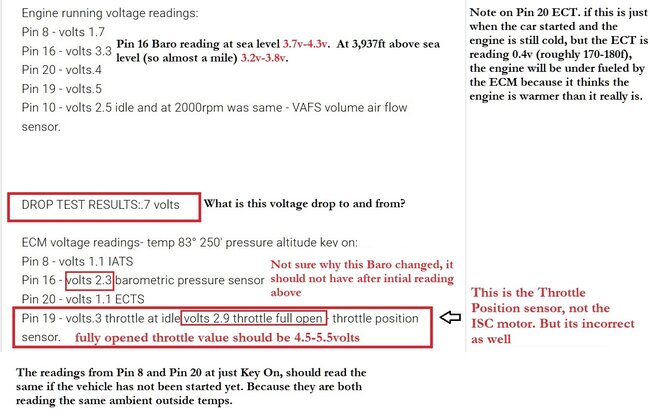

And regardless of the distributor, you still have low reference voltage, that is going to affect starting as well. Thats where you began with, codes for sensors that showed to have low 5volt references. That's why those codes were setting. Take care of one problem at a time, with a malfunctioning ECM nothing is going to work. I'm looking back at all your testing results right now, there is low reference voltage to multiple sensors, which will not allow the engine to start.

I plugged the harnesses back in best I could - they seem like they might be functional until I get a harness connector. Wouldn't it be best to check for spark at the spark plug so that I am checking the distributor the wires and the spark plug? Do I need to check each spark plug or just one? If I check at the spark plug, can I just look for a spark at the tip of the spark plug? It has fuel at the fuel filter located on the rear wall of the engine compartment prior to the throttle body, but I cannot check for pressure like the video showed - no transportation. Can I assume that I have fuel to the engine based on fuel being at the filter?
You said at the very beginning of working with me that the engine control modules that have been rebuilt are problematic, so I probably should have started with a used engine control module just to see if that resolves the problems? I also remember that the check engine light and most if not all these problems originated after replacing the original engine control module. I called the phone number from the rebuilt engine control module sticker and they seem like they were going to honor their limited lifetime warranty, but then they said they didn't have me in the system and the company that rebuilt it went out of business and forwarded their phone number to this engine control module repair company so they seem like a shady operation or not willing to help after I told them the check engine light was on ever since we installed the engine control module.
Can I purchase this engine control module and utilize it to check my old engine control module? It has the same part number: MD159561 but I think the Vin reveals it as a GS and it might have anti-lock brakes airbags and other things that my car doesn't have.
