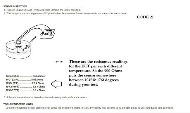

ECT ohms reading:

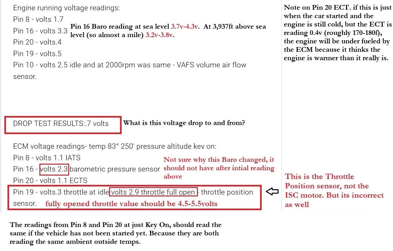

PIN 17 in ECM with key on but engine not running was.3 volts.
I had the engine coolant temperature harness unplugged and the volume air flow sensor harness unplugged during that check. I'm not sure if I was supposed to run an ohm's check from PIN 17 to PIN 5, but they are both a brown wire (Br) and it seemed like one of those diagrams did a check like that.
I will try to check ECM pins 8 (IATS) and 20 (ECTS) again as they were both 1.1 volts last time I checked them. I will also try to check ECM pins 13 and 23 for the 5 volt reference.

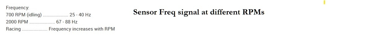

The crank and cam sensors inside the Distributor are pick up (variable reluctance) type of sensors, so they are a coil of wire and when a part of a trigger wheel passes by the pick up for the sensor it sends a signal, now it could also be the transistor getting hot inside and failing as well, this is a diagram of the Distributor, the Ignition Power Transistor is a solid state device, which is inside an ignition module inside the Distributor, but long story, short, it can act with the same hot/cold fault.

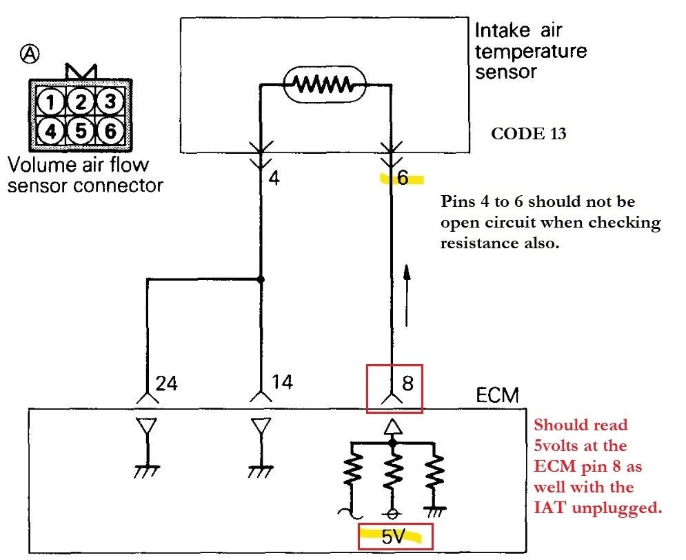

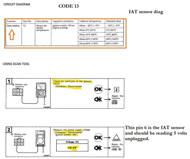

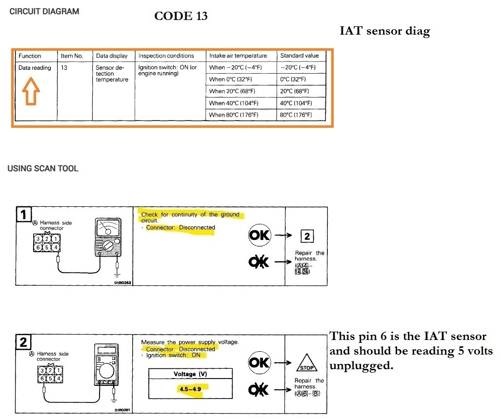

The reason I wanted you to check for 5volts on pin 8 and 20 was to make sure that either the IAT or ECT sensors were not shorted out and effecting the other sensors, if one is shorted out and pulling down the 5volts, it can cause other sensors to set codes as well.

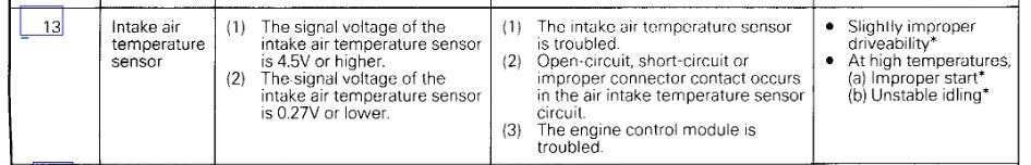

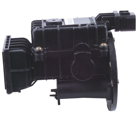

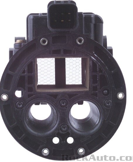

This is the Air Volume sensor youre dealing with, its a pretty complex sensor for a 1993. Its also about $120 from rockauto. Just resistance readings jumping around like that can be caused by potential solder joint issues inside, since you had steady readings on the other sensor I dont think its a multimeter issue, but resistance will jump around like that when the circuit being tested doesnt have a good complete circuit,
whats difficult about this sensor is with service info they want you to see what a scan tool is reading from the sensor compared to the actual temperature. For code 13 they have you check scan tool data temperature reading, then check the ground for the sensor and then just the 5volt ref, and thats it, (diagram 5). So youre previous check of the unplugged 5volt ref that was low, is really our only clue as to what might be setting the code.
You can do the same check on the wire from ECM pin 8 to IAT pin 6, except with the colors being incorrect, service info doesnt help us much, the only thing you can really do is see if ECM pin 8 has a resistance reading to one of the 6 wires of the connector.

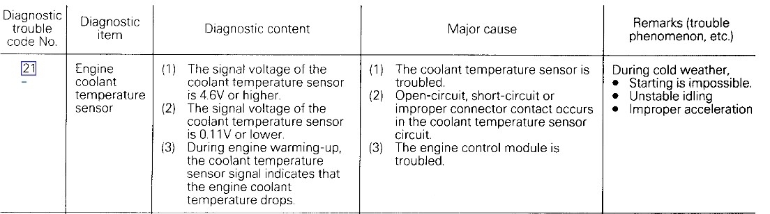

The Code 21 ECT info is on diagram 7.

Key on and engine off with VAFS harness disconnected, ISC MOTOR POSITION SENSOR harness disconnected and ECT harness disconnected readings at ECM:
PIN 13 - 5 volts
PIN 23 - 5 volts
PIN 8 - 3.9 volts to IAT sensor
PIN 20 - 3.9 volts to ECT sensor
Last time I checked PIN 8 and PIN 20 with the harnesses connected they were the same at 1.1 volts with key on engine off and now they're the same at 3.9 volts with the key on and the harnesses disconnected and these two pins are right next to each other at the ECM. Could these two (pins 8 and 20) be shorted together between the engine control module and the sensors.

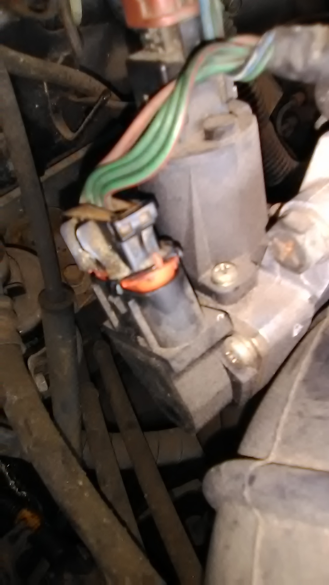

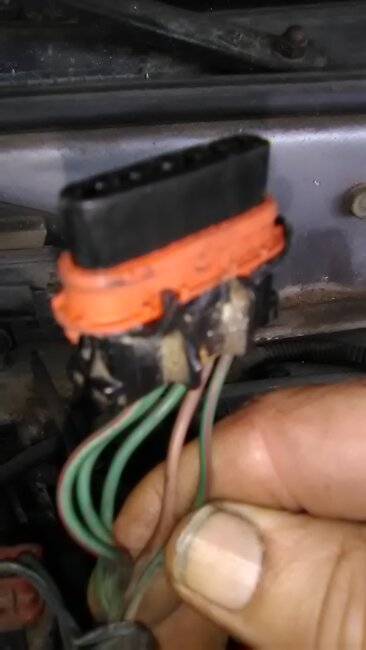

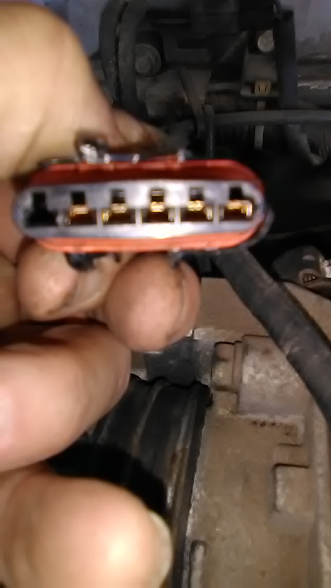

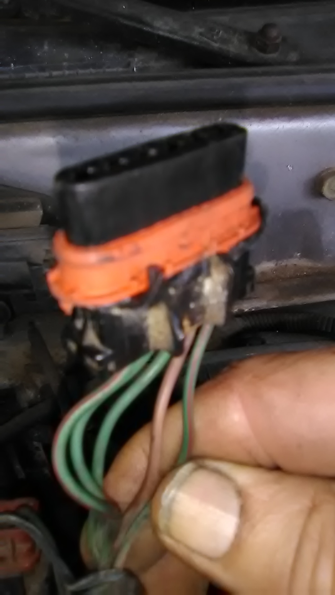

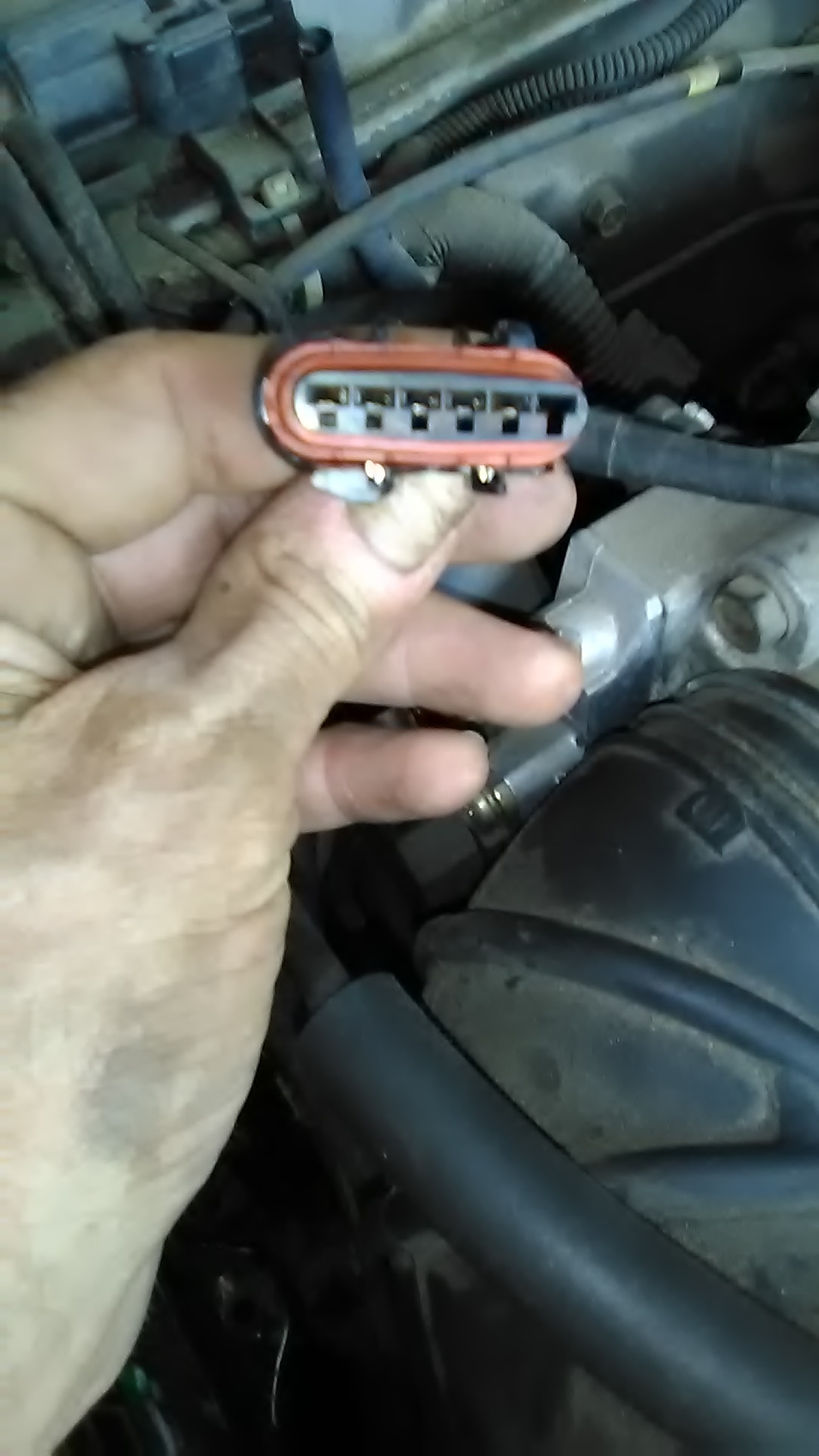

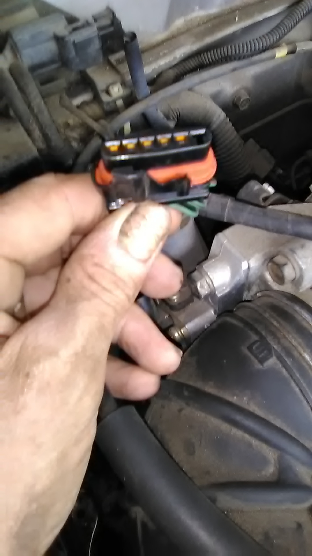

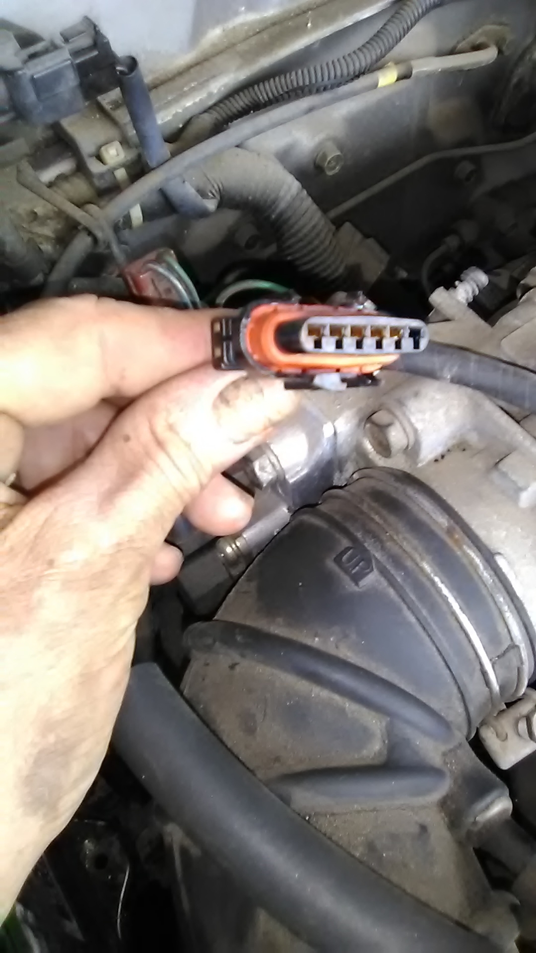

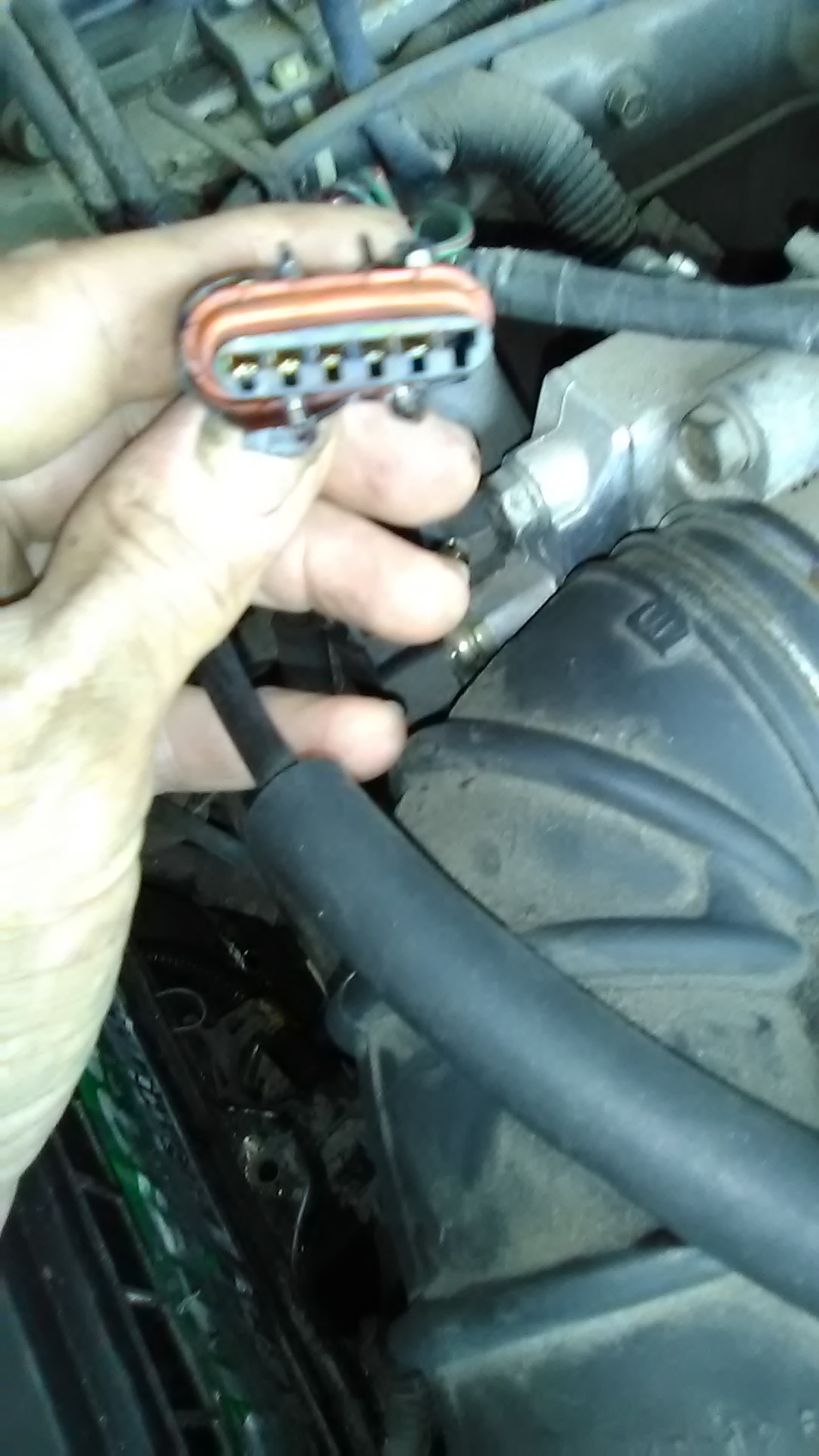

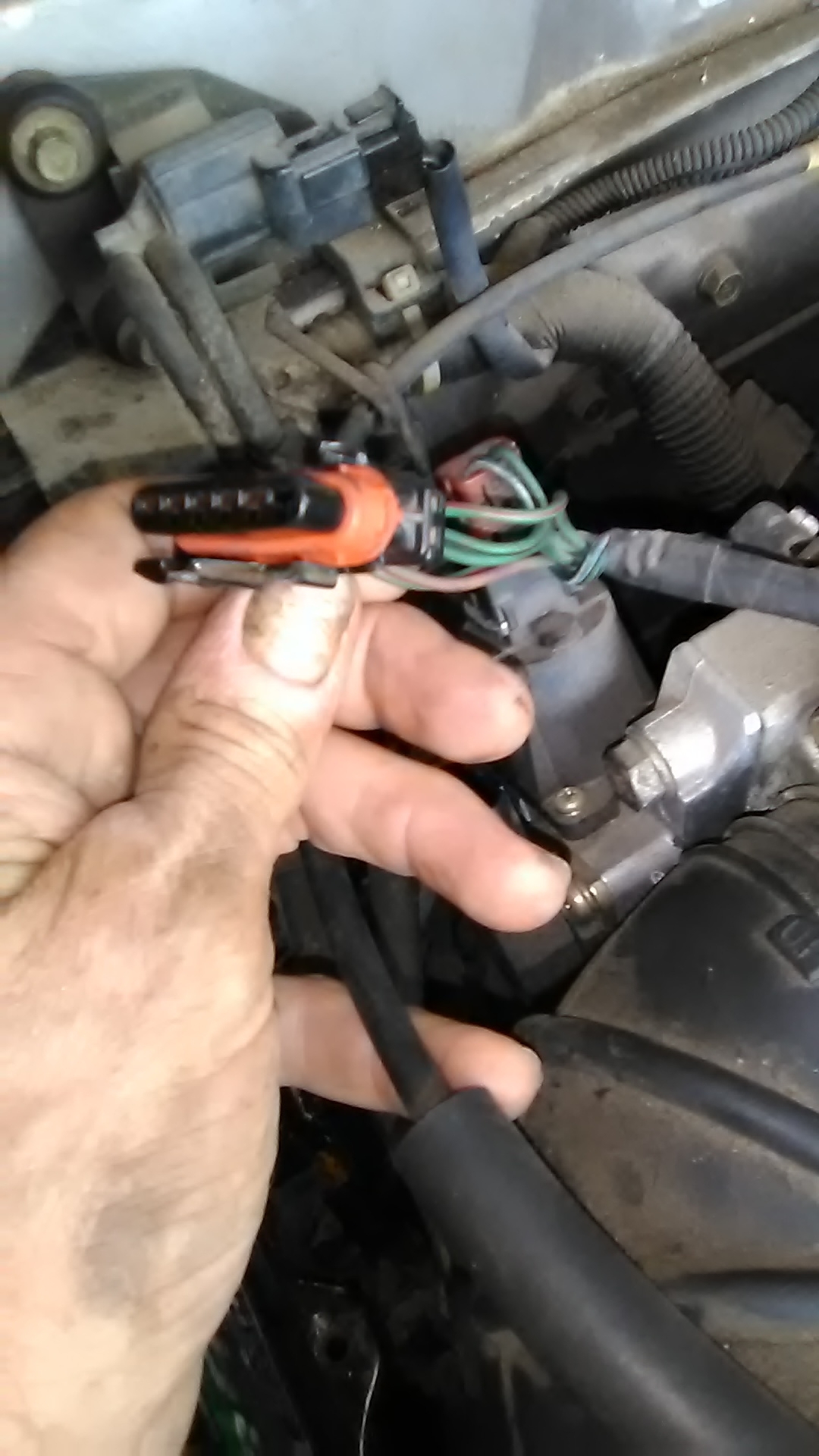

I attached photos of the idle speed control motor position sensor harness connector for you to evaluate the damage, but I doubt if it's the problem because these codes were there in 2013 and I doubt if the harness had much if any damage in 2013.
I was going to try to read the codes again with the ohms reading, but there's four wires in the diagnostic connector and I couldn't find where the diagram indicate which wire to connect to which lead from the multimeter. I believe only one of the wires is dark and the other three are either creamy or white color.

So as for your question on the two sensors possibly having their wiring shorted together, yes that can absolutely happen, to check that, unplug both sensors, and unplug the ECM connector they go to and just check pin 20 and pin 8 at the ECM connector for continuity between the two, there shouldnt be any reading between the two of them, with both ends
of the circuit open while unplugged they should read OL on the meter.
Another test you can do is with them both still unplugged, check for continuity to ground (Battery Negative) on either wire, there should also be no reading from that test. If you read anything, the wires can be shorted to ground somewhere, its common to find wires melted together at location where they might be touching the exhaust or a contact location where they have been rubbing on metal over the years and they short out that way.
A corroded connector can also short circuits together, if water or some other liquid has gotten into something like a bulk connector, in that case you will find a bunch of green or white crusty corrosion inside the pins of the connector. Even a pin hole of a wire can corrode inside, and the corrosion can just grow inside the wire insulation breaking the copper strains, those are difficult to find because you cant actually see the corrosion.
So following the wiring in the harness from a sensor will sometimes lead you to a location where the wiring is just a complete mess.
From your readings it sounds like Pin 13 & 23 are a different voltage regulator inside the ECM and pin 8 and 20 share a different 5volt regulator, or most likely you would be reading the same 3.8 volts on 8 and 20 as well.

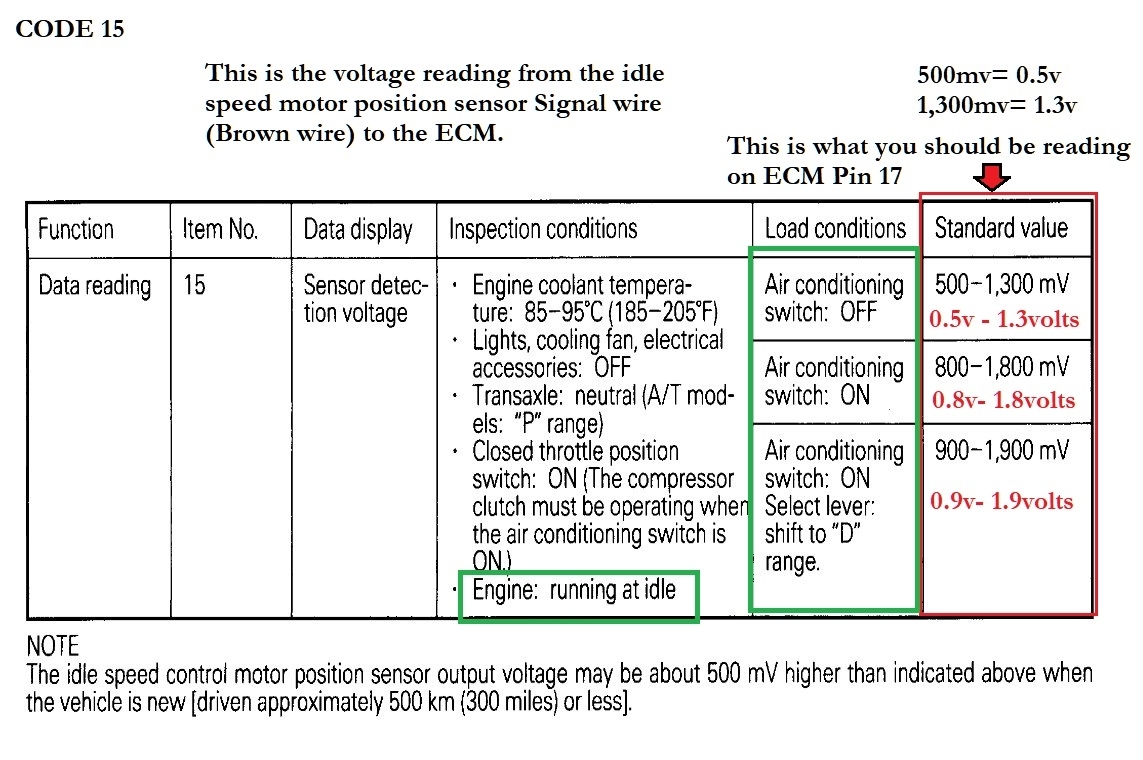

Br wire from the (ISC) Idle speed control motor position sensor - PIN 17 readings at ECM: volts stayed.4 volts with air conditioner off and air conditioner on. I know that the fan at the radiator kicked on but I'm not sure what the parameters are or how to know if the compressor was on, which was a parameter for the third measurement. Seems kind of mute anyway because 0.4 is below the allowable tolerance which the diagram indicated from.5 to 1.3 volts and goes up to.8 to 1.8 with air conditioner on and 0.9 to 1.9 with compressor on. The car engine RPM was idling at 950, dropped to 900 when I turn the fan on, and drop to 700 when I turn the air conditioner on, but the car never died out.

It sounds like the idle speed motor might not be moving like it should, Try removing the guard from the air intake boot area, and see if it will start, technically pressing the gas pedal will open the throttle plates allowing more air in, if that idle speed motor is the issue.

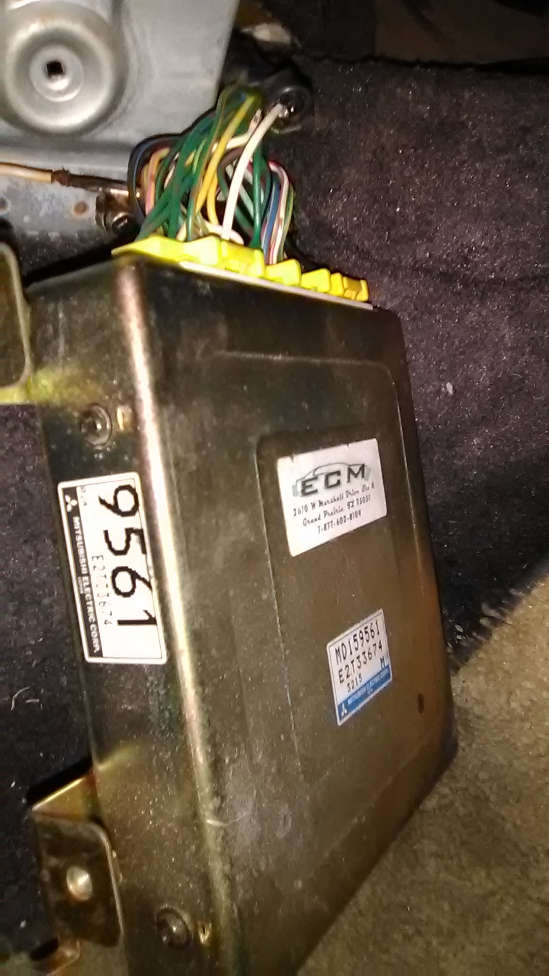

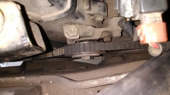

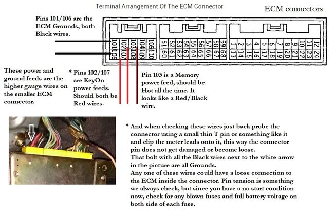

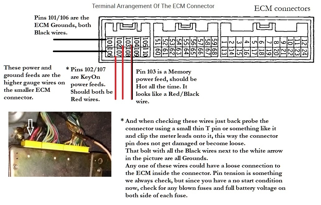

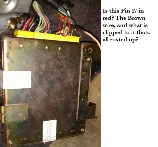

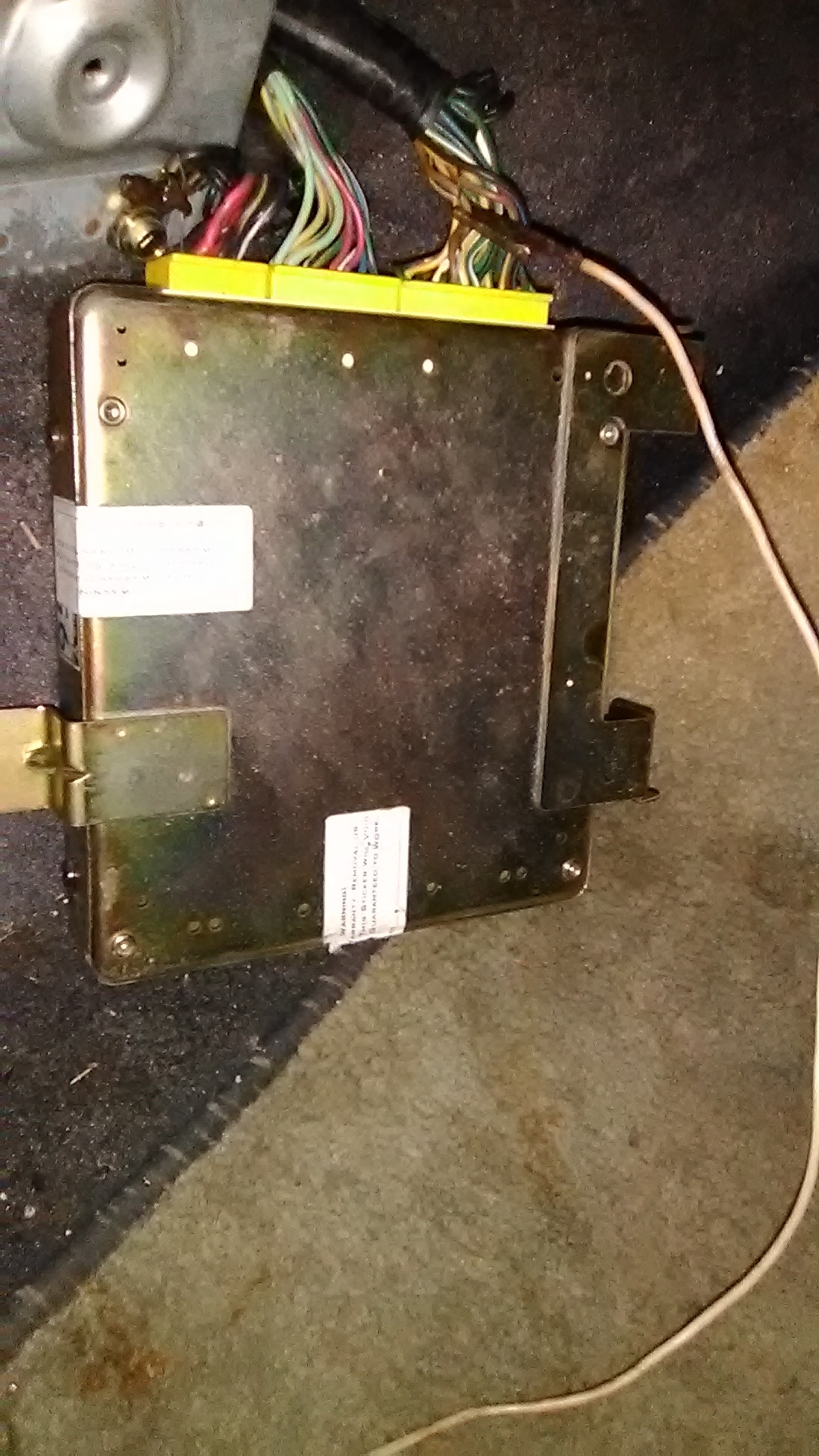

Can you post a picture of the ECM for me, you dont need to unplug it or anything, I just want to see which type it is. If you have trouble posting it here for whatever reason leave me an email and Ill contact you for the picture.
I also question the condition of the ignition system, ie spark plugs and wires, possibly some clogged fuel injectors as well. Or even old gas since youre having so much trouble starting it.
Monday, October 7th, 2024 AT 11:48 AM
CODYBTUCKER
  • 19 POSTS

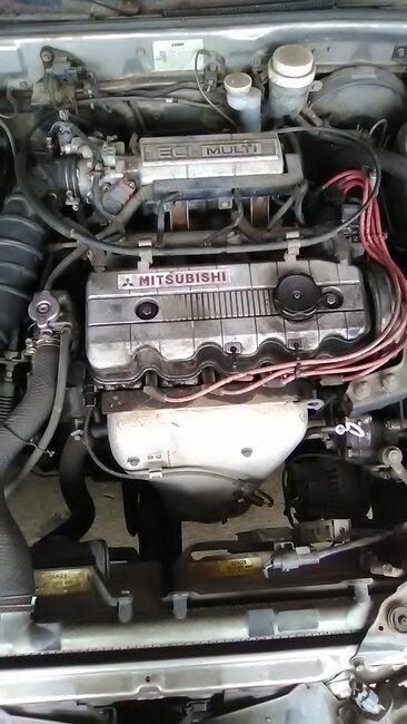

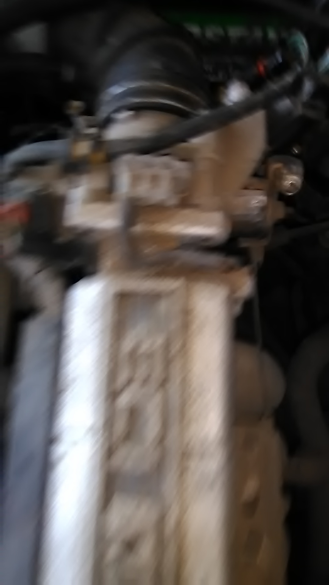

Two of the photos are of the engine control module both sides, two of the photos are of the throttle next to the idle speed control and the last photo is of the clutch or air conditioner part that you wanted me to look at because it is way down in there and I'm not sure when you say cycling on and off if that thing is spinning or moving in and out - I could not tell. Another strange thing that might be helpful is that the coolant temperature warning light, door ajar, brake and the battery warning light always came on when I turn the key on and now since we did the air conditioning test those lights do not come on when I turn the key on but after trying to start the car the lights then show up with the other warning lights (check engine, oil, seat belt).

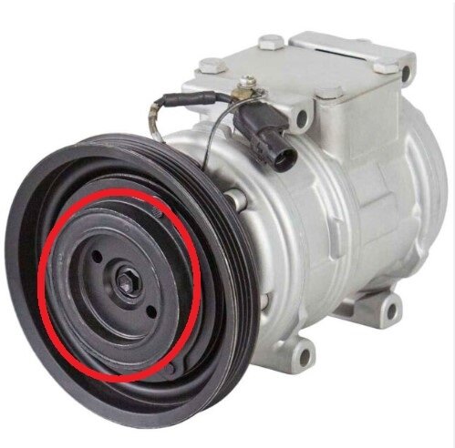

The front clutch on the AC compressor should be spinning and cycling on and off roughly every 8 seconds on these older ones. I can definitely see that is a remaned ECM.

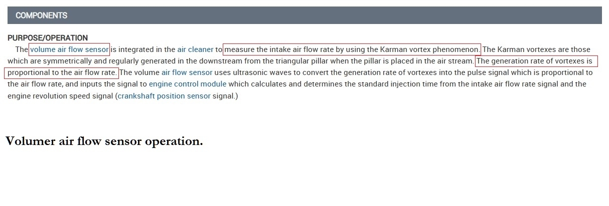

Something to note, and I will post the air volume sensor operation below because it signals the ECM by Frequency not a voltage reading and the vortex or turbulence of the incoming air is very import for the sensor to read correctly, and the **guard being in the way is not allowing that air turbulence,
the ECM calculates the amount of fuel to be delivered from the air volume sensor, using the other sensors such as the IAT and other temperature sensors to adjust that air/fuel mixture depending on engine and outside temperature.
The Coolant temperature warning light is most likely happening because of that voltage variation. With only 3.8volts on a 5volt reference circuit for such a critical sensor, and the load that the AC compressor put on the engine, (even if it didnt turn on because the ECM will adjust the idle according to the AC pressure sensor), may have just plainly over worked some other components. Because the car is not driven much at all, thats one of the worst things for a vehicle, is to sit, it effects so much.
So from here we can either diagnose the no start condition by checking for ignition spark to make sure the spark plugs are even firing, you can see if it will start with the air intake system cleared of any obstructions, such as that guard, at least temporarily.

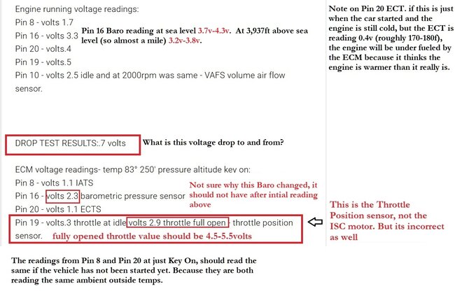

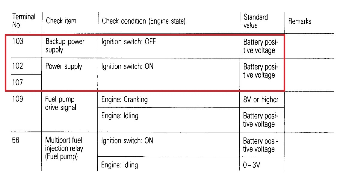

Diagram 3 below is some notes on your testing voltages, there are some sensors not reading correctly, The Baro reading should not have changed, since the key On values are different than the running values, I do wonder about this battery too.
But put the air flow guard back where it should be, check the battery voltage before starting the car, and see how low the voltage drops when cranking the engine. If it drops below 9-10volts during cranking its no good and needs to be replaced. A bad battery can cause Alternator problems that will eventually cause the ECM to fail.
The ECM I can bench test if needed, but low voltage to the ECM during running or a wire connection issue (corrosion) will cause voltage drop especially while running because of the extra electrical loads. Even though you tested the wrong pin, 19 instead of 17, the throttle position sensor is not reading correctly at full throttle.
These are probably all related. Diagram 4 is the ECM battery voltage pins and 5, 6 are the Ground locations in the engine compartment to check for corrosion or broken wires, they should be cleaned as well.

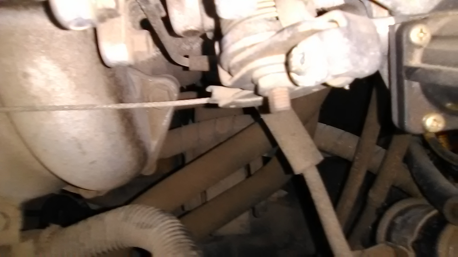

The car cranks but it will not start, and it has only started doing this since the air conditioning fan and clutch were engaged. On the instrument warning panel lights, the door ajar light should be on and is not on and the brake light is on dim when it should not be on and the brake light goes bright when I engage the brake and sometimes when I turn the key on there are three lights and sometimes there are six lights and after turning the key to crank it defaults back to six lights in the instrument warning panel and all of this has started since you had me do the air conditioner test on the engine control module PIN 17 test that resulted in point 4 volts when it should have been.5 volts to 1.3 volts. I swapped the battery and the problem is the same. The five ground points that the diagram indicated as the eclipse engine grounding points all tested with what appeared to be the same appropriate ohms. Can there be a wire or wires from the air conditioner or air conditioning components that can tell the engine to shut down as soon as it starts (meaning it cannot ever start) and can be causing instrument warning panel light issues? Why is engine control module PIN 17 giving a steady.4 volts when it should have been climbing to.8-1.8 when the air conditioner was turned on. The air conditioner has been a problem with this car since before the engine control module went dead in January of 2013 and since ECM was replaced the check engine light to the best of my knowledge has been on. Many mechanics have looked at this car with this information, and either walked away scratching their heads or charged me money and amplified or increased the problems.
I remove the hose between the idle speed control engine position module and the volume air flow sensor, but you have to tell me why or what to do with it. I also remove the guard that was intended to keep the rodents out of the volume air flow sensor filter, but the car started many times with that guard in place and it still will not start now without the guard in place.

I wanted you to check the throttle plates for any carbon build up, and you cant get to them without removing the air intake boot. If the ISC motor position should move when the AC is on to increase the engine idle because of the load the AC compressor puts on the engine, try unplugging the compressor clutch, it has a connector that goes to the clutch on the front.

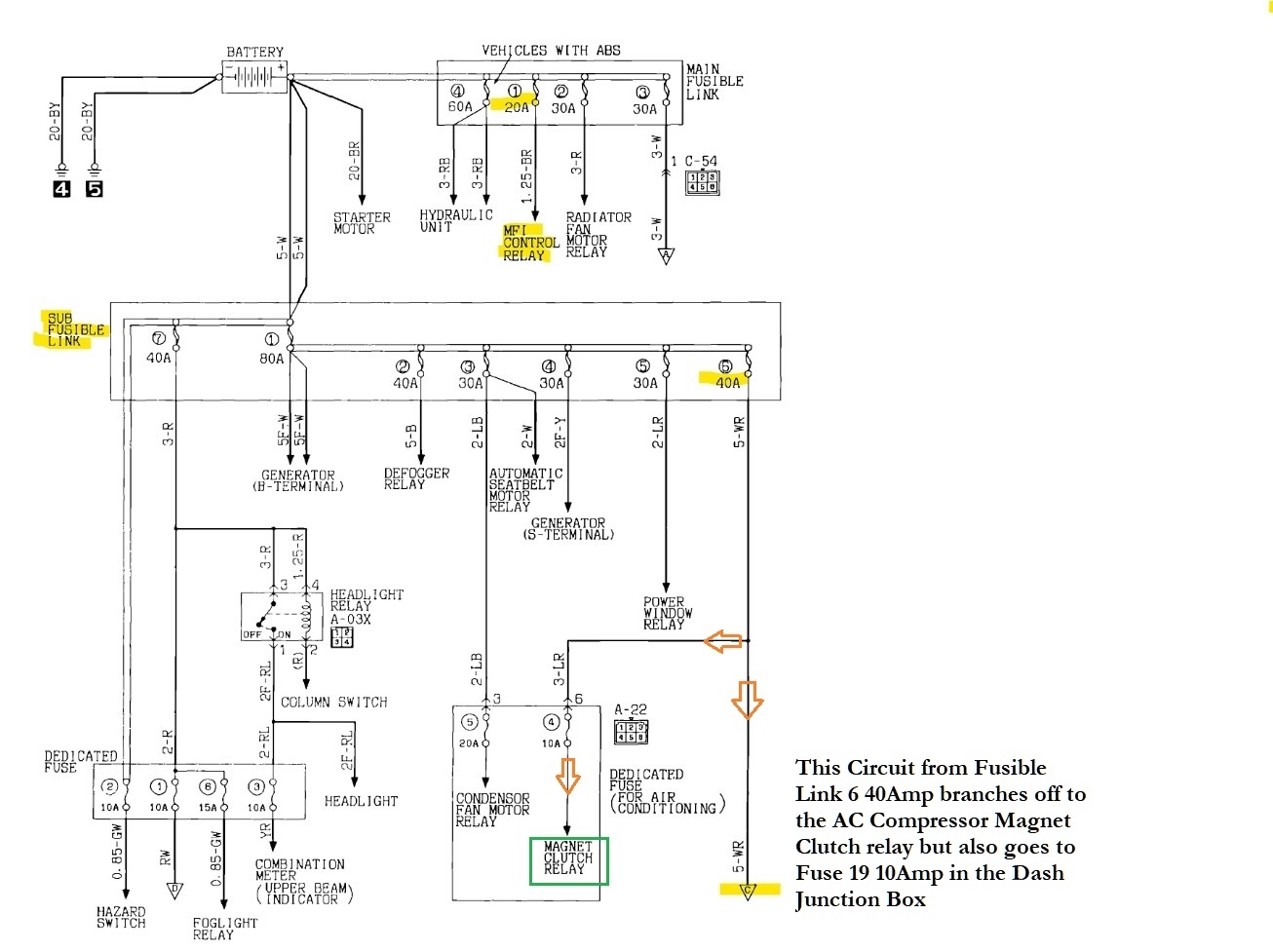

Its possible the AC compressor is starting to seize up or there is a problem with the Compressor clutch or Clutch relay. So unplugging it to begin with will take it out of the equation electrically.

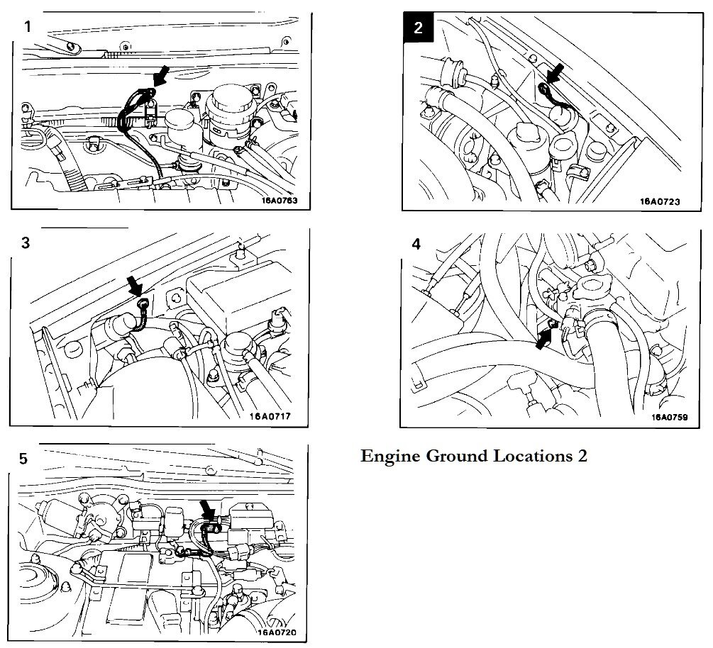

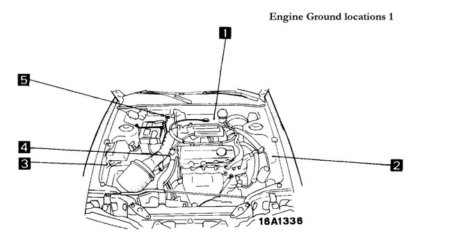

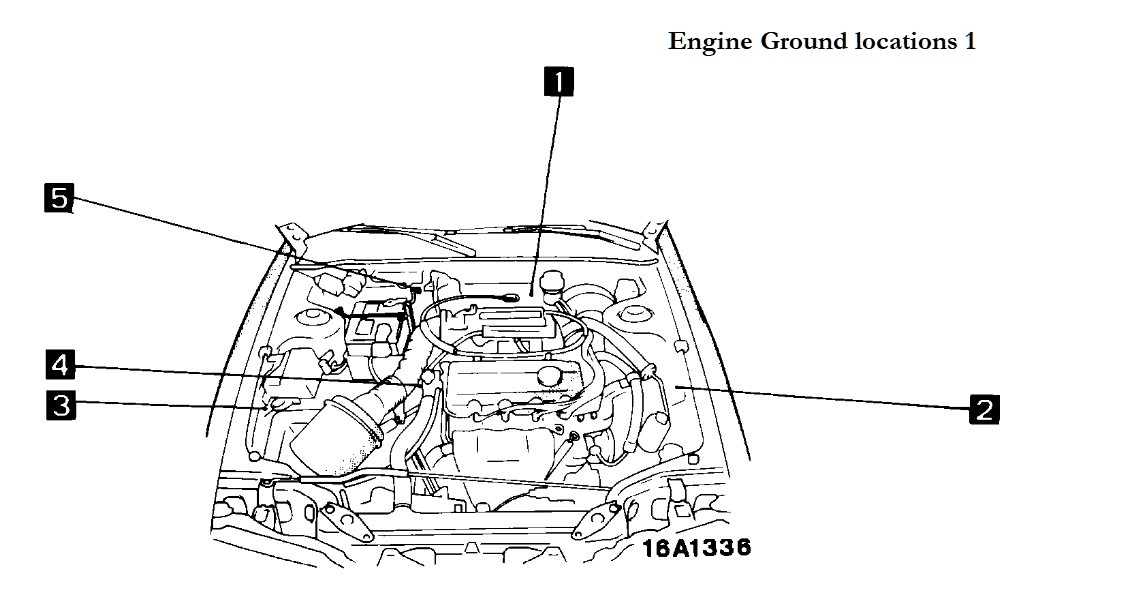

There some electrical issues going on here, if you have lights that are dim, then getting bright and some on and off, thats a voltage loss somewhere.
And there is a reason the original ECM went bad in the first place too, this is an old vehicle, so things are going to have worn out by now,

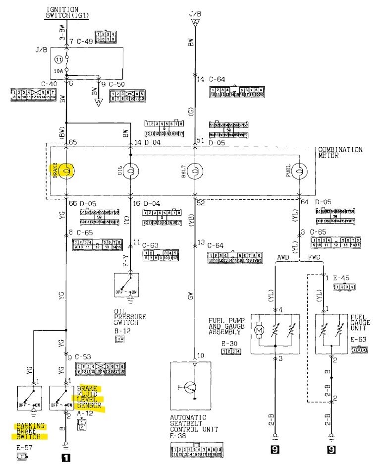

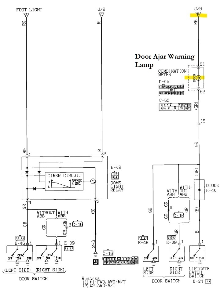

The Brake lamp on the dash is triggered in two possible ways, either there is low brake fluid in the master cylinder or the Parking brake switch is engaged (diagram 2).
Checking the voltage level for the idle position sensor with the AC on shouldnt cause any additional issues. Its because we have started testing things and moving wires around and even the ECM connectors might have lose pin issues.
If the throttle plates look ok, and there isnt any black carbon around the edges of the plate, then just put the intake air boot back on and put everything back together.
Are you able to press on the gas pedal when cranking the engine? That will allow more air into the engine if the ISC motor is not moving its full range. Thats all the ISC motor does, its just moves in and out to open a port that bypasses the throttle plate and allows air in to control the idle. And thats why its position voltage should increase as well with the AC on, because its opening more to up the idle.
Diagram 4 are the Power and Ground wires at the ECM.
Sorry for the delay, but I have found some more diagrams that link things together, I will post them next.

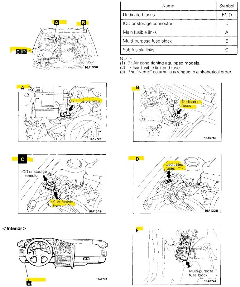

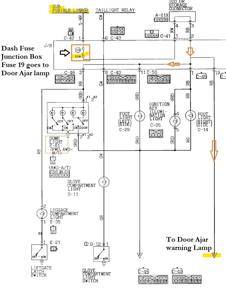

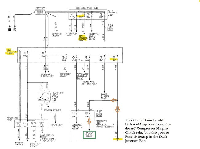

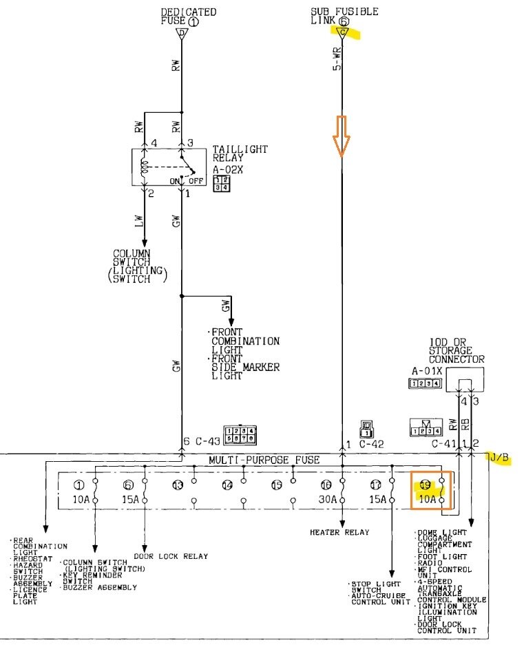

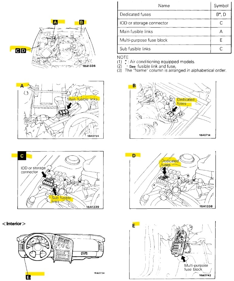

So, these two first diagrams are for the Door Ajar lamp which originates from Fuse 19 10Amp in the dash fuse junction box, but what is interesting is in diagram 3 notice that Fusible Link 6 40Amp branches off and goes to the AC Clutch Relay, then also goes to that same Fuse 19 10Amp in diagram 4. So you may find a blown fuse that happened when the either the AC compressor Clutch came on, or something is wrong with the Relay that controls the compressor clutch. It does link together.
Diagram 5 shows all the fuse box locations Since there are 3 locations in the engine compartment and then one under the drivers side dash.
So with a test light hooked to ground, you should have power on both sides of each fuse. And check the fuse locations for any corrosion inside the pins as well..

Sorry, I did not get to looking at any of the fuses yet.

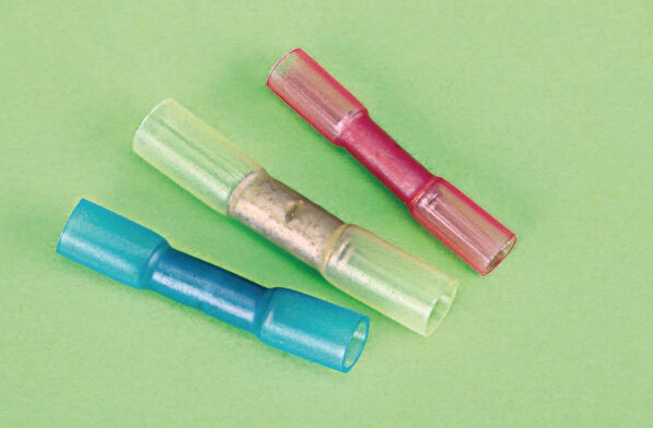

You can get new pigtails with a section of wires already connected to the pins but you will need to crimp the wires together in the correct places, and heat shrink them down to keep moisture out. I will explain all this, but see if you can even get new connectors for the Distributor and ISC motor position sensor. You may have to go to the dealership for this, I dont know, considering the age of the vehicle. But these repairs need to be done first.
Get a can of this electrical terminal cleaner, and these are heat shrink butt connectors, they crimp the wires together, and then you heat the ends and they will seal around the wires to protect from any corrosion. You can search you tube for any videos showing how to crimp wires together to get an idea of how it works.
This is an example of a pigtail replacement connector.

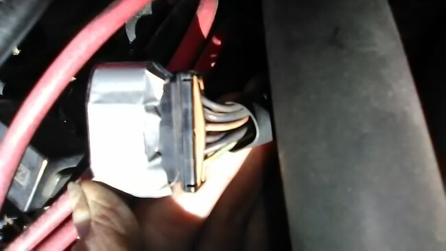

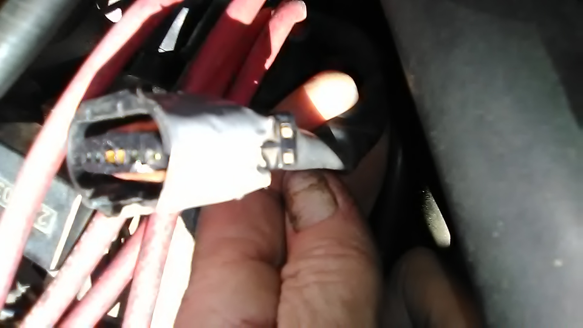

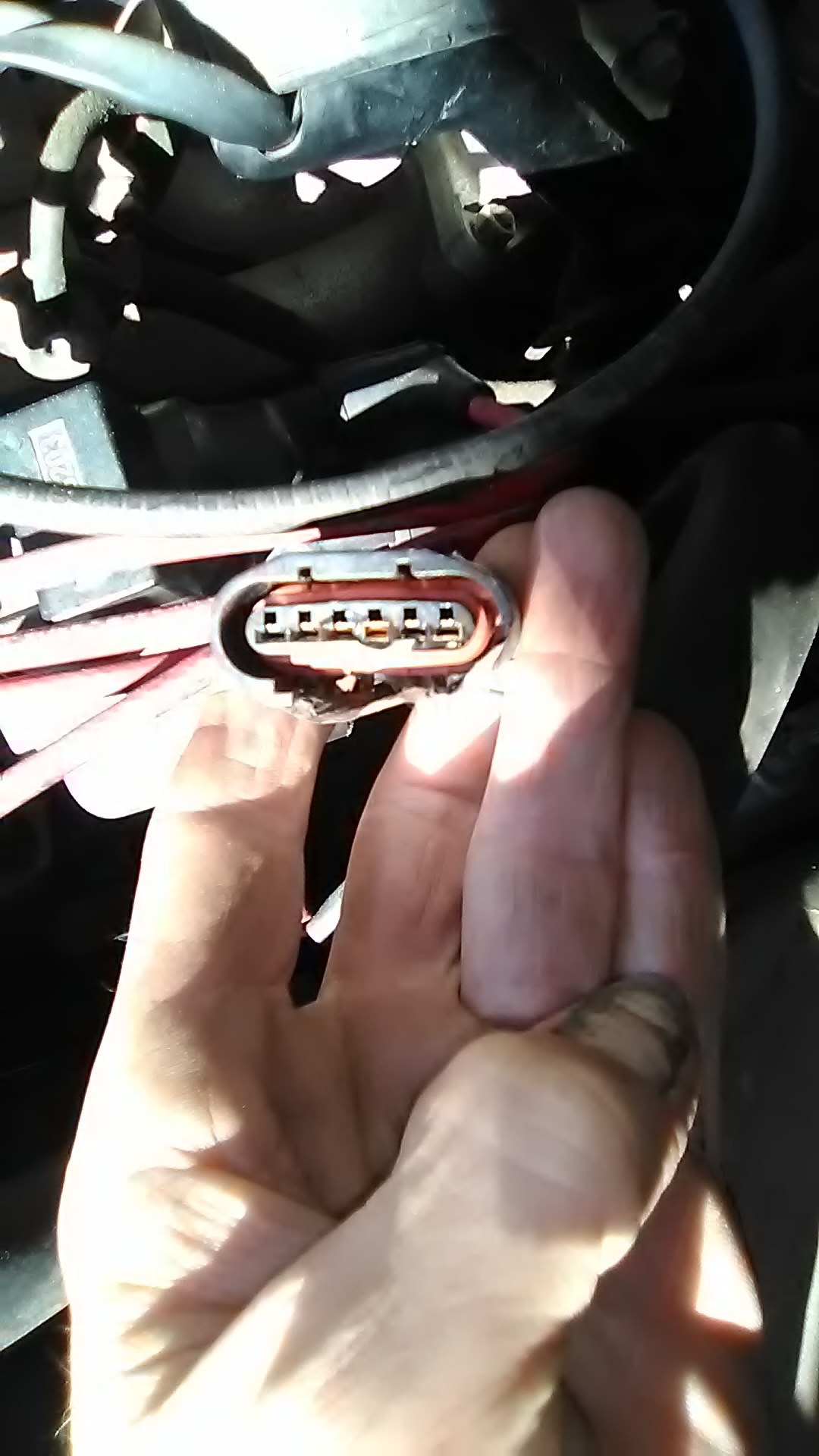

Photos of the harness connectors. I think the distributor and the idle speed control motor position sensor connectors are the same.
Saturday, October 12th, 2024 AT 10:05 PM
CODYBTUCKER
  • 19 POSTS

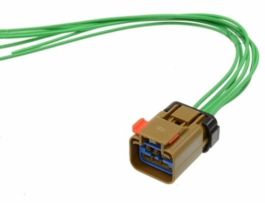

The two harness connectors are so heavily damaged that it is difficult to determine the shape, but I believe this is the part number.
MG640547-5 6 Pin Female MAF Sensor And Ignition Distributor For Mitsubishi
And I attached a link to a photo of the actual harness connector.
https://www.aliexpress.com/i/2251832663961130.html?gatewayAdapt=4itemAdapt
There's another one at the same link that has the pins already connected with the wires.
Sunday, October 13th, 2024 AT 4:30 AM
AL514
  • 5,584 POSTS
No you don't want to have to deal with re-pinning the connectors, you need to get a connector with a pigtail, so a connector with wires already pinned into the connector like I posted. (1st picture) this is the type of connector you need to get; it will take you forever to rebuild a connector with new pins, and then try to stripe the wires to fit those pins, then get them into the new connectors making sure they make perfect contact. It will never happen. You have to have a lot of experience even dealing with the pins to begin with. Don't buy any junk connectors from Amazon or some other cheap site, they are going to be incorrect like always, go to AutoZone or some local auto parts store and see if they can get you those connectors with pigtails already connected, and crimp the connectors together.
With a connector that already has the wires installed in it, you just need to go wire by wire one at a time and use crimp connectors (2nd pic) making sure you have the correct wire in the new connector going to the old wire from the old connector. Thats the only way you will be able to do this,

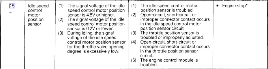

The other issue you are having is the low reference voltage. And most likely a ISC motor that has carbon build up inside, like I said, all the black soot that is in the air intake boot and around the throttle plates is carbon build up, your intake manifold is probably full of the same stuff. But that low reference voltage is definitely a problem, Pins 8 and 20 at the ECM should have a full 5 volts or those sensors will not read correctly. It looks like the ECM in the picture isn't even bolted down. I can only go so far with this, have you checked the power and grounds at the ECM yet? Your original post was for these four codes setting, the ECT is the first sensor the ECM is going to use during a cold start.
And the engine needs air which the ISC motor provides, in the 3rd diagram below is the code setting criteria, the 3rd row over are the voltage levels that will cause that code, the 4th row over are some possible causes, same with the other codes,
You may need to have a mobile technician come out and look at the vehicle, not some shop where they don't know what they are even looking at. It will save you a lot of time and a headache. Just have a mobile tech come out, tell him about the low reference voltage, and the codes, let him figure out what's wrong, it will probably take an hour of diagnostic time, then fix what's wrong yourself, there are too many issues with this vehicle and possibly a bad ECM to figure this out on your own, I know you want to, but it takes years to learn how to properly diagnose these things, if I could I would come to your house and help. But that's not possible unless you live in NC. I'm helping with the relief work from the flooding in Ashville NC too. Bouncing back and forth here. It would just help you so much at this point to pay a mobile guy for an hour or two of diag time, just to figure out the issues. Where are you located?
