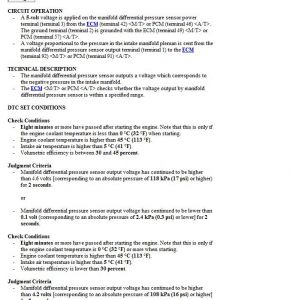

My son has a Eclipse GT with a 3.0 V6. The check engine light is on all the time. After having the codes read we were told we had code P1400 with was the "manifold pressure switch".
I pulled it off the manifold and there isn't much to it and re-installed it. The connection was tight and nothing looked wrong as far as the install.
How do you check it out?

are you sure its not a egr code. check the vacuum lines to the egr valve to be sure. if you still need help i will research it in the am.

[quote:81eee2ead0="mastertechtim"]are you sure its not a egr code. check the vacuum lines to the egr valve to be sure. if you still need help i will research it in the am.[/quote:81eee2ead0]
He went to Autozone and they used their scanner to pull the code P1400. Looking it up it was the
"P1400 Manifold Differential Pressure Sensor Circuit Malfunction (Mitsubishi) "
On some Fords it might be the EGR circuit is what I found
Thank you!

you are correct. if you dont have a scanner to watch the pressure voltage of the sensor i would go ahead and replace it due to the most common problem would be a faulty sensor not the computer. let me know

I replaced the sensor and it so far has worked. I cleared the codes by disconnecting the battery. Test drove it and turned if off several times. Let's see if this does it. Thanks for your help!

He has been driving it for two days without a light on so hopefully it's fixed. Going to get the smog check tomorrow so I will know for sure after that :)

Believe me, I understand. Based on the code, I would believe there is a vacuum leak somewhere on or around the intake. It could cause a noise that you described. Also, check the exhaust for leaks. On this type of car I'm concerned that a change in backpressure may even set the code.
Also, the Manifold Differential Pressure switch (MDP) sits on top of your intake manifold and monitors the air pressure. Check it to see if it's mounted good and maybe unplug it and plug it back in to see if there may be corrosion on the plug. Also, have someone check closely for leaks there, remove the MDP and clean it if carboned up and properly replace it. The more I think of it, the more I think that is where the problem is. You may also want to have the EGR checked for leaks, if it's stuck, or carboned up too.
