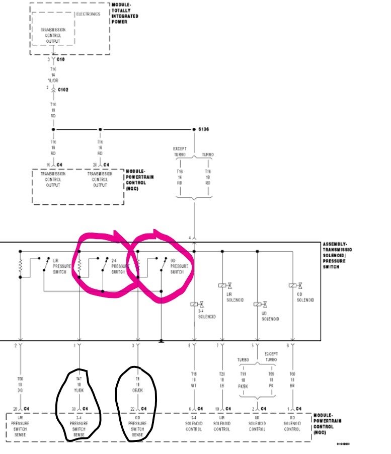

Well, I got it to start. It is doing the same thing it did before. It kicks when I put it into reverse, feels like it engaged but it won't move, little kick when moved to neutral, then shuts off when I put it in drive. Do you think it could be a bad solenoid pack even though it's new? Is there a certain way the manual shift lever should go? There are more codes now too. P0732 P0846 andP0871. Can't afford to take it to a shop now more than ever. I am a big girl, so I am not going to cry, on the outside.

Well, those are all transmission codes. Basically, pressure in the transmission isn't correct and it's causing issues. Likely it is the reason for the stalling. I would start it and let it run a bit, then erase the codes and cycle through the gears again to see which ones come back.
The 846 (circuit B) and 871 (circuit A) are both pressure sensor circuit codes, the 732 is incorrect gear ratio, which basically means the PCM is seeing that the transmission is in a gear, but the output of the transmission isn't moving.
I doubt it's the new pack. It sounds more like something in the wiring, like corrosion or a pinched wire.

I have done your first suggestion, but one more time won't hurt. Might you have a direction as to what wires to start with? I checked many, many wires and connectors because of the p0882. Should I start there again? You know, I don't know that I can flush the fluid if the dang car isn't going into gear, can I? I haven't tried yet but removed the cooling line and got some fluid out and it doesn't look bad, I guess because half has already been changed. Just thought a flash would be good considering the work. Thanks for the quick get back.

If the engine runs, you get fluid flow as the pump is turning. To see if the issue is a faulty switch or two or if it's something internal you could use a meter to probe the switch outputs at the transmission connector. The switches should both be open with the engine running in park, as well as open when the engine is off with the key on. Ground one lead of the meter and probe the yellow with black and the orange with black wires on pins 1 and 3. With the key off you should read a resistance and not a direct to ground.
If you see a direct short, then there is a wiring problem or the switch you are testing is stuck closed.

I hope you are doing okay. I worked at a hospital for 20 years and am still amazed at how much everything costs. My husband has serious heart problems so, yeah, he's in the triple digit club too. Try to stay well. We diy-er's need you, lol! So, I printed my wiring diagrams and shall start poking around tomorrow. Wish me luck. Thank you, my good man!

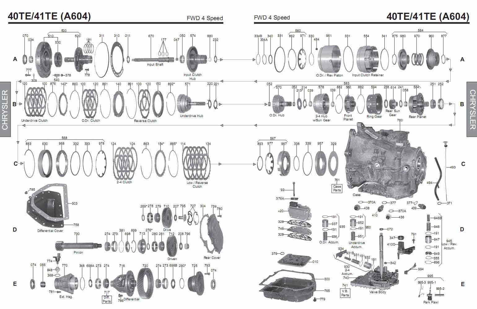

Good day to you sir, I hope all is well. So, today I did the flush. At first, the car did nothing when put in reverse, but the drive kicked in and actually moved but, when reverse started to kick but not kick in, it suddenly started stalling in drive. This was happening as I slowly added the fluid. Now that the fluid is at a good level the car does the die in drive thing. I am going to start testing wires, but I just wanted to ask if something like the od and ud accumulator springs could cause this kind of problem? When I dropped the VB the springs and accumulators went flying. No biggy except one has one spring and the other has two. I researched as best as I could and think I put them back where they belong. Also, the car is acting like it did after the solenoid pack and before the BV. Still, I am guessing those springs could get sprung and lose their function so I thought I would ask. As always, you rock!

The springs in wrong could cause problems like you have, as the pressures could be wrong. There should be a parts breakdown showing the springs like the attached.

That is beautiful! And it is the first I have seen of it. Looking at this breakdown, I see the springs in question, but alas, one of mine has 2 springs, I believe it is the underdrive accum. Also, this is what was happening after the solenoid change but, before the valve body change. I deduced the spring w/small spring belongs to the underdrive by faint markings on the plate. I put it closest to the front of the car. I am sure it is possible that I could recreate the symptoms if I was mistaken. But that would not tell me how the first symptoms arrived. Oh, and generic code p0700 pending, and freezeframe shows P0736 though there might be more, but I am not sure when the codes will set especially since the car is back to not moving again. I will do my wires first thing tomorrow. I am trying not to overthink this. And while I know this, for now, is way beyond me, I figure I've little to lose because if I don't try the car will just sit in my driveway looking pretty until it doesn't anymore. Honestly, I dig the challenge but, certainly welcome and appreciate the help. And did I mention your patience?

The 2-4 accumulator has 2 springs as does the low reverse. The under and overdrives should have a single spring. However, the springs are also different strengths depending on location. These might help a bit.

When I removed the valve body two pistons came tumbling out as well as two springs and one of those had a smaller spring inside it. I never touched the low/reverse accumulator because as you know, it isn't part of that removable valve body. I am so confused right now! I am thinking I need to go back in there and see what the heck is going on! Do you concur? There is a sticker on my transmission that says something like proudly remade in the USA. Do you think it is a rebuild and they messed it up and that is why the sticker doesn't say proudly remade correctly in the USA? Could a mistake like that cause all of these problems starting with the p0882? Or am I getting all worked up over nothing? Or (And let this be the right or!), Might you have diagnosed my car without laying a hand or eye on it? I sure could use a reason to celebrate!
