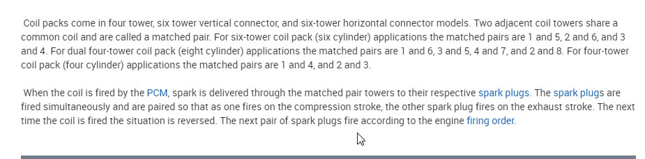

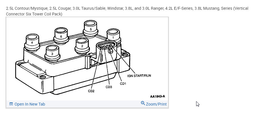

Sorry just posted this and then saw the videos. That thing is running pretty rough and that thing is red hot so you weren't exaggerating. I am surprised there are no codes.
However, now that I have seen that, your issue could be one of a couple things. First is a misfire so we need to suspect that coil.

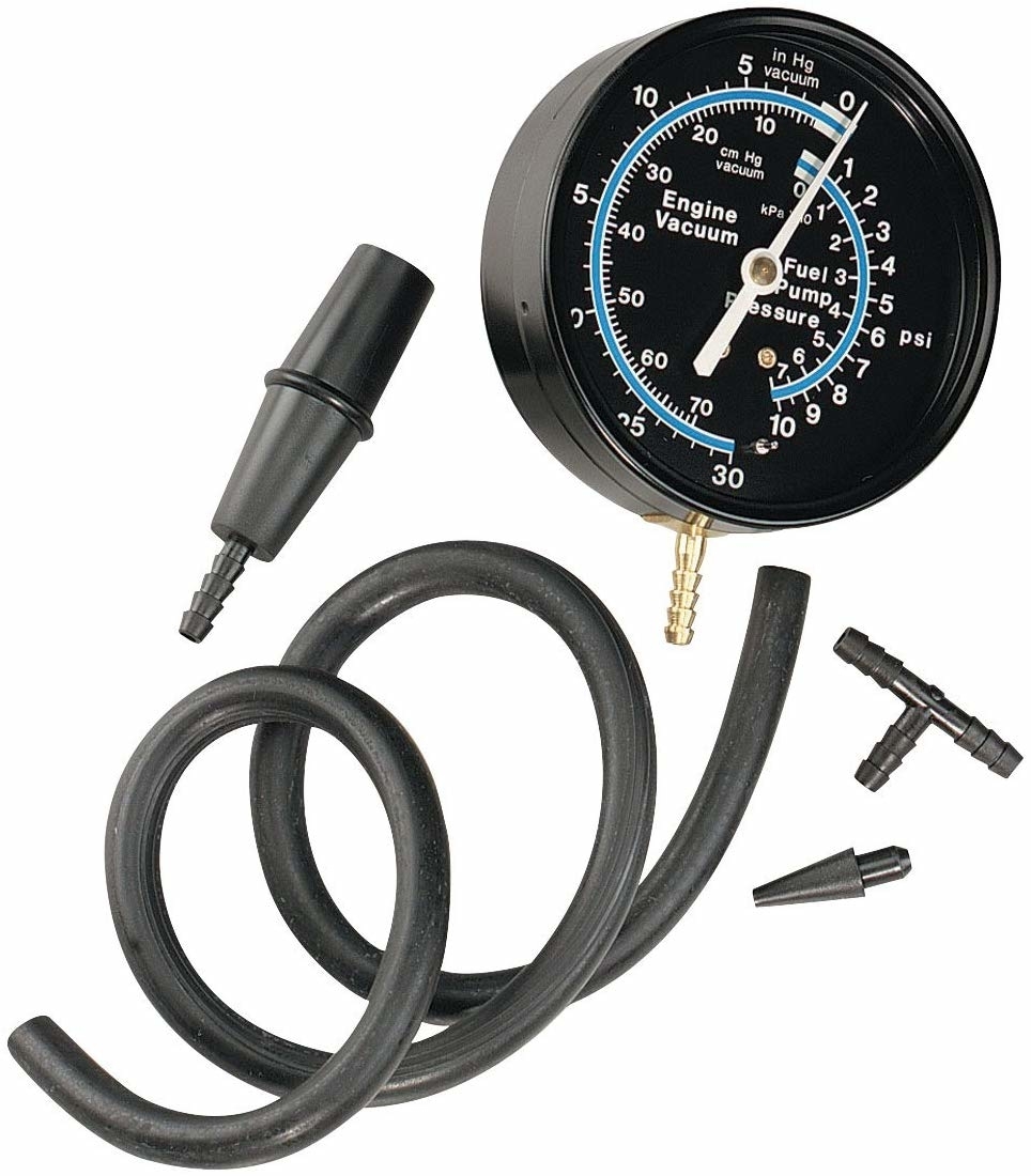

You would be measuring the pressures in the exhaust system. An open unplugged system should have close to zero psi across the rpm range. A partially plugged system will show pressure that increases rapidly with RPM. A misfire will dump extra fuel into the exhaust and if the system is plugged that alone will cause misfires as the exhaust cannot get out of the engine and the new fuel doesn't burn very well. However a blockage past the converters is a real possibility. That location would let the extra fuel from the misfires get into the converter and ignite and it wouldn't mess up the O2 readings real bad as long as there was some flow. If there is a flange between the front converter and the rear you could split the exhaust there and see if it runs better. This entire thing could be nothing but a bad muffler or converter.

What do I use to test for pressure and could it be the EGR valve maybe?
Sunday, February 2nd, 2020 AT 5:55 PM
STEVE W.
  • 15,694 POSTS
The pressure testing uses nothing special, just a simple fuel pressure vacuum test gauge.
