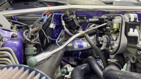

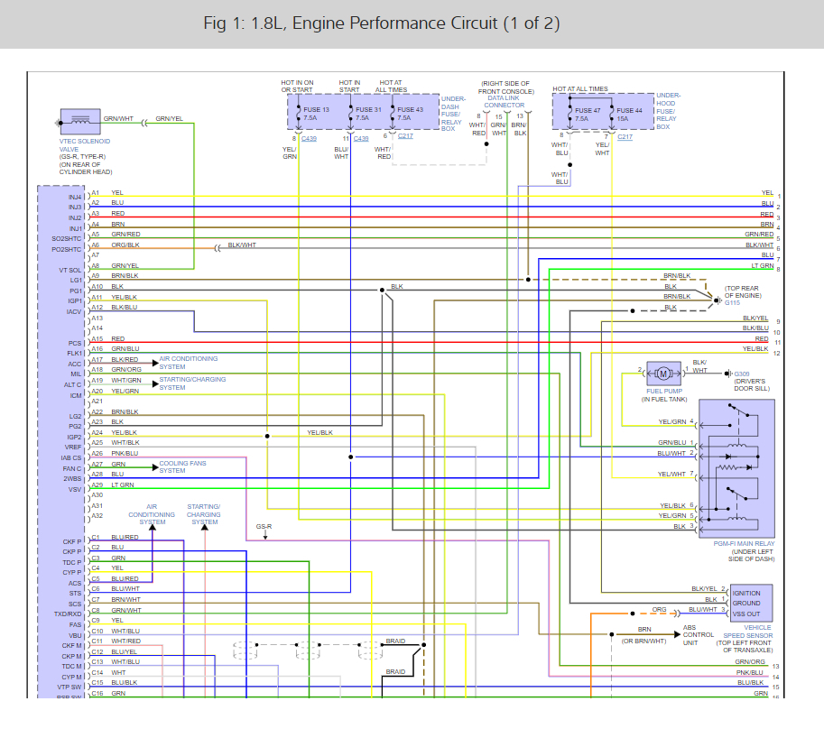

The vehicle listed above is a GSR with JDM B18C swap, supercharged, running Hondata S300 w/ ID 1000cc fuel injectors, Walbro 255lph fuel pump. The car was running terrific, I washed it and pulled it into the garage to polish it I went to turn it around and now it won't start.
**The car did have an alarm (Python650) installed when the problem occurred. The alarm was working fine but several people pointed to it being an issue, so it has since been removed. All associated wires, relays, triggers, sensors and modules have been removed. The factory harness has been restored to the original connections-however the same problem persists.
The problem: the car will crank quite strongly, but the fuel pump is not priming. (The pump works when jumped via +12v test)
Battery is on a tender and healthy, but just in case I brought it to AutoZone for a load test, which it passed.
The main relay (PGM-FI) is not clicking in any position on the key/ignition switch however the main relay is working outside of the car when bench tested. (I have since replaced it with two new main relays but neither worked)
All related fuses have been checked for continuity (and all visible fuses in general) Fuse under hood -FI E/M 15A, not blown, has continuity. Fuse drivers kick panel - FUEL PUMP (SRS UNIT) 15A, not blown, has continuity.
Plugged in laptop to the ECU via USB (hondata) and it reads driver offline so its not working or seeing the ECU/ECM.
Next, I removed the Hondata OB1ECU (P30) w/conversion harness and plugged in the OBD2A ECU (P73) from the original B18C(motor) swap. The same issue still persists, car cranks - won't start - no fuel pressure.
Next, I checked the Clutch Interlock switch. When the clutch is pressed and the key is switched, the car will try to start it, it cranks quite well, but it won't start. When the clutch is let out and key is switched on, the car goes limp. The switch works and I don't think it's related to this issue.
Test fuel pump with (+) jump on yellow green wire at fuel pump. - Good pressure builds to 57PSI.
Test fuel pump with (+) jump on yellow green wire at main relay. - Good pressure builds to 57PSI.
Test ECM (PIn 11 +25 yellow/black wires, IGP1 + IGP2. No power to either)
Main relay still does not click on ACI and ACII positions.
Check Ignition Switch
white wire = 12v+ constant
white/black wire =12v+ accessory switch to position 1
yellow wire = 12v+ accessory switch to position 2
black/yellow wire = 12v+ accessory switch to position 2
When trying to start the car the check engine light illuminates but does not go out.
I have a multimeter and the tools, but I'm not sure how to diagnose from here.

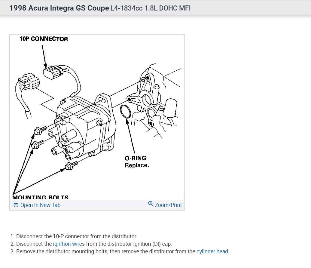

So, if the computer does not see the engine crank over via the crankshaft sensor which is inside the distributor it will not turn the fuel pump on. I would remove the distributor cap and dry it out, maybe leave the cap off for a day to completely dry. Does the engine have spark, this video can help you test for spark.
https://youtu.be/baq_aEWNQ0Y
This guide can help as well:
https://www.2carpros.com/articles/car-not-running-advanced

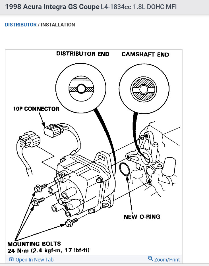

Also, while the cap is off look for rust colored dust which is a sign the distributor needs to be replaced. I would get a rebuilt unit here is how to replace it just in case.
Check out the images (below). Please let us know what you find. We are interested to see what it is.

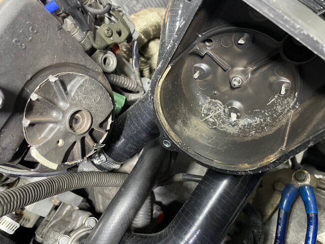

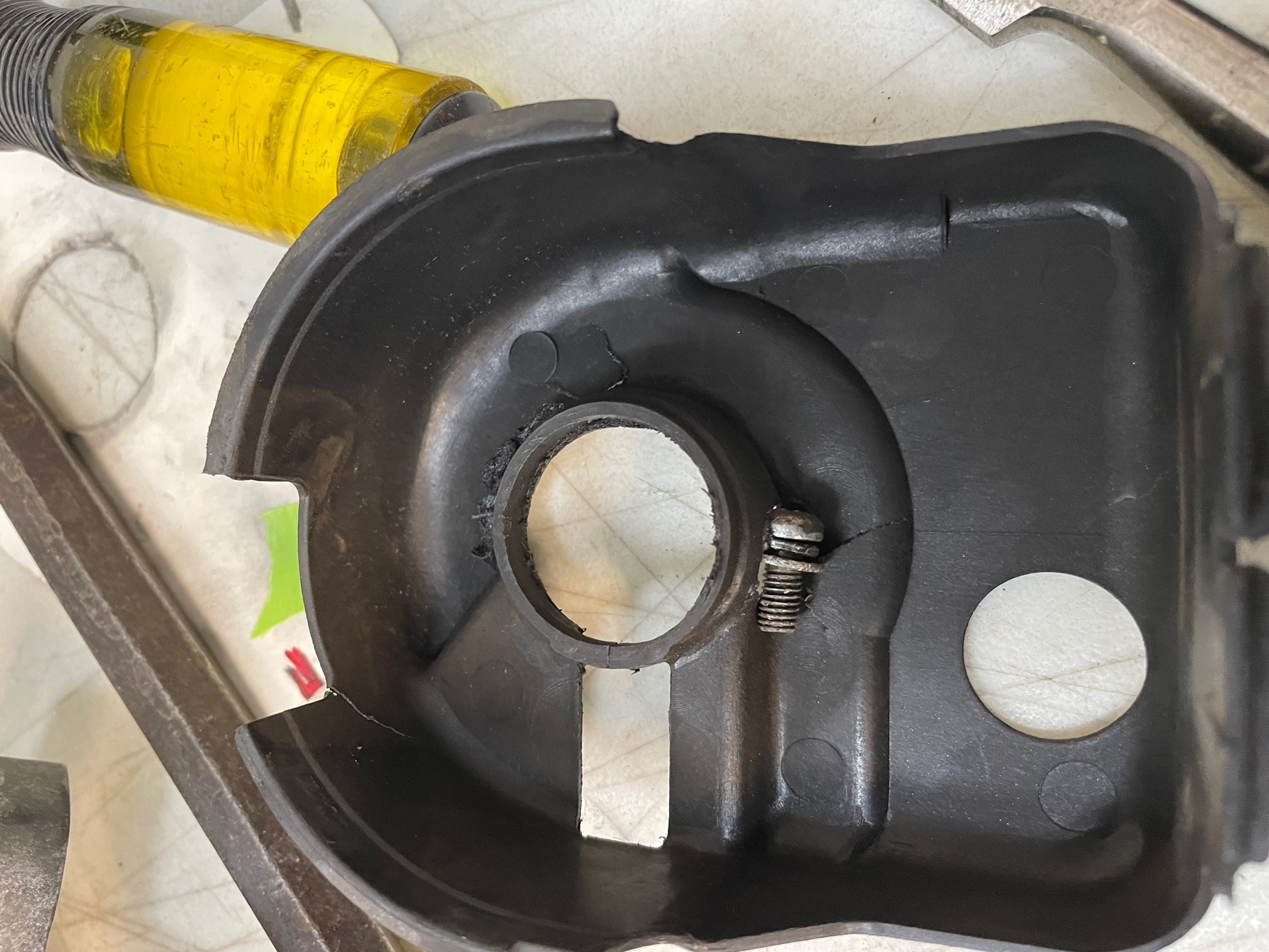

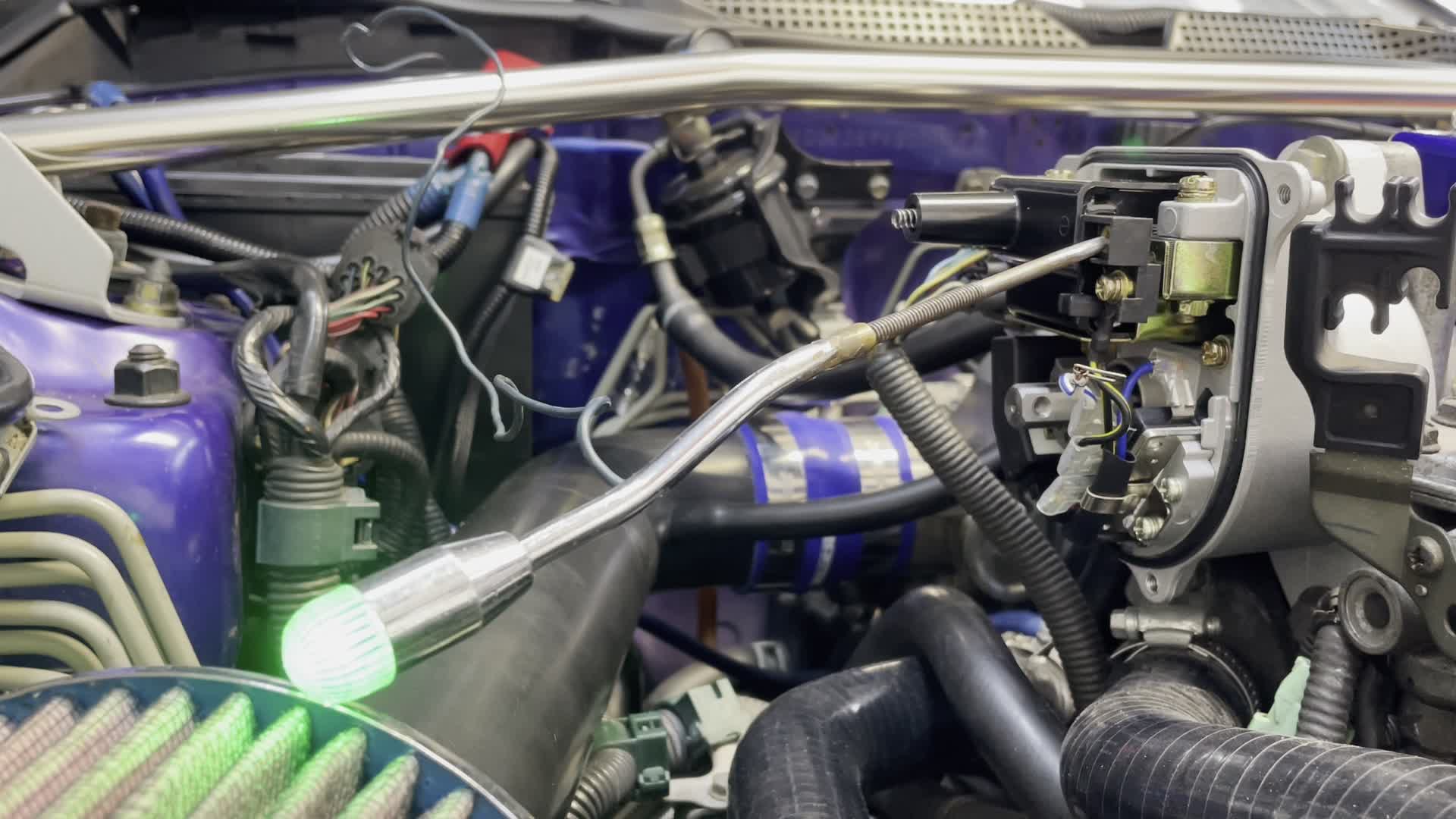

Hey Ken, thanks for taking the time to answer. I started to follow your advice by taking the cap off of the distributor, glad to see it was bone dry and the gasket worked, however it appears the rotor destroyed itself and the cap (see pic below). There was no screw in the rotor and it's also not coming out with force. I'm going to see if I can get the rotor free today and will replace that and the cap, then perform the spark tests listed above. I will update with progress when I have made some. Thank you so much!
Tuesday, October 11th, 2022 AT 6:42 AM
KEN L
  • MASTER CERTIFIED MECHANIC
  • 55,281 POSTS
Yep, that will do it, let me know how it goes.

Hello again Ken, I replaced the entire distributor (since the old one may have been damaged when the rotor screw came off and shredded the internals of the cap) with a remanufactured unit. The car still won't start. No spark is being generated from the spark plugs (only tested cylinder 1), and also tested for spark where the wires connect to the distributor cap. Still no clicking from the Main Relay, fuel pump does not prime with key switch. What would you suggest next?

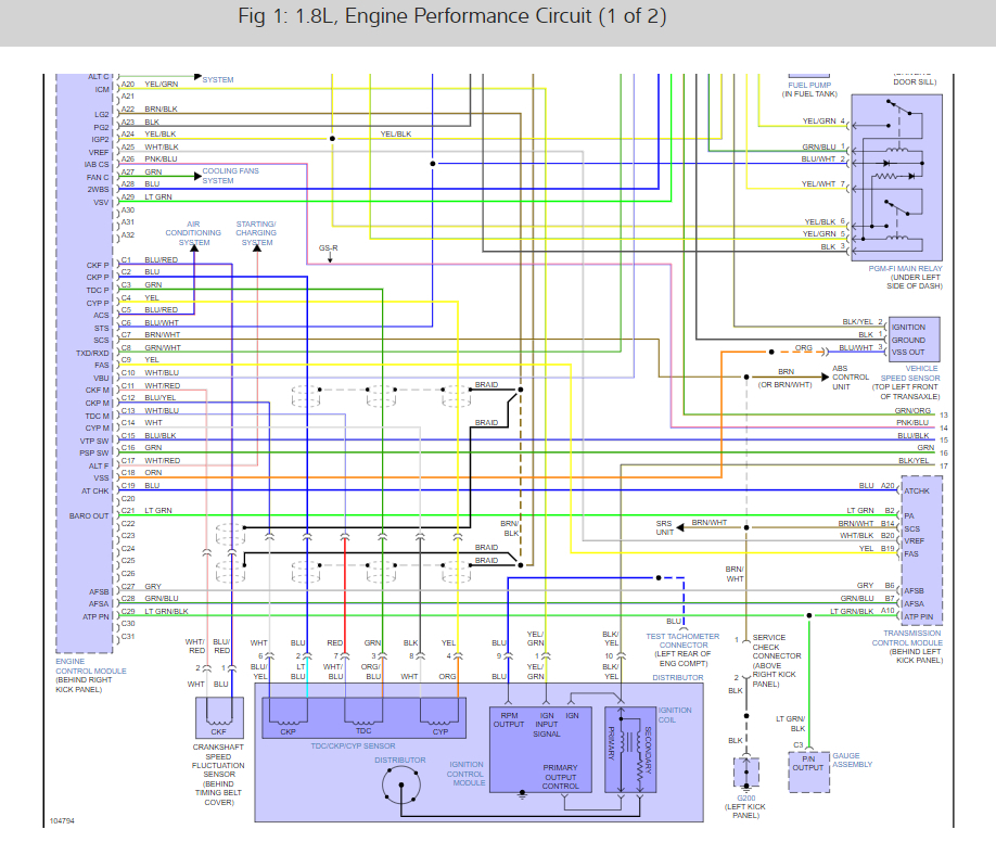

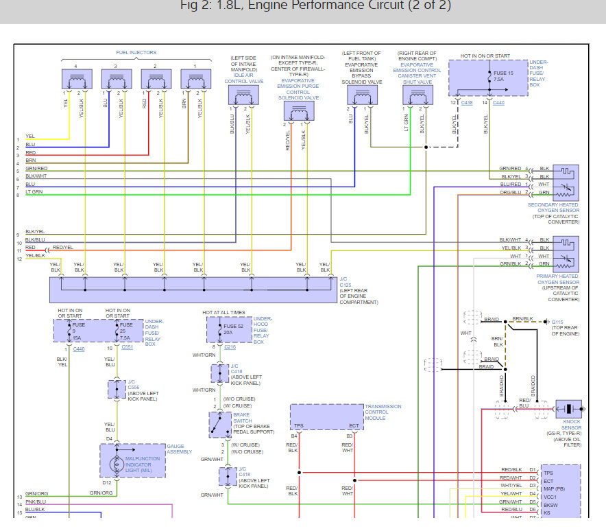

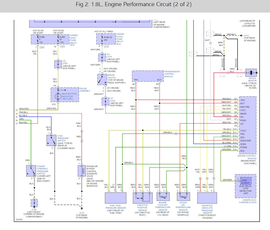

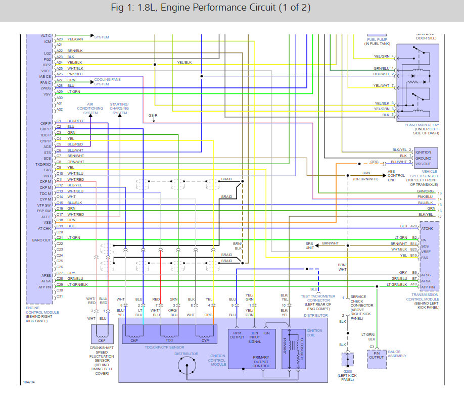

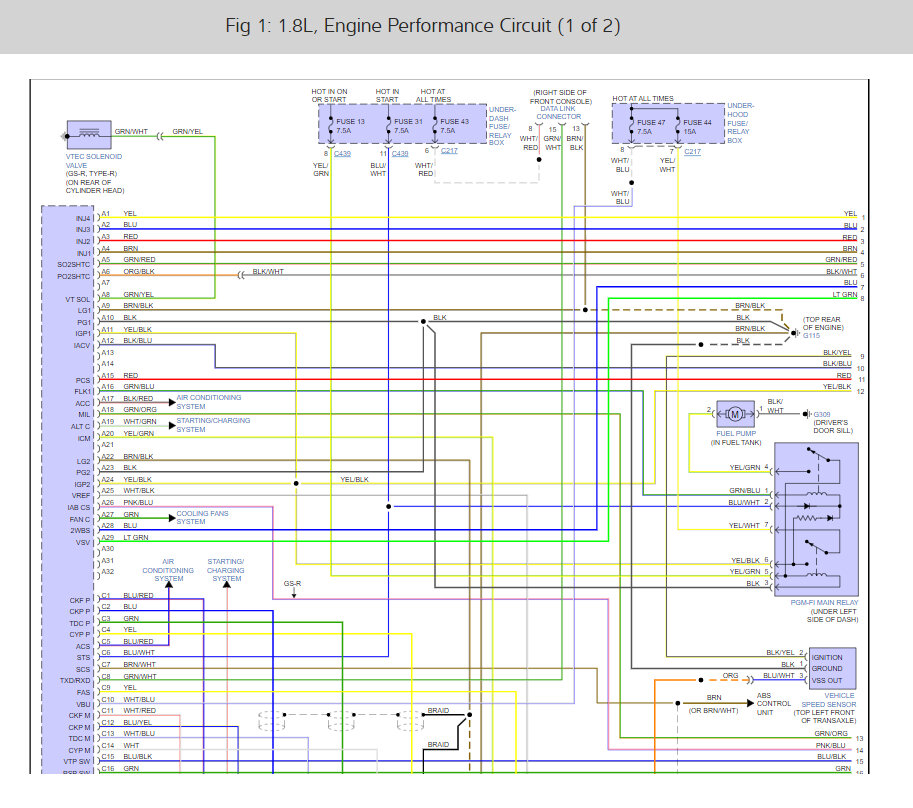

With the key on do you have power on the positive side of the coil?
Also, we should check the fuses that run the system for power as well, here are the PCM and engine wiring diagrams so you can see how the system works and which fuses to check:
Saturday, October 22nd, 2022 AT 1:24 PM
MIKESCARWONTSTART
  • 7 POSTS
Yes, with the key on there is power (12.77v) to the positive side of the coil.
The primary coil resistance reads.9ohms and the secondary is 15.5k ohms.
When testing the ICM to coil for power, there is power on ACC1 but none on ACC2.
All fuses have been double checked and are good.

Thanks for the video. The engine sounds okay, if the positive side of the coil is getting power and the negative side doesn't flash the distributor is bad or the coil is shorted out. The distributor is defective.
