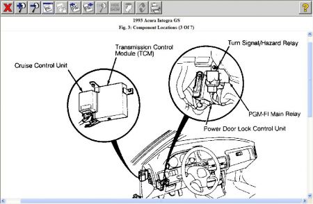

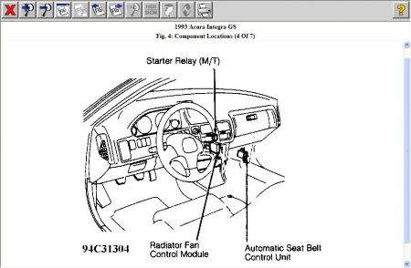

If so can you help me locate it? Acura parts describes it as three inches in length and four bolted under dash on drivers side. However a discount auto parts guy tells me no, no it is much smaller and held by one bolt through a bracket on the passenger side. Help me please. Saailer

Main relay and starter relay are two different things. Starter non cranking is not related to PGM-FI main relay.
https://www.2carpros.com/forum/automotive_pictures/192750_StarterRelay99Integra_1.jpg
https://www.2carpros.com/forum/automotive_pictures/192750_PGMFIRelay93Integra_3.jpg" alt="
https://www.2carpros.com/forum/automotive_pictures/192750_PGMFIRelay93Integra_3.jpg" />
The starter relay could be the problem but we need to verify the problem.

I am inclined to agree it is the ignition switch/lock. It is $294.83 at discount auto. Would prefer to try starter relay. I am not quite clear where starter relay is located. Is diagram pointing under the dash? Can you describe relay or better yet offer a part number? Hate to be a pest but physical description/or part number is a necessity at dealership.

As for the relay, I am sorry I could not find any close-up pictures to show you. It is the normal four pin relay that is common with the headlight or fan relays. You can try swapping them instead getting a replacement part. Try swapping with the head light relays, they could be easily removed and if the relay is bad, at least it would not affect any important engine functional components.
