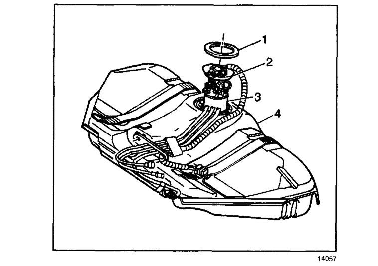

CHARISE LANDRY
It has spark but fuel pressure is low. So how do I know is if it's the fuel pump or fuel filter?
Wednesday, January 27th, 2021 AT 6:25 PM (Merged)
  • 52,797 POSTS
The filter will not change the pressure. it has a bypass in the filter itself.
if the pressure is low, it is the fuel pump.
https://www.2carpros.com/articles/how-to-replace-an-electric-fuel-pump
CHARISE LANDRY
Is this for a 2002 Malibu?
  • 52,797 POSTS
That is correct. The picture is for your car.
procedure
1. Remove the fuel tank (4).
IMPORTANT:
The modular fuel sender assembly may spring up from position.
When removing the modular fuel sender assembly from the fuel tank, be aware that the reservoir bucket is full of fuel. The reservoir must be tipped slightly during removal to avoid damage to the float. Discard the fuel sender seal and replace the seal with a new one.
Carefully discard the reservoir fuel into an approved container.
2. Press down and rotate the cam lock ring (1) until free of the fuel sender retaining tabs.
3. Remove the modular fuel sender assembly.
4. Remove the fuel level sensor.
-1
