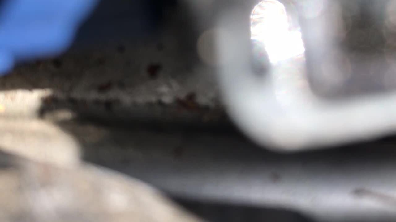

Thanks for responding. Spark plug is firing, although not as strong as I am use to seeing but these platinum plugs have very slender electrodes so I believe thats ok. Used starter fluid and no change. I could tell by the fuel pump running and the plug that it is getting gas. I have attached video of engine being cranked like you asked. If you have a problem listening to it I will try to send it a different way.
Thursday, February 23rd, 2023 AT 10:59 AM
  • 110,194 POSTS
The cranking sounds normal, which is a good thing. If there was no change, with the starting fluid, then it has to be related to the ignition spark. You indicated it wasn't what you expected. Was it a good blue snapping spark? Also, were the plugs wet with fuel when you removed them?

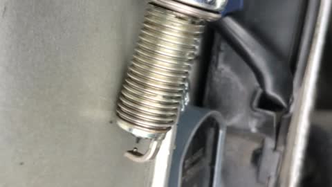

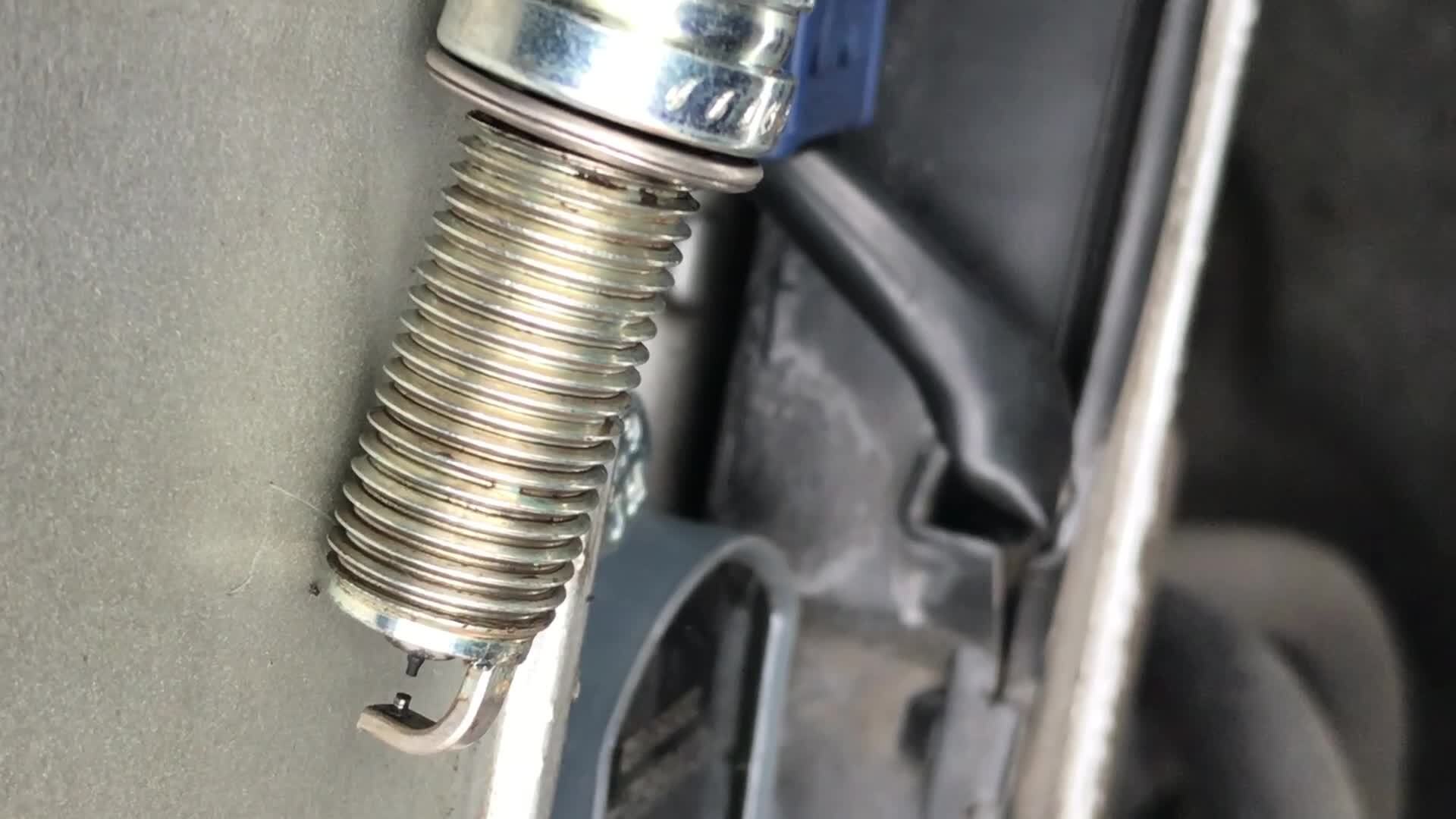

Attached is a video of plug firing, all 4 plugs fired when tested.
Two plugs were wet and all four smelled strong of gas.

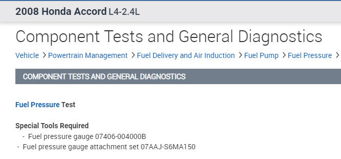

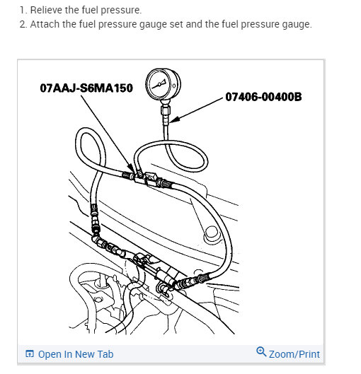

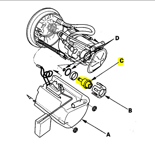

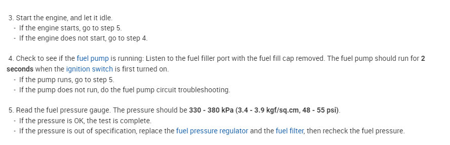

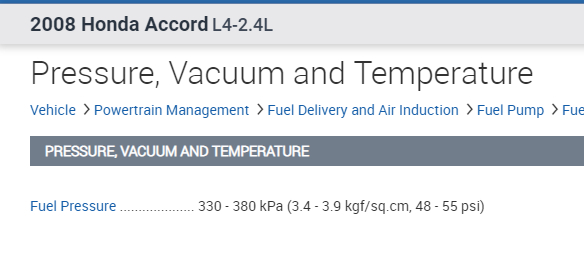

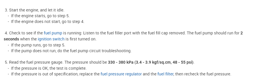

If the plugs were wet, we need to check the fuel pressure. You may have a faulty pressure regulator or even a faulty coolant temperature sensor. By any chance, do you have a live data scan tool? If you do, check the engine coolant temperature sensor signal to see if it makes sense. For example, if it is 90 degrees outside, it shouldn't read -40 degrees. LOL
Here is a link that explains in general how to test fuel pressure:

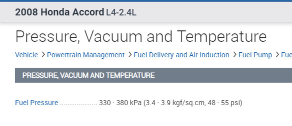

If you look below, I attached the directions specific to this vehicle. If the regulator is bad and the fuel pressure is too high, we need to replace the regulator, which is in the fuel tank and part of the pump assembly.
Pic 4 shows the regulator and pic 5 provides the manufacturer's pressure specifications.
Let me know what you find. It sounds like it may be flooding itself.

ECT was 48 degrees at 9AM and outside temperature was 62 degrees. Fuel pressure was 43 and 44 psi (44 three times). Pulled No 1 plug and was wet. Pulled pump fuse, used starting fluid and nothing. This engine is not even coming close to starting. Could the crankshaft position sensor be firing spark plug at the wrong time? I have been told that if the spark plug fires at all the sensor is good, but it makes sense to me that it could fire at the wrong time. Again thanks for your time.

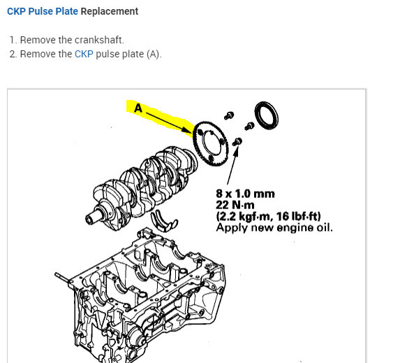

The compression looks great, so chances are the timing is okay. To answer your question, yes it could affect timing if something is damaged or loose. Also, there is a pulse plate that may be damaged or loose. That will cause a timing issue. Take a look at pic 1 below.
Let me know your thoughts.
joe
See pic below.
