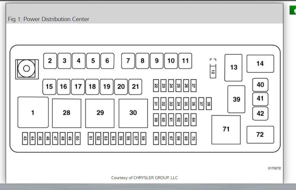

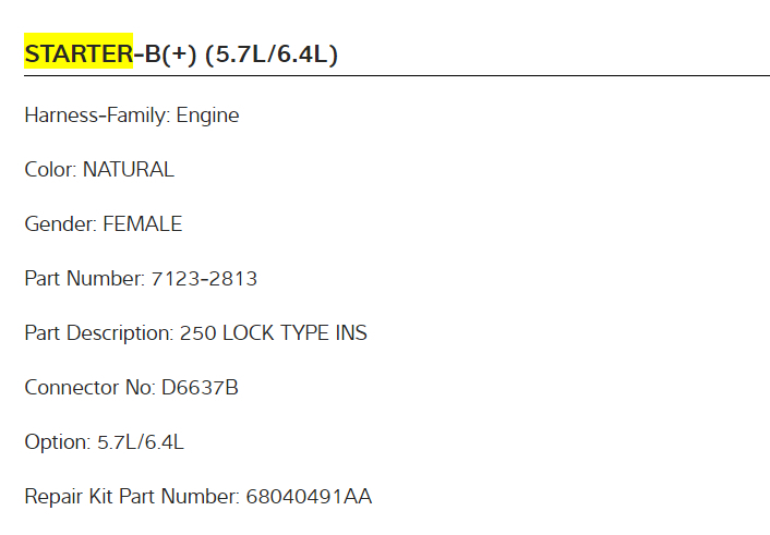

I have a rt 5.7 hemi. My car will not crank. I tried to start it over and over and nothing happened. I replaced the starter so it is brand new, the battery tested 100% good, and the alternator tested good. When I start the car I hear the fuel pump moving and all the lights come on as normal but the car will not crank and start up. Please help
May 10, 2019 at 5:57 AM
SCGRANTURISMO
  • CAR REPAIR CONTRIBUTOR
  • 4,897 POSTS

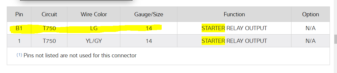

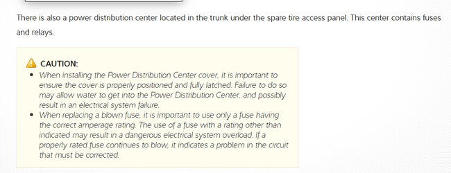

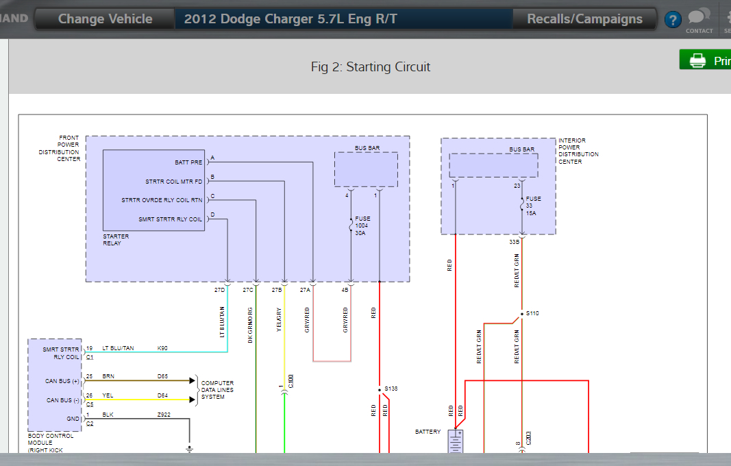

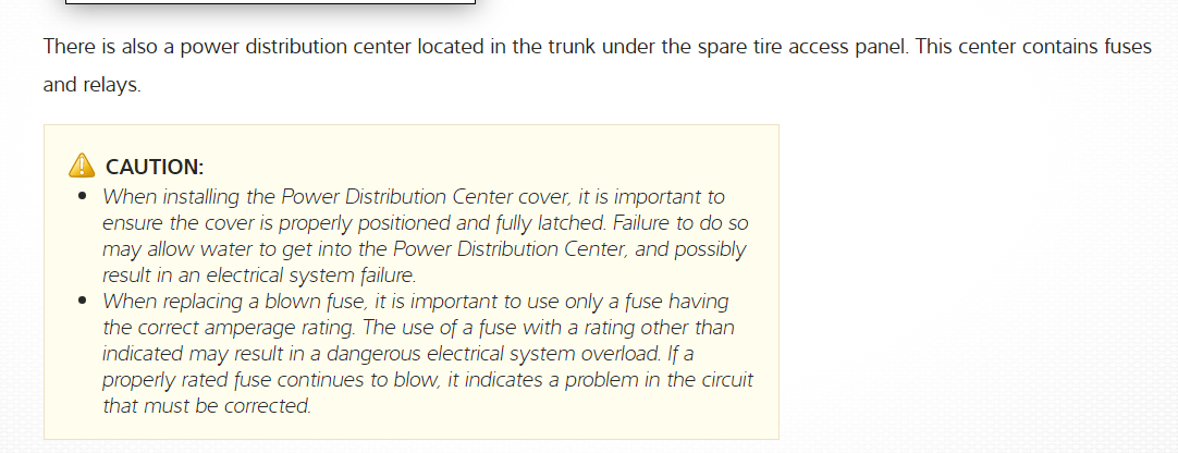

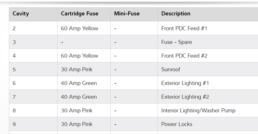

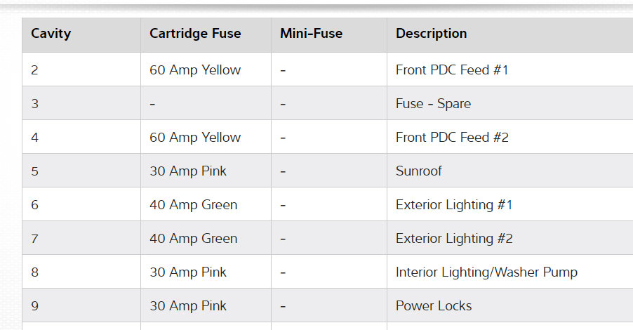

This could be a problem with fuse #33 in the Interior Power Distribution Center. It is located in the trunk under the spare tire access panel. This fuse is responsible for protecting the starting circuit. I have included a couple of links down below for you to go to:

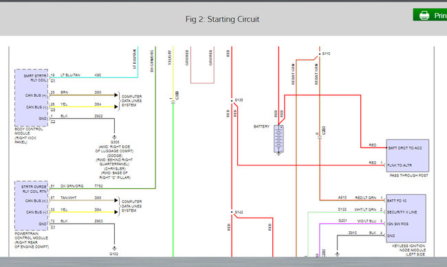

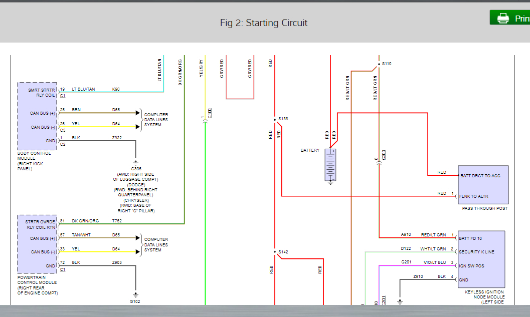

I have also included a wiring diagram of your vehicle's starting system and a diagram of the Interior Power Distribution Center in the diagrams down below. Please go through these guides and get back to us with what you are able to find out.

Hello Alex,
I checked the fuse #33 ignition switch/wireless module and it tested good. I switched it to a brand new fuse anyway but I am still unable to get my car started.

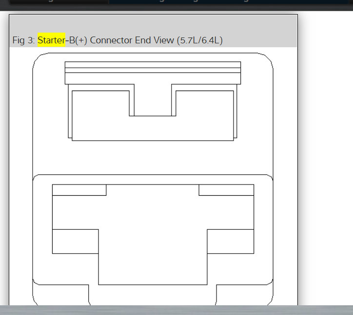

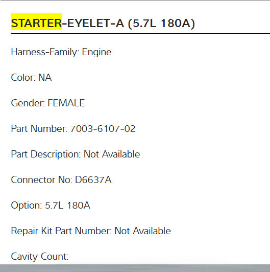

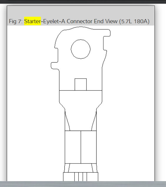

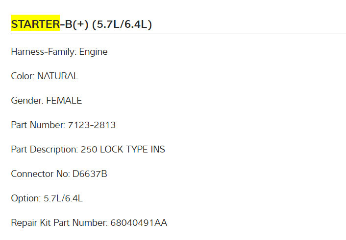

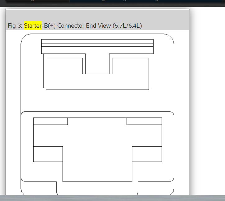

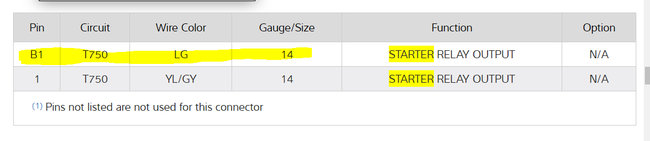

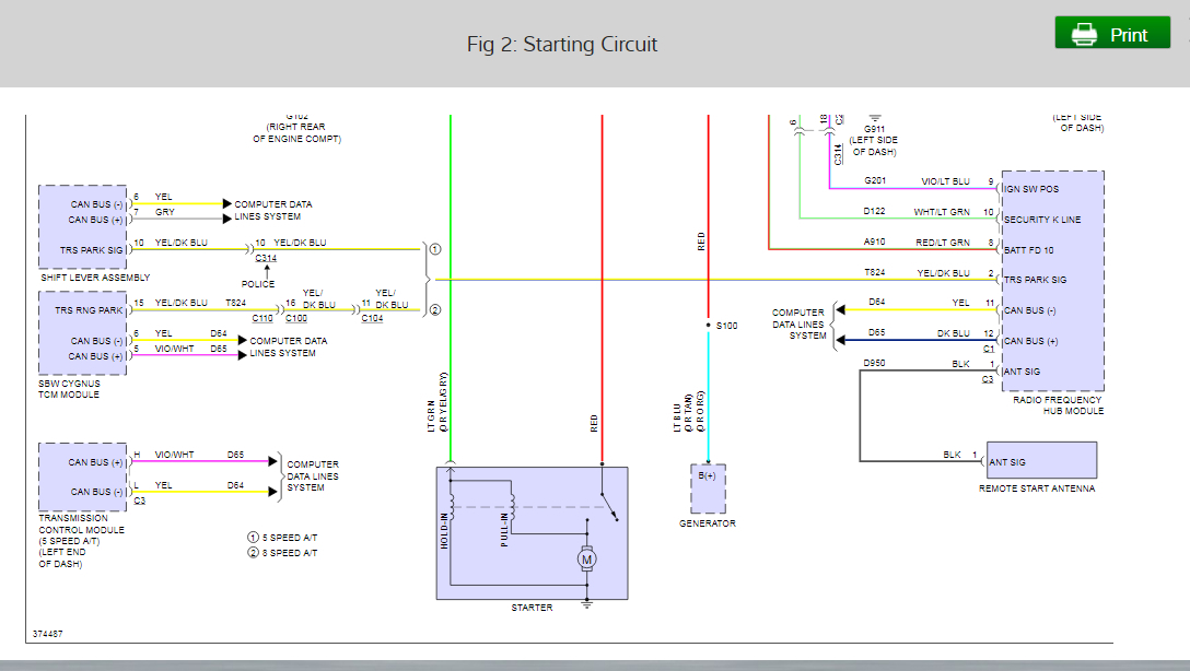

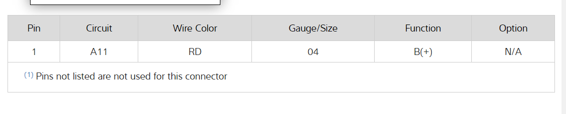

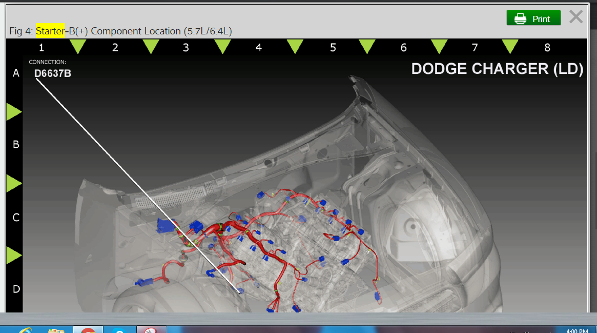

Okay, let's both look at this together. You have the wiring diagram of your vehicle starting system that I sent you. So let's start working our way from the starter back to the battery since the easy didn't work.. This is a process of elimination, so bear with us. I have included a few links for you to go to below:
You will need an assistant to help you with this. We want to take a voltage reading at the light green wire of the starter connector with an assistant cranking the engine. Please ensure that the vehicle is in park with the emergency brake on. Please get back to us with this reading. I have included more diagrams in the diagrams below.

Battery tested 12.15 starter tested 12.02. I am also hearing a high pitched humming sound come from the engine when I try to crank it for about ten seconds then it cuts off.

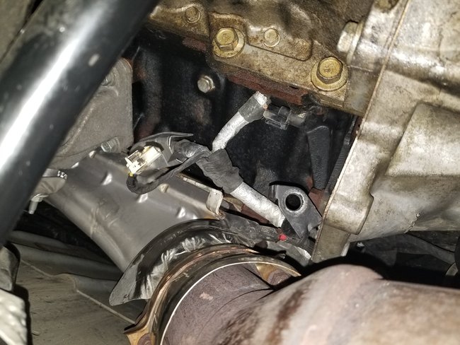

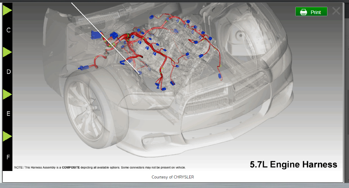

I got my starter tested and it tested good. The readings on the power cable to the starter was 12.09. The reading to the switch was 11.72, and the reading for the battery was 12.12. Just an update on the progress. I started the car and it sounded like the starter was going to kick in then it gave out again. I didn't see any corrosion on the ground cable. This is what the cables are looking like.
Jun 29, 2021 at 9:13 AM
HASAN JOHNSTON
  • 11 POSTS
Underneath the engine.
