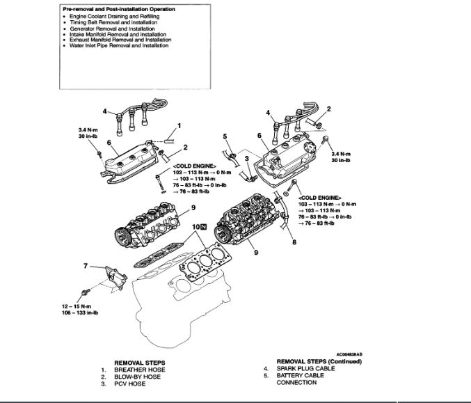

My car was overheating and stop on me. I try to turn it on but it won't start. Any suggestions?
Monday, April 29th, 2019 AT 1:27 AM
  • 52,797 POSTS
Good morning,
When this happens after overheating, it is possible the head gasket failed in the engine and water is getting into the cylinders not allowing it to start.
https://www.2carpros.com/articles/engine-overheating-or-running-hot
Has anyone checked it yet?
