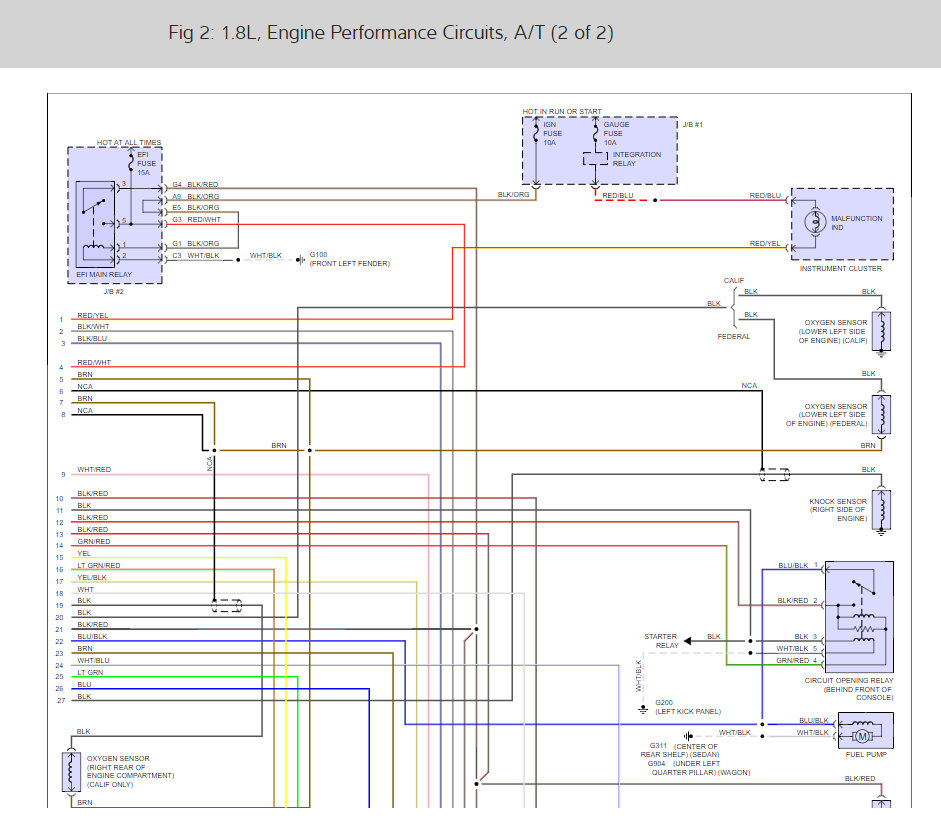

i have a 95 corolla wagon,1.8 liter,it will start up and idle ,but stalls as soon as i touch the gas .i replaced the fuel pump and filter,changed all the sensores on the engin, and the computer.any help would be great, thanks tom .

i have a '94 ....with the exact same problem. I was just on this site double checking how to change my fuel filter when i ran across your question. Has anything you've tried fixed it?
