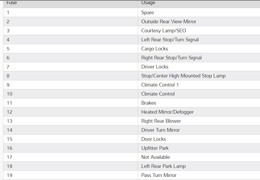

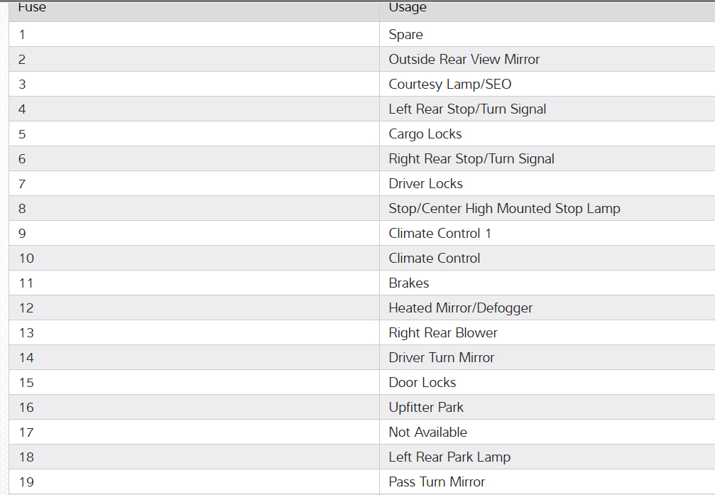

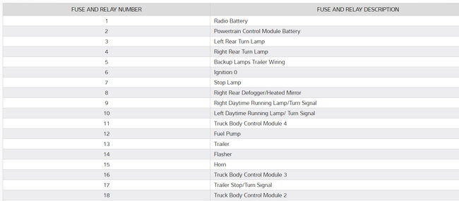

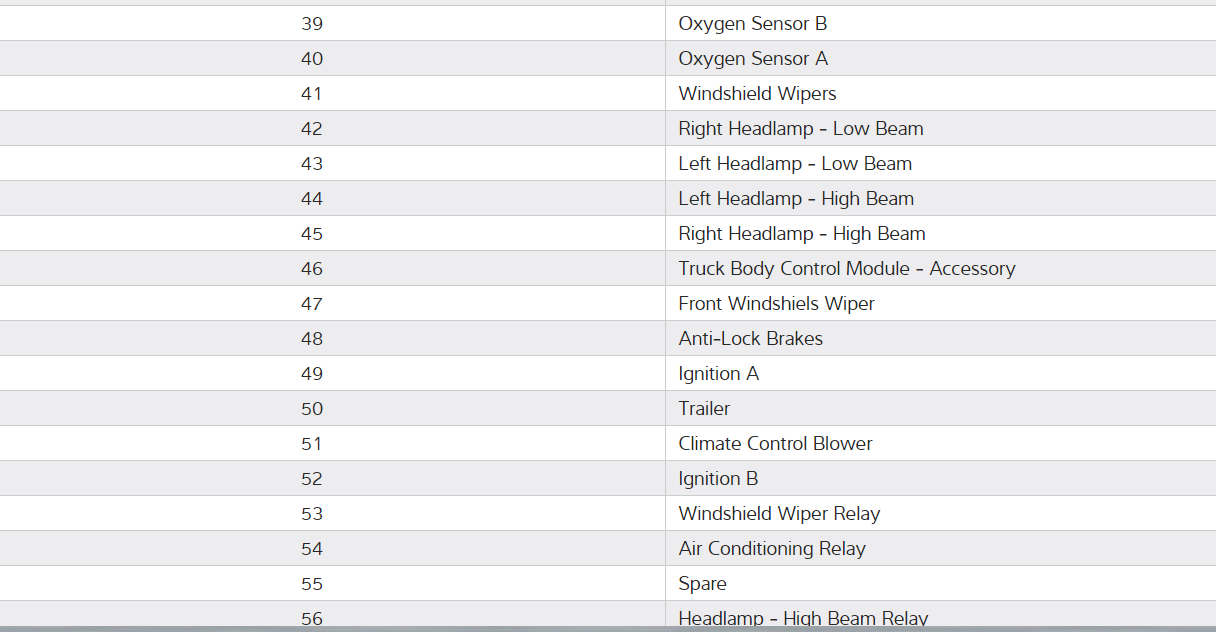

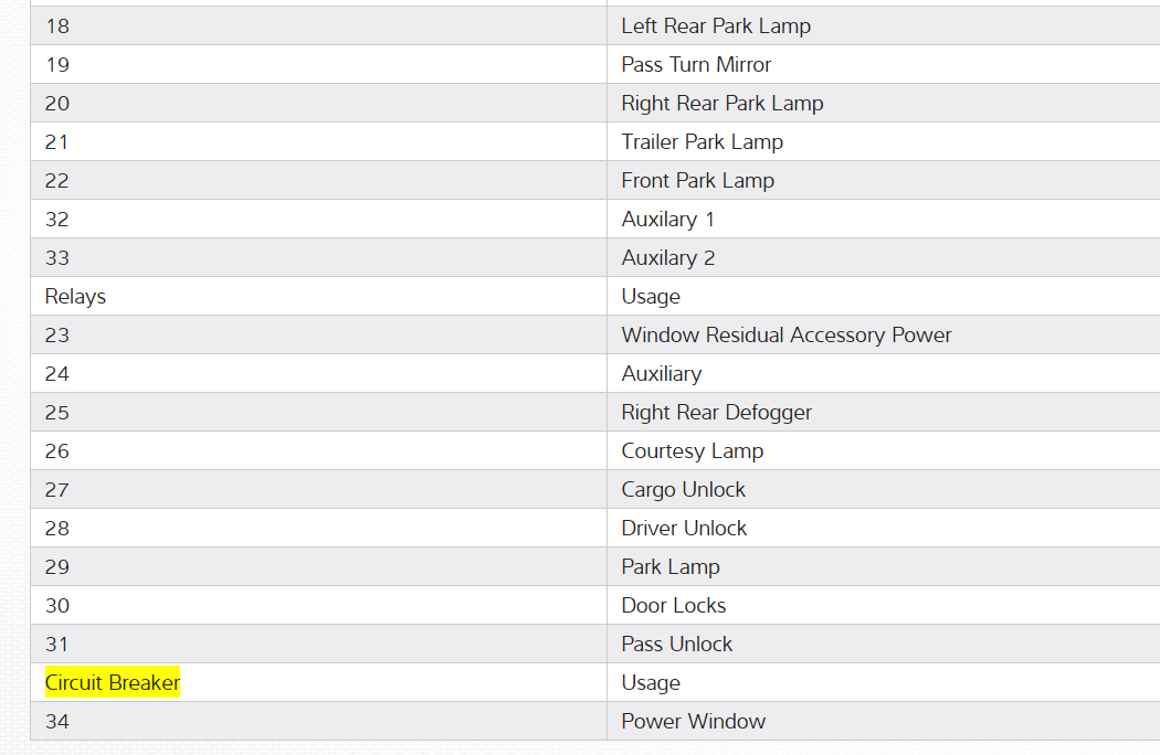

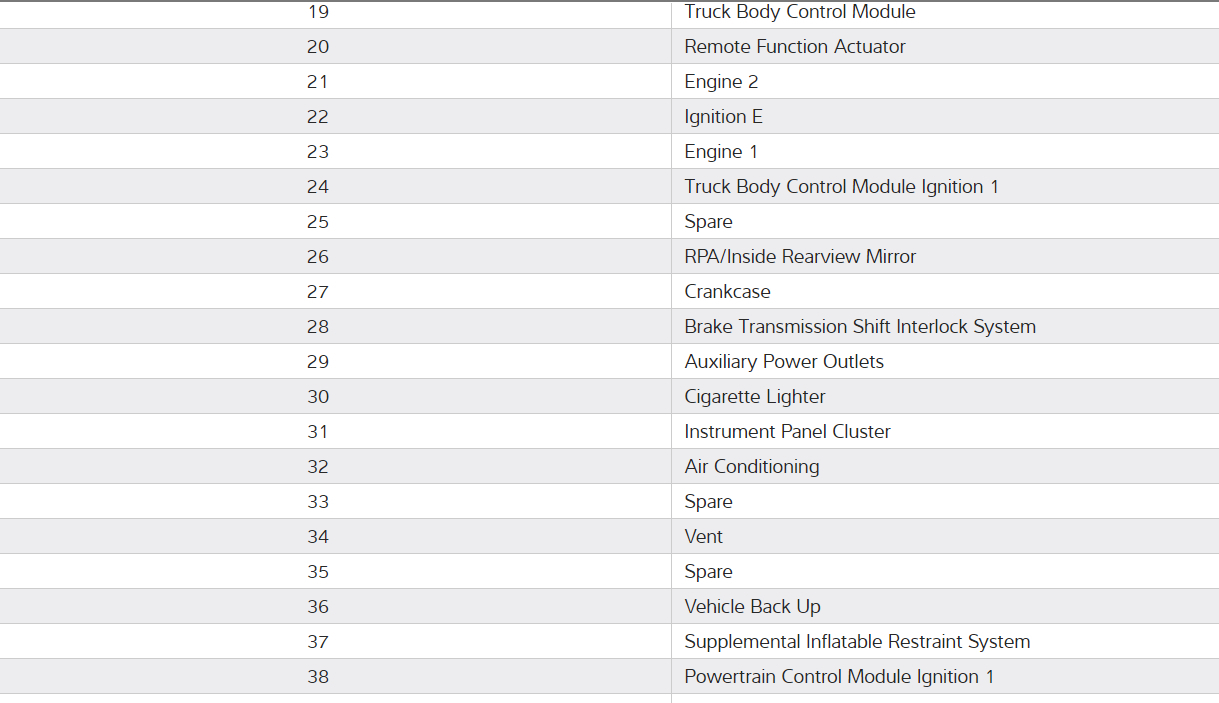

My left rear brake and turn signal not working. I check all the bulbs. Checked every fuse Left signal flashes fast. Test light flashes fast when I touch in the fuse block. Right flashes normal.

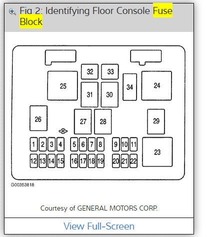

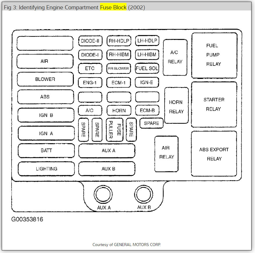

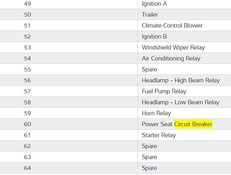

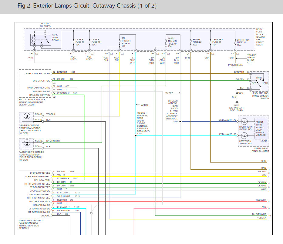

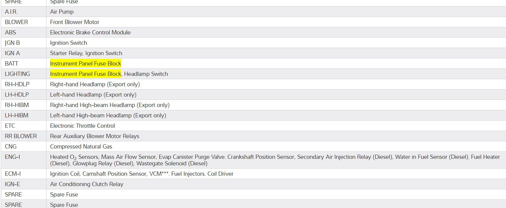

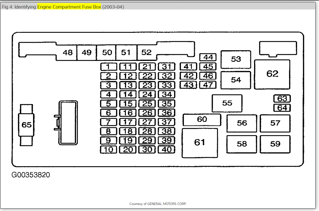

It sounds like you have lost power or ground. I would start by checking the fuses because there are several that run the system.
Check this guide as well.
https://www.2carpros.com/articles/no-tail-lights-exterior-running-lights-tail-lights-out

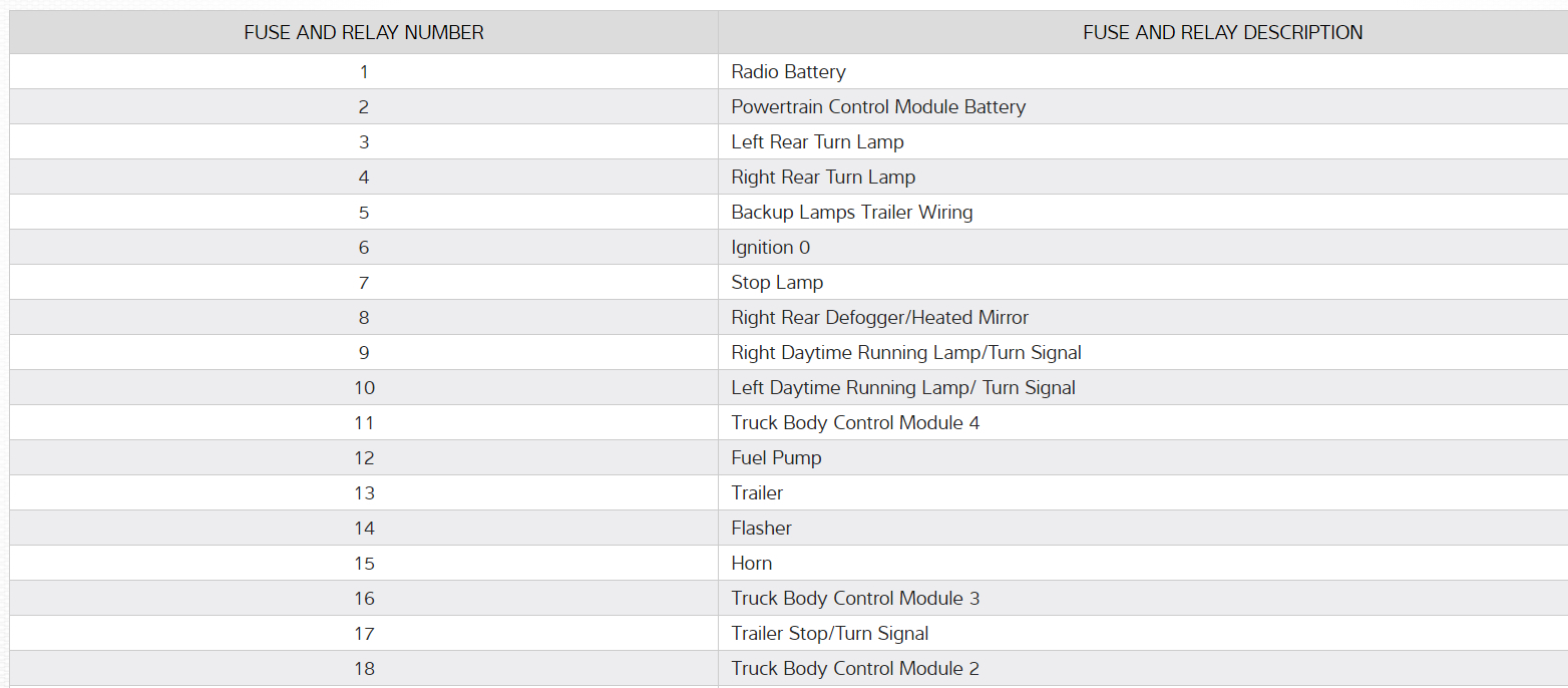

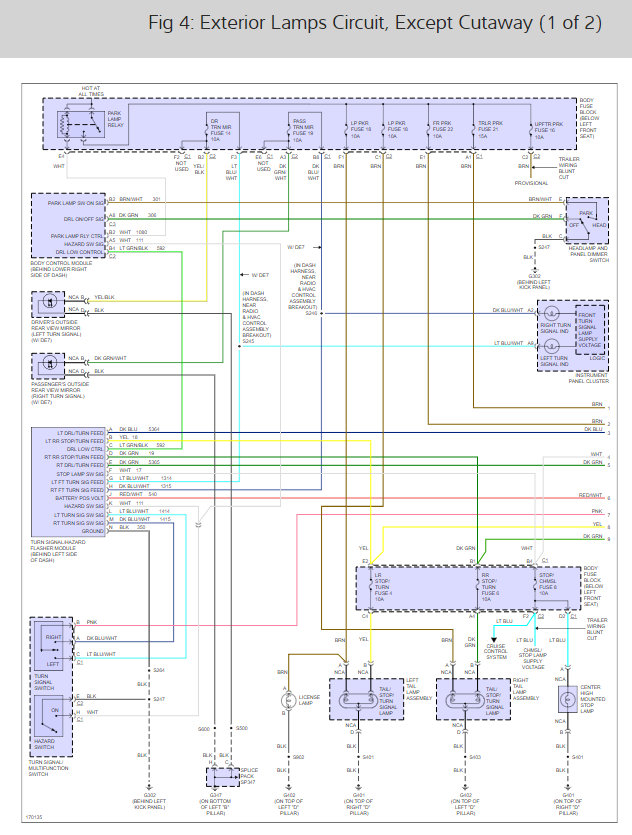

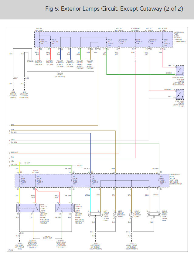

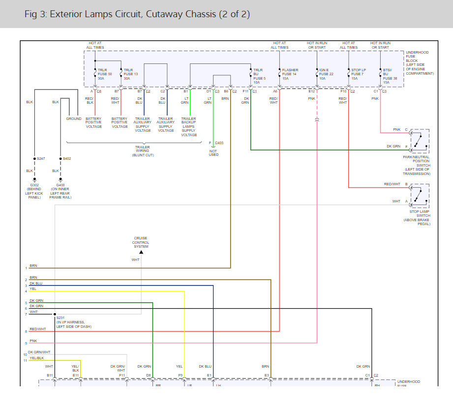

Here is the fuse locations and the brake light wiring diagrams so you can see how the system works.

I checked every fuse - okay.
I checked the bulbs- okay.
I check ground at the rear light - okay.
(I used a test light from a known power source or in this case the taillight wire to the ground and it worked)

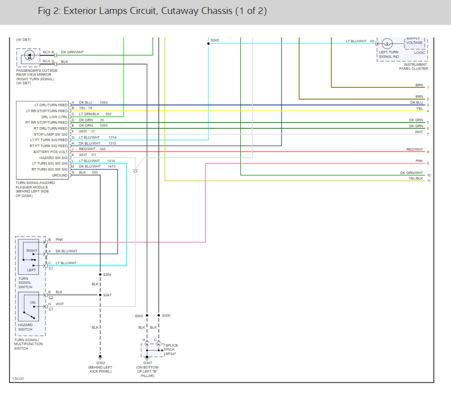

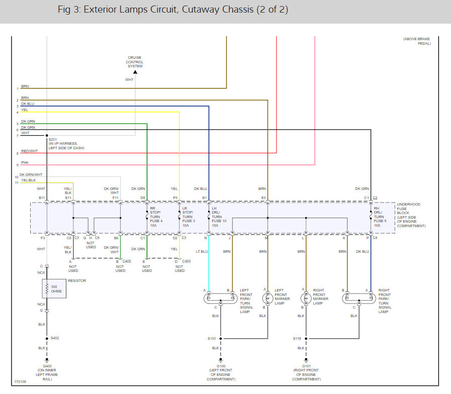

I searched for diagrams to try and determine where power originated and where it ends in relation to the flasher relay, BCM, fuse block, that I was unsuccessful. I did locate what wire came out of flasher relay, yellow wire.
I exposed the copper wire and ran a new wire from that point to the left rear brake/turn bulb as a test and another ground wire at the rear and turn signal/brake light worked correctly. So I cut the wire at the flasher relay and and ran the new wire to the rear location. At this point all lights are working correctly. Now that I have your post and these images I will look to see if by doing what I did I have bypassed anything.

Yes lets continue this problem until we fix it. It sounds like a bad ground to me lets make sure by checking the connections. here is a guide to help and the updated wiring diagrams so you can see how the system works and which grounds to check. (behind kick panel I would check first.)
