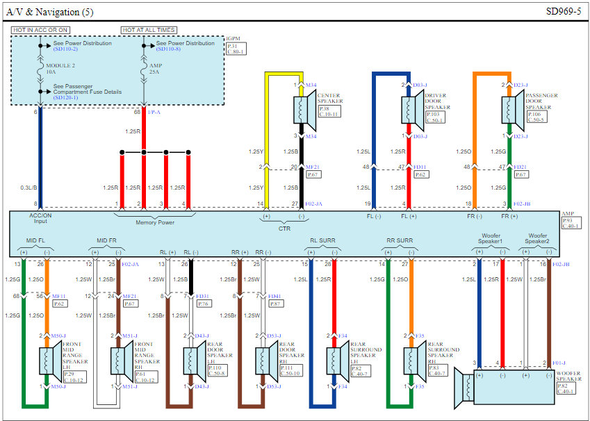

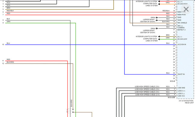

Can any one help me with the factory radio wire color diagram for car listed above FE? It has no factory amp so I’m trying to put in a converter for my subs?
Monday, July 6th, 2020 AT 12:53 PM
55 Replies
Good morning,
I found the diagram for you and posted it below.
Check out the diagrams (Below). Please let us know if you need anything else to get the problem fixed. Roy

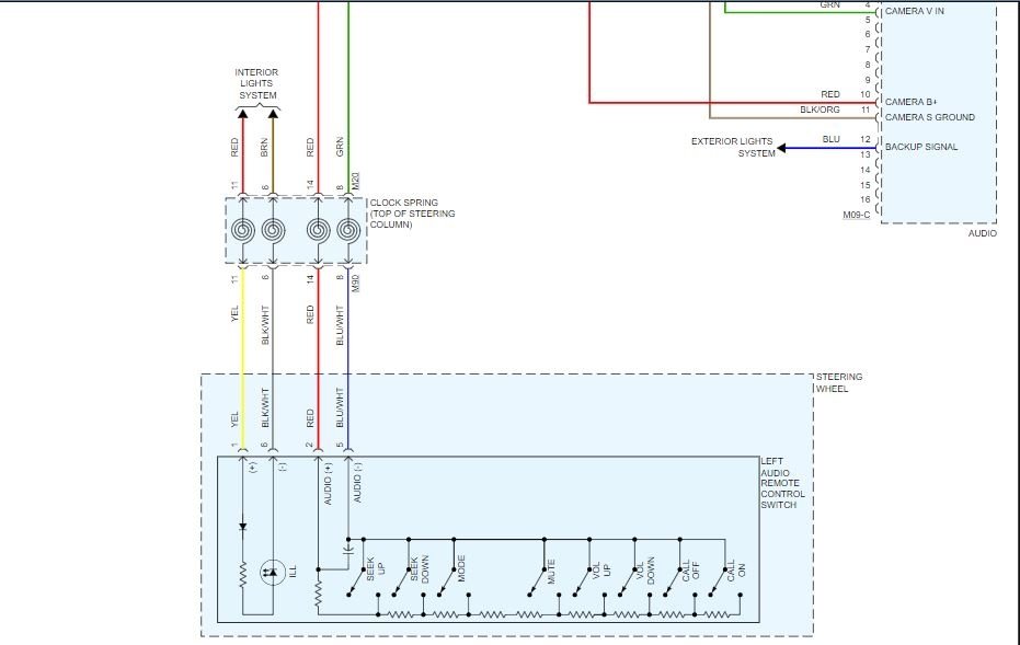

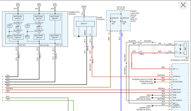

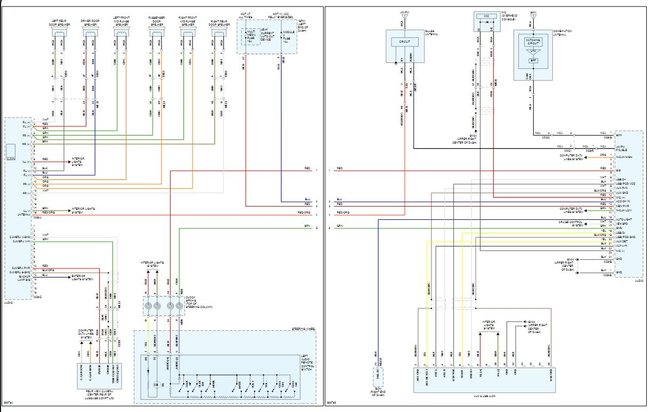

Hello, I am trying to find a wiring diagram for my 2019 Kia Optima LX+ factory stereo. Its a 7" touch screen with the back up cam, android auto but no UVO and no Nav. I have purchased an Audioconrol LC2I to run to my Amp's while keeping the functionality of my stock Radio and need to hook it up however, I'm not sure which color wires are for which set of speakers along with the accessory cable.
+1
Wednesday, March 10th, 2021 AT 7:09 PM (Merged)
  • 110,176 POSTS

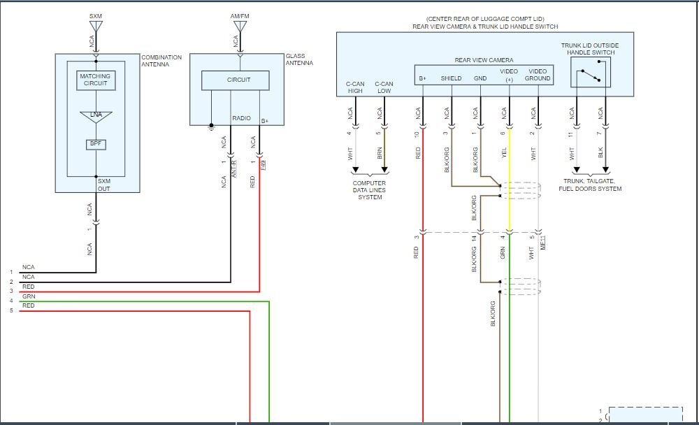

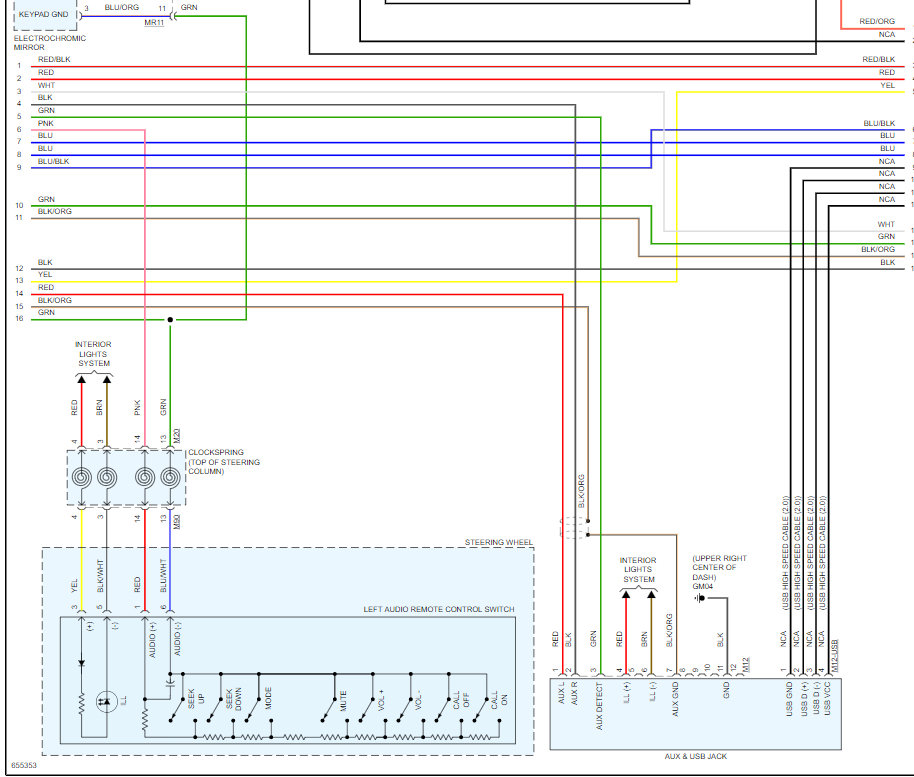

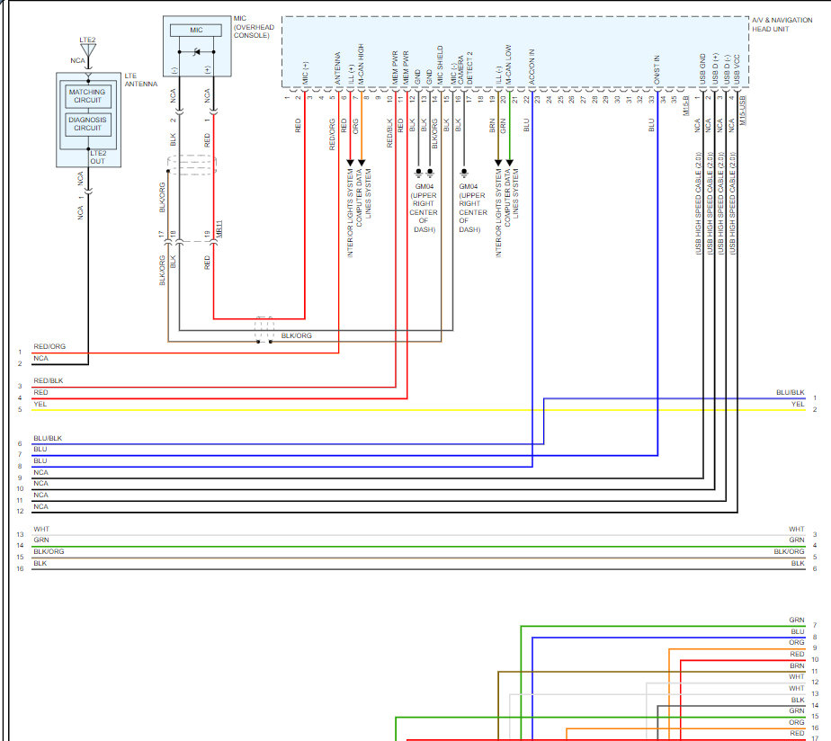

The schematic is three pages long. I had to break each page into 3 parts to make it readable for you, but I did overlap the pics so you could follow them. This is the entire system.
Let me know if this helps.

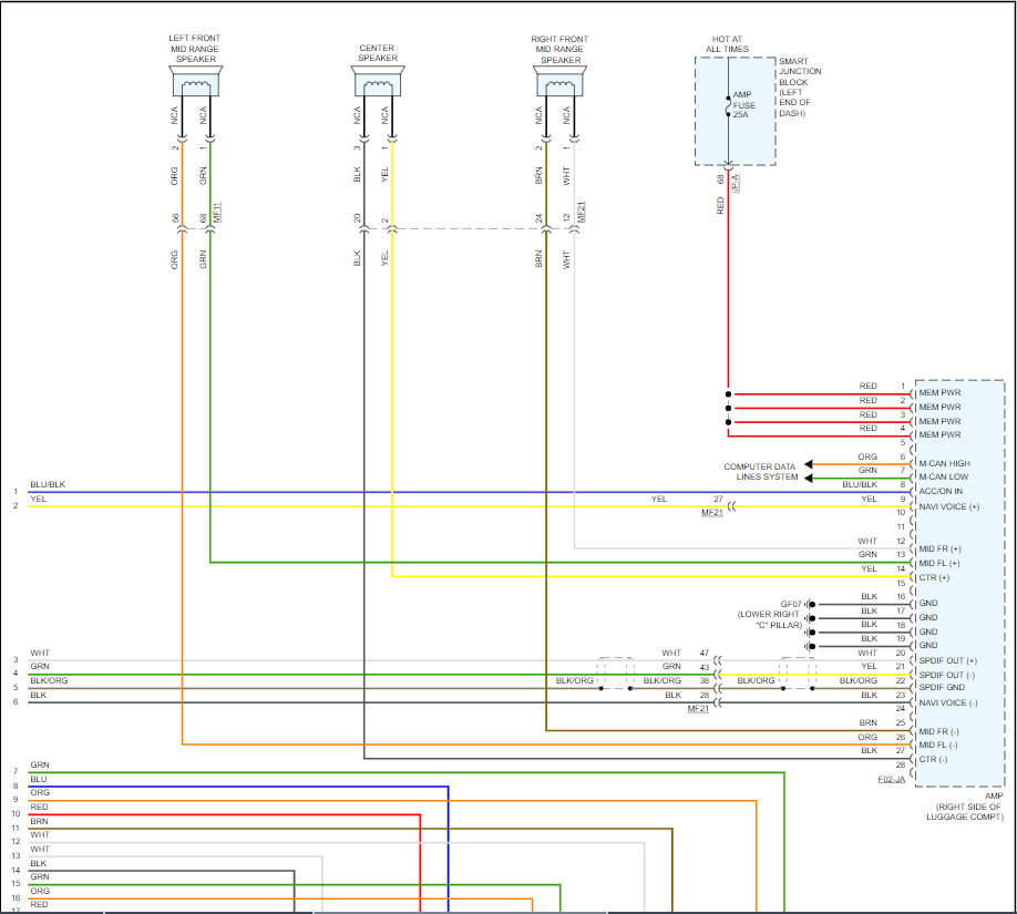

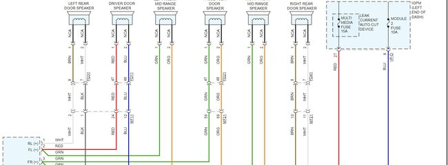

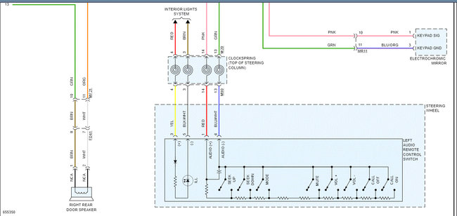

Hi, I have Navigation but stock speakers just 6 speakers and I'm trying to find the wiring diagram to install an amp using hi to low converter. I can't find anywhere on the internet. I Have the car listed above Sx. Also it would help a lot if you can help me identify which speakers are full range and mid range. Thanks in advance.
+1
KENW1
  • 213 POSTS
Thanks for visiting 2CarPros.
The speakers in the doors will be full range. I'll post the diagrams for this system below for you. If I can help further just let me know.
+1

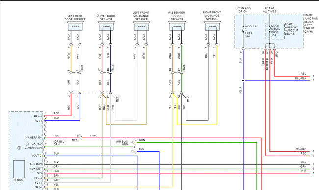

FRANCISCO PEREZ2
I can barely see the diagram I can only distinguish the different colors, so all door speakers are full range? It would be way easier for me to use the rear speakers for hi input signal.
+1
KENW1
  • 213 POSTS
I'll try to post a larger image of the speaker colors. I would use the rear ones for sure.
+1

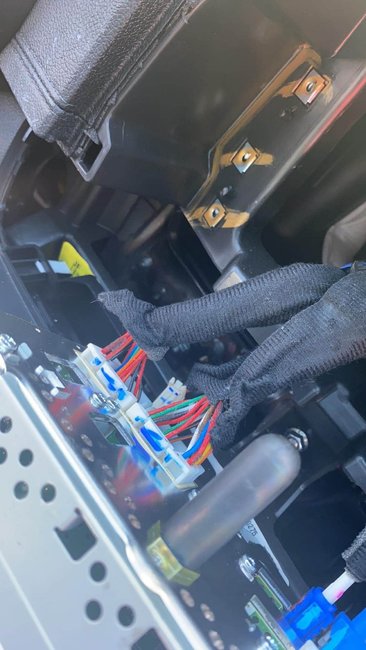

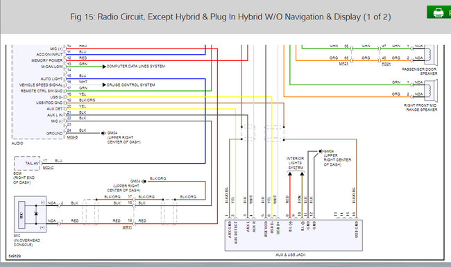

Hey everyone!
I have the vehicle listed above s with the uvo without Harmon kardon.
I’m looking to tap the speakers at the radio harness to add a lc7i and a 4-channel. I love my stock head-unit but I’m not a fan of the sound it produces.
I’ve searched for hours with no luck.
Anyone happen to know which of the 2 plugs on the back of the radio holds the keys to my success?

FRANCISCO PEREZ2
This one definitely helps. Thank you so much for the help, I will be posting an update on how the install went.

MOTOR MASTER
  • 279 POSTS
Hello my name is Dave.
Here are the diagrams you are looking for. Let us know if there is anything else we can help you with and thank you for using 2CarPros! Check out the diagrams (Below). Please let us know if you need anything else to get the problem fixed.

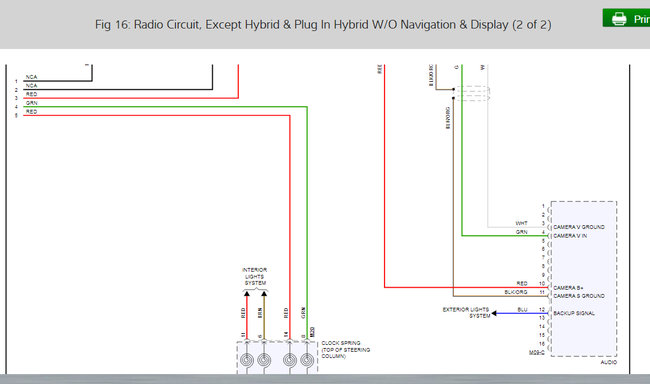

Looking for a wiring diagram for the base model stereo. Pinout diagram of head unit and speaker wire colors in main wire harness. Thanks.
SCGRANTURISMO
  • 4,897 POSTS
Hello again,
I thought I included the wiring diagrams for you in the diagrams down below earlier, but for some reason they did not make into the diagrams. I apologize for the mix up, and now they should be included in the diagrams down below.

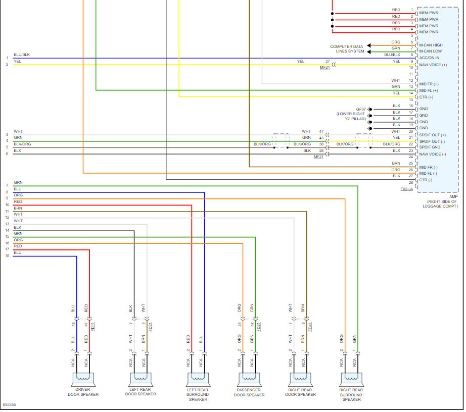

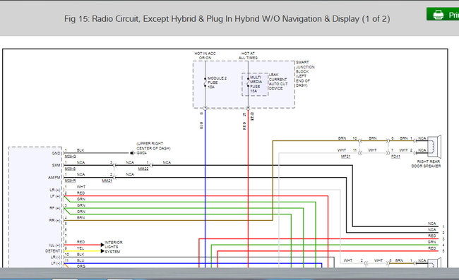

JAMES BUSH2
  • 5 POSTS

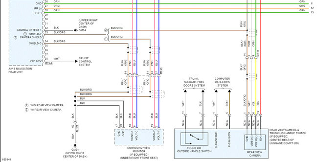

Would this be the same diagram for a 2019 Kia optima that's what I'm looking for lx optima base radio. I want to hook up a line out converter and need the colors of right rear speaker and left rear speaker and also non constant power and ground
Thanks for your help
SCGRANTURISMO
  • 4,897 POSTS
Hello again,
I would almost assume so. I tried to pull some 2019 wiring diagrams for you, but they have not been made yet. I apologize for this. I can say that on an aftermarket stereo switched power would be the red wire, ground would be black, right rear would be purple wires, and left rear would be the green wires. On both speaker wires the black striped one would be the negative wire. But that's not helping here. You can look at the wiring diagram and compare your vehicle's wires and if the wires match, then you are golden.

JAMES BUSH2
  • 5 POSTS
  • 2017 KIA OPTIMA
  • 2.4L
  • 4 CYL
  • 2WD
  • 35,000 MILES
I can't find a diagram for my car listed above base model with cruise no amp or upgraded stereo, but it does have a display.
Thanks for the help.
JAMES BUSH2
  • 5 POSTS
Okay great I will try and see how close the diagram you put up and my hardness is thanks again for the help
