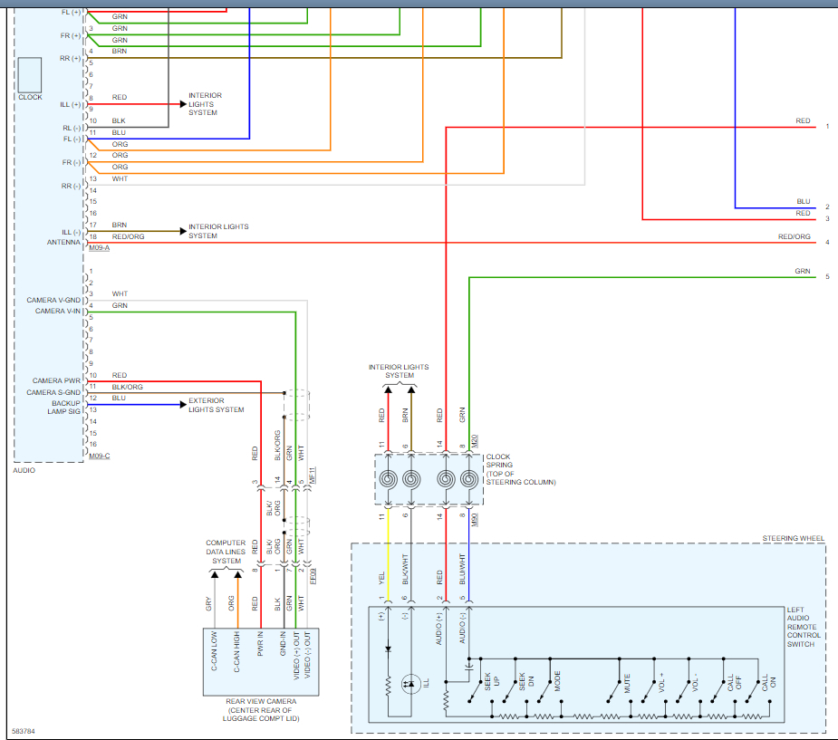

Hello again.

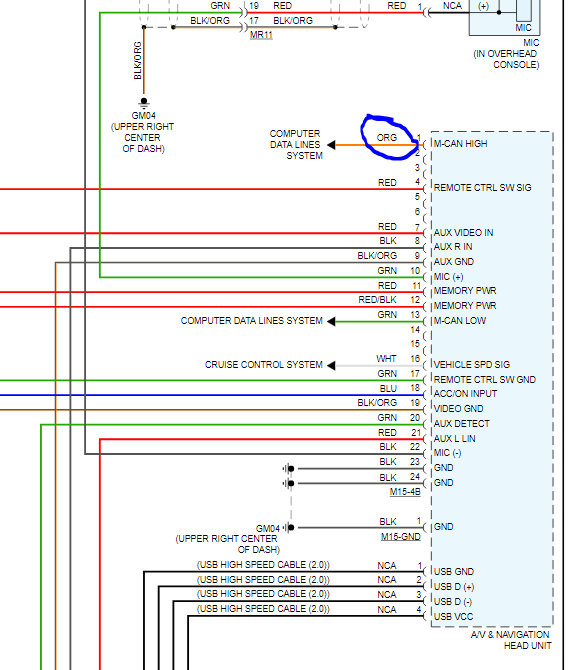

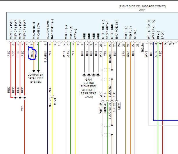

I would take a look at the orange CAN high data line wire that connects the amp to the head unit. I've attached the two pictures below and circled in blue. Let me know what you find. Hope this helps and thanks again for using 2CarPros. Happy Thanksgiving.

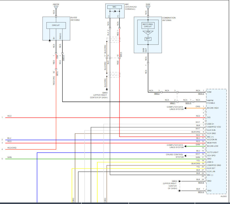

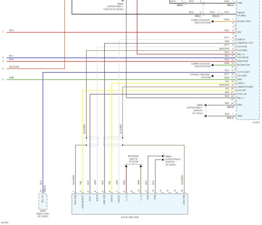

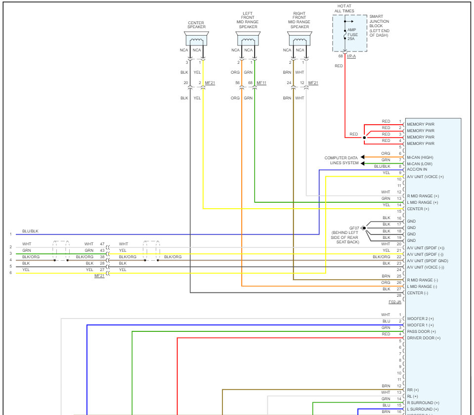

Hi, I was wondering if I could get a wiring diagram for my 2018 Optima LX+ 2.4L no UVO, no Amp. Would it be the same as the 2019 as posted above?
Monday, July 26th, 2021 AT 1:41 PM
Good afternoon,
I attached the diagram for you of the system you requested.

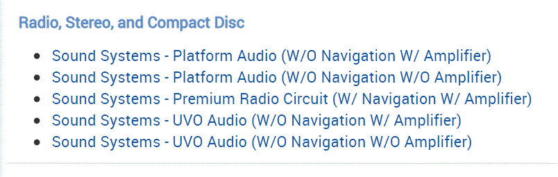

Hello, my name is Dale. I have a 2014 Kia Sportage awd I need a color coded wiring diagram for UVO wnavi and backup camera. Replacing the head unit because was having a lot of connections issues and wanted Apple Car
play and Android auto and I have a subwoofer factory.
Saturday, August 14th, 2021 AT 4:14 AM
  • 110,194 POSTS
I would be happy to help, but I'm not showing the UVO with navigation. It only shows it without nav. Take a look at the attached pic to see the options that were offered.
Let me know which you feel is the correct one for your vehicle.
Take care and let me know.

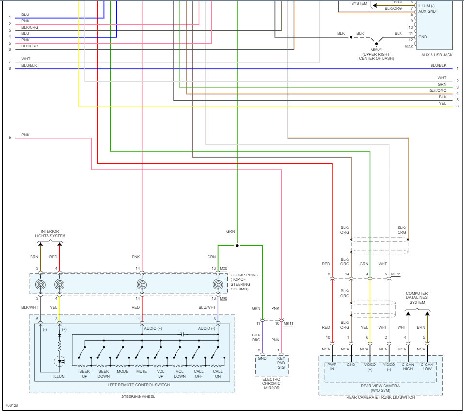

FORMATZZ

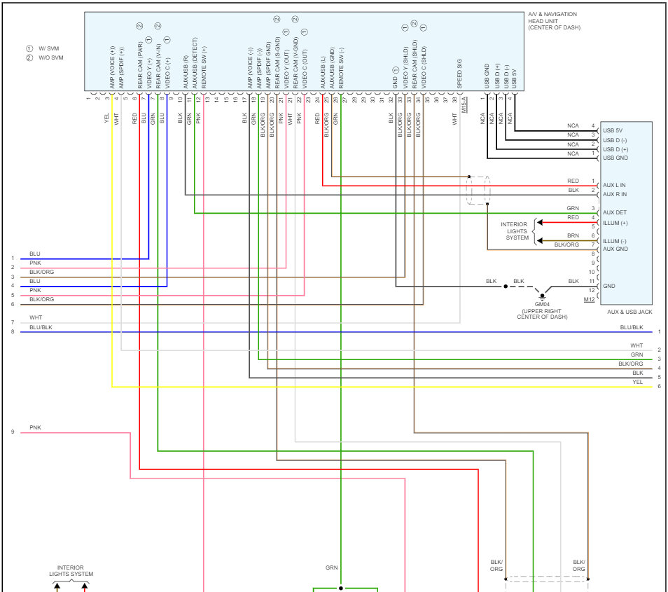

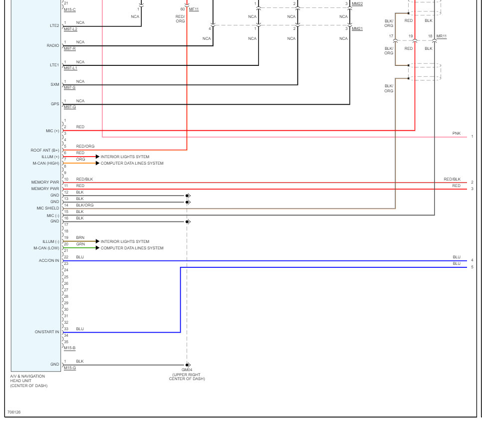

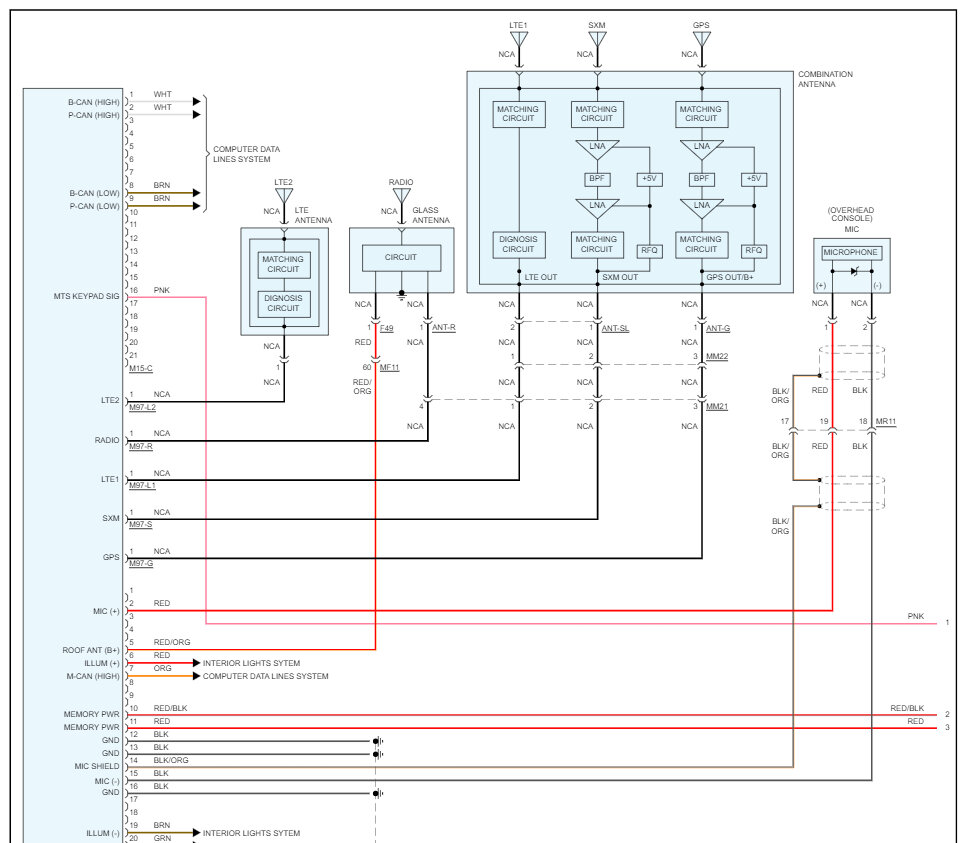

Hi. Maybe you have wiring diagram for kia k5 2020 - 10, 25" touch screen (Bose) with surround view monitor 360.
Tuesday, July 11th, 2023 AT 4:42 AM
KEN L
  • MASTER CERTIFIED MECHANIC
  • 55,440 POSTS

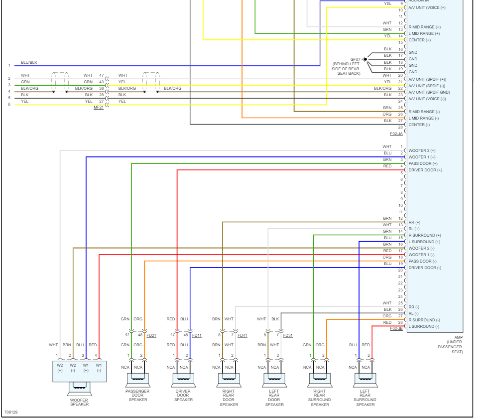

I think these are the wiring diagrams you need, if not please start a new question. This guide can help you test the connections:
Check out the images (below). Please let us know if you need anything else to get the problem fixed.
