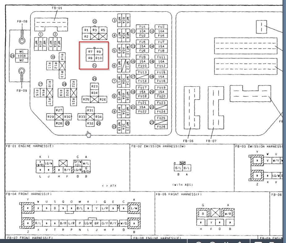

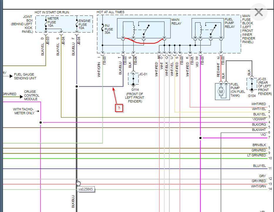

My main relay I think is bad, I tested the continuity and there none. There are 4 prongs I looked up the electrical diagram which follows c to d then the bottom a to b. So can I use a jumper wire to try to start it?

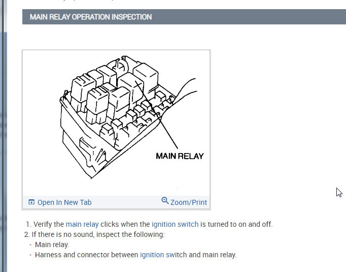

Okay. Does the relay click when you turn the key to the on position?
Here is a guide on how to test it to be sure:
Also, I attached the test for the relay from the manual. Basically it just wants you to touch it and see if it clicks when turning the key. If it does not, I would replace it or swap it with another just to see if it is the relay.

Can I test my relay in other words to jump it? But the numbers aren't on it.87 and so forth. What about the 100 amp fuse how can I test that?
Saturday, December 26th, 2020 AT 11:24 PM
Yes. You can jump this relay by jumping the power terminal to the output terminal.
I showed this on the diagram attached. Let's just make sure you have power on the black and blue wire that I put the question mark next too. If you don't have power on that wire then the relay will not close. You should have power there in the run position.

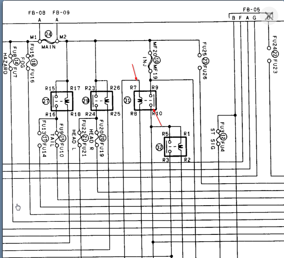

I think I'm doing this wrong A and D are the jumping spots. And I have to have the car on to do it right.
Thursday, December 31st, 2020 AT 8:44 PM
If you are jumping the relay, you want to install the jumper with the key off, then turn the key to the start position. Or you can test the R10 position shown below for voltage with the relay installed when starting to see if you have voltage. If you have voltage on the R10 then the relay is working.

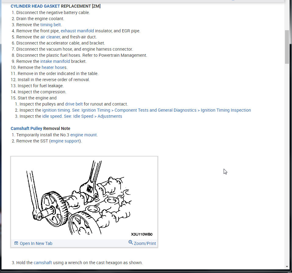

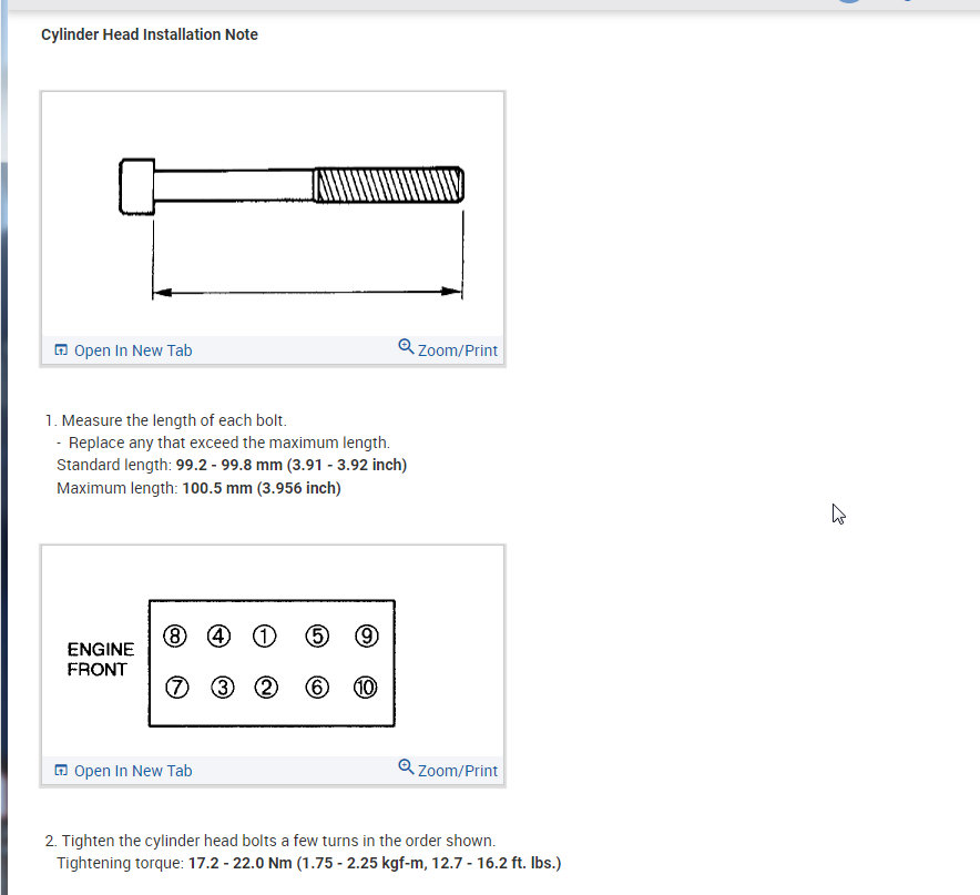

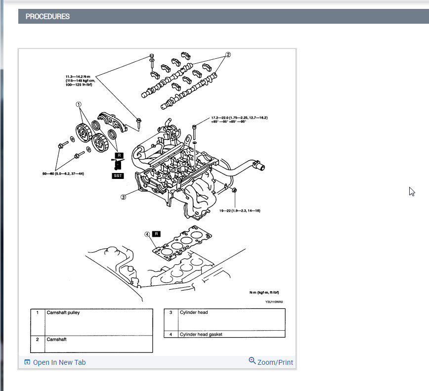

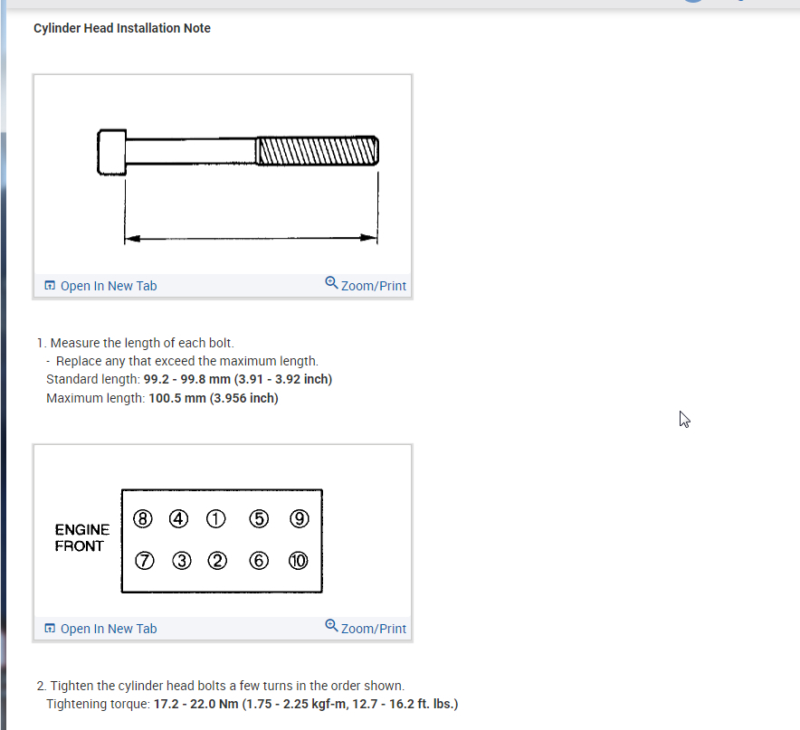

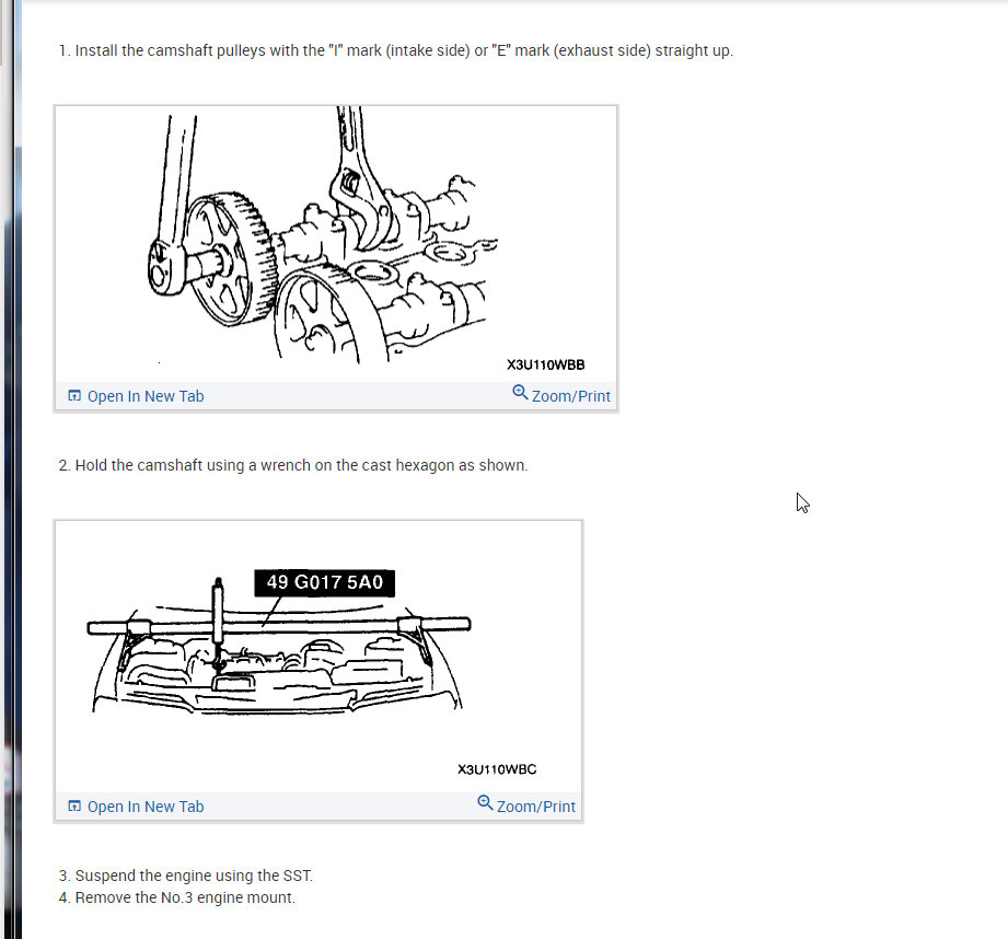

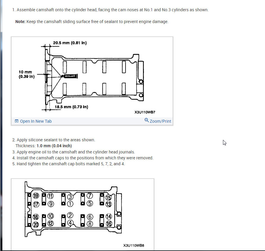

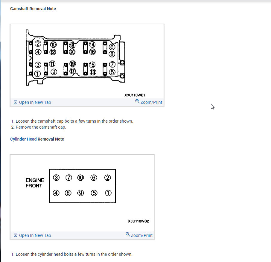

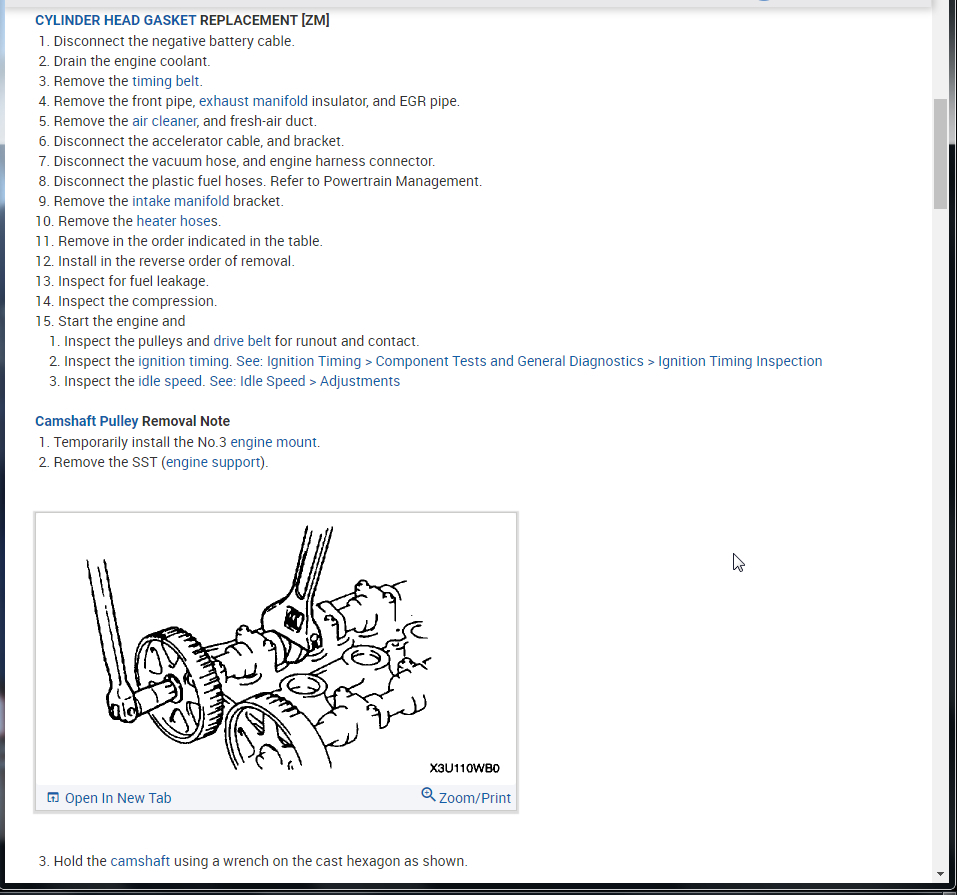

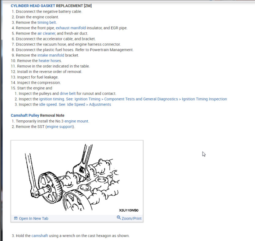

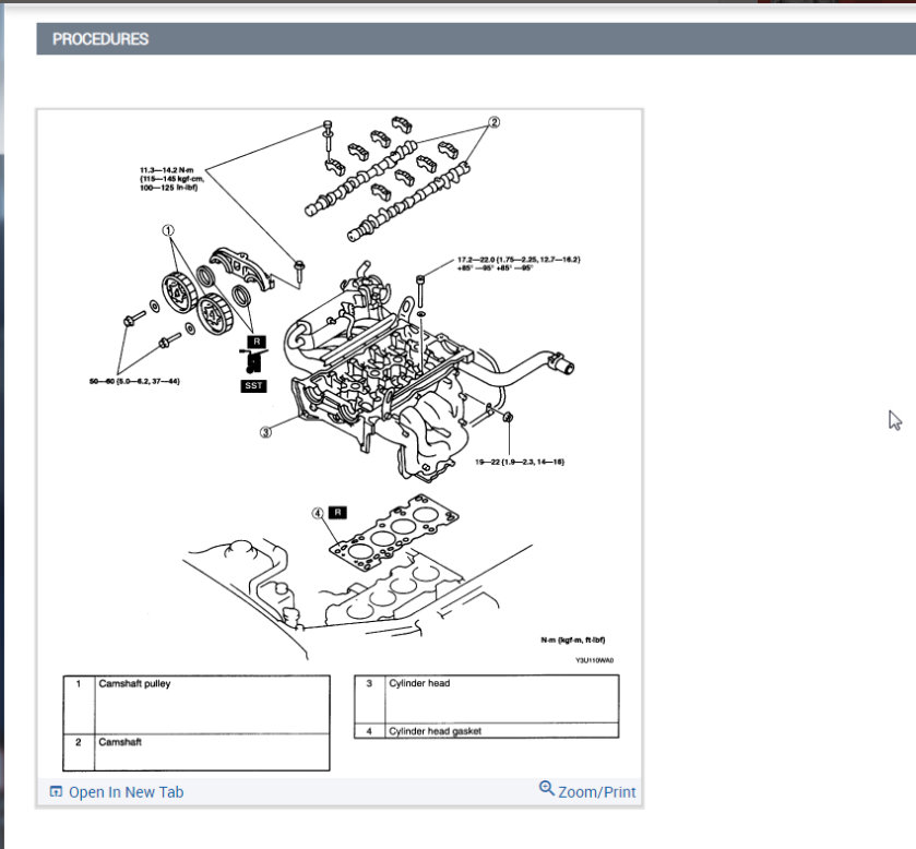

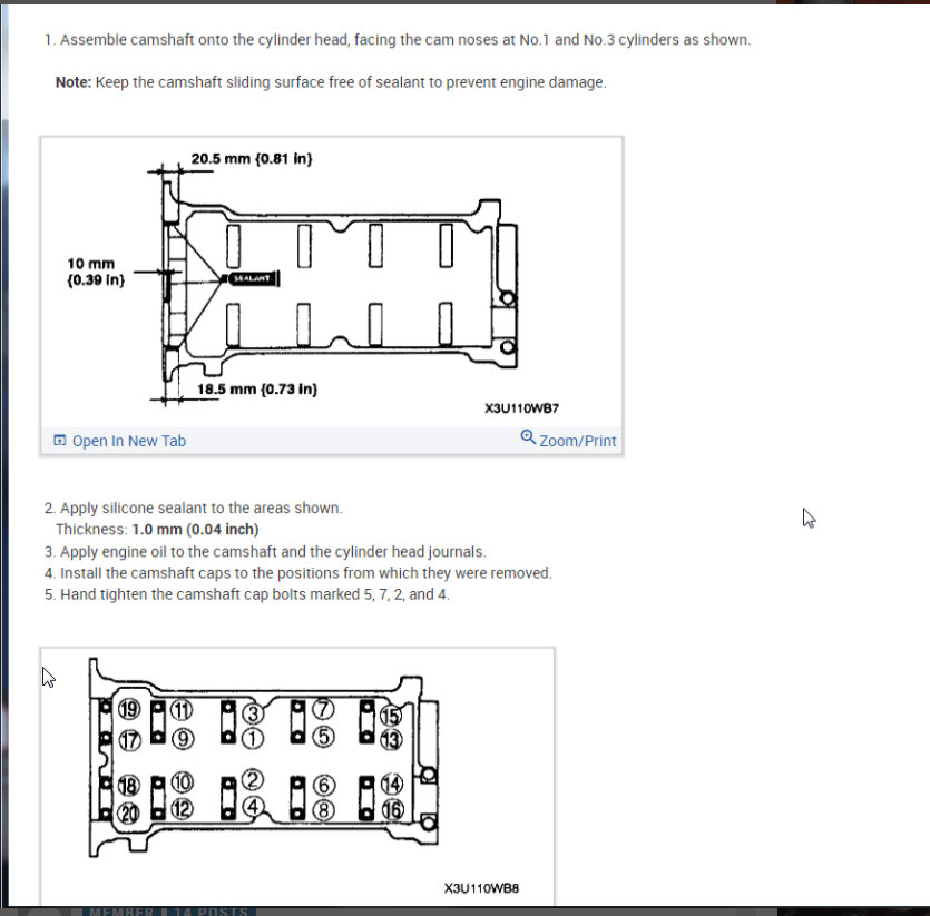

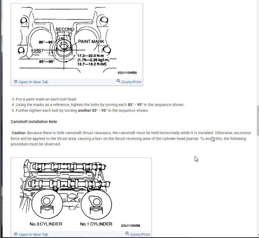

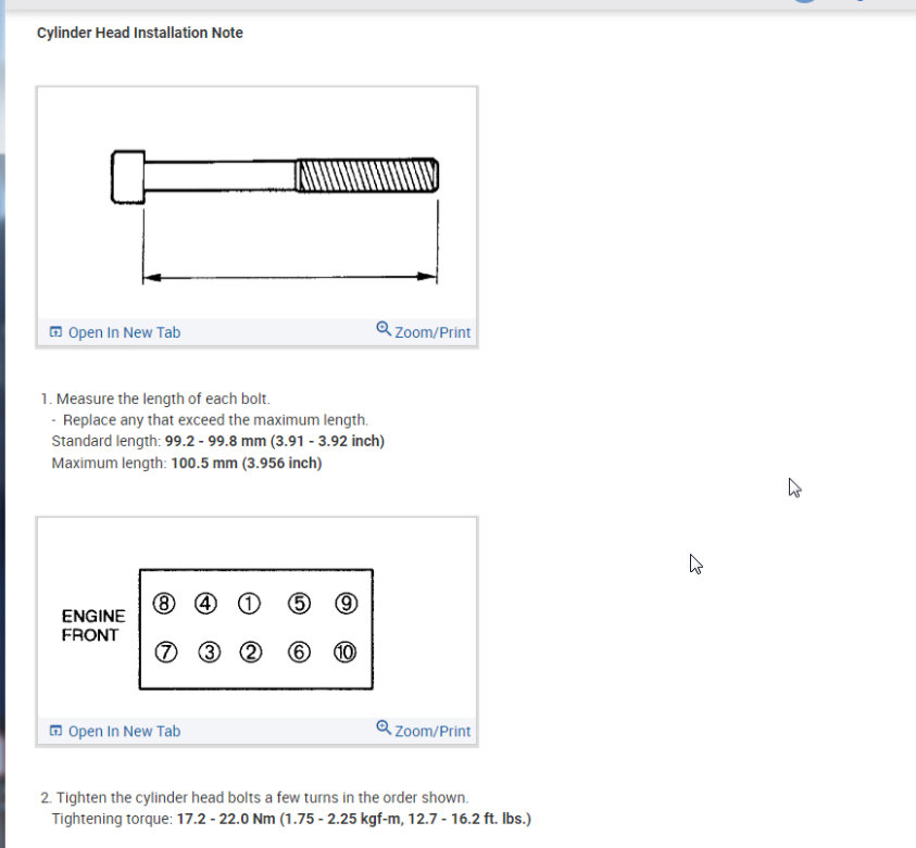

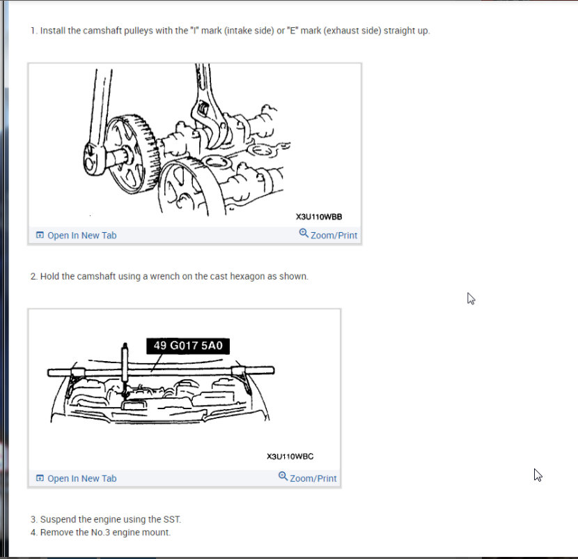

So, I just found out that it's a head gasket leak. And oil is going into to the catalytic converter and tons of white smoke is pouring out the bottom of the engine. So I need step by step how to take it off. Especially timing belt and valves etc.
Saturday, January 2nd, 2021 AT 12:12 PM

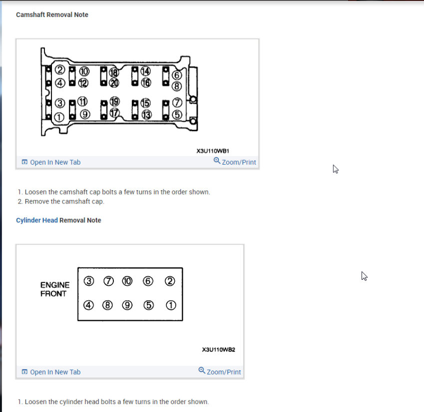

That is great that you found it but we need to refer back to my first response and make sure the head is not warped. If the head is warped it would have pushed the head gasket out and if you just replace it, it will fail again. Take a straight edge when you have the head off and put it across the head and make sure you can't see light under the straight edge.

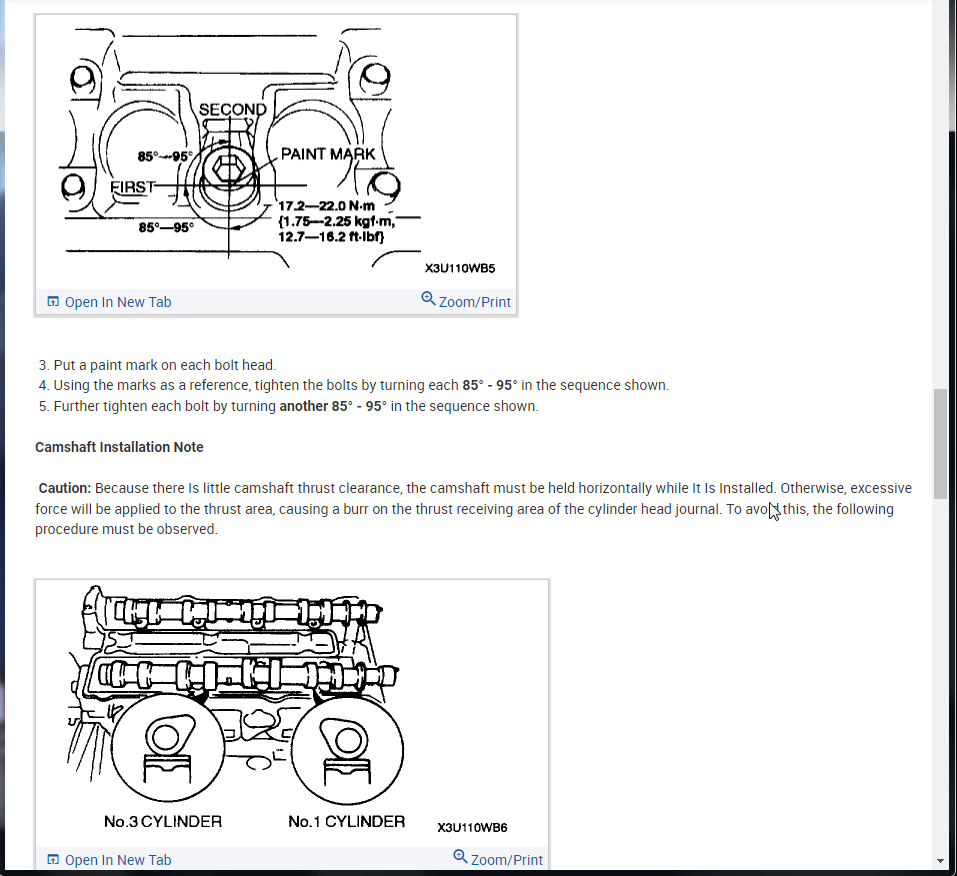

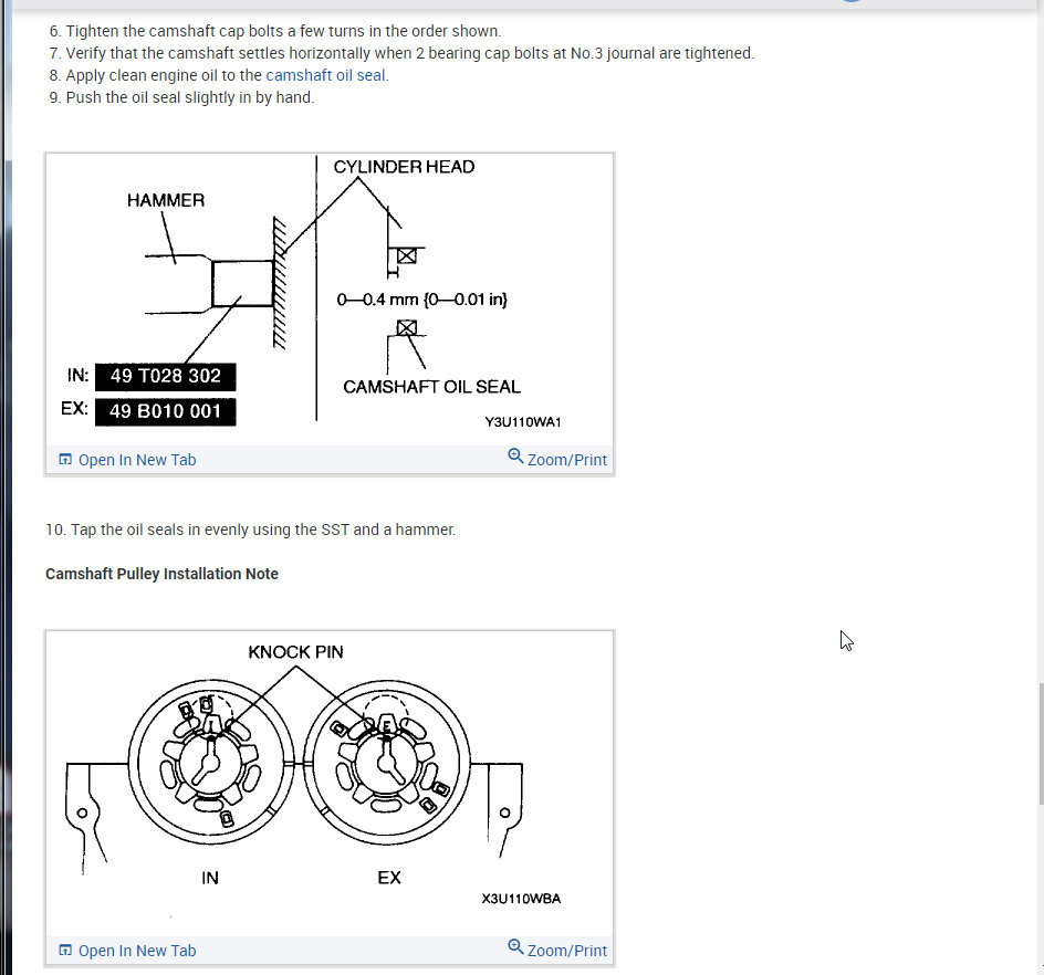

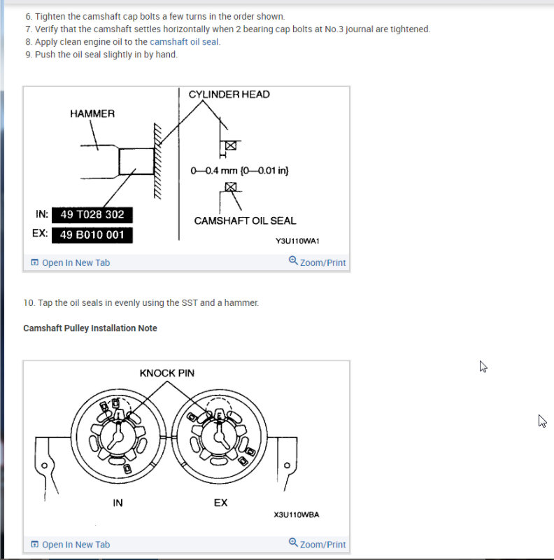

Here is the process from the manual on the head gasket. Let us know if you need more detail.

So I'm getting ready. My gasket set comes tomorrow. So I just want to make sure I have the timing belt and the camshaft. What thrust clearance? And do I need any special tools for the job? And I want to say thank you for all your help and support.
