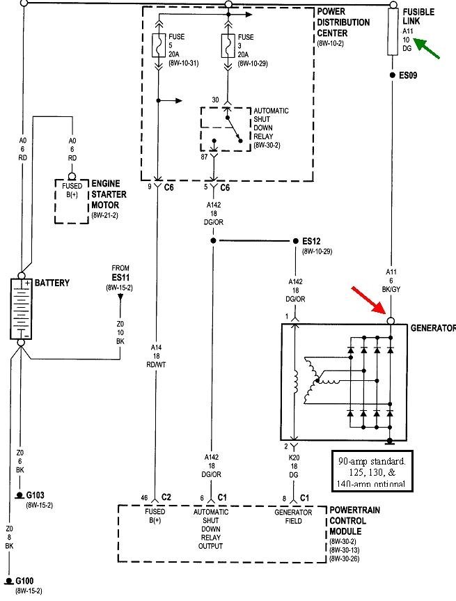

I need to know precisely where to find the fusible link between the alternator and the battery, since both lines to the alternator connections run in one wrapped bundle.
Suspect that fusible link may be the problem as to why not only the alternator light is on, but I had weird glitches in instrument panel (loss of tachometer and speedometer, ABS light coming on). In process of changing the PCM which I suspect may have received damage to the voltage regulator chip inside. Really getting tired of dismantling the top of my engine compartment if you know my meaning. And i need my one and only transportation!

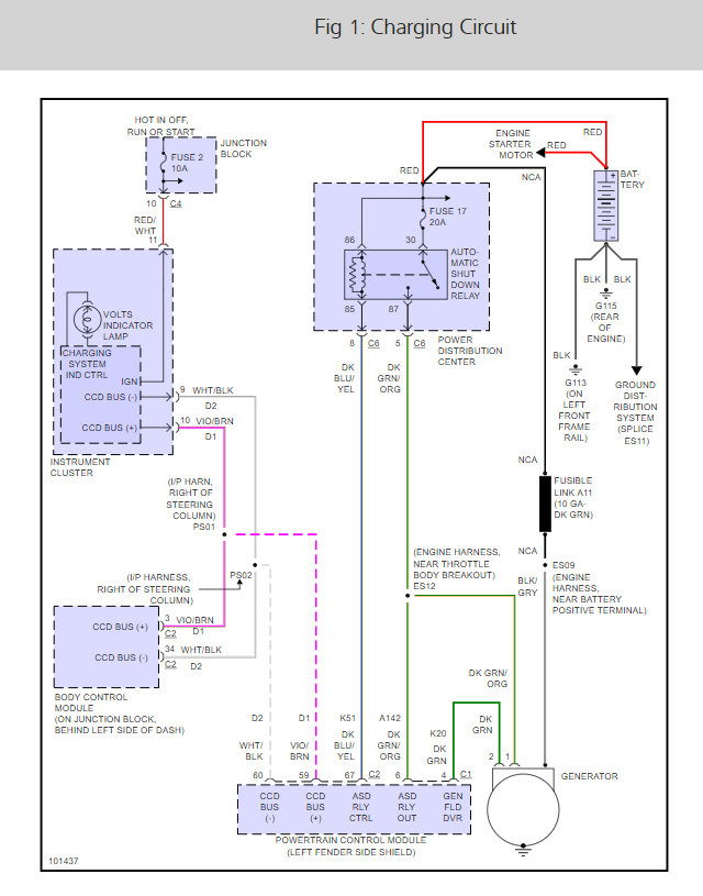

The link is in the positive cable right near the battery terminal. Check the ASD relay as well. Here is the wiring diagrams for the alternator so you can see how the system works with a guide to test the wiring as well.
Check out the diagrams (Below). Please let us know what you find. We are interested to see what it is.

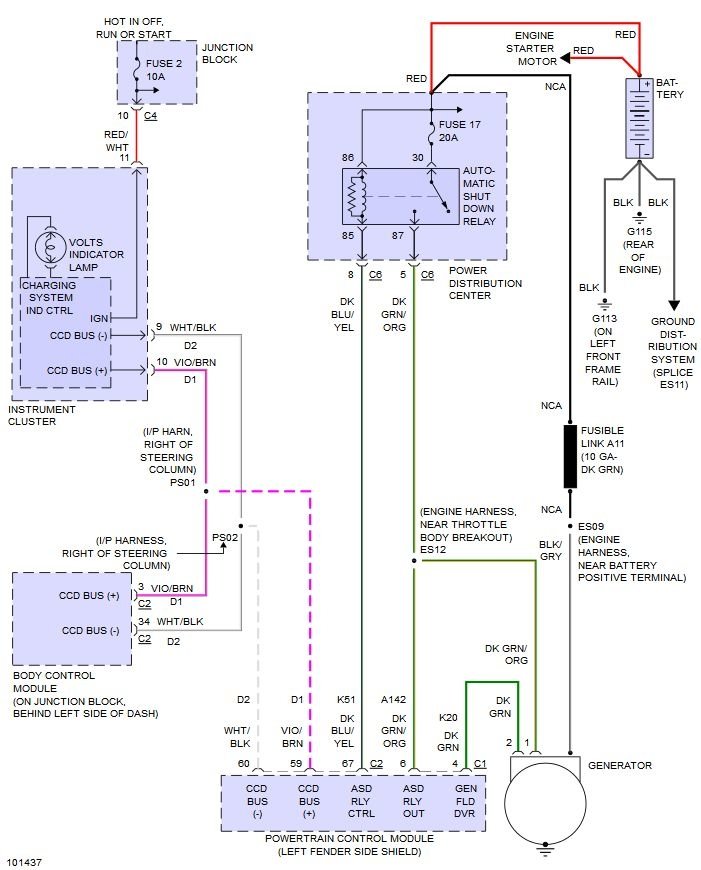

These are the wiring diagrams for that vehicle and both show that it has a fusible link (A111 Dark.green ten gauge) spliced to the black with gray wire that goes to the alternator at the battery end.
And in your complaint about being given wrong information you state "Main big cable from post is to the starter/starter solenoid, smaller red cable (ten gauge) goes to the PDC, also to the PDC is a dark green cable (ten gauge) and that's to the PCM. NO FUSIBLE LINKS"
The dark green wire is the fusible link. It is bonded (electrical splice 09) to the Black with gray stripe about one foot down the harness.
Go look at the wire on the battery terminal of your alternator. What color is it?

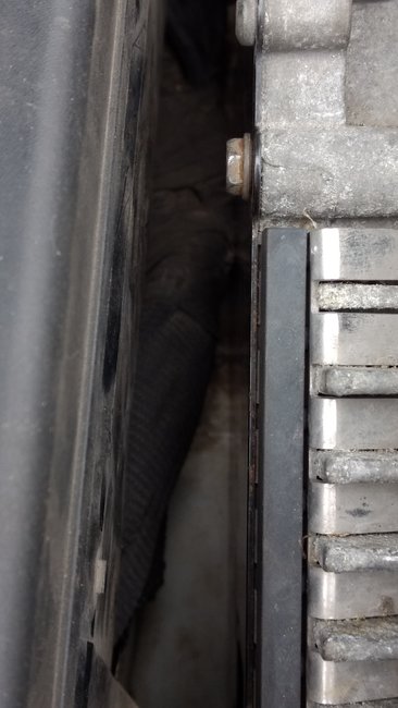

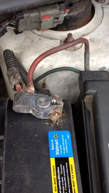

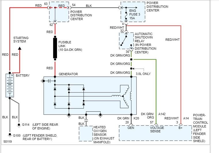

Maybe these will help what I said. And as I said there's no fusible link in this vehicle. Left RED is main, right RED leads to PDC and that Dark Green (same color as my schematic says the fusible link A111 is) leads from PDC to the PCM. The bundle under the PDC between the PDC and PCM has the Red Main in it but NO FUSIBLE LINK. So, after tracing every bundle from battery to alternator including the leads to the ignition system and fuel injectors and not finding anything I went to the Dodge Dealer parts store to get a brand new ASD RELAY and asked their chief mechanic (showing every photo I had taken). He looked it up and looked up my VIN and found that this 1998 Grand Caravan Sport does not have a fusible link. So, when I post what I am told by a dealer's mechanic after an hour and twenty minutes of searching and waiting it's not my imagination. Besides it makes no difference now anyway because I had to order a whole new PCM after having this one checked out because the voltage circuitry chip smoked out. Presumption is by what the codes showed is that it lost ground apparently of which I have no doubt since that fender was severely damaged in an accident 2 yrs ago. Just one of several parts that had to be replaced in time as a result. Like I saud, Thanks For Your Help!

There's a lot of misinformation here. You found the dull dark green wire. That is the fuse link wire. Tug on it. If it acts like a wire, it's good. If it acts like a rubber band, it's burned open. The problem is it doesn't come off the battery cable like in years past. The smaller positive battery wire bolts to the under-hood fuse box. That connection is where the fuse link wire is bolted.
The next problem is most of these diagrams only show what is relevant to the specific circuit. You could have multiple fuse link wires bolted to that connection, but the one for the alternator does not go to the Engine Computer. It goes straight to the alternator's output terminal.
There is no need to even have to know where that fuse is unless testing proves otherwise. Just measure the voltage on the alternator's output stud. It should have full battery voltage all the time. If it does, you're done in that circuit.
Forget the ASD relay. It's true that it sends current to the alternator's field winding, but it also powers the ignition coil pack and injectors. If the engine runs, the ASD relay is turning on. Less than ten seconds to eliminate those two circuits.
It is also correct the voltage regulator lives inside the Engine Computer, but it is incapable of being damaged by the alternator. They put it there to simplify the circuitry needed to provide information used to modify the target charging voltage. That can include wide-open-throttle, turning on the AC compressor, engine running too hot, ambient air / battery temperature real cold, etc. It is possible for the regulator circuit to fail, but it's not very common. I've only run into one since 1990. That low-current circuit is also real easy to test. Look at the two smaller terminals bolted to the back of the alternator. The engine must be running for them to have voltage from the ASD relay. One will have full battery voltage. The other one must have less, but not 0 volts. If you find 0 volts, the brushes are worn. (Nine bucks for a replacement assembly). If you find exactly the same voltage on both terminals, there is a break after that point. That could be the voltage regulator is open, but it is much more likely there's a corroded terminal in the connector going to it.
Typically you'll find between 4-11 volts on the second terminal. The lower the voltage, the greater the difference there is across the two of them, and the larger the electromagnetic field is. That one voltage will tell you if the low-current input circuit, including the voltage regulator, is working.

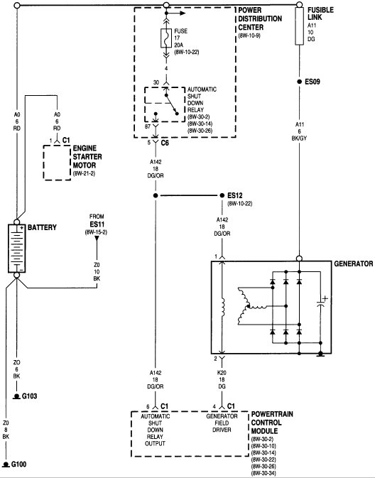

There were four sizes of alternators available for this model and year. The wiring harness will always be the same except for the fuse or fusible link. Those are selected at the factory for the size of the alternator being installed. In this case, all they show is a 10-gauge wire, denoted by its dark green insulation. In this diagram, the fuse link is shown way up in the top right corner with my green arrow pointing to it. The small circle on top indicates that end is bolted to the under-hood fuse box. "ES09" right below it indicates that is a soldered splice to the wire it protects. That is circuit "A11 6 BK/GR". "A" circuits are always tied right to the battery positive side. This is circuit A11. It's a 6-gauge wire with black insulation and a gray tracer, (stripe). Most commonly these fuse links are part of a larger bundle of wires, but they are left out where they can be seen.
The place to start is by measuring the voltage at the alternator's large output terminal with the engine not running. That's the red arrow in the diagram. You must find that voltage is the same as battery voltage at all times. If you find 0 volts, suspect the fuse link is burned open. It's best to check this with a test light rather than a digital voltmeter. The advantage to using a fuse link wire is they are slow-acting, so they tolerate momentary current surges. The disadvantage is when they burn open, they leave a carbon track behind, and those can conduct enough current for a digital voltmeter to pick it up and falsely show there's 12 volts at the output terminal. A test light needs current flow to operate, and sufficient current can't get through that carbon track to make the bulb light up. For that reason, test lights are more accurate in this type of circuit.

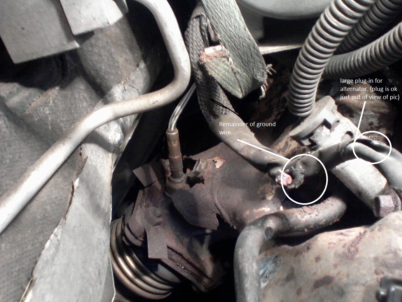

In removing the alternator the location of the ground wire was melted off of the back, tracing the wire back a little showed the melted other side. Need to replace the alternator and have to replace the ground wire, it is wrapped with the power wire and I need to know where it goes.

There is no ground wire can you ID color ? Think it is Black/Gray if so power feed from BATT cable through a fuesible link. That maybe what fried. was ALT light on before?

I am attaching a photo of what is left of the wire, I can go try to pull on it to see what color the wire sheathing is, but i didnt notice a color before.

Yep that is power lead

remove ALT see if ypou can cut insulation away. will need to soilder a 10AMP fuselink. may end up having to replace charging loom. have ALT tested to see if that is reason for wire frying

ok alt was bad, as i said it had melted the metal around the connector. So alt is out and we are going to replace the entire wire, however I am in need of a diagram as to where this wire goes. It feeds into a larger bundle of wires and we lose the wire in the mess, so if we can get a diagram as to where it goes we can just bypass the wiring bundle and wire it directly to where it goes. and Docfixit - Thank you for all of your help, you have been absolutely wonderful!

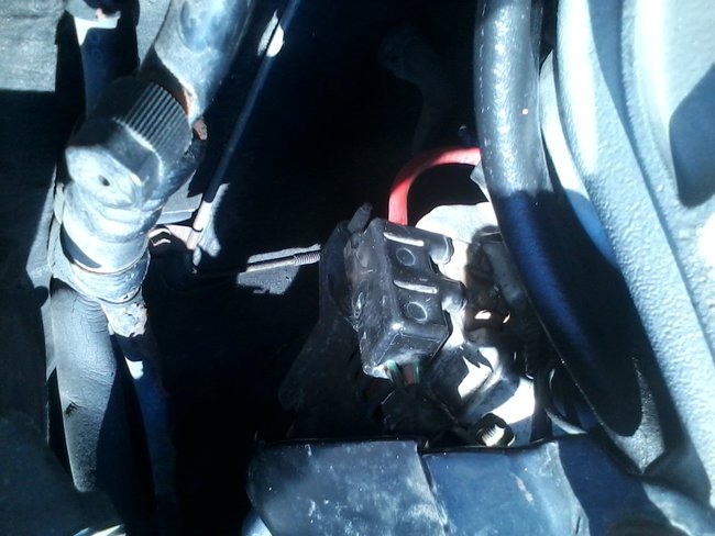

DODGEPODGE
  • 111 POSTS
It seem there is something wrong with a black inline box by the alternator. I need a wiring diagram where those wires run back to. For awhile when the voltage dropped I tapped on that black box and it would start charging again. But now that does not work. So either something happened in there or there is an open wire. Thanks

was finally able to uncover enough of the wire past the burnt part to see that it was a black and grey wire, traced it around and found out it links to a green wire at the main fuse box, where the pos battery cable connects. Still planning on replacing the entire wire now just searching for a place to buy one. Again thank you for all of your help.

Good afternoon,
I attached a wiring diagram for you to view of the charging system.

See the black thing in the middle of the picture with the red wire coming out. That is hat i'm talking about.
Sep 21, 2020 at 12:15 PM (Merged)
That is the main junction block for power.

DODGEPODGE
  • 111 POSTS
But do you know what is in there? i also checked to see if there is voltage to that point and there is not. so i need to know what is in there. there are no clips to open it up. it is twenty five years old and if i crack it open. i wont be able to replace it.
The top is a cap.
There is a power wire from the battery and the other wire goes to the alternator.

DODGEPODGE
  • 111 POSTS
Although it is a junction box it does not open up Roy. there is no cap, there are no nuts as you describe. i'm talking about one thing you're talking about another.
