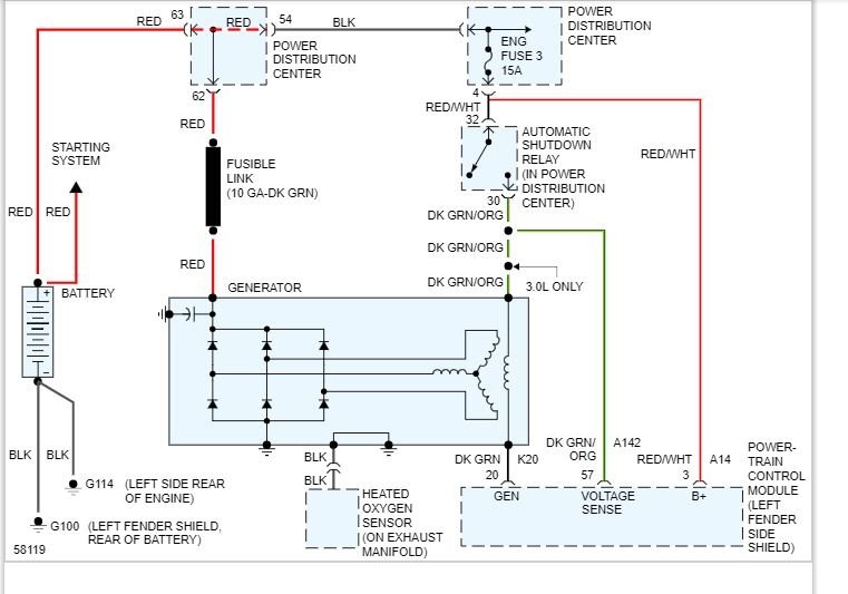

alternator wiring diagram?
1998 DODGE CARAVAN

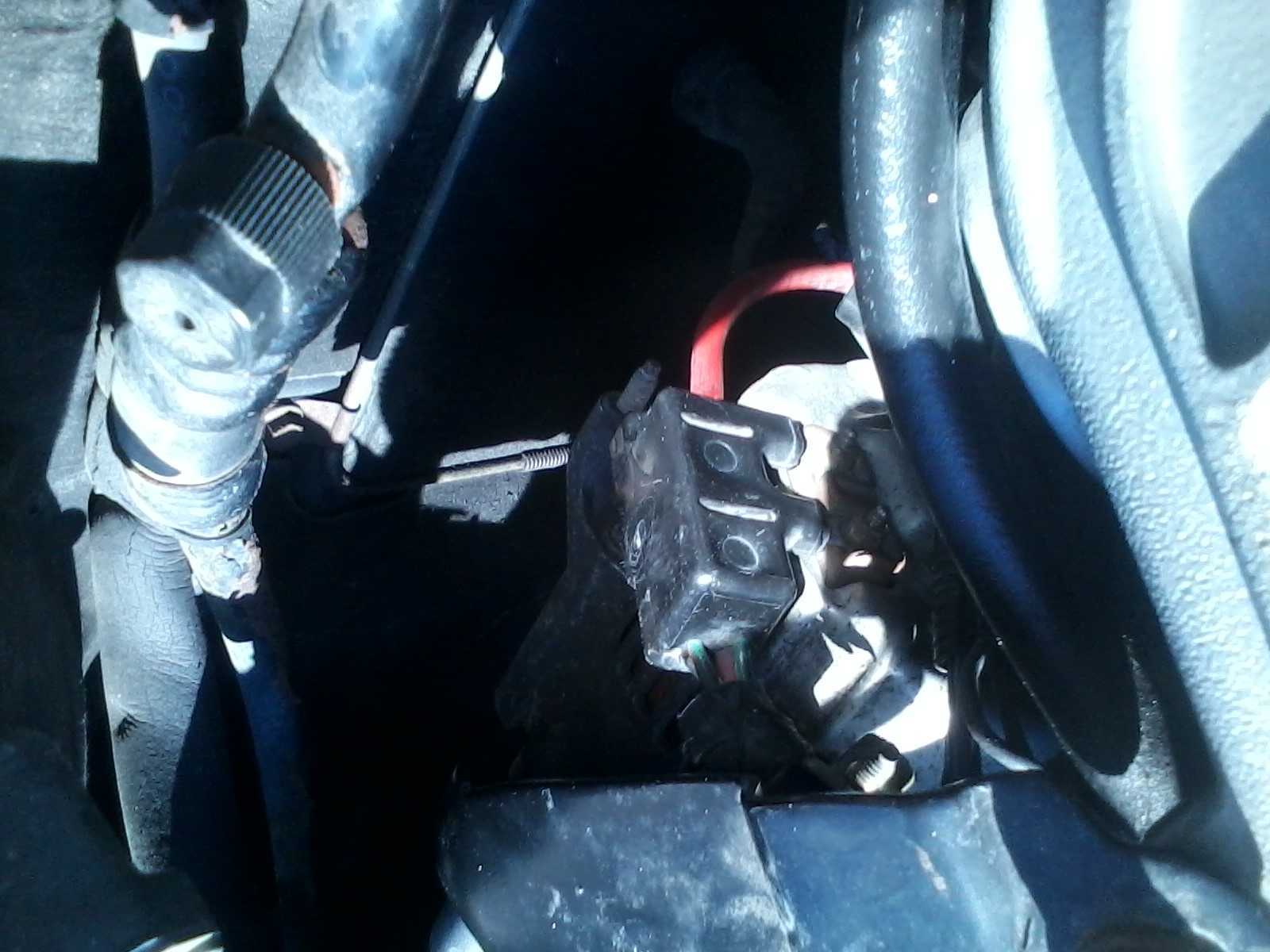

That area is what you said you tapped and the van worked. There is a problem with that connection as it looks like the reason for your issues.
It needs to be checked to see what is failing.

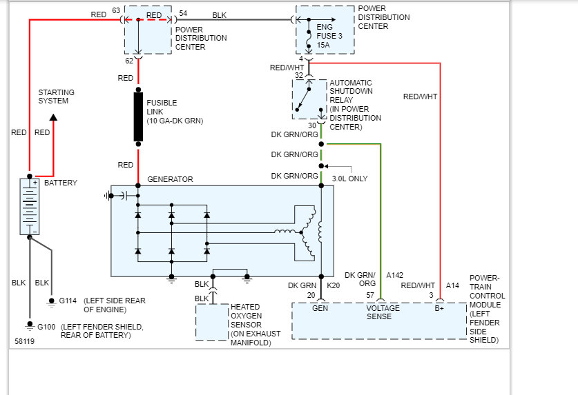

Okay,how about this Roy ? would you have a pin diagram with the pin numbers of the ECM or whatever it is called with the internal regulator ? or is there a procedure to test the voltage regulator with say an ohm meter ?

well I replaced the black box thing near the alternator with another one. when I removed it. there was a broken tab that connects to the alternator. thought that would fix the problem and it didn't. can the alternator be tested on the vehicle with a volt meter then there must be a way to test the voltage regulator with an ohm meter within the ecm ? but what pins ? if the brushes are totally worn in the alternator would it not throw a charge ? thanks
Sep 21, 2020 at 7:15 PM (Merged)
Okay, start the engine and put the voltmeter on the battery and tell me what the voltage reading is on the Dc scale.
Lets start there.
I attached a diagram for you to view. You will use a voltmeter as well to test the ECM control of the regulator.
