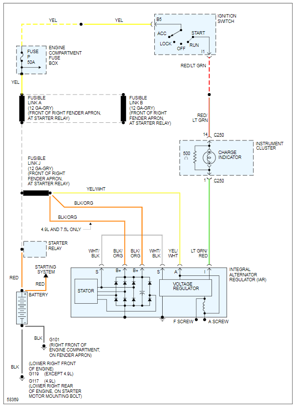

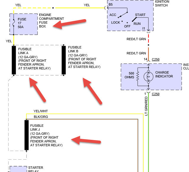

I bought a new alternator about two months ago and a new battery at the same time. The alternator still was not charging the new battery. So then I ordered the voltage regulator plug in the ten plug that goes on the other side of the alternator and I drove it to O'Reilly's because it still was not charging correctly. So then they put the tester that they have on it had and said it was a alternator but then when I took it off they tested it inside and said it was not the alternator that it could have been the wiring. So they did not sell the wire for the alternator so I had it jumped off and I tried to head home with it, but I ended up stranded across the road beside a convenience store. Is there a fusible inline fuse or something that I am missing is that what could be what the problem is?
Friday, January 22nd, 2021 AT 11:38 AM (Merged)
HMAC300
  • 48,601 POSTS
I do not know why auto parts guys think they know everything about a vehicle they only sell parts nothing else. There are three fusible links and a fuse which any of them could be bad see picture to check them. They should have 12 volts on each side wiggle them as they may only have one or two strands connecting.

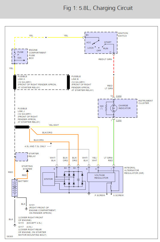

What kind of alternator do you have ?
with internal or external voltage regulator?
https://www.2carpros.com/forum/automotive_pictures/99387_Graphic1_425.jpg
https://www.2carpros.com/forum/automotive_pictures/99387_Graphic2_212.jpg
check fuses
check wiring
check for battery power at the B terminal

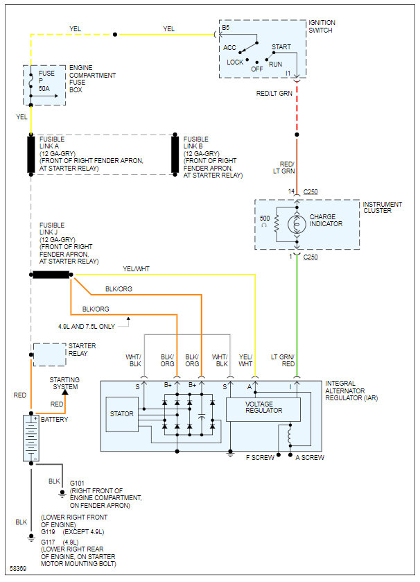

Two days ago driving down the road all lights dimmed really quick. Realizing that I believed the alternator just fried got to a safe place that I could work on it took both battery and alternator and had them tested both were bad. Come to find out it has a 1989 alternator with external voltage regulator in it. Changed alternator and battery, but not voltage regulator. Last night it sat for maybe an hour and a half (nothing was left on) tried to start it and all I heard was a loud pop (one click) noise coming from the voltage regulator and nothing. Tried to jump it and did same thing one click nothing. Tapped on starter solenoid, test diode fuses and every other fuse. Battery is completely drained. What could be the issue or how can I fix this?
I managed to get it figured out the screw that allows it to engage was not positioned correctly. Now that I have it set I am going to find something to keep it from moving and call it a day.
Friday, January 22nd, 2021 AT 11:39 AM (Merged)
Thanks for the update. That is great that you got it figured out. I am attaching the wiring diagram for not only your future use but also, for others that may have this issue. While you figured out that your vehicle was installed with the wrong alternator the voltage regulator was external. This vehicle should have a voltage regulator as part of the alternator.
Here is a guide on how to test the alternator:
Please view the wiring diagram below for more info. Thanks and let us know if you have other questions. Thanks
