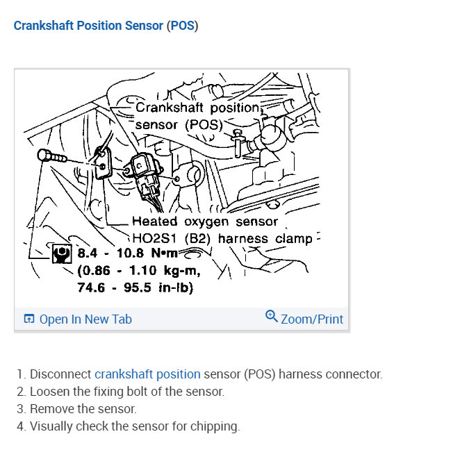

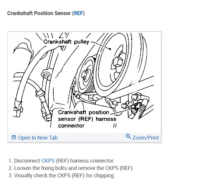

Another thing, the RPM hand doesn't move while trying to start also.
Thursday, May 4th, 2023 AT 12:18 PM
KEN L
  • MASTER CERTIFIED MECHANIC
  • 55,469 POSTS
Okay, this can be a bad crankshaft sensor, here is the location of the sensor so you can change it out and we should run the codes on the car as well.
Here is a guide to help you:
