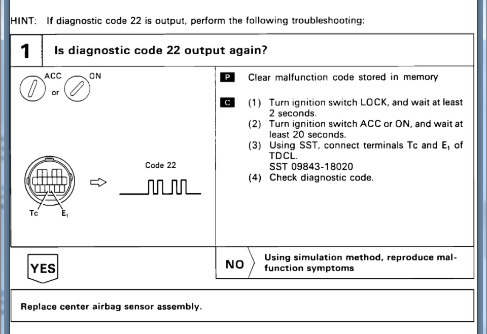

Read codes and got a code 22 and changed the center airbag module under the console and cleared codes turned on key and now getting a code 14. I checked the clock spring with an ohmmeter and there is constant continuity even while turning the wheel. I do not think it is the clock spring, and I do not think the center airbag module is bad, but, because I am getting the code 14, open in squib circuit, I believe the actual airbag has a resistance problem or open. How can I check the resistance of the airbag itself and also what exactly should the resistance be? I have seen on the internet where if you put a resistor of proper value in place of a faulty airbag, the light will go out because the ecm now senses proper resistance. I need help troubleshooting the airbag on the steering wheel I think now.

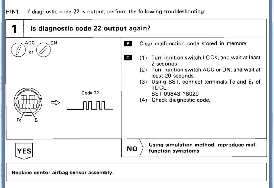

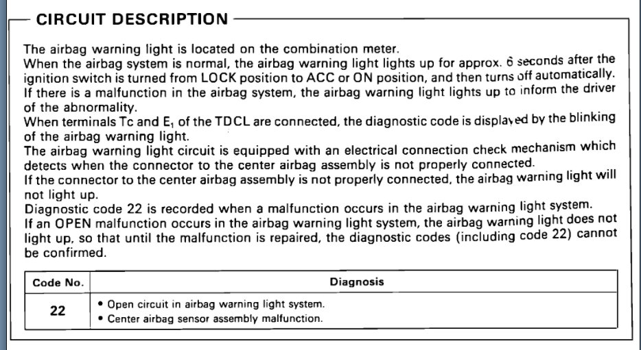

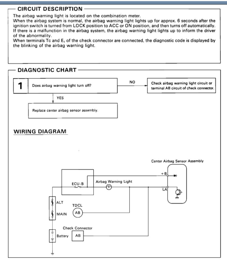

DENO2970
  • 19 POSTS

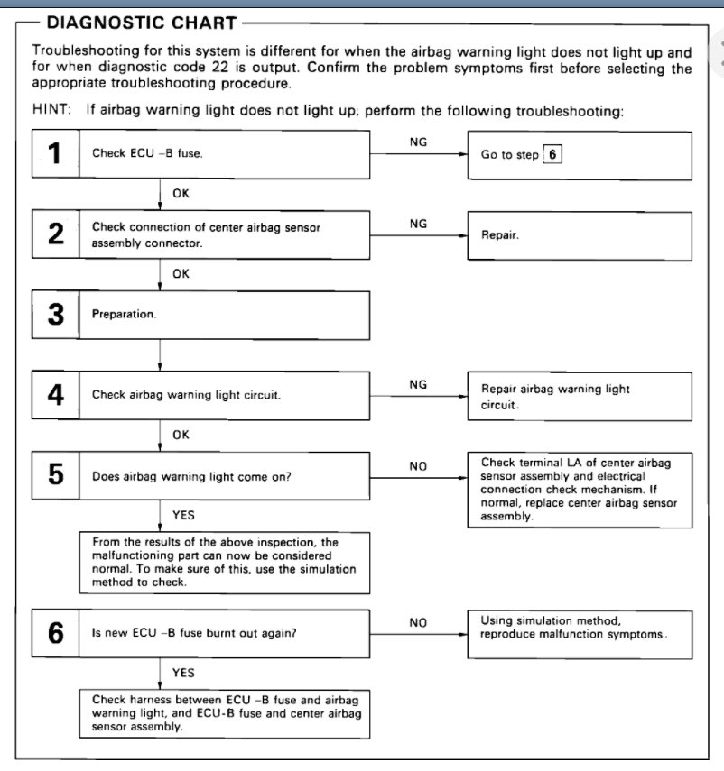

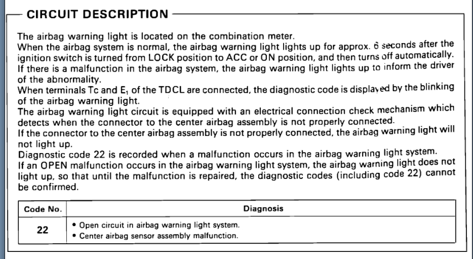

Hello Sir,
Need some direction on a issue with airbag light staying on. I retrieved a p-code 22 which is associated with the airbag indicator lamp circuit. When I removed the radio and the instrument cluster and reinstalled
everything is when the light would not go off. I checked the lamp again and its fine. Check for good connection as well. Do you have any resolutions or recommendations?
Wednesday, January 13th, 2021 AT 9:31 AM (Merged)
Two things. Did you have the battery disconnected with you were doing this? If so, you more then likely missed a connection and it is causing an open circuit. If not, you may have a shorted center airbag sensor.
Here is the testing that you need to run through to fry and find this issue. Let me know if you have questions. Thanks

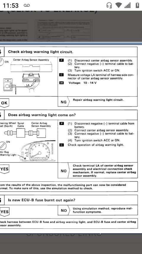

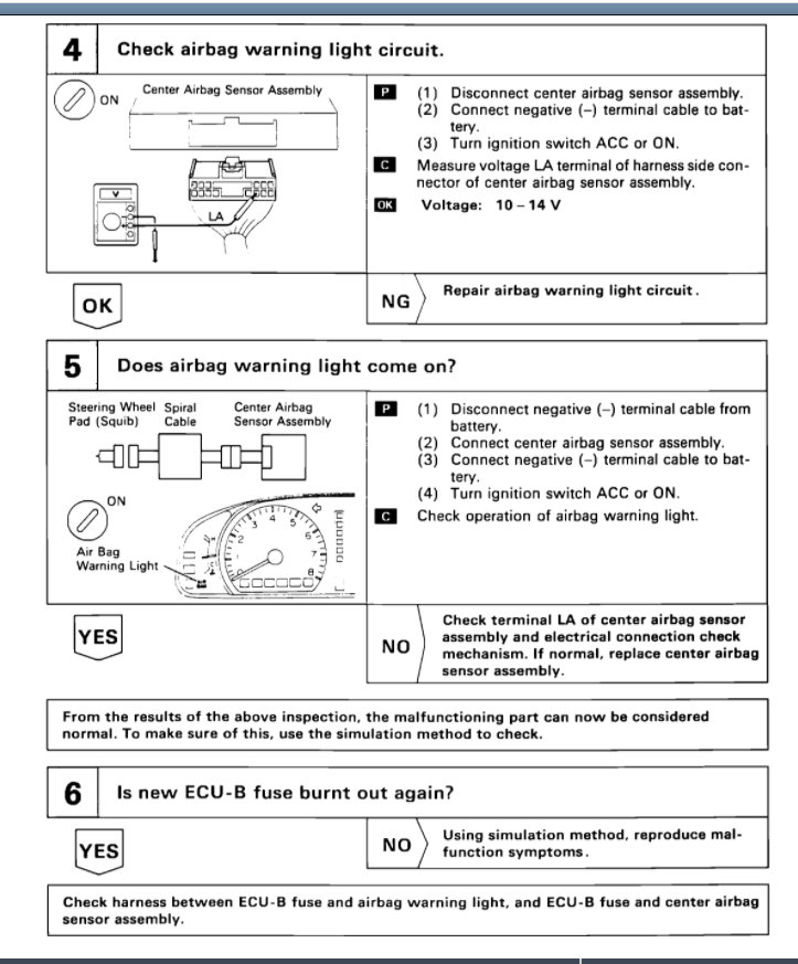

DENO2970
  • 19 POSTS
Kenny, I have no voltage at LA terminal of the Airbag Center Sensor assembly. I actually tested all of the exactly how the Diagnostic steps instructed.

DENO2970
  • 19 POSTS
Kenny, my sincere apologies. I double and triple checked LA pin at the plug while disconnected from center airbag sensor assembly and I did get the 10-14 volts. Note: The Airbag Warning Light stays off when disconnected and comes back on when connected to the Sensor Assembly. I hope I'm understanding this correctly, on the voltage test. If it has correct voltage, is it asking if the warning light is on while disconnected from the Sensor Assembly?

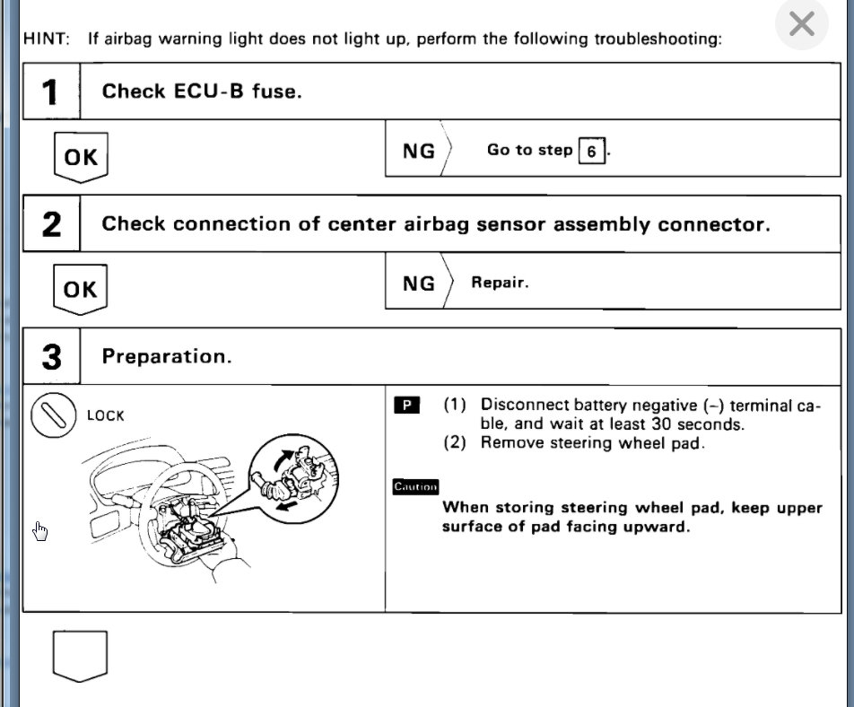

Okay. That is great. What this step is asking you to do is disconnect the battery. Connect the sensor back to the connector. Reconnect the battery and then turn the key on. Does the light come on? It may not stay on but when you turn the ignition on, the airbag light should do its self check where the light turns on and then off. If it stays on that is fine, it just means you have a code.
Sounds like your light does come on when it is connected. If it does then it is asking you to go to the next step and check the fuse and circuit as you may have a wiring issue.
Keep in mind it is important to follow the practice of taking the battery negative terminal off when connecting and disconnecting these connectors. If you don't and you get a quick short or spark the air bag can go off and that will injure you.
Just let me know if this is what is happening when you do this test and we can go from there. Thanks
DENO2970
  • 19 POSTS
Yeah, I've always disconnected the battery when plugging or unplugging these type connections.

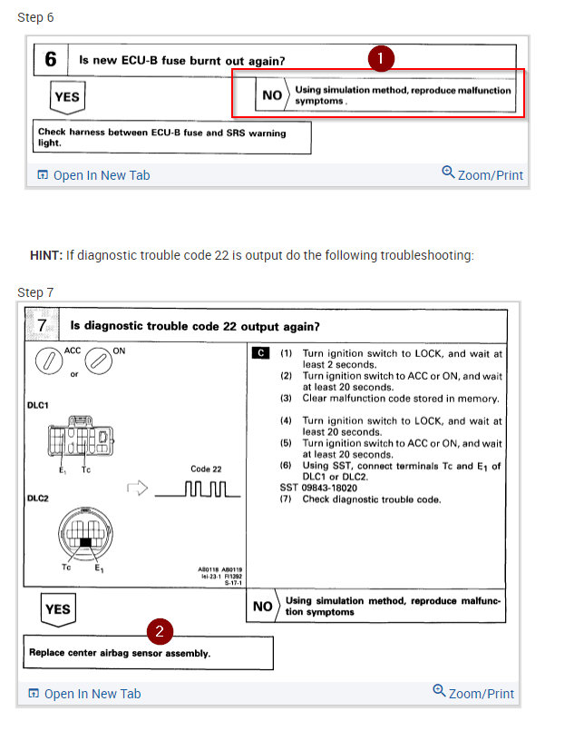

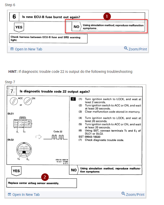

So how do I proceed? I got voltage, airbag warning light stays lit still, ECU fuse is good, still get code 22.
So do I need to jump to the step where I disconnect the steering wheel airbag spuib connection, right?
Yes. Take a look at the attachment. I show you are here where it is saying you need to clear the code, wait the proper amount of time and then check it again. If it comes back you need to replace the assembly.

COMERCIALAUTOSERVICE
  • 48 POSTS
  • 1992 TOYOTA CAMRY
  • 4 CYL
  • FWD
  • 229,225 MILES
This car never has accident and the air bag light it on please you can help me?

5. Code 22 is recorded when a malfunction is present in air bag warning light system. If an open circuit is present in air bag warning light circuit, AIR BAG warning light will not glow. Diagnostic codes (including Code 22) cannot be confirmed until warning light circuit is repaired.
