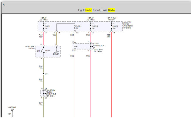

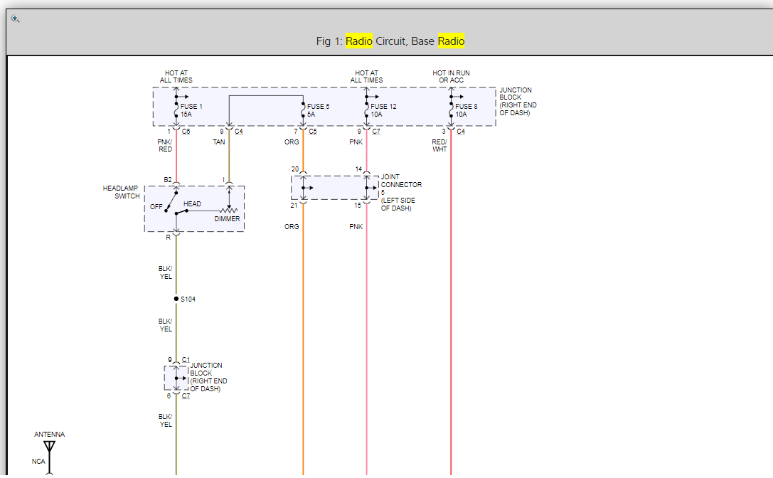

Here is a factory radio wiring diagram I hope this helps. This guide can help test the connections
Check out the diagrams (Below). Please let us know what you find. We are interested to see what it is.

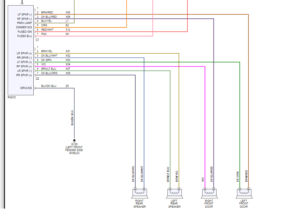

CAPO547
I have the gray and black plugs I am trying to find the left and right audio on it but don't know which one can't read the diagram that good if you can help me out
Thursday, August 27th, 2020 AT 11:07 AM (Merged)
CARADIODOC
  • 34,485 POSTS
I have that information, but it's on my computer that just went through a major house fire. If I don't get back to you within a week, post another reply to remind me.
