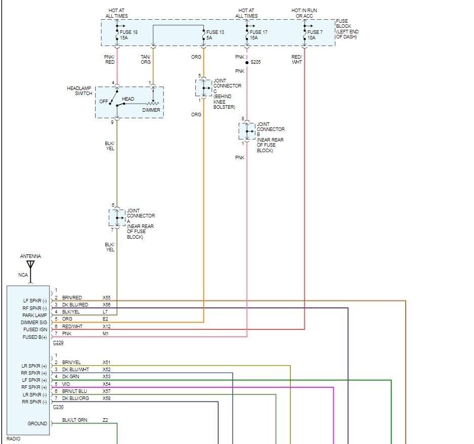

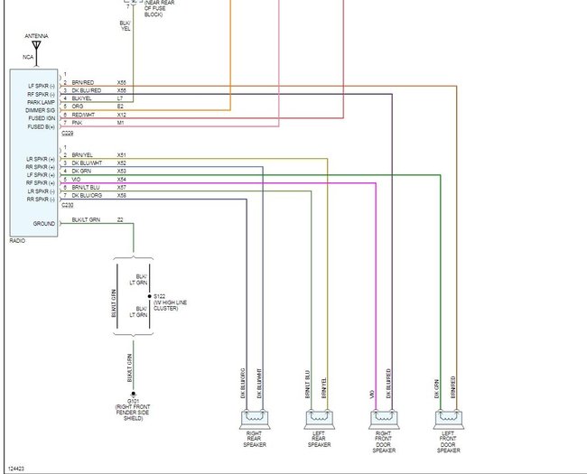

I need the color code for the stereo wiring in order to install an after market CD player. The wiring harness for the CD player has twelve wires if I am not mistaken. Ground, ignition power, constant power, antenna, +/- speakers (four).
Jul 11, 2008 at 9:36 PM
  • 54,878 POSTS
There are two different stereos for these trucks so got have both wiring diagrams for you and a guide to help you test which ones are ground and power
Please don't worry if the color coding of the wiring is wrong. It was very common for the OEM to switch wiring back then and they would basically pick the most common wire colors and make the wiring diagram reflect that color.

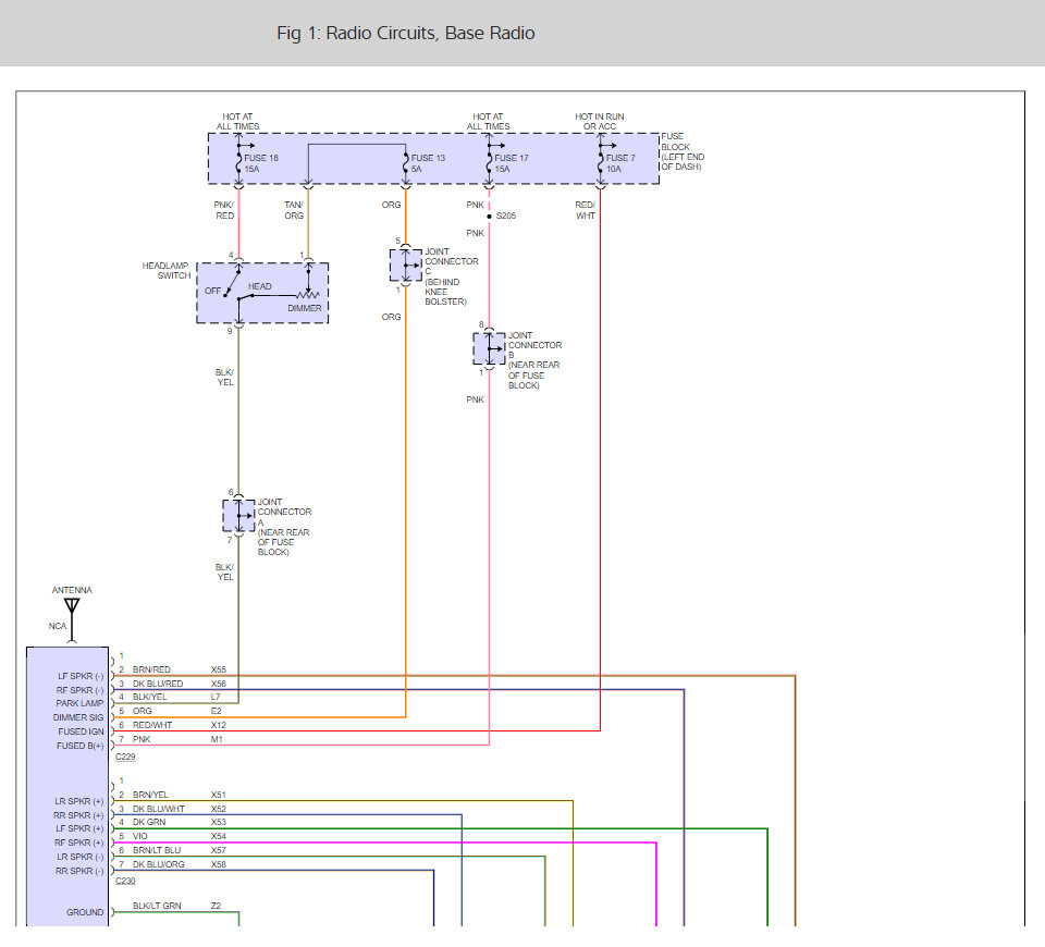

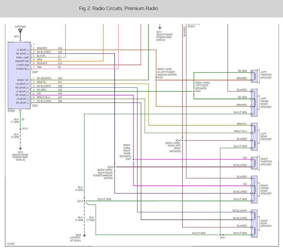

there are two different ones we need to know which is which. one picture is base other is premium.

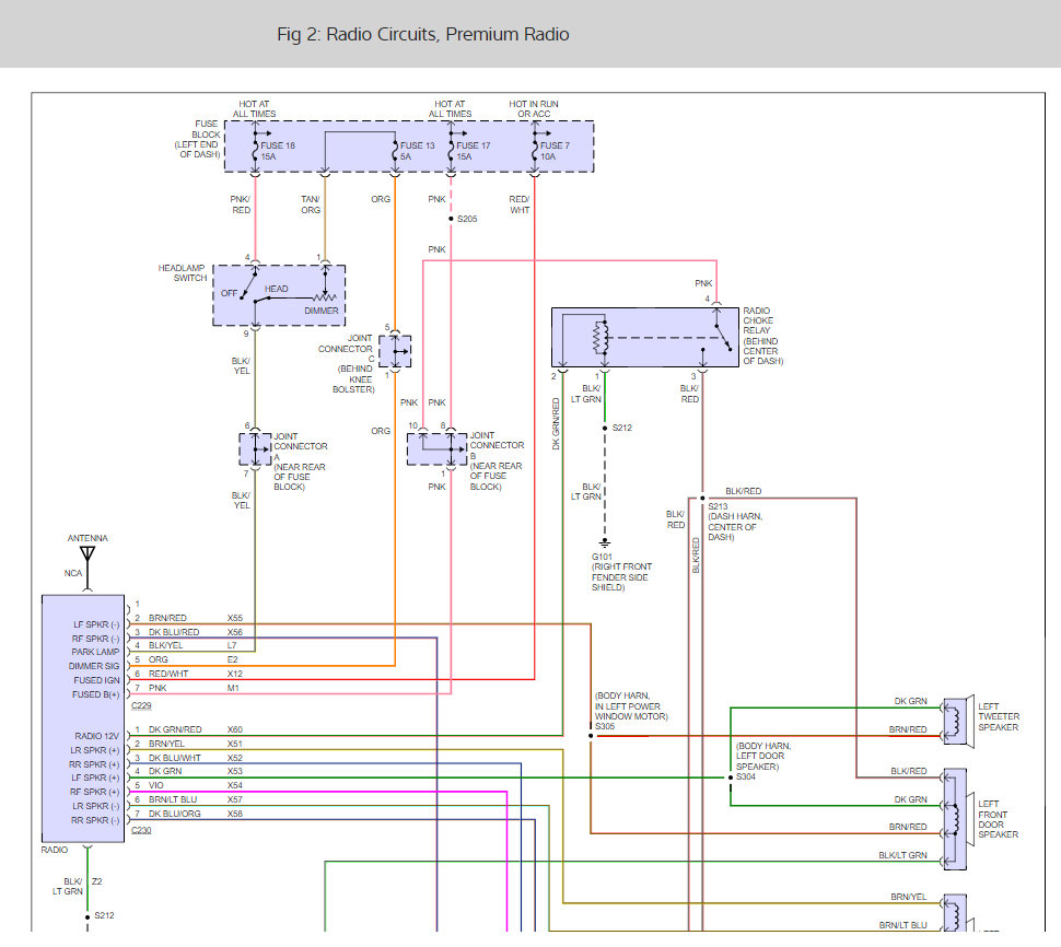

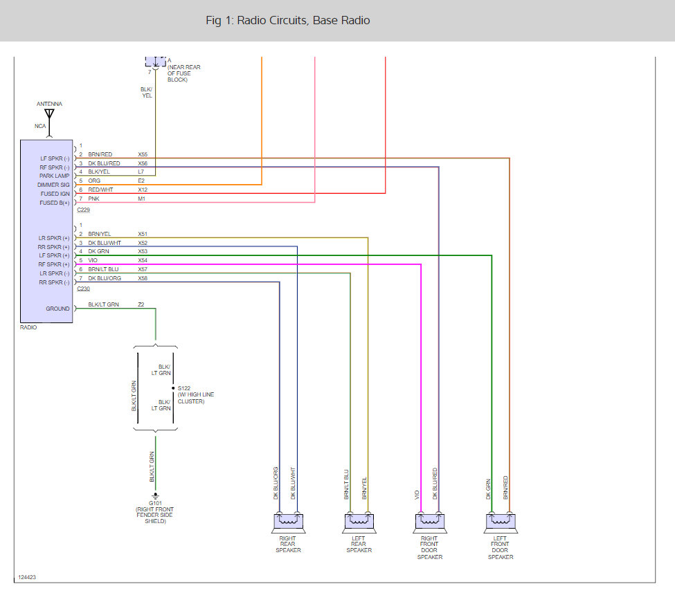

To me, it sounds as there may be a short in a speaker wire somewhere down the line. If the wire itself is touching metal it will shut the system sown preventing an overload (short) so you won't fry the deck. Have you put in an amp? or EQ?. If so make sure all wires are hooked up as factory directions indicates. You can also get a feed-back if your amp or EQ's out-put speaker wires are in reverse. ie you may have put the (+) wire to the (-). Just something to check out. Also did you make sure your yellow and red (power on and Acc) wires were correctly wired?
The wiring diagrams for your radio are attached below, check all wiring carefully to be sure its not grounding out

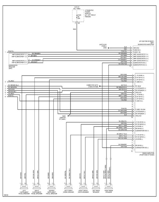

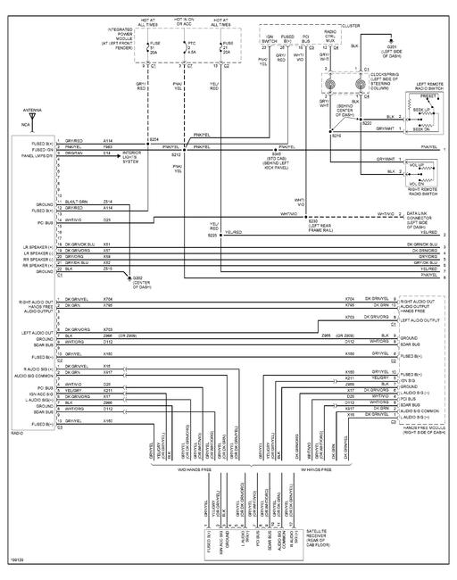

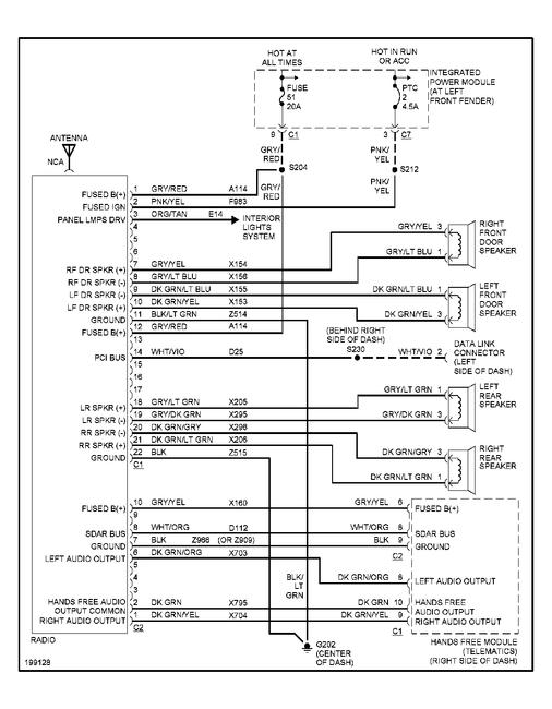

I have a 2005 dodge ram 1500 and I'm trying to put in an aftermarket stereo could you check my wiring to see where I went wrong
I have...
Black to black
Dark Green/yellow to gray
Dark green/light green to purple
Dark green/light blue to gray/black
Pink/yellow to yellow
Grey/light blue to black/white
Dark green/gray to purple/black
2 gray/red to red
Gray/light green to green
Gray/yellow to white
Gray/dark green to dark green/black
In the dash I have black/green, orange/gray, white/purple. Left and on the wiring harness I have dark blue left and don't know where to put it.
I'm not even totally sure the rest are right
Jun 26, 2019 at 6:21 PM (Merged)

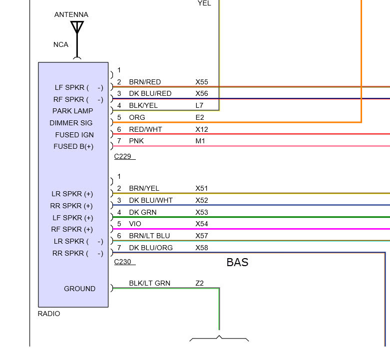

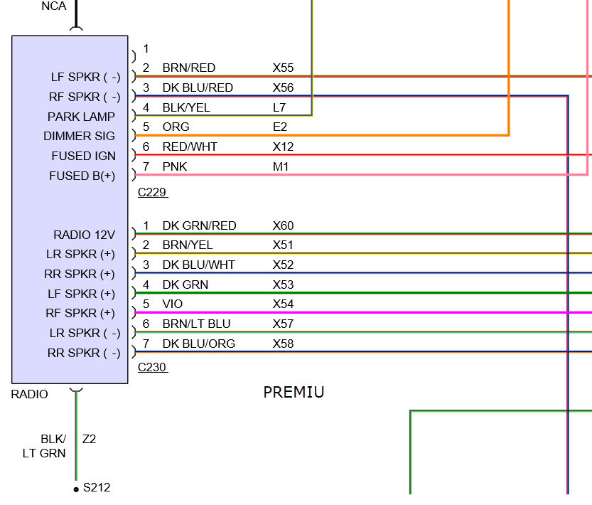

2 versions that were offered.......you should be able to figure out which system you have, by looking over the diagrams
1st diagram is the "base" radio diagram......in other words, the "run of the mill job"
2nd and 3rd diagrams are for the "premium radio"........sorta the "high dollar option"
you might copy these 2 and print them....then join the diagrams together
i think these diagrams will serve yo well....even though they are not colored, the colors are listed beside the wires when you get these, reply back and let me know what you think click on them to enlarge them below.
