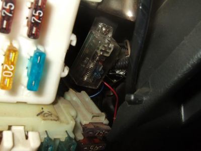

The pump makes noise now for the about two seconds. i have not started the car though and not sure on what to do. i am sending a picture of something near the fuse box that looks like someone put into the system. let me know what i should do now that the pump makes noise. thanks again

Cannot say I know what that is.
You say the pump is turning on now. Check for pressure.
