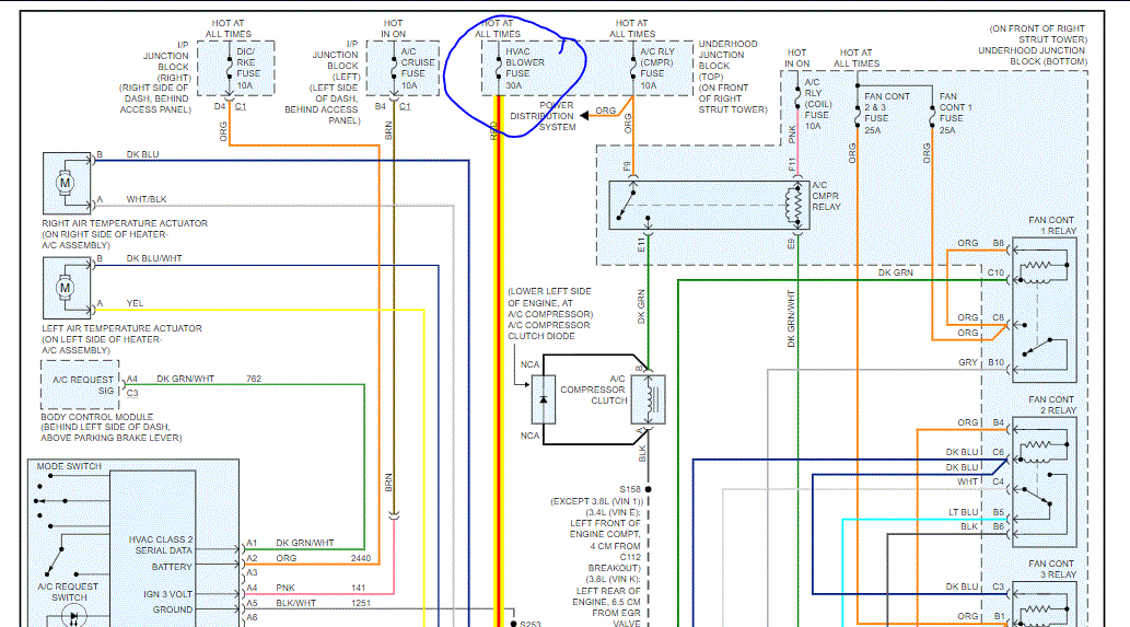

I have the car listed above with a 3.4L and my AC/heat does not blow.
Sunday, September 13th, 2020 AT 12:58 PM
MECHANIC
52,796 POSTS
Good afternoon,

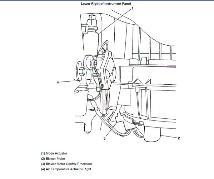

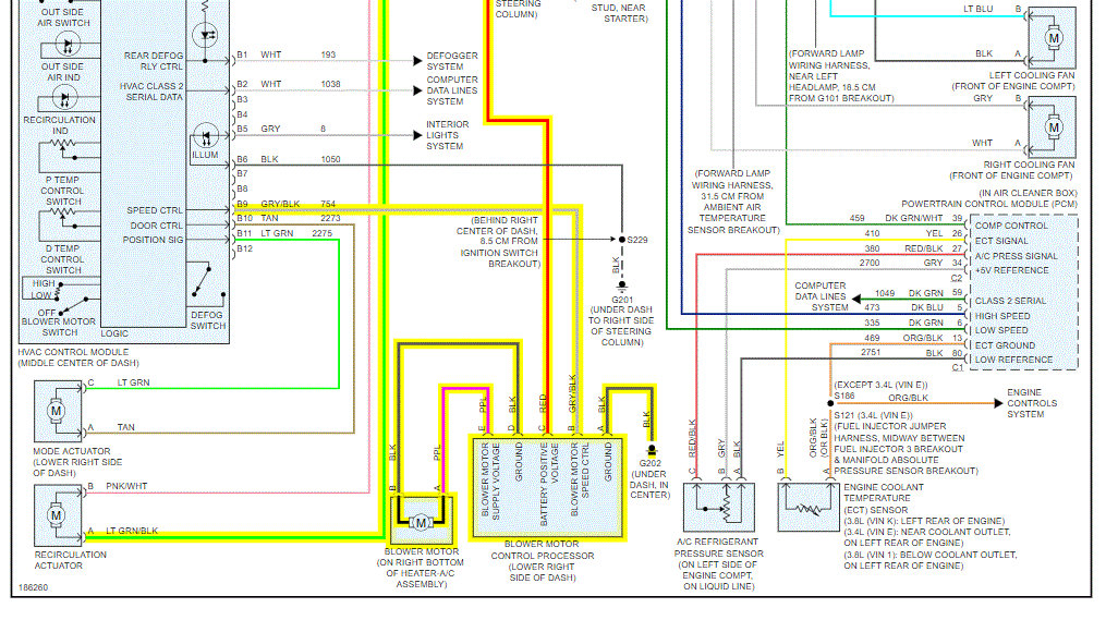

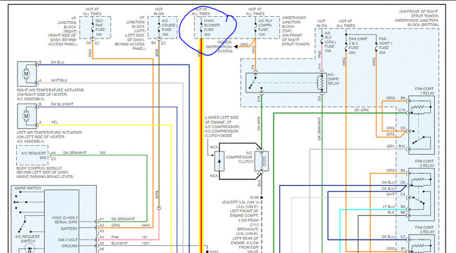

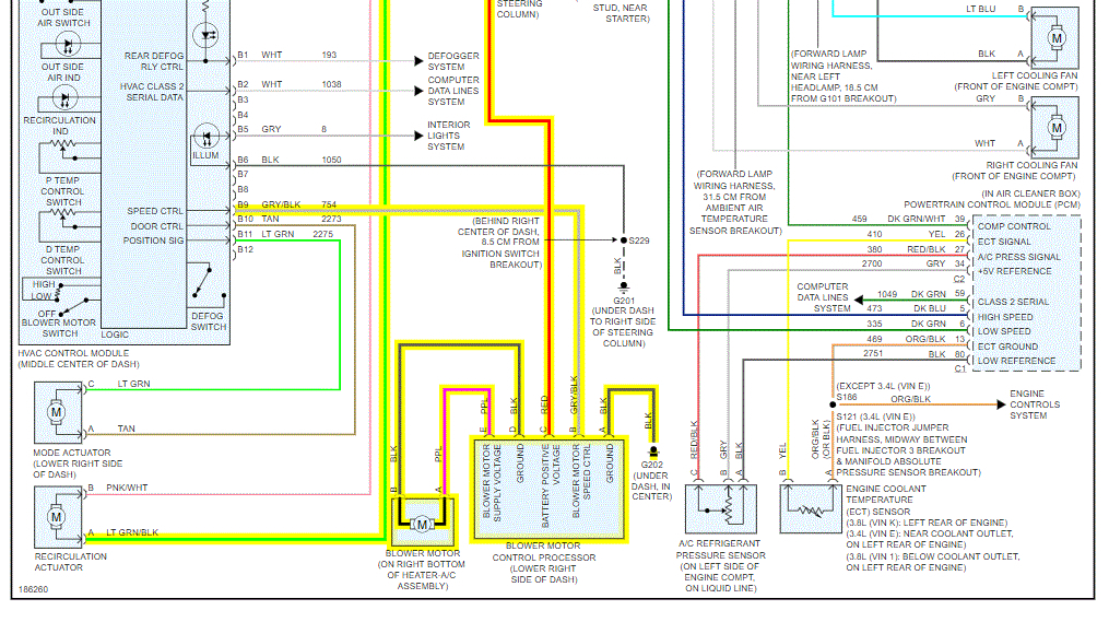

The most common cause is the blower motor for this but needs to be verified.
https://www.2carpros.com/articles/blower-fan-motor-works-on-high-speed-only
Do you have a test light or voltmeter to do some testing?
I attached a diagram for you to view for our testing.
