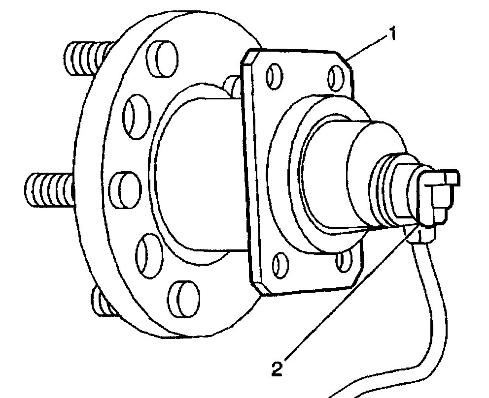

ABS Light is on, Trac Off, and when i accelerate my car it shakes.
Feb 23, 2019 at 7:19 PM
  • CAR REPAIR CONTRIBUTOR
  • 110,190 POSTS

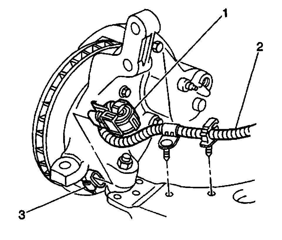

The ABS and traction control work together. Since the ABS light is on and traction control (TC) is off, my first suspect is that a wheel speed sensor has failed. That will cause both of the issues. As far as the power issue, if the computer thinks the vehicle is spinning a wheel, it will limit power from the engine and cause what you feel.
Now, my first suspect is one of the front wheel speed (ABS) sensors. Often times, the front wheel speed sensor harness may wear or come into contact with the tie rod end stud. This can damage the wiring harness and cause the problem.
I attached a picture of the sensor wiring connector behind the hub of the front wheels (Picture 1) . Take a look at it and then check for damage on your vehicle. If the wiring is in good condition and there is no evidence of damage, I recommend on of the two things.
First, have the computer scanned to identify specific diagnostic trouble codes. This can identify the exact problem and save time. Here is a quick video showing how a scanner is used. If you don't have one, often times a parts store will do it for free.
https://youtu.be/YV3TRZwer8k
Second, if you have no access to a scanner, here is a link that shows hot to check the ABS sensors:
https://www.2carpros.com/articles/abs-wheel-speed-sensor-test
Also, here are a couple links that show how to use a volt meter as well as check wiring.

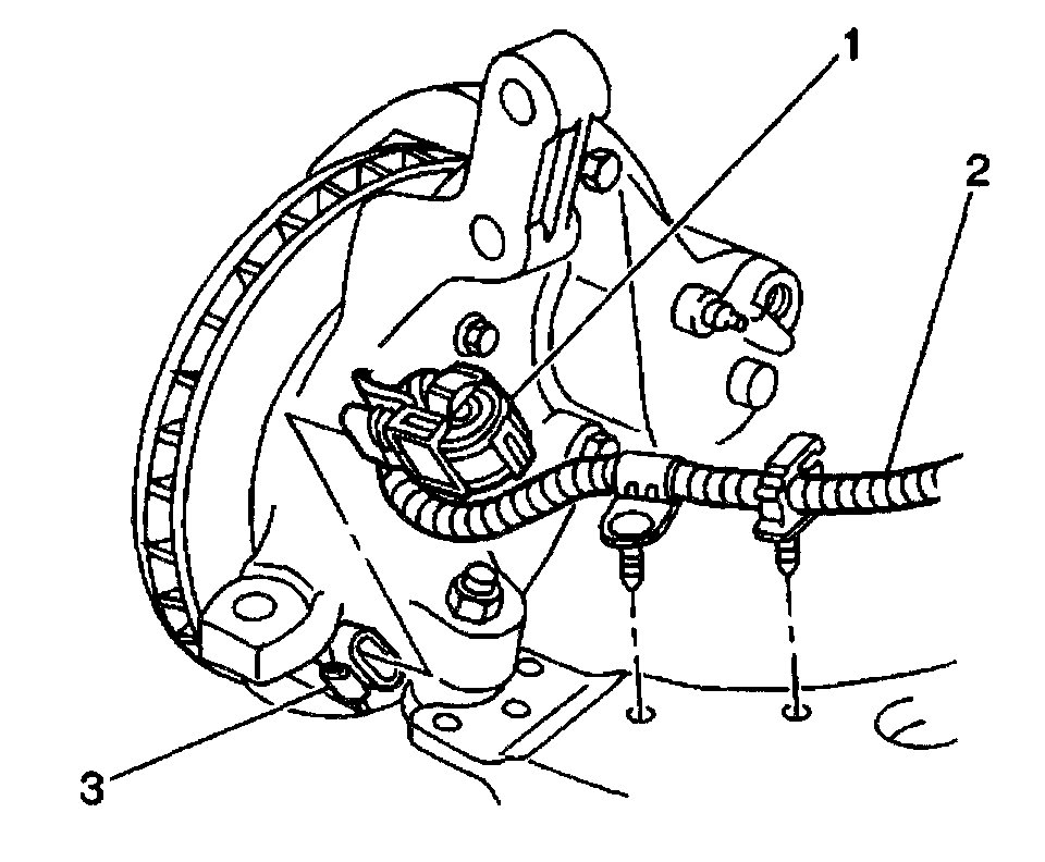

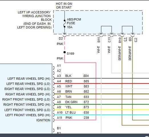

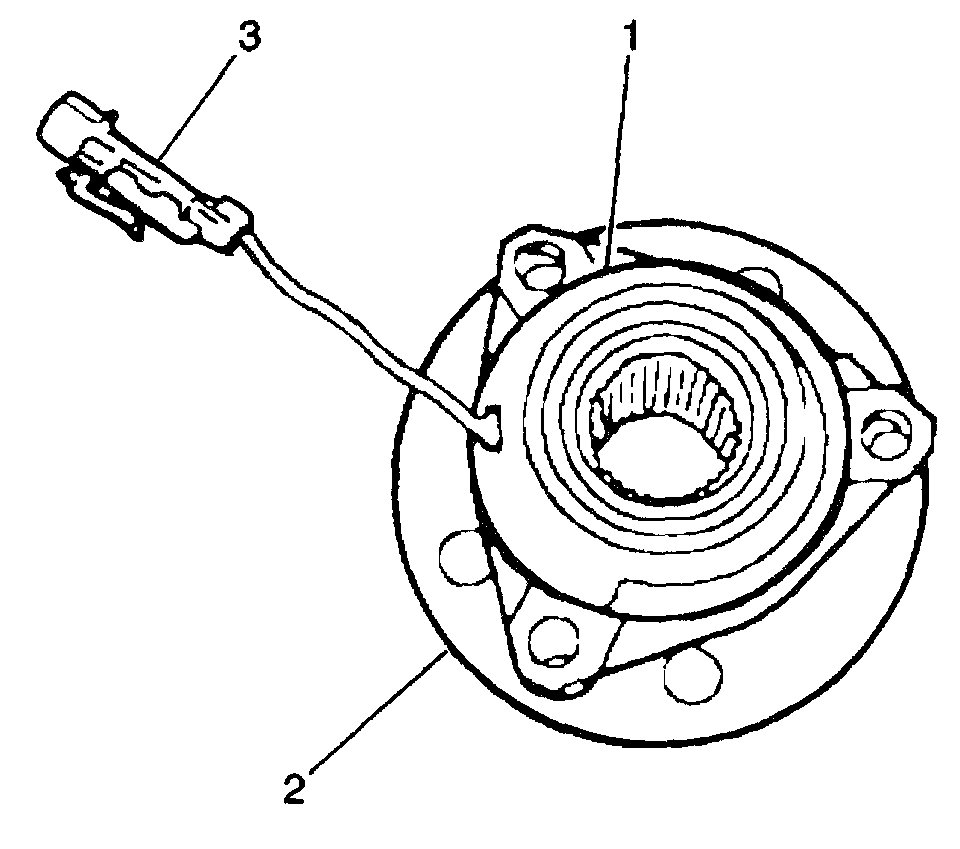

Keep in mind, there is also a fuse that could be bad. At the end of the dash on the driver's side is a fuse box. Check the ABS/Traction control fuse. See picture 2.
Here are a couple links relate to checking fuses and how to use a test light:

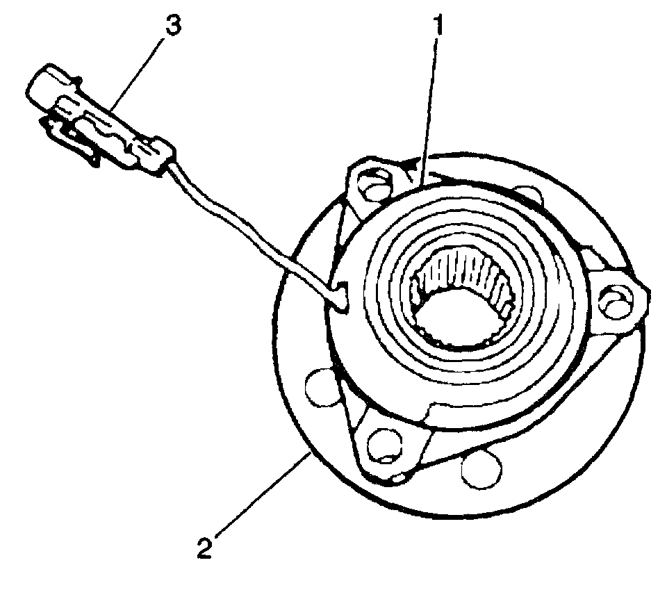

If you determine one of the rear sensors has failed, the entire hub assembly needs replaced. The sensor is part of it. Here are the directions. The attached pictures correlate with these directions.
WHEEL SPEED SENSOR REPLACEMENT - REAR
Wheel Speed Sensor Replacement - Rear
Removal Procedure
Important: The rear wheel speed sensors and rings are integral with the hub and bearing assemblies.
If a speed sensor or a ring needs replacement, replace the entire hub and bearing assembly.
Picture 3

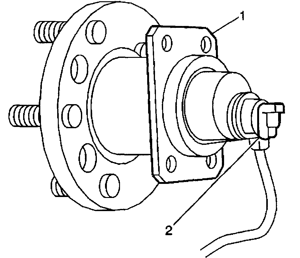

3. Disconnect the electrical connector from the rear wheel speed sensor.

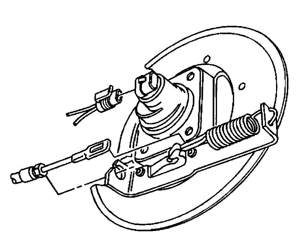

Picture 4
4. Remove the hub and bearing assembly (1).

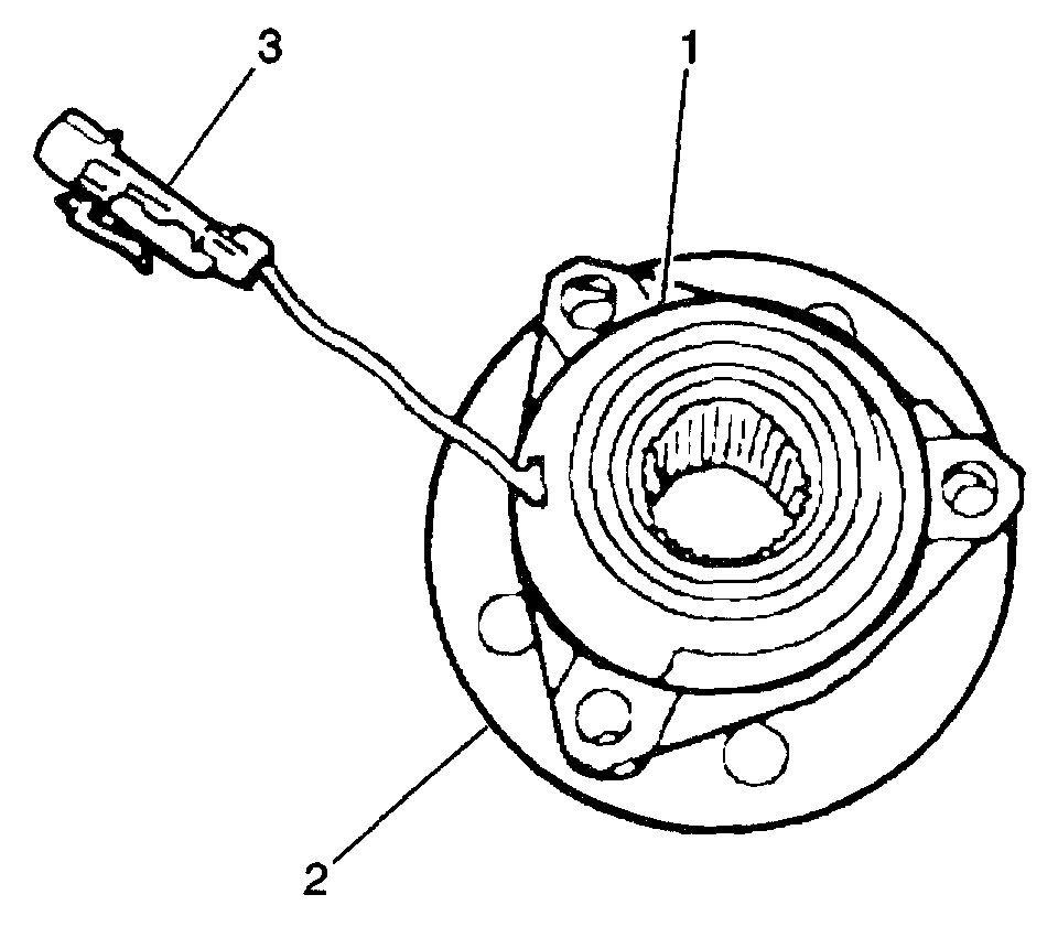

Picture 5
1. Install the hub and bearing assembly (1) to the vehicle.

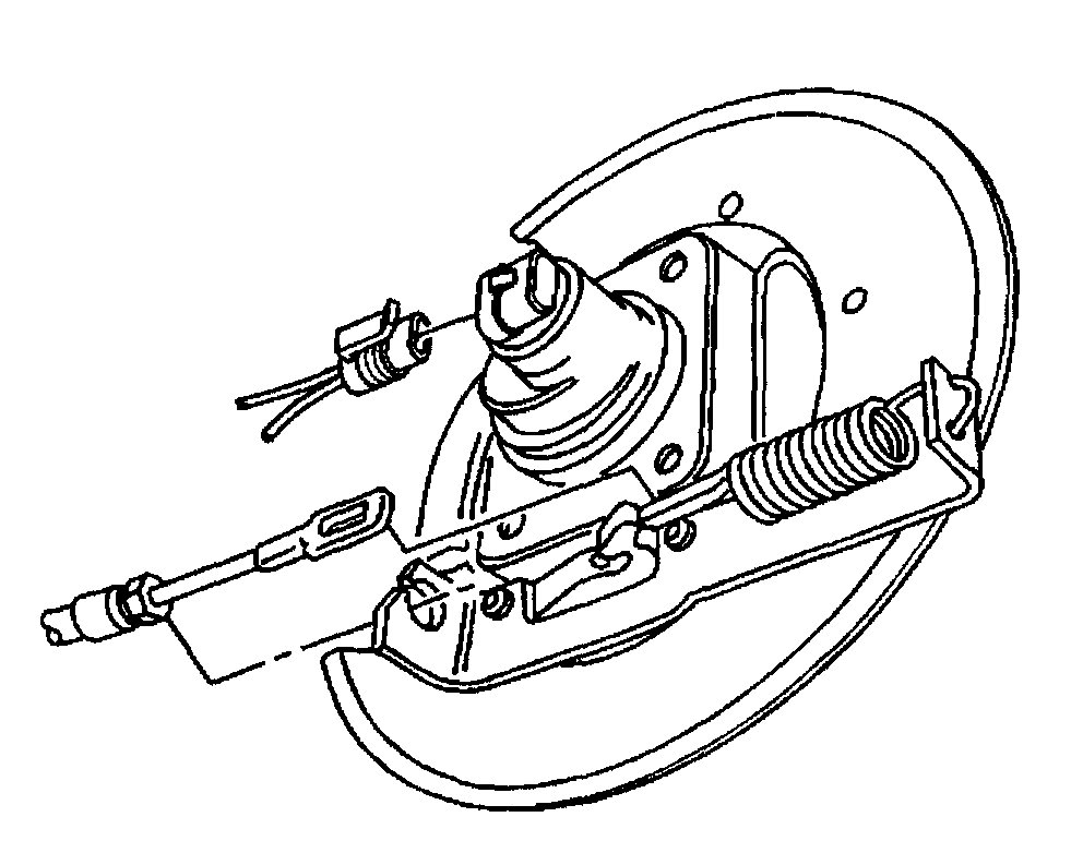

Picture 6
2. Connect the electrical connector to the rear wheel speed sensor.
