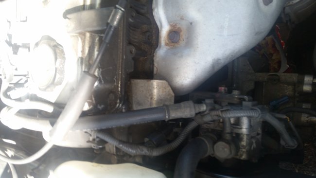

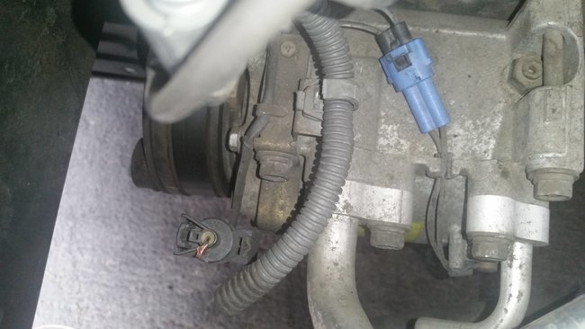

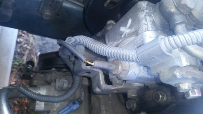

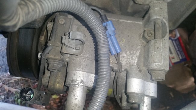

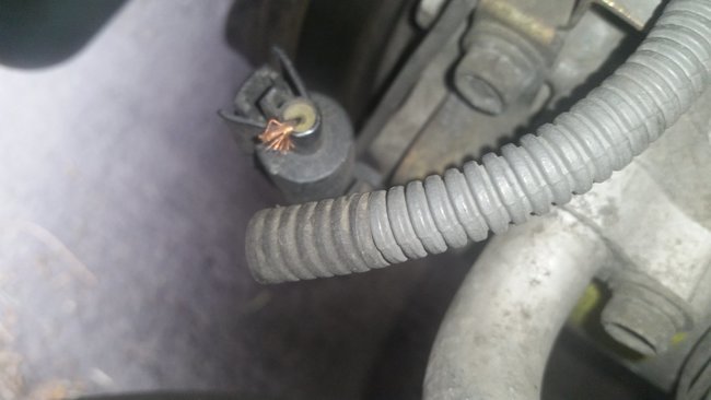

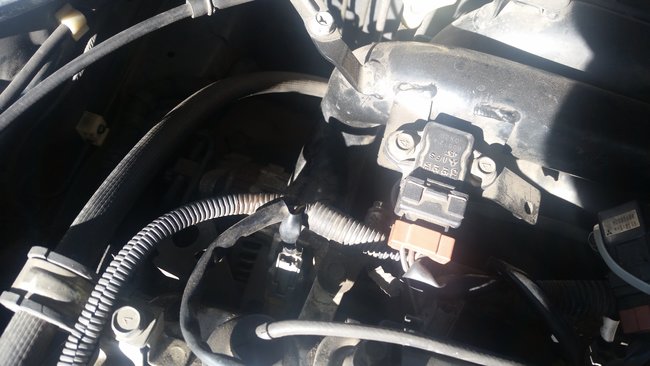

So what's the name of the sensor in these pictures that had broken loose? We soldered it back together and that fixed the A/C. It stopped blowing cold yesterday, and it has broken loose again. I don't think there's enough wire left on the sensor itself to solder it back together again. So probably gonna need a replacement.

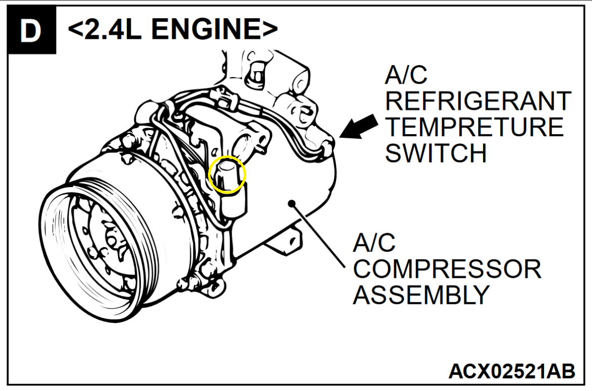

I've circled the sensor in yellow on the diagram. Of course nowhere in the repair manual do they actually put the name of it that I can find.
Tuesday, June 9th, 2020 AT 2:18 PM
The connector you circled is for the temperature switch.

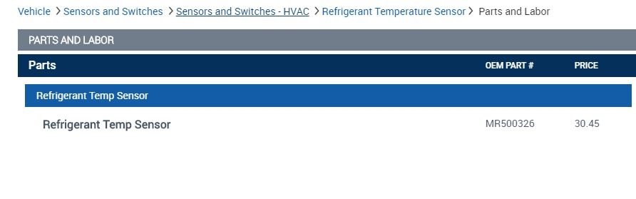

Can you find the part for me? Temperature switch just seemed to bring up the ECT sensor and engine cooling fan sensor. Which temperature switch are you referring to?
Tuesday, June 9th, 2020 AT 3:10 PM

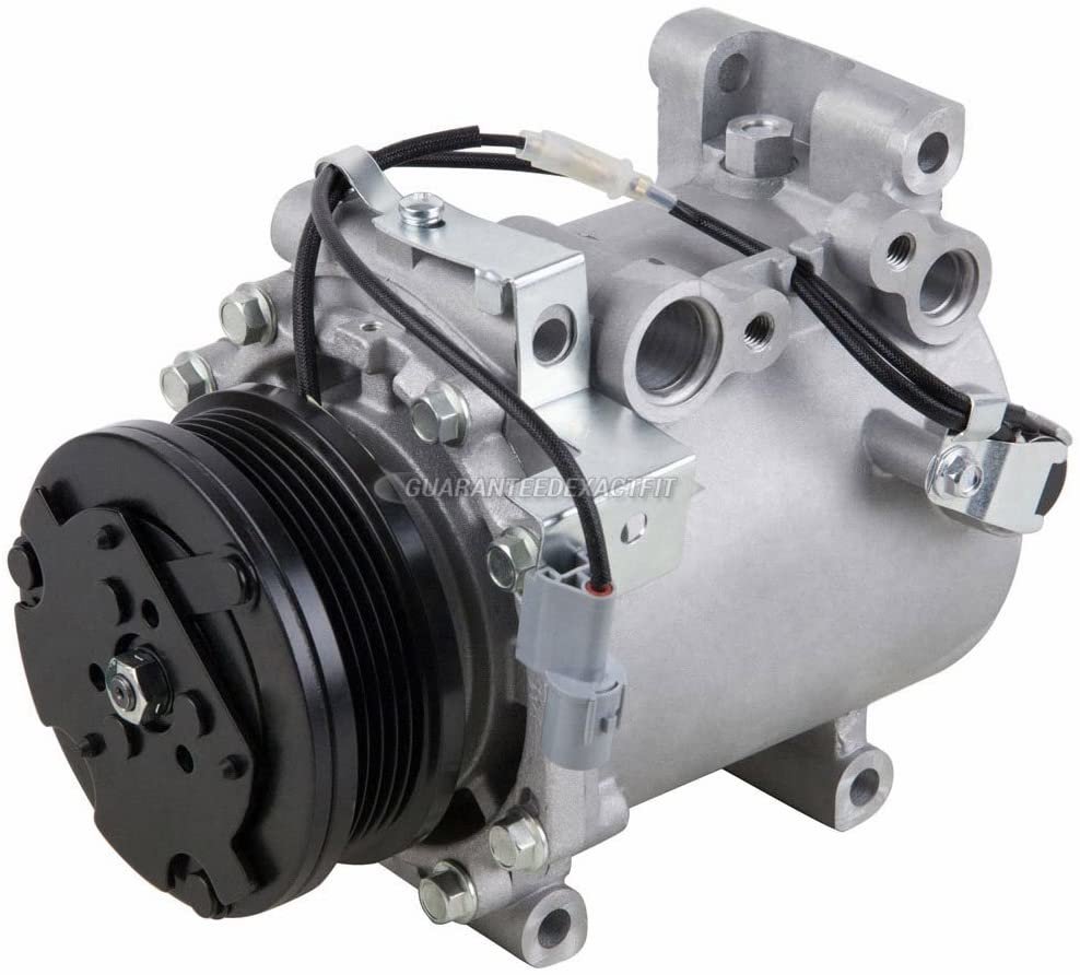

Okay, I attached the part number for you. You need to contact the dealer parts department to confirm price and availability.

The part you linked appears to connect to the opposite side of the compressor from the connector I'm talking about. I'm attaching more pictures. It is a one wire connector that is housed in a ribbed gray plastic shell, and it continue all the way up to the main wiring harness behind the engine with the MAP sensor and such. So I suppose a complete replacement would include the wire all the way up to this point, or to replace the entire connector harness.

The connector is the round black circle connector in the bottom left of the last picture. It's right up next to the pulley.
Tuesday, June 9th, 2020 AT 5:09 PM
The only other connector is for the clutch itself which is part of the compressor.
I could not make out anything from your pictures.
Wednesday, June 10th, 2020 AT 1:21 AM
KIWASABI1
  • 198 POSTS

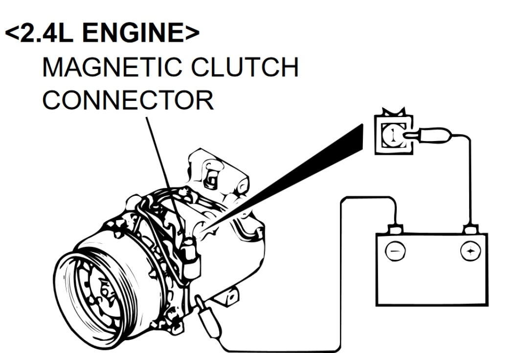

Mostly the last picture is the useful one. It shows exactly where the connector sits on the compressor. The black circle connector in the lower left is the connector in question.
Can you find the part number for the A/C clutch connector then? This appears to be spliced in directly to the main harness though. That's what the other pictures are supposed to show, that the gray sort of ribbed plastic housing for the wire continues all the way up to the main harness, splicing in right around the MAP sensor. There is no other connector that it plugs into, like the refrigerant switch sensor that you mentioned above does.

Here's a perfect picture. It's the connector right by the clutch. So I guess you're right, it's the A/C Compressor Clutch Connector. I can't for the life of me find one online. I found Standard Motors part #S-1530 which is very similar, but it's 2-wire and has a slightly different connector from mine.
Wednesday, June 10th, 2020 AT 1:47 AM
KIWASABI1
  • 198 POSTS
I finally found it in the repair manual. It's called Magnetic Clutch Connector in there. But searching for that brings up no results. This may simply be a junk yard item only.
Wednesday, June 10th, 2020 AT 1:52 AM
There is no part number for the connector. It is not serviced separately.
You could just bypass the connector and solder and shrink wrap the wires together to eliminate the connector itself.
