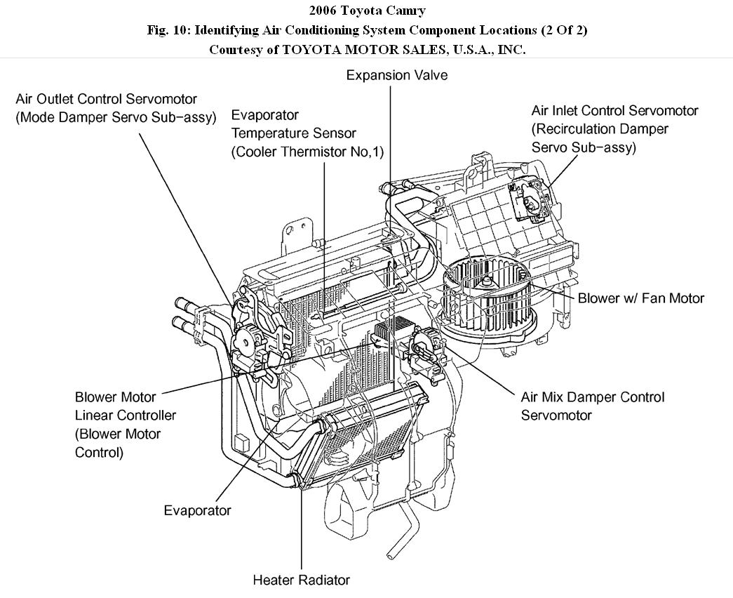

My Toyota Camry is having problems with the left bank vents blowing warm air, while the right bank vents are all blowing cold air
Friday, November 27th, 2020 AT 8:27 AM (Merged)
KHLOW2008
  • 41,814 POSTS
Such problems are caused by the air mix servomotor or its linkages. Try switching between heater and A/C a few times and note fif the servomotor is running correctly.

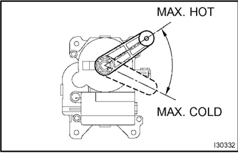

Thank you for your reply KH Low. I have tried the fix you suggested, but it does not work. My air cond is a manual one (not auto/ temperature control type). Does this type of air cond have Air Mix Servomotor?
KHLOW2008
  • 41,814 POSTS

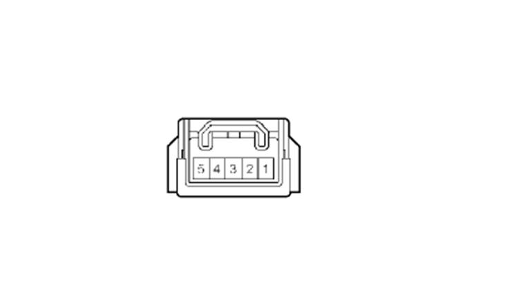

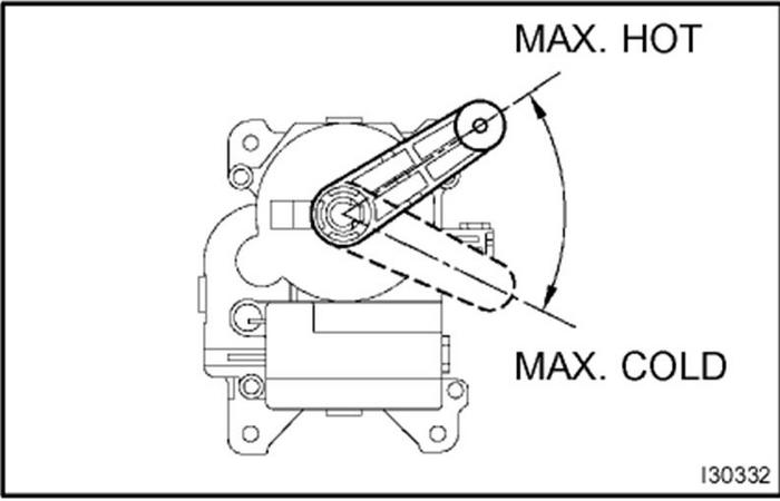

Yes, even the manual system has the servomotor.
Inspect servomotor operation.
1. Connect the positive (+) lead from the battery to terminal 4 and negative (-) lead to terminal 5, then check that the arm turns to "COLD" side smoothly.
2. Connect the positive (+) lead from the battery to terminal 5 and negative (-) lead to terminal 4, then check that the arm turns to "HOT" side smoothly. If operations are not as specified, replace the air mix servomotor.
