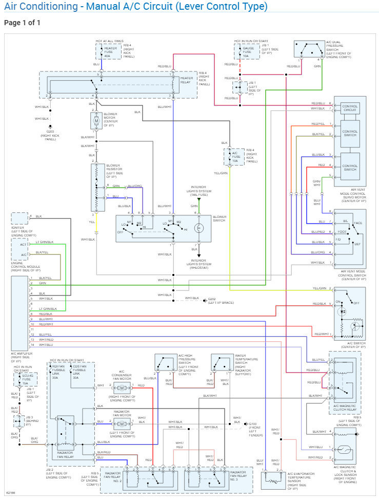

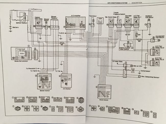

Here is your wiring diagram. It appears this one uses an amplifier (module) also.
Nov 27, 2020 at 8:48 AM (Merged)
SZALKUSKT
  • 274 POSTS
Is there a better way to attach the image of the diagram? I am having a hard time reading it. It seems to be small. Is the rpm sensor on it? Also, I do know that before my A/C clutch completely stopped working the clutch and fans would energize simultaneously. Possibly both fans not one. But I do know that the fans turned on and off abruptly/quickly as well as the clutch. Also at this time the A/C button green light would not illuminate but the switch did turn on and off the clutch/fans.
WRENCHTECH
  • CAR REPAIR CONTRIBUTOR
  • 20,761 POSTS
There is nothing I can do about the size. The site shrinks it down automatically. You may have to save it to you computer and then enlarge it. The tachometer sensor is inside the compressor in the lower right of the diagram.

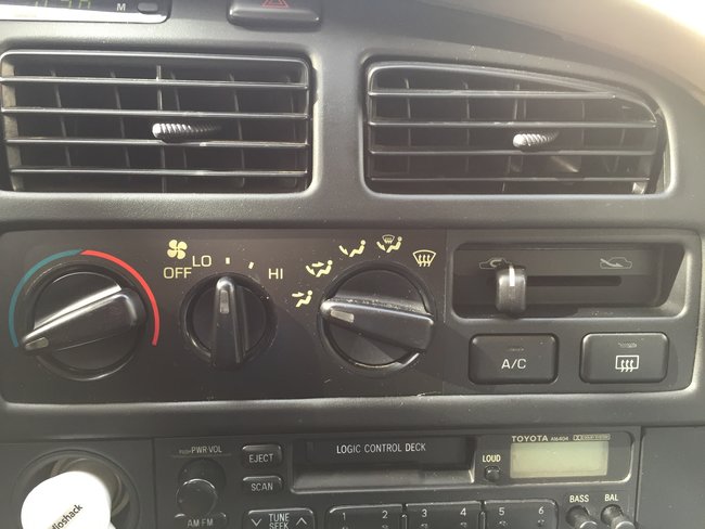

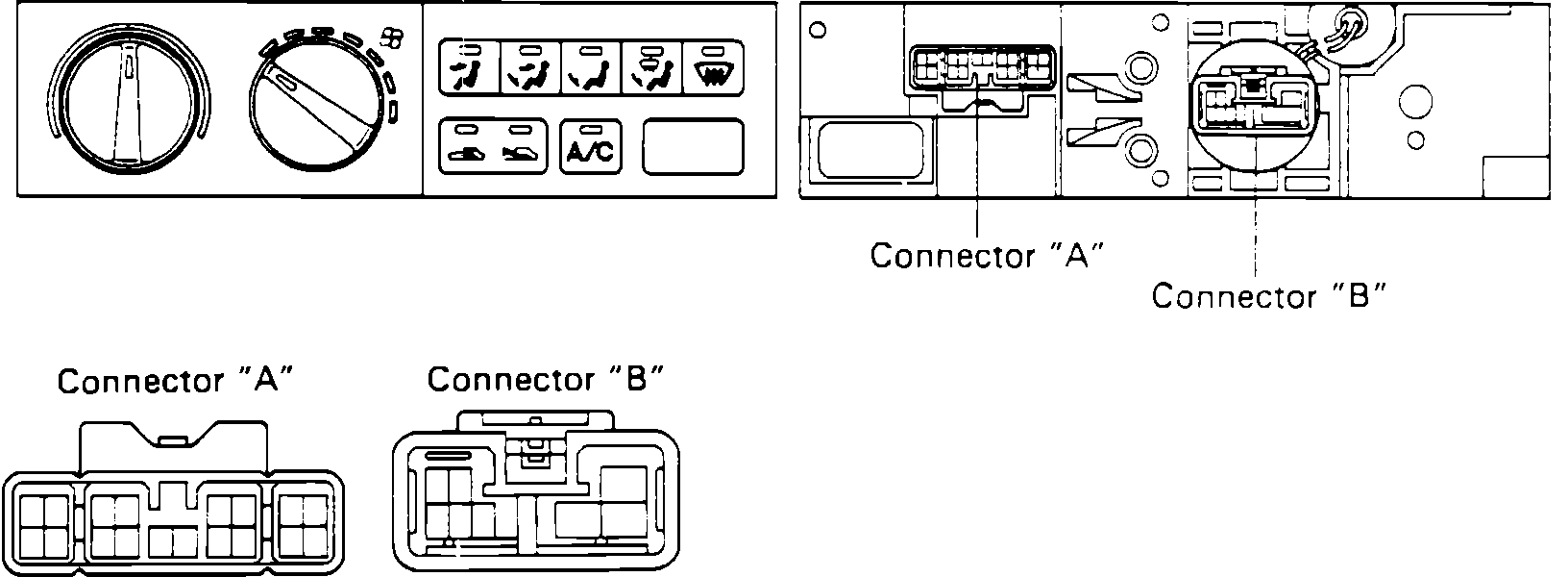

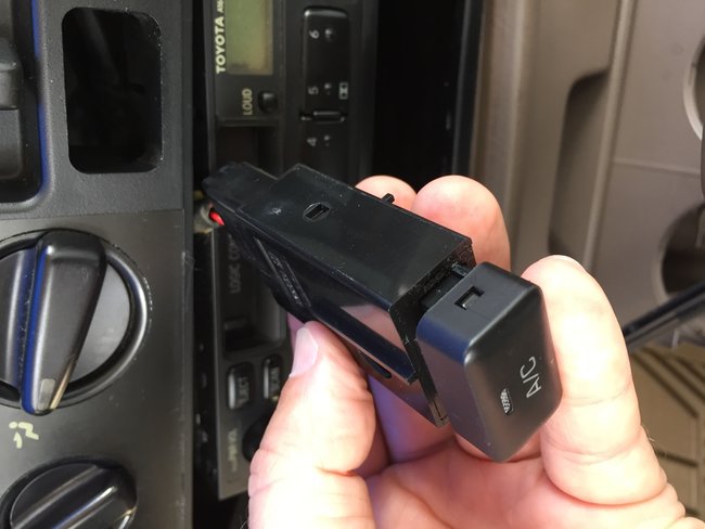

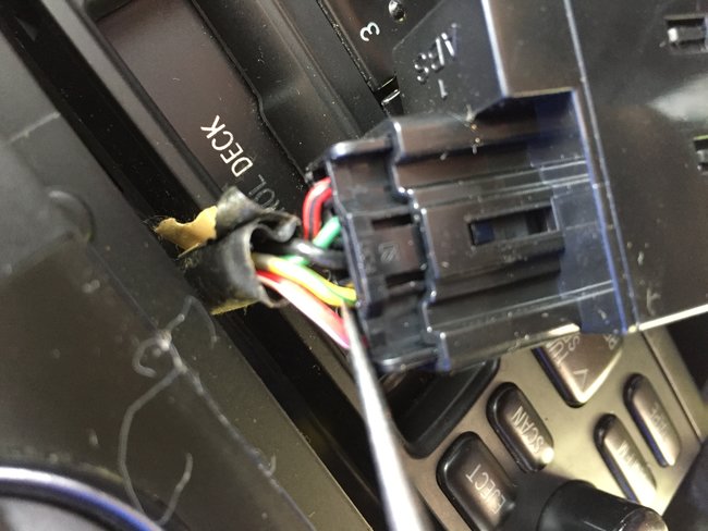

SZALKUSKT
  • 274 POSTS

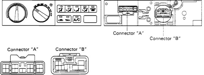

This is the kind of control panel I have. I still do not understand what they mean by push button or lever type. I was able to find a diagram online and there are two different diagrams like you said, one for push button and one for lever type and I am not sure what they mean. That is why I took a picture of my control panel.

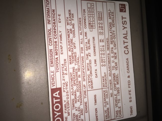

SZALKUSKT
  • 274 POSTS
My car is a 2.2 L, 5S-FE engine.
WRENCHTECH
  • 20,761 POSTS
I gave you the correct diagram. You have lever type. This picture is what the push button type would look like.

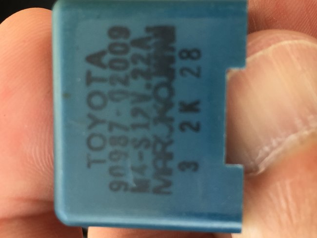

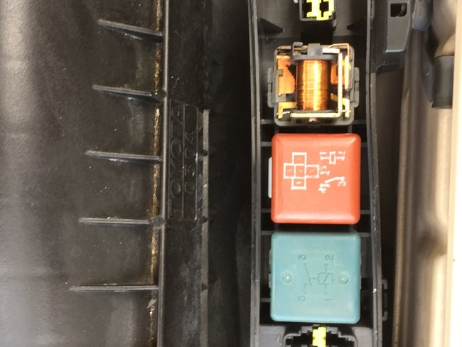

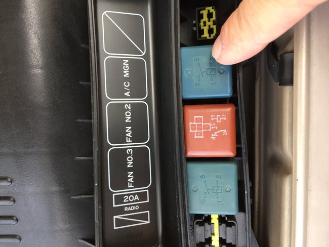

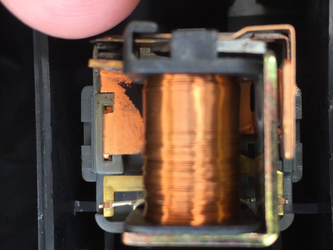

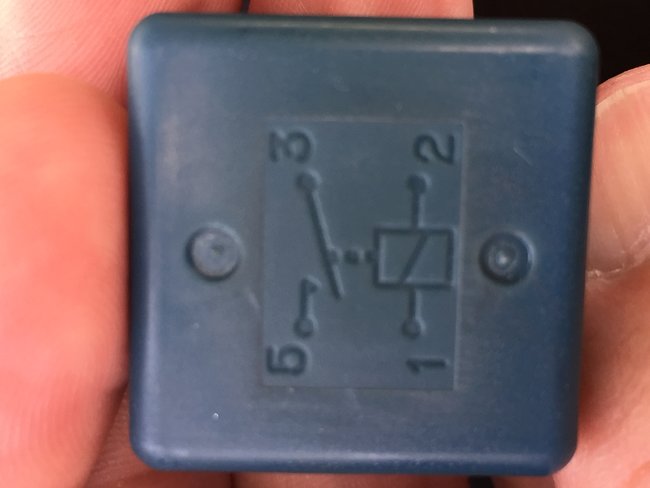

I looked at my relay under hood by the air cleaner, drivers side front. Relay looks like it was cycling on and of a lot because it was blackened a little on the contact area. I removed it and checked it with battery voltage and a test light and the coil is working and allows power to transfer through and holds. Also, I have a 1992 parts car with lever type and I took that relay from the parts car and installed it and no difference. I did notice that the parts car AC switch light works even with or without the relay installed so that leans me towards the AC switch in dash control panel because my car initially had the problem of only the AC light not coming on, but AC system worked fine and AC blowing cold. I did hold down contact of the exposed relay with engine running and AC compressor clutch came on and air started to come out cold quickly.
WRENCHTECH
  • 20,761 POSTS
The relay operates the compressor clutch, not the control head.

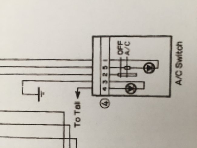

Schematic I have also.

SZALKUSKT
  • 274 POSTS
Okay, I am going to look at the switch now after I access it via dash panels. Yeah, I was thinking same thing that the switch tells amplifier what to do.
SZALKUSKT
  • 274 POSTS
The yellow wire with green tracer. It has power when key is in “on” position.
WRENCHTECH
  • 20,761 POSTS
So, the switch should be lighting up at least and it is not. You might try getting some electrical contact cleaner and spraying it inside the switch while working the button, unplugged of course.
SZALKUSKT
  • 274 POSTS
I have another switch from parts car.
SZALKUSKT
  • 274 POSTS
Installed another switch same thing no change. With test light switch has power to yellow/green tracer wire and switch controls power to red/black tracer wire. I can observe the switch controlling power out to red/black tracer wire.

Looking at your diagram I cannot figure out why the light is not coming on when switch is depressed. I know I have power coming in and power out when depressed.
WRENCHTECH
  • 20,761 POSTS
It needs to have a ground path through a component on the output to complete the circuit.

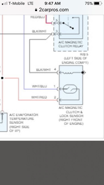

Based on the diagram and both AC switches not lighting up, and what you mentioned initially, I am scrutinizing this rpm sensor on the AC compressor.
SZALKUSKT
  • 274 POSTS
The magnetic clutch and lock sensor is shown open in the diagram. How can I check it to verify it is bad?

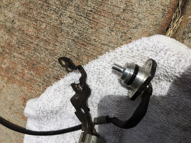

SZALKUSKT
  • 274 POSTS
The white/blue white/red wires are going to the sensor. This is what it looks like.

Still trying to figure out why light in A/C switch not coming on. I need help figuring out the diagram. You said it needs a ground path on the output of a the A/C switch to light up the button. I cannot figure out what to check.
SZALKUSKT
  • 274 POSTS
The two wires coming out of the A/C switch go to the amplifier.

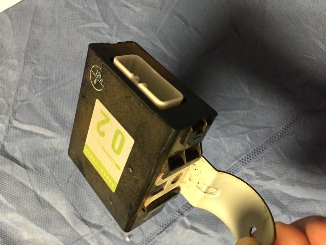

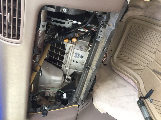

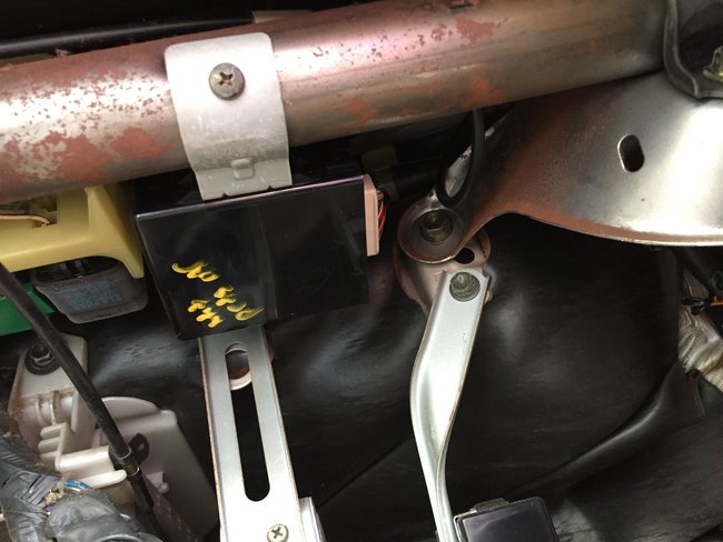

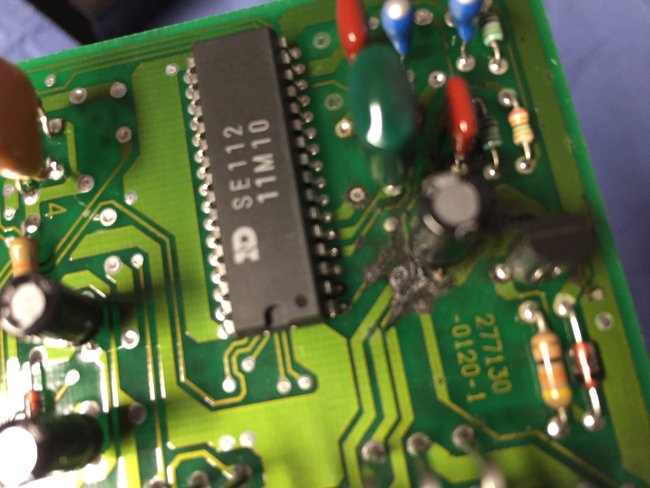

SZALKUSKT
  • 274 POSTS
I am pleased to report that I swapped out the amplifier with one from junkyard and It fixed my problem. Everything is working fine now. The glove box has to be removed and the amplifier is attached by a Philips screw and bracket to the tube that supports the dash. I am mentioning this so others will know. My AC light was not blinking but totally off. That is why I decided to change the amplifier before the rpm sensor on the compressor. Like you said, the blinking light is associated with the rpm sensor. I opened up the amplifier and I could see burning on the circuit board.Thanks for your help with this.
SZALKUSKT
  • 274 POSTS
This is what the amplifier looks like.
