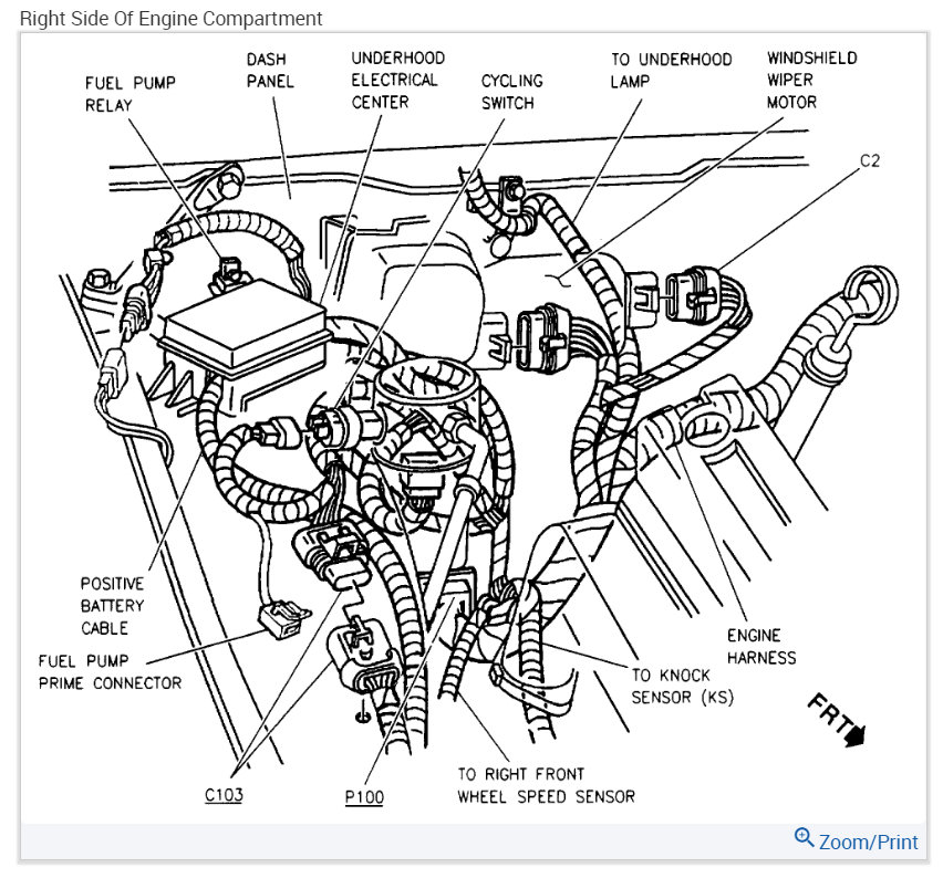

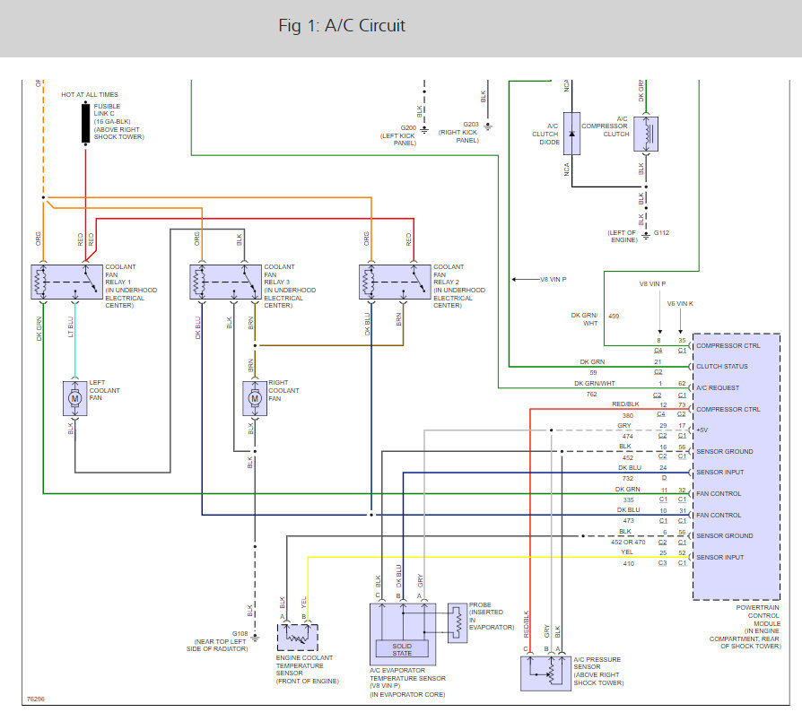

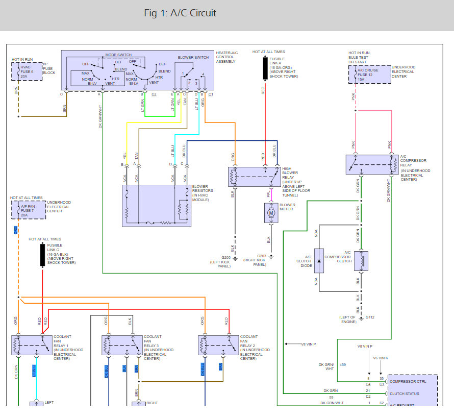

This sounds like a connection is heating up and shutting off the compressor. When the AC stops can you see if the clutch is still going? Here is a guide to help you test the wiring and the AC wiring diagrams so we can see how the system works:
If the compressor is still going can you grab a hold of the large AC tube coming out of the firewall to see if it is cold please?
This guide can help as well.
Check out the diagrams (below). Please run this test and get back to us.
