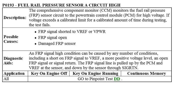

DECAPTAIN2010
  • 75 POSTS
Long time my good friend. My problem still persist with the codes p2104, p2112 and po193 even after I bought a new fuel pump.I also see that it is a returnless fuel line. Again, each time we tried to use our hand to open the throttle plate, the engine tries to accelerate but goes off again maybe because of uncleaned air. To me but not too sure I think the problem lies between the throttle body, TPS and the fuel pressure regulator. Please give me your expert view as this problem has taken long now but I still believe we can still make it work. Again the idling is perfect, no fluctuation even with A/C on. Thanks for your time
Saturday, August 27th, 2011 AT 3:53 PM
KHLOW2008
  • 41,814 POSTS
P0193 is not a fault with the fuel pump and replacing it is not going to help.
You do not seem to be doing things the correct way and unless you go through everything accordingly, it is not going to work.
I have aleady outlined all the test in previous posts. Print those related to the existing codes and go through them to see of you have missed out anything. Check for damaged wires, especially those brushing against any metal parts etc.

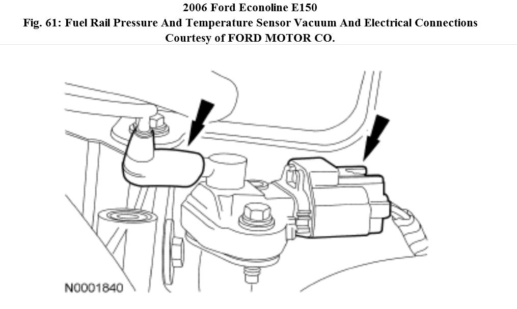

KHLOW2008
  • 41,814 POSTS
For P2104 and P2112, refer to reply of Dec 22 and Mar 03.
FRP is near fuel rail. Refer to diagram.
Sunday, August 28th, 2011 AT 4:50 PM
KHLOW2008
  • 41,814 POSTS
For P2104 and P2112, refer to Decc and Mar 03 replies.
For FRP location, refer to diagram, is near fuel rail.
