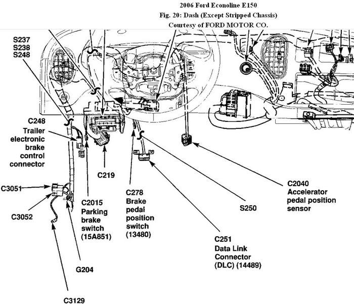

Most likely you have damaged the APP when you loosened it. That is the part that you have to replace.
Monday, February 28th, 2011 AT 3:32 PM
KHLOW2008
  • 41,814 POSTS
Refer to diagram for location.
Monday, February 28th, 2011 AT 3:39 PM

APP is above the accelerator pedal.

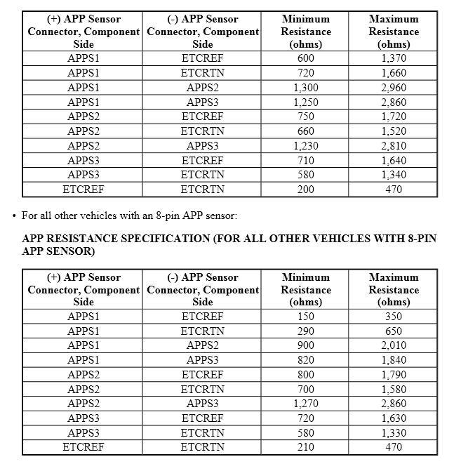

PINPOINT TEST DK: ACCELERATOR PEDAL POSITION (APP) SENSOR
INTRODUCTION
NOTE: The following DTCs should be diagnosed and repaired through POWERTRAIN DTC CHARTS & DESCRIPTIONS and the appropriate service repair article respectively before entering pinpoint tests DK or DV:

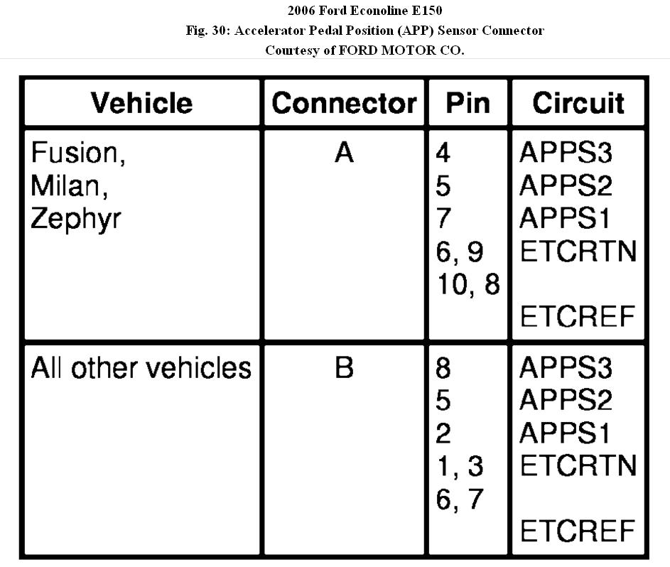

This pinpoint test is intended to diagnose the following:
†accelerator pedal position (APP) sensor (9F836)
†harness circuits: ETCRTN, SIGRTN, ETCREF, APP1, APP2, and APP3
†powertrain control module (PCM) (12A650)
â€

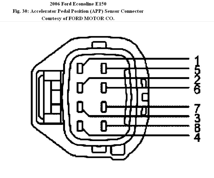

Fig. 30: Accelerator Pedal Position (APP) Sensor Connector

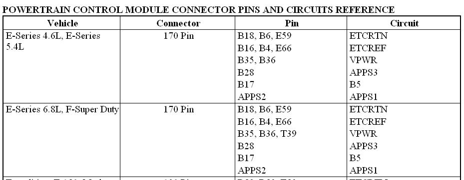

For PCM connector views or reference values, refer to diagram # 3.

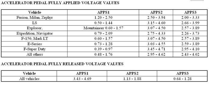

DK3 CHECK THE APP SENSOR SIGNAL VOLTAGE RANGES FOR THE ACCELERATOR PEDAL FULLY APPLIED AND RELEASED POSITIONS
†Access the PCM and monitor the APPS1, APPS2 and APPS3 PIDs.
†Press the accelerator pedal fully to the floor and release.
ACCELERATOR PEDAL FULLY APPLIED VOLTAGE VALUES
ACCELERATOR PEDAL FULLY RELEASED VOLTAGE VALUES
(Refer to Diagram # 4)
Are all 3 APPS signals out of range for the pedal fully applied and released positions?

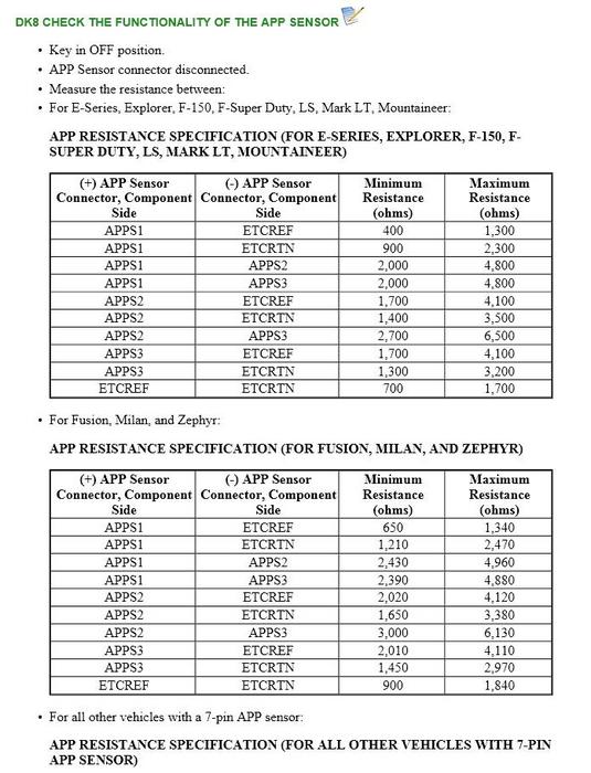

DK5 CHECK THE FUNCTIONALITY OF THE APPS1 CIRCUIT
NOTE: Use the voltage measurements from DK3.
Is APPS1 out of range?
Yes : GO to DK8.
No : GO to DK6.
DK6 CHECK THE FUNCTIONALITY OF APPS2
Is APPS2 out of range?
Yes : GO to DK8.
No : GO to DK7.
DK7 CHECK THE FUNCTIONALITY OF APPS3
Is APPS3 out of range?
Yes : GO to DK8.
No : GO to DK22.

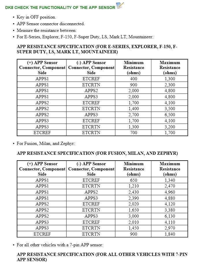

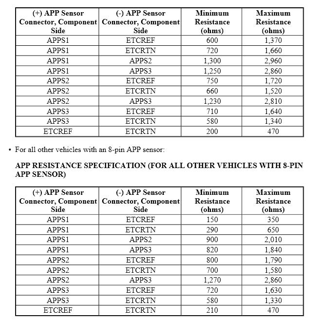

Refer to diagram # 5 for DK8
Are all the resistances within specifications?
Yes : For DTCs P2121, P2122 or P2123 alone or in combination, GO to
DK10.
For DTCs P2126, P2127 or P2128 alone or in combination, GO to DK14.
For DTCs P2131, P2132 or P2133 alone or in combination, GO to DK18.
For DTC P2104 alone, GO to DK26.
For a lack/loss of power, the concern is elsewhere. RETURN to SYMPTOM
CHARTS for further direction.
For all others, GO to DK22.
N0 : INSTALL a new APP sensor. REFER to the appropriate ACCELERATION CONTROL article.
CLEAR the DTCs.
PRESS the accelerator pedal several times and REPEAT the self-test. If DTCs are present:
GO to DK9.

†Measure the resistance between:
( + ) APP Sensor Connector, Harness Side = APPS1
( - ) APP Sensor Connector, Harness Side = APPS2
( - ) APP Sensor Connector, Harness Side = APPS3
( - ) APP Sensor Connector, Harness Side = ETCREF
( - ) APP Sensor Connector, Harness Side = ETCRTN
Are the resistances greater than 10K ohms?
Yes : GO to DK25.
No : REPAIR the short circuit. CLEAR the DTCs. REPEAT the self-test.
DK23 CHECK FOR THE APPS2 CIRCUIT SHORTED TO SIGNALS IN THE SAME HARNESS
†Key in OFF position.
( + ) APP Sensor Connector, Harness Side = APPS2
( - ) APP Sensor Connector, Harness Side = APPS1
Yes : GO to DK25.
No : EPAIR the short circuit. CLEAR the DTCs. REPEAT the self-test.
DK24 CHECK FOR THE APPS3 CIRCUIT SHORTED TO SIGNALS IN THE SAME HARNESS
( + ) APP Sensor Connector, Harness Side = APPS3
Yes : GO to DK25.
DK25 CHECK THE APP SENSOR CIRCUITS FOR AN INTERMITTENT CONCERN
†Wiggle, shake, and bend small sections of the wiring harness while working from the sensor to the PCM.
( - ) PCM Connector, Harness Side = APPS1
( - ) PCM Connector, Harness Side = APPS2
( - ) PCM Connector, Harness Side = APPS3
Are the resistances less than 5 ohms?
Yes : GO to DK26.
No : ISOLATE the concern and REPAIR as necessary. CLEAR the DTCs. REPEAT the self-test.
DK26 CHECK FOR CORRECT PCM OPERATION
†Disconnect all the PCM connectors.
†Visually inspect for:
a) pushed out pins
b) corrosion
†Connect all the PCM connectors and make sure they seat correctly.
†Carry out the PCM self-test and verify the concern is still present.
Is the concern still present?
Yes : INSTALL a new PCM. REFER to FLASH ELECTRICALLY ERASABLE PROGRAMMABLE READ ONLY MEMORY (EEPROM).
N0 : The system is operating correctly at this time. The concern may have been caused by a loose or corroded connector.

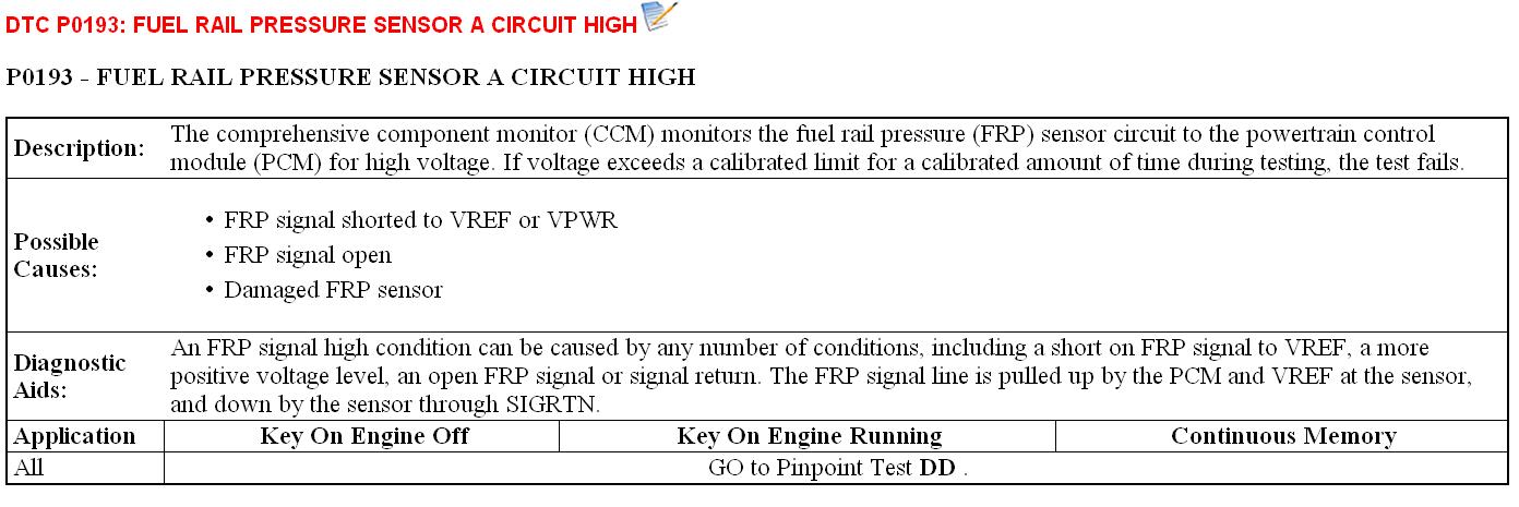

Hi, long time no communication my good friend.I have changed the Complete Accelerator pedal(new from ford), I also bought the brain box but fix it without reprogramming but the van started and idle fine without shaking even with A/C on. But yet there is no acceleration. As you know before I have changed the Throttle Body(used but good). This codes are still present:P2104, P2112 and Po193. Thanks a lot for your patience
Friday, June 3rd, 2011 AT 3:27 PM
DECAPTAIN2010
  • 75 POSTS
Sorry please I forgot to add that I used to hear one kind of clicking sound by the throttle body each time I open the ignition to start the vehicle. Again bear in mind that the throttle body is a used one. Thanks
Friday, June 3rd, 2011 AT 5:14 PM
KHLOW2008
  • 41,814 POSTS
Refer to diagram for explanation of P0193.
As to the other 2 other coeds, check the wireharness. Seems someone has encountered such problems before and was found to be due to damaged wiring. Check the wireharness underhood, near the EGR pipe. Note if the wire is brushing against the EGR pipe and has signs of damage to the wires.
Saturday, June 4th, 2011 AT 7:13 AM
DECAPTAIN2010
  • 75 POSTS
Thanks my man, I think this make a lot of sense, I will do that immediately but I need to know the type of wires you are talking about. Again do you think from experience that the Po193 codes has anything to do with the non-accelerating problems. Secondly, do you thing that I need to reprogramme the PCM I bought, although it has the same number and pins and it started the vehicle when fixed. With the explanation on the smooth idling of the vehicle, do you also think the Throttle position sensor by the TB is faulty again. Lastly, please comment on the clicking sound by the TB plug-in connection (i.E 2 wires to the motor side). Thanks
Monday, June 6th, 2011 AT 4:14 PM
KHLOW2008
  • 41,814 POSTS
Yes, P0193 can cause poor throttle response as the fuel pressure sensor is not working correctly.
Since the computer works, it is not necessary to reprograme it but there have been instances whereby reflashing helps.
The wires mentioned are those that is in a harness that goes near the EGR pipes and it could also be the reason for P0193.
The TB would have minimal clicking noise when ignition is turned on as it tries to adjust itself to the conditions such as engine coolant temperature so it is nothing to worry about.
Monday, June 6th, 2011 AT 8:05 PM
