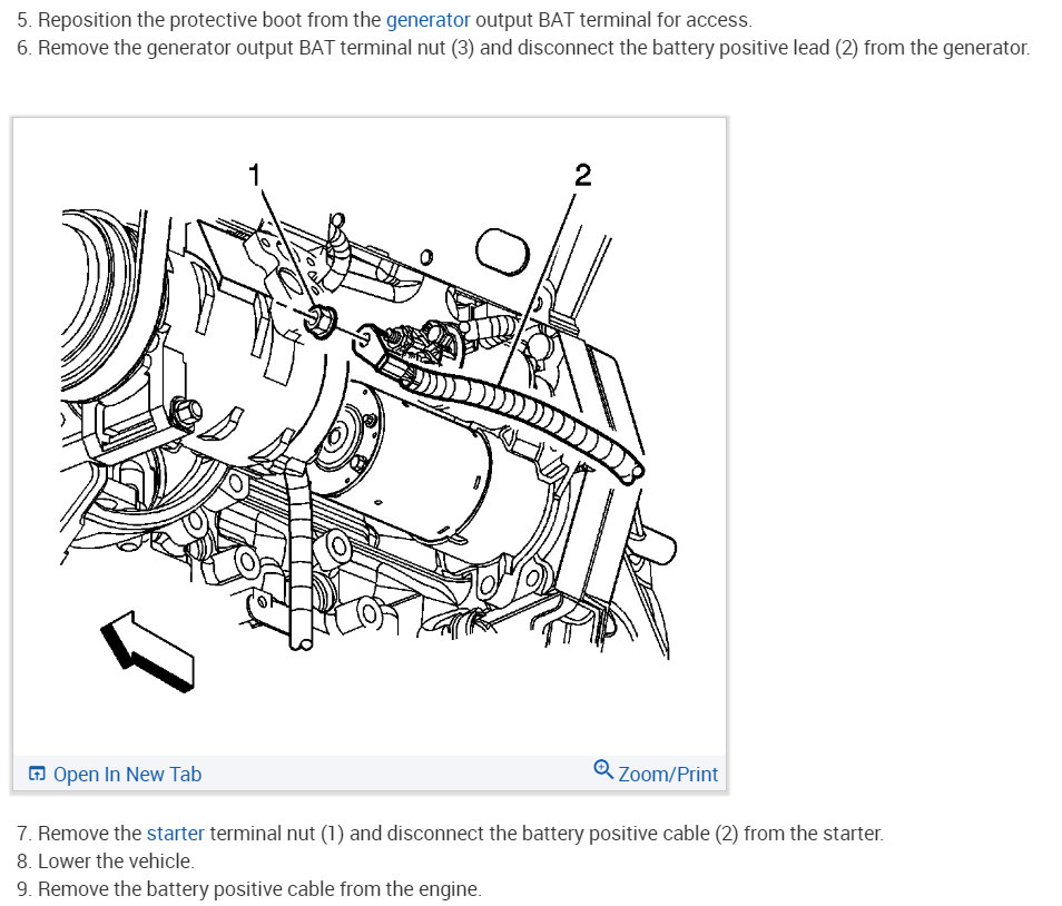

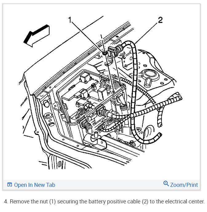

KROWNEDKING316

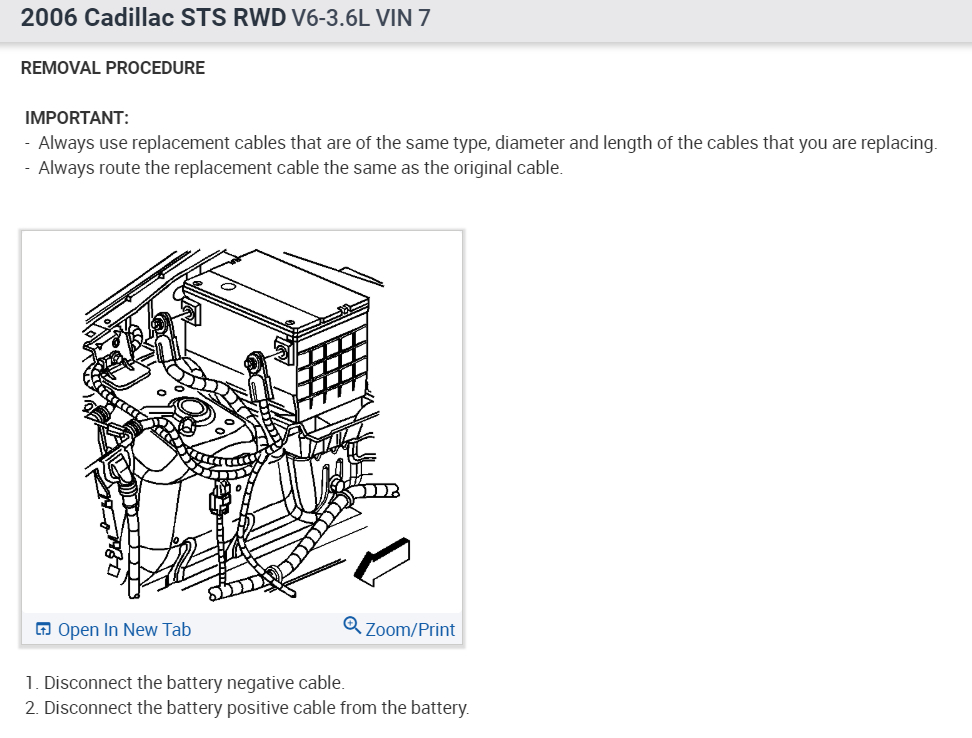

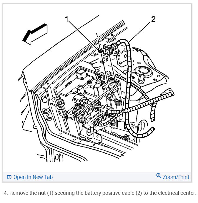

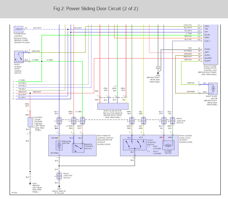

I'm having a similar problem I have a 2005 Cadillac STS 3.6l and everything blacks out when I push the start button but it's fine before that no service light or code and I've replaced the starter alternator battery starter relay and the ignition switch I'm lost and trying to keep away from the dealership for now but it's looking like I'm going to have to take it. Any suggestions
+1
Monday, January 28th, 2019 AT 6:17 PM
KEN L
  • MASTER CERTIFIED MECHANIC
  • 55,291 POSTS

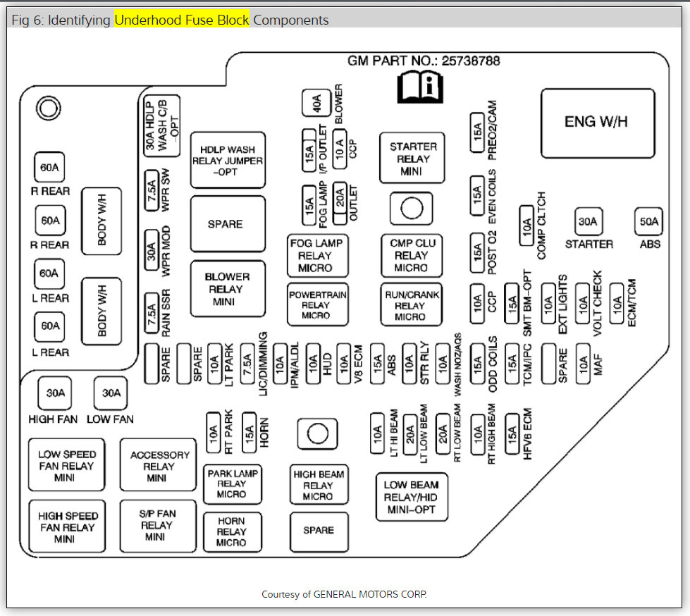

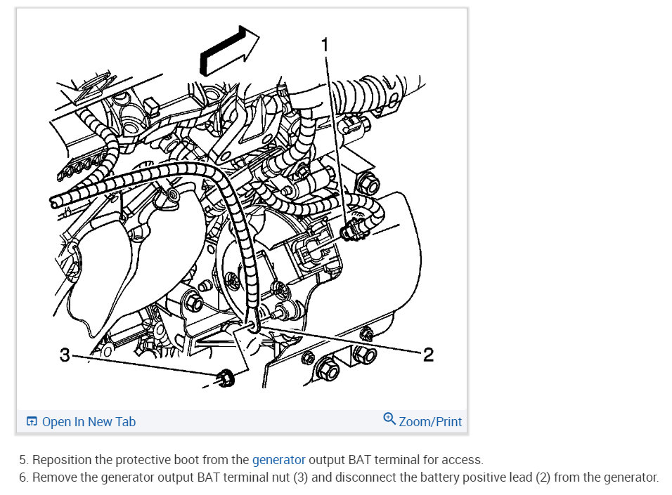

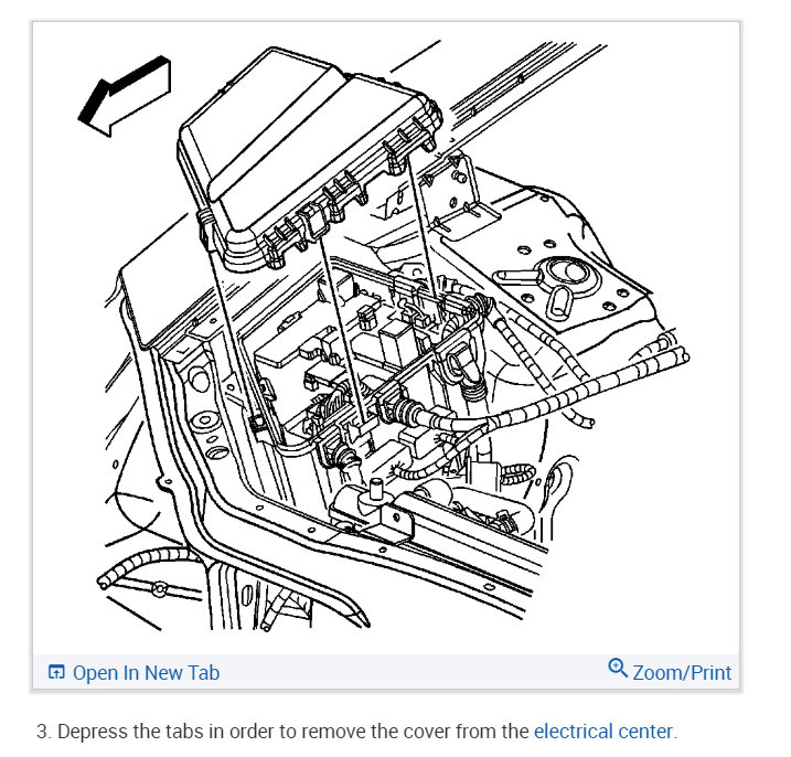

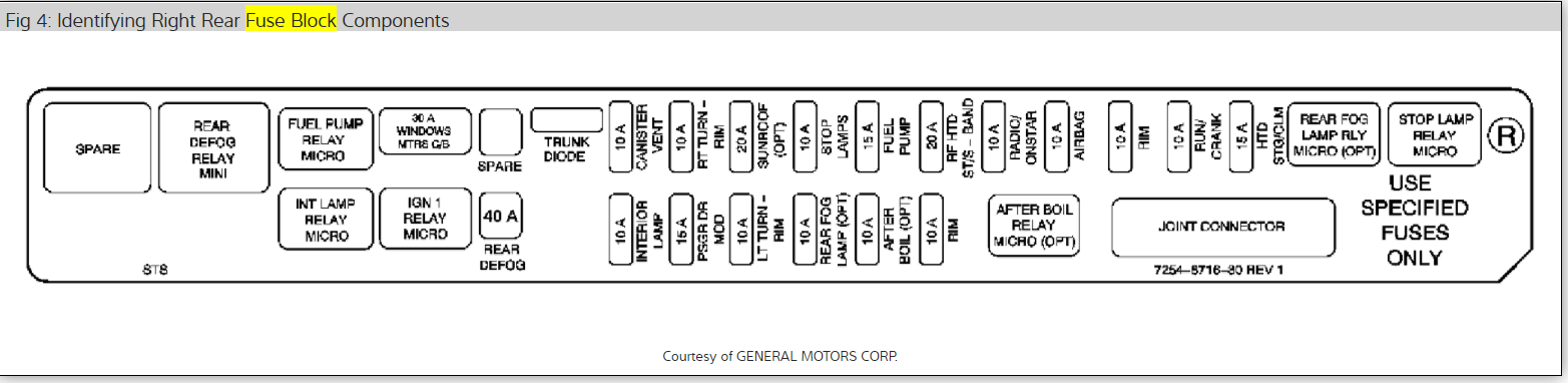

If everything goes dead it is a connection problem I would start by replacing the positive battery cable and cleaning the negative terminal. Here is a guide to help us with diagrams below to show you how to replace the cable:
+1
Tuesday, January 29th, 2019 AT 11:34 AM

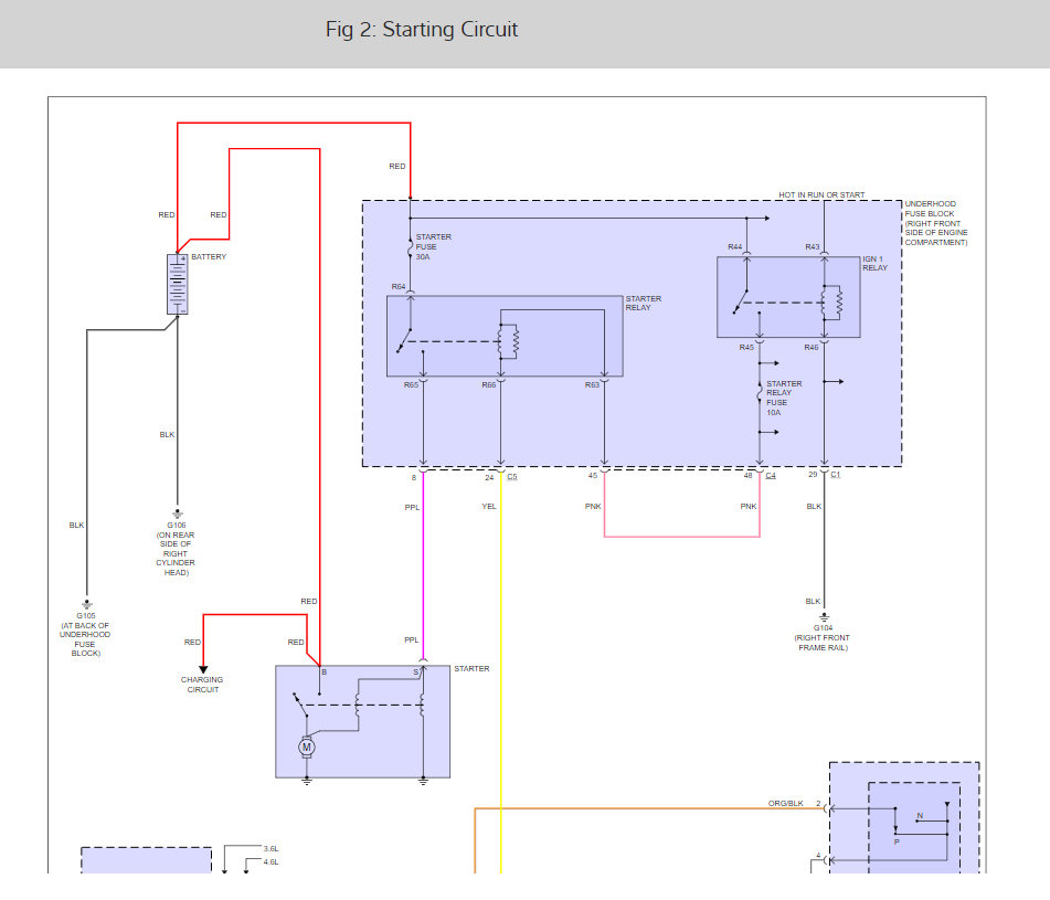

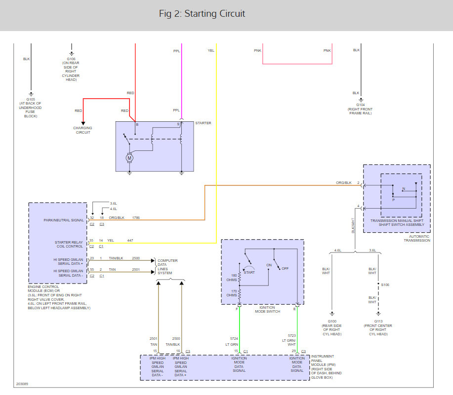

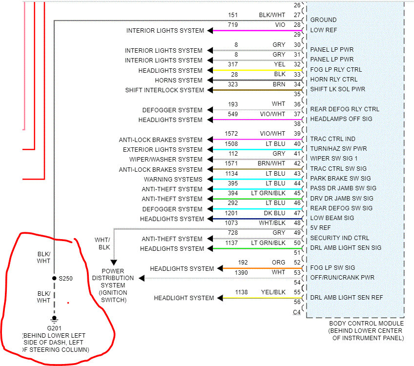

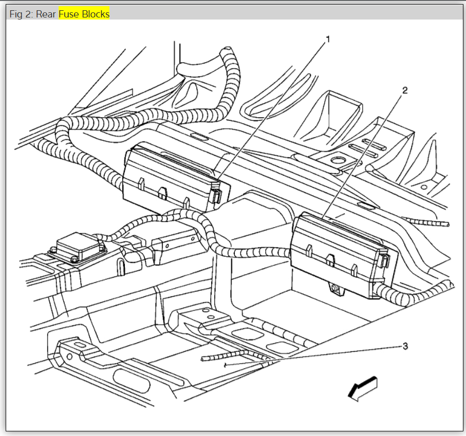

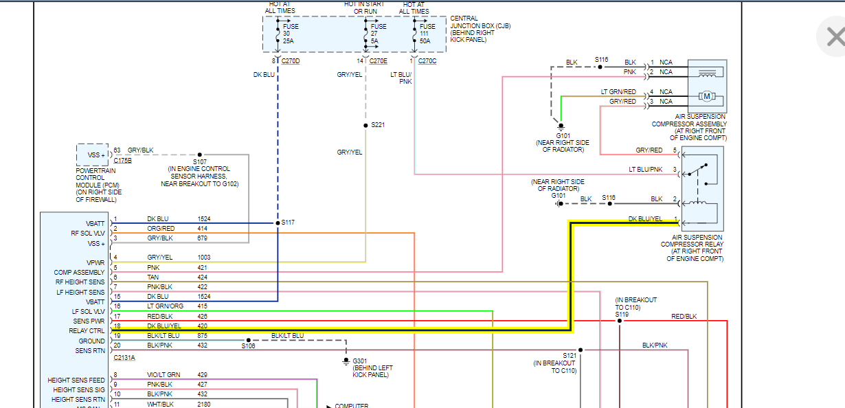

KROWNEDKING316

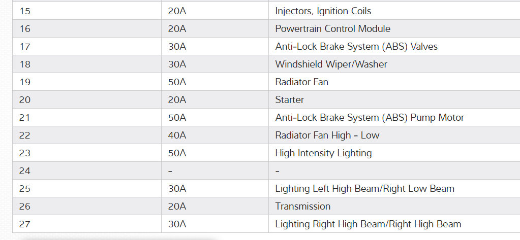

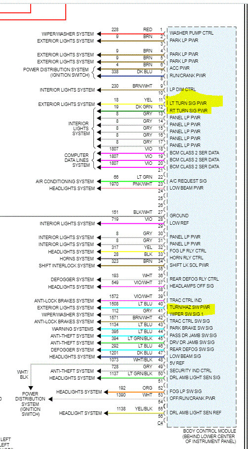

Also, if I use a jumper wire and go past the relay it will start.
Tuesday, January 29th, 2019 AT 1:11 PM

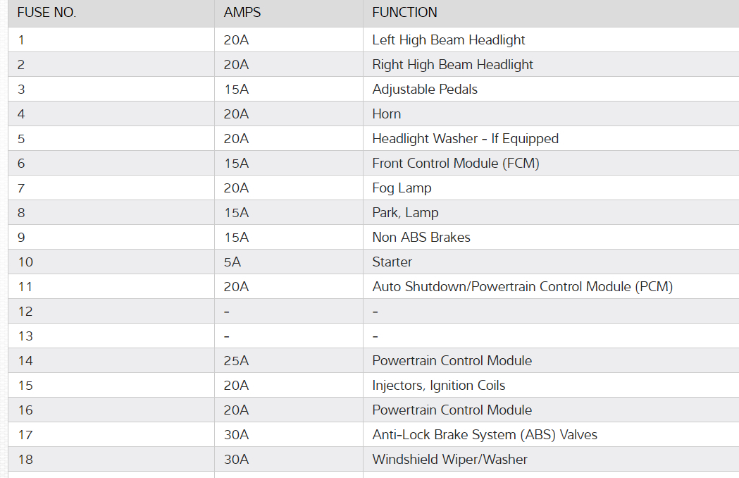

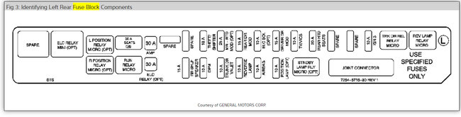

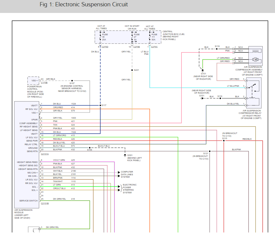

KEN L
  • 55,291 POSTS

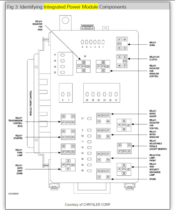

Is the security light flashing? Here is the starter wiring diagrams so you can see how the starter is wired. Can you please check the IGN1 relay? here is a guide and the location of the relay below:
Check out the diagrams (below). Please run this test and get back to us.
