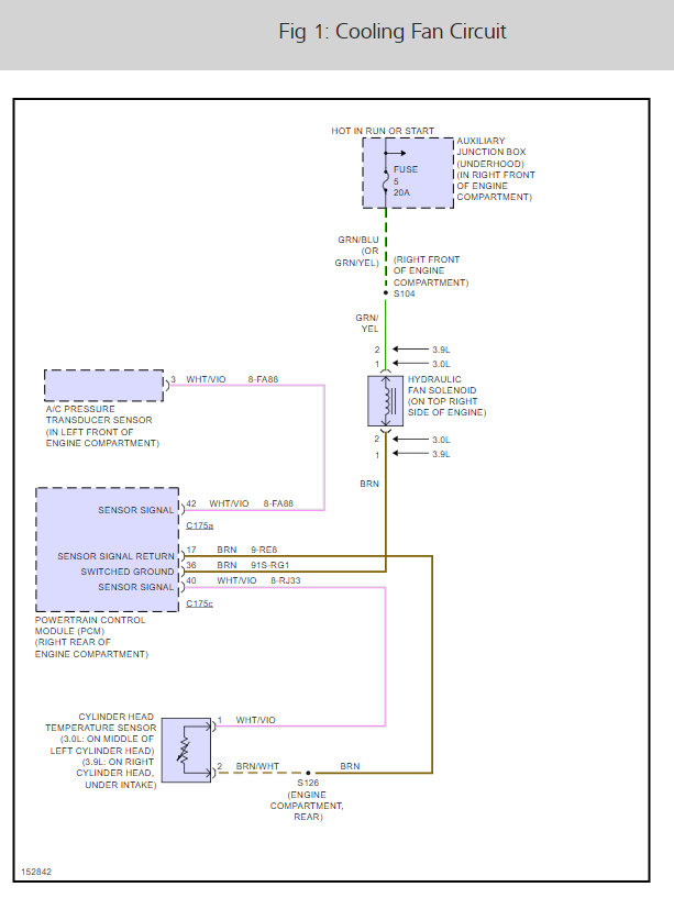

I was just driving on the interstate, then like four hours into the trip the car started to overheat. So I turned the heater on in the vehicle and the temperature went down. However, I ran into traffic then it took a dump on me. The status indicator advised pulling over and shut off ignition. I did so and let it cool off turned it back on and checked oil level, and coolant levels, both were fine. There were no leaks, so I turned the car on after cooling and checked the engine compartment turns out the radiator fan stopped working. Please help me out.
Wednesday, August 1st, 2018 AT 8:25 PM (Merged)
BILLYMAC
  • 2,204 POSTS
Hi, the cooling fan works off from a temperature switch that senses when engine temperature requires cool down. Also, a fan relay so the fan relay fan motor or temperature sensor has failed. I would have vehicle scanned for codes this will help pinpoint which one has failed. Here are the fan wiring diagrams so we can see how the system works.

I thought the Lincoln IS v-8 does not have a relay for the radiator fan. Although I am not sure. Is this an easy fix?
+2
BILLYMAC
  • 2,204 POSTS
It has a relay but it is integrated into a multinational relay. The easiest part to change is the temperature sensor.

You can turn your air conditioner on or your heat with defroster the fan is designed to come on with the defrosters and the A/C or the temperature. If you are just wanting to get home and have a wire handy unplug the plug from the fan hook two wires up one hot one ground fan will run.
