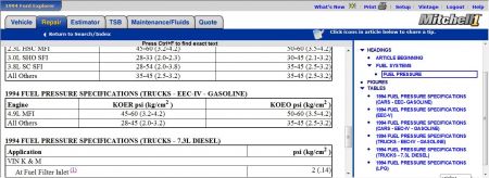

4.0 liter v6 engine with a manual transmission. Every time I start the truck it misfires and bucks really badly for the first five to fifteen minutes of driving and then it gets better. Sometimes it takes a lot longer for it to get better during the drive but most of the time it fixes itself somehow. I have a KOER code of 998 which is limp home and I also have a MAF code 135 I think which is that the MAF had low ground signal or something.
I have replaced plugs, wires, the coil pack, the O2 sensors, the MAF, and the fuel pressure regulator. I also checked the voltages of the wires coming out of the MAF while upping the throttle while idling and all voltages are fine. I am lost as what to do next. Any help would be appreciated.
Wednesday, July 29th, 2020 AT 11:25 AM (Merged)
AL514
  • 5,596 POSTS
Hi there, you should check the fuel pressure while the truck is running, you may see it has low pressure when start and may correct itself a bit when the truck warms up. As for the codes; you probably fixed the issues with the MAF with a new sensor, but I would go after fuel pressure at this point.

I forgot to include that. Yes, I did just replace it. I do not have a fuel pressure gauge. I will get one I guess. I do have pressure on the fuel rail when I press the Schrader valve on it.
AL514
  • 5,596 POSTS
You may have some pressure, just not within spec, since you have replaced so many of the ignition parts already, defiantly check the fuel pressure. Also, are any of the codes returning after the other fixes?

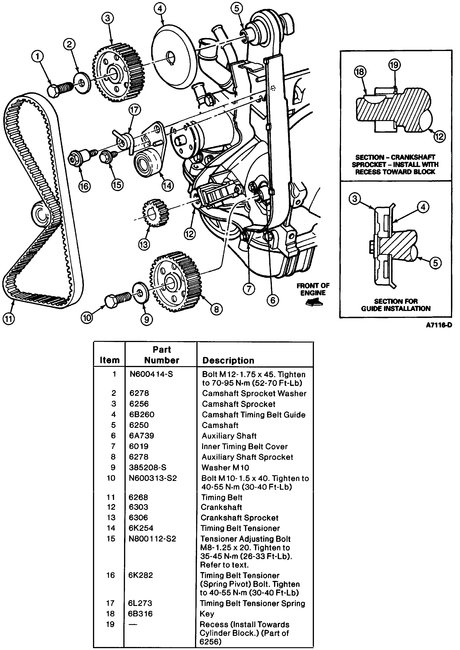

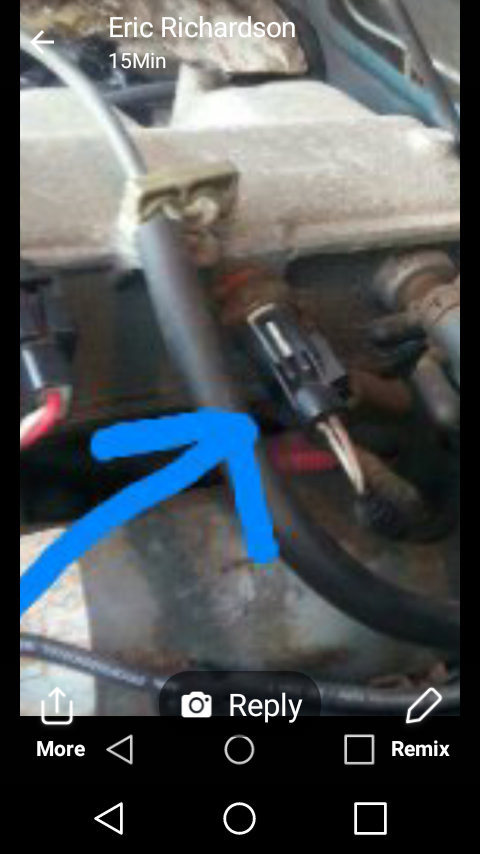

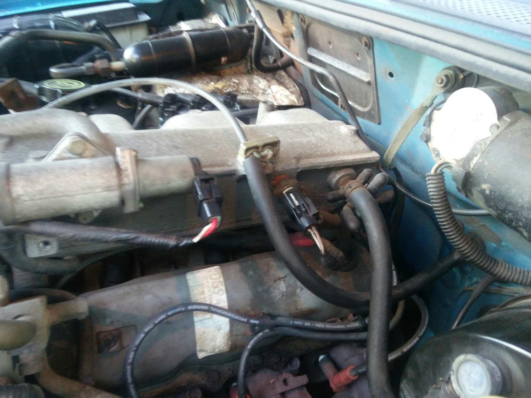

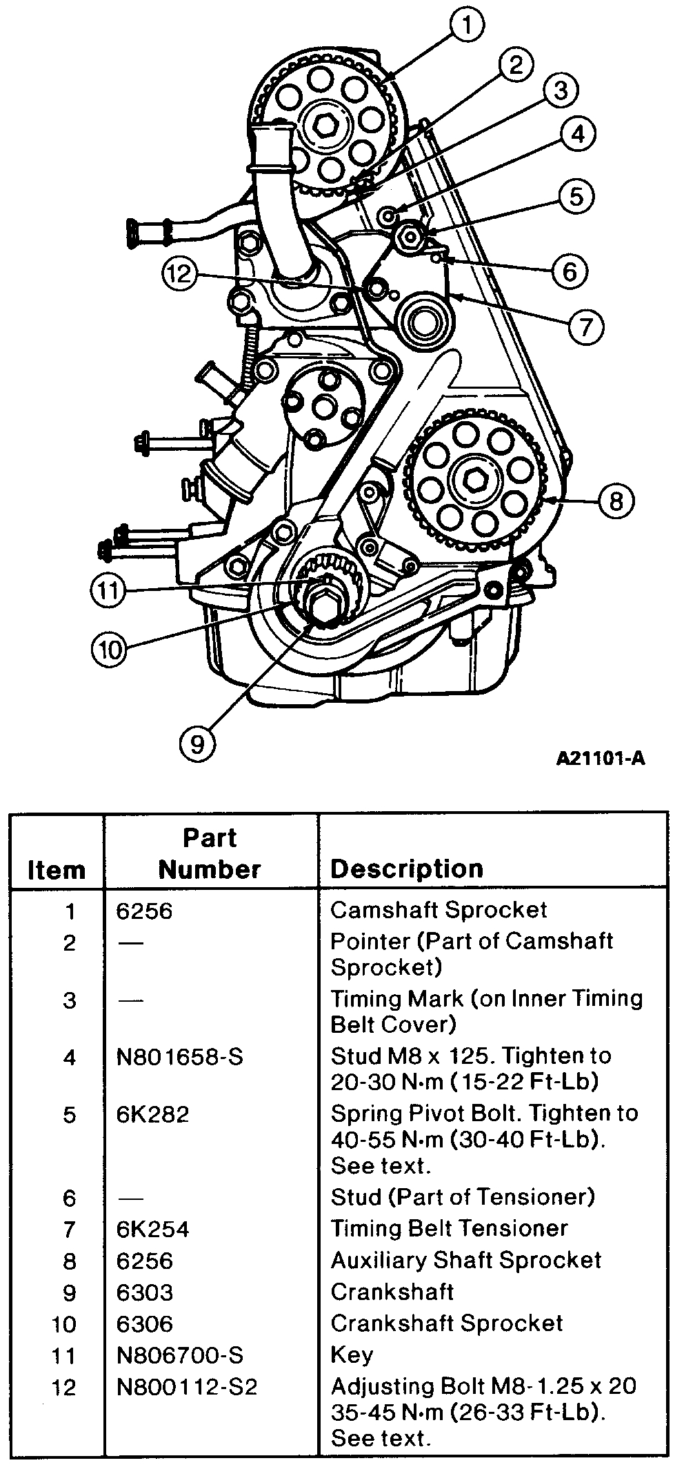

One day I was driving down the road to work and I herd a pop thought I blew a head gasket. I made it to where I was going. The next day could not find a problem took it home turned out I had bad wheel bearings on one side. I took it shop and had it fixed. Now it's missing when I'm idling and when I try to take off it jerks it is better when I'm going to going a little faster but barely. There's no check engine light on. I replaced hoses on EGR valve and I have looked all over for air leaks. There's a tiny hole on the hose under my cold air intake but it looks like the person who had the truck before me removed it because I does not have a box or filter and the air filter that's on I looks rigged. Took mas airflow off nothing changes. What do I do? I don't have much money and I think it's a simple fix I'm just not car savvy.
Wednesday, July 29th, 2020 AT 11:26 AM (Merged)
  • 110,194 POSTS
Welcome to 2CarPros.
First, if you notice a misfire, the light should be on. Confirm it is working when you first turn the key on. It should turn off after a few seconds. With that in mind, I still need you to check for trouble codes. All you need to do it is a test light. Follow the directions in this link:
https://www.2carpros.com/articles/ford-lincoln-mercury-obd1-1995-and-earlier-diagnostic-trouble-code-definition-and-retrieval
If no codes are found, it could be many possible issues. I am going to provide links on the different things to check.
Next, if you question that a possible head gasket can be an issue, here is a link that shows how to check:
Next, you may have a plugged catalytic converter. Here is a link that shows how to check that:
Also, a timing issue can be the cause which would result in low compression and ignition timing issues. With that, I would recommend testing engine compression.
As far as the tiny leak, make sure it isn't allowing unmetered air to enter the engine. That will cause at least a rough idle.

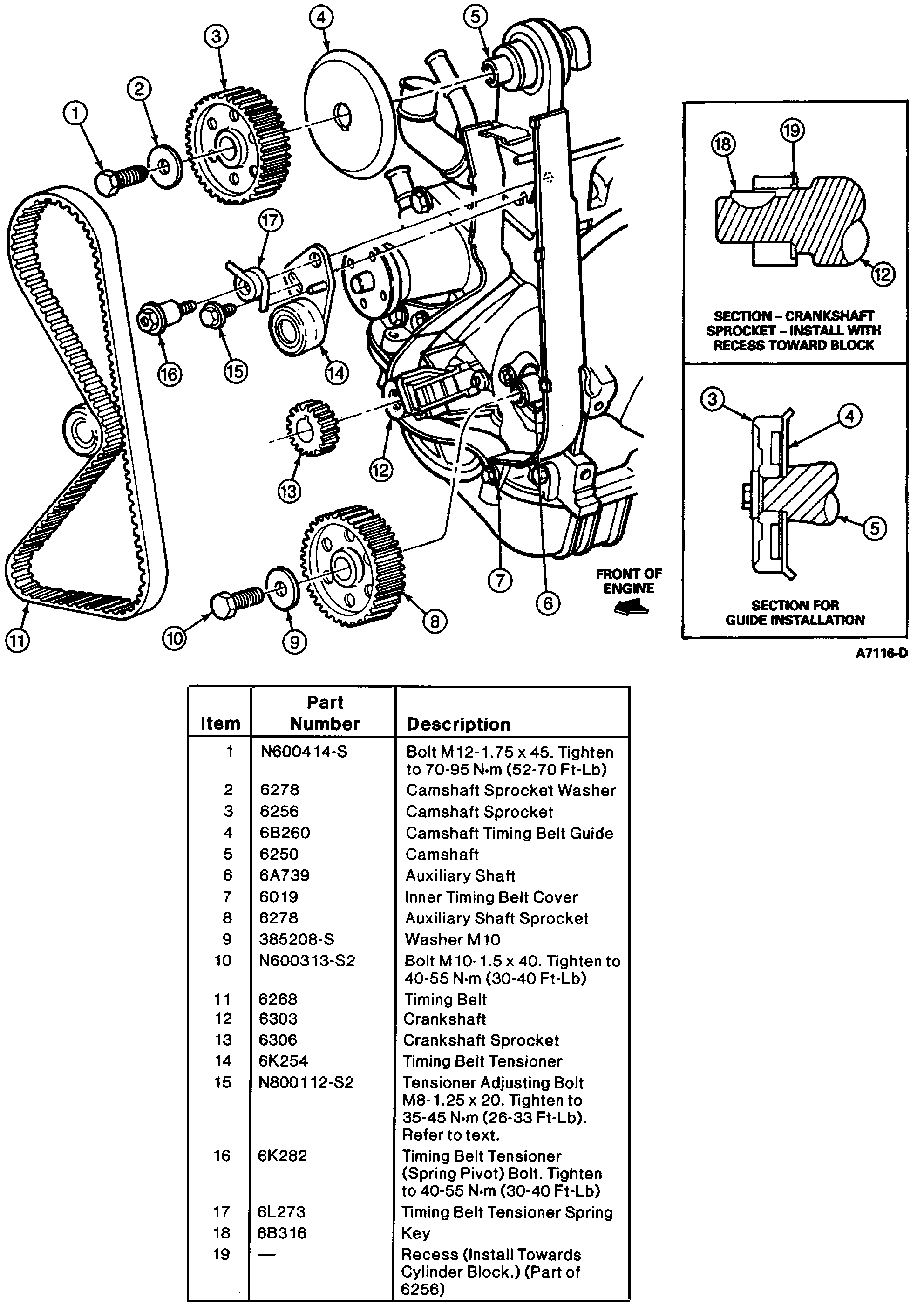

Now, in addition to all of this, I am really questioning if the timing belt has jumped. Here are directions for installing the timing belt. I'm adding them in case you want to check to make sure timing marks are correct. The attached pictures correlate with these directions.
INSTALLATION
Special Service Tool Required:
Camshaft Belt Tension Adjusting Tool T74P-6254-A
Synchronizer Positioner T93P-12200-A
picture 1
1. Remove one spark plug from each cylinder.
2. If not done:
a. Loosen tensioner adjusting bolt.
b. Using Camshaft Belt Tension Adjusting Tool, PRY tensioner CLOCKWISE against spring tension as far as possible.
c. Tighten adjusting bolt to hold tensioner in RELEASED position.
3. Align crankshaft so number one piston is at Top Dead Center (TDC) as indicated by timing mark.
picture 2
4. Line up the camshaft sprocket timing mark with the inner timing belt cover timing mark, so that the key is pointing DOWN.
NOTE: On 49-State, and all Automatic Transmission vehicles, it is not necessary to align auxiliary shaft sprocket.
5. If vehicle is California Emissions Certified with a Manual Transmission:
a. Install Synchronizer Positioner into synchronizer.
b. ROTATE auxiliary shaft sprocket until the synchronizer shutter is against the stop, and the notch of the tool engages the notch of the synchronizer bowl.
6. Install timing belt over crankshaft sprocket. Then, proceeding COUNTER-CLOCKWISE, over auxiliary shaft sprocket and camshaft sprocket.
7. Loosen tensioner adjusting bolt allowing tensioner pulley to press against timing belt.
8. Remove tool from synchronizer.
NOTE: When performing the following step, DO NOT ROTATE crankshaft COUNTER-CLOCKWISE as timing belt may jump a cog, putting camshaft or auxiliary shaft out of time.
9. ROTATE crankshaft two revolutions CLOCKWISE.
10. Bring crankshaft slowly, without stopping, to number one cylinder firing position (keyway directly UP).
11. Recheck timing mark alignment. Repeat steps if timing marks are no longer properly aligned.
12. ROTATE tensioner assembly against bolt with torque wrench up to 41-45 N.m (30-33 ft-lb) and tighten adjusting bolt.
13. Tighten adjusting bolt to 35-45 N-m (26-33 ft-lb).
14. Tighten spring pivot bolt to 40-55 N.m (30-40 ft-lb).
15. Install the crankshaft belt guide.
16. Install the crankshaft position sensor onto the dowel pin and tighten the two longer bolts to 8-12 N.m (6-9 ft-lb).
17. Adjust crankshaft position sensor air gap.
18. Install outer timing belt cover.
19. Install spark plugs.
Let me know if any of this helps or if you have other questions.
