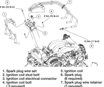

Hello cjohn14
Water in the fuel could cause the random misfire(bad gas)or the ignition coil is causing the problem.
Please go over this guide
check also for a vacuum leak in the intake manifold, throttle body or vacuum plumbing, a defective Exhaust Gas Recirculation (EGR) valve that is leaking exhaust into the intake manifold.
Ignition coil removal
https://www.2carpros.com/forum/automotive_pictures/46384_0996b43f80202d6c_2.jpg
