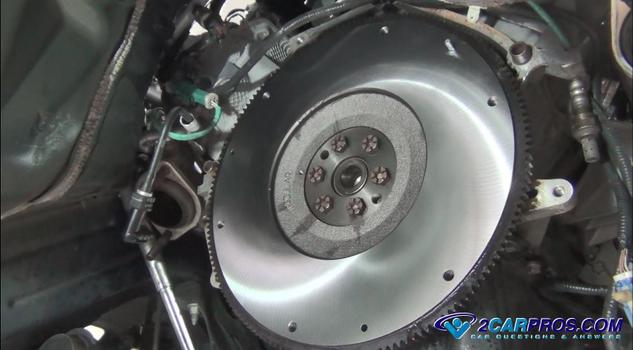

How does it work?
The flywheel is bolted and turns directly with the crankshaft acting as a solid coupler to join the power output of the engine and transfer it to the transmission input shaft. The flywheel also acts as an agent to help start the engine via the starter motor. A flywheel is "timed" to the crankshaft and can only be bolted up one way. This is achieved by offsetting the bolt pattern helping preserve the engine balance when running. When replacing a flywheel mounting bolts should to be tightened to manufacturer's specifications to preserve the flywheel integrity.

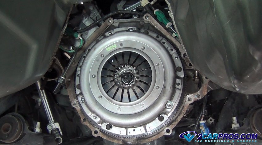

This is what a clutch looks like when mounted to the flywheel
clutch mounted flywheel

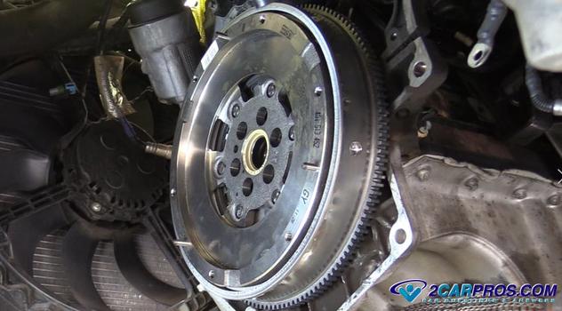

The dual mass flywheel has made shifting transitions more comfortable.
dual mass flywheel
