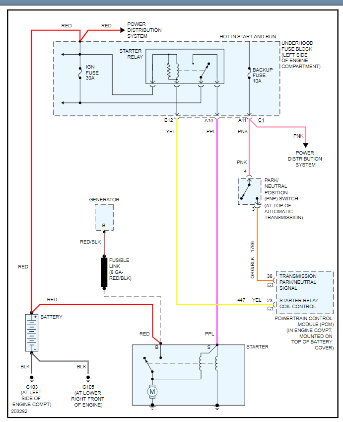

Engine will not start after being driven
DANE DESPAW SR.
  • 2005 CHEVROLET EQUINOX
  • 3.4L
  • 6 CYL
  • 2WD
  • 196,000 MILES
It will start and run. After driving any distance, it won’t start again until it cools down. Starter solenoid? If not, what should I look at?

Thank you. No, when this happens the engine does not turn over. Dashboard lights up like expected, but that is all I get. When the engine is cool, it starts right up like it should. At first I thought temperature sensor, but I’m not getting a DTC for that. By the way, I have replaced the crankshaft sensor recently due to a separate issue with programming a new ECM.

Okay. Tested wiring when the car would start and have power as it should have. Tested when it wouldn’t start and no power at the starter on either wire. Changed the relay out and the car is still doing the same thing. Starts fine when it’s cold, won’t start when it’s hot. I don’t know if the vehicle temperature makes any difference or if it’s just coincidence, but the only difference that I’ve seen so far. Also, last night it registered a dtc for Evan emissions vent performance. Would that solenoid have an effect here?
Thursday, February 25th, 2021 AT 1:14 PM
No it would not have an effect but I just want to make sure we are on the same page. When it is not starting, you have no power on the purple wire which I understand. However, the red wire should have 12 volts at all times. So if you have no voltage here then we need to find out what is happening with that battery cable. More then likely when it is hot it is not able to carry the current.
So that means the cable is most likely failing. When this is happening let's do what is called a voltage drop test. This means you put one lead at the battery positive terminal and the other at the terminal of the red wire at the starter and tell me how many volts it is showing.

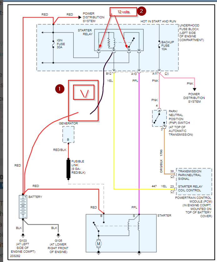

Okay. That red wire from the battery should have 12 volts all the time no matter what position the key is in. However, if there is 12 volts when the key in on then lest move on past this for now.
Take a look at this wiring diagram below. We can assume when this acts up and the engine does not turn over that the purple wire have no voltage.
If that is the case we need to find out why. Is the PCM not grounding the relay or is there no power to the 12 volt side of the relays?
Take a look at number 1 and 2. We need to test this relay when this is acting up. So to do this we need to put a meter on battery positive and the other lead on the terminal of the relay coming from the PCM. Then crank the engine. There should be 12 volts. What is happening is the PCM is grounding this relay and that closes the relay to send power down to the starter.
Then we need to make sure there is 12 volts at both locations on the relay that I am pointing too.
Friday, February 26th, 2021 AT 6:39 PM
DANE DESPAW SR.
  • 72 POSTS
After following those steps, I ended up changing the relay a second time. Problem seems to be solved at this point. Thank you for the guidance.
