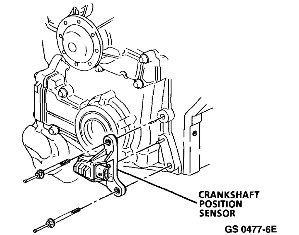

Started fine turned off put some gas in and now wont start. Turns over but no spark. I cannot run a scan my scan tool will not work on this car it is not compatible obd11 plug but not obd11 system right at that time when they were changing to the new system.
Sunday, March 14th, 2021 AT 2:46 PM
11 Replies
Good afternoon,
Yes, during the changeover, they had an OBD2 plug that would not connect with the system. You needed a special adapter.
This sounds like it could be a crank sensor not sending a signal to the ECM.
I attached the procedure below and a picture of the sensor.

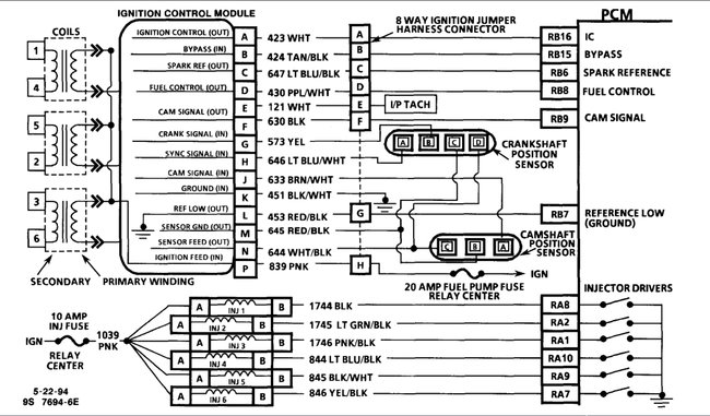

Any thing to check before replacing? I know it is not getting spark on at least one plug have not tested all.
Sunday, March 14th, 2021 AT 10:13 PM

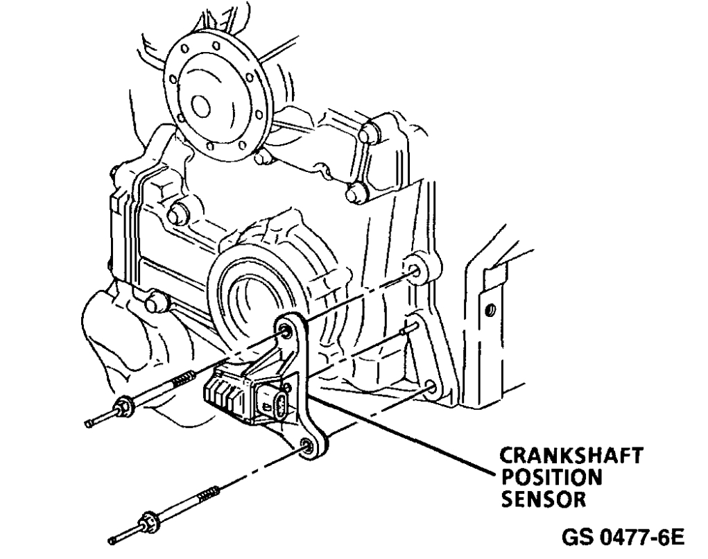

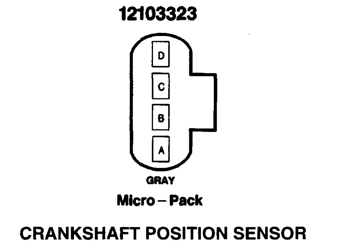

You would need a scan tool that will communicate with the system to see if you have a crank signal to the ECM.
I attached the diagram of the sensor as well as the location and a picture for you.
