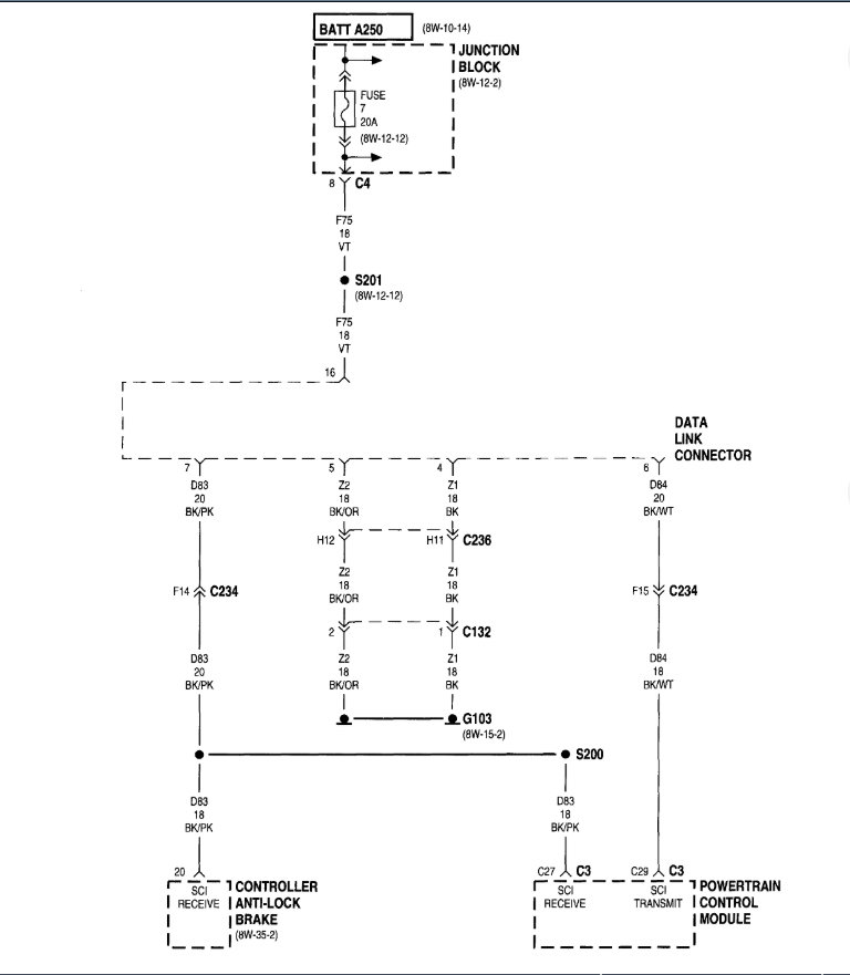

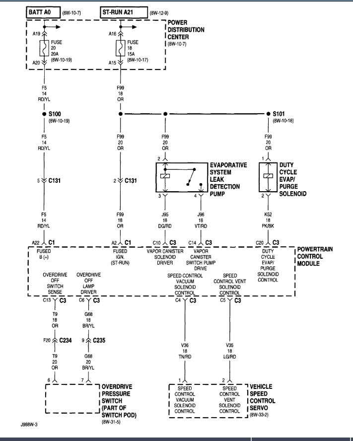

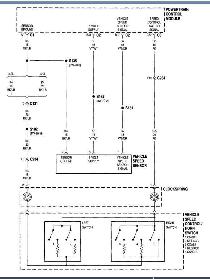

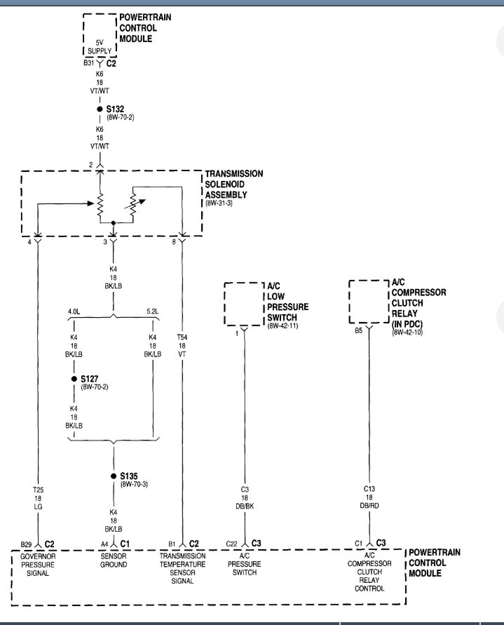

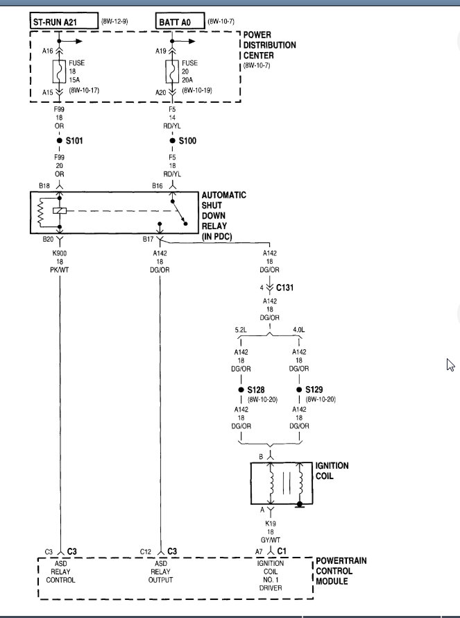

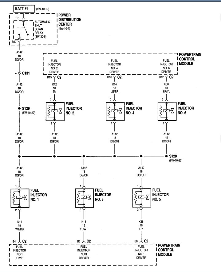

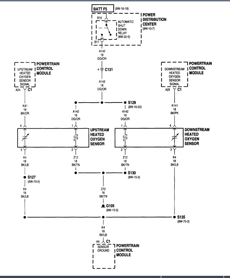

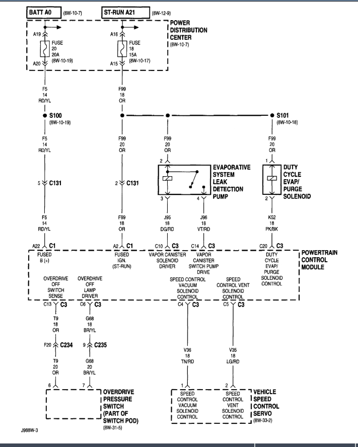

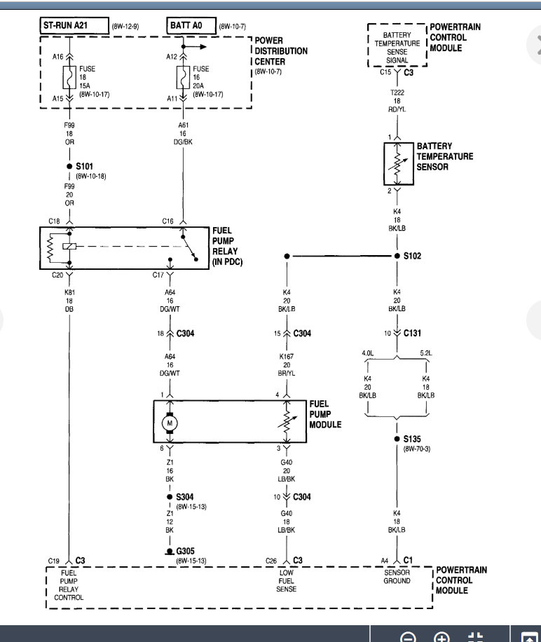

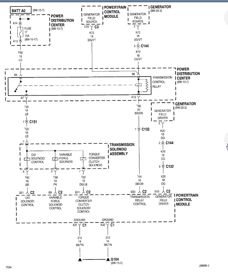

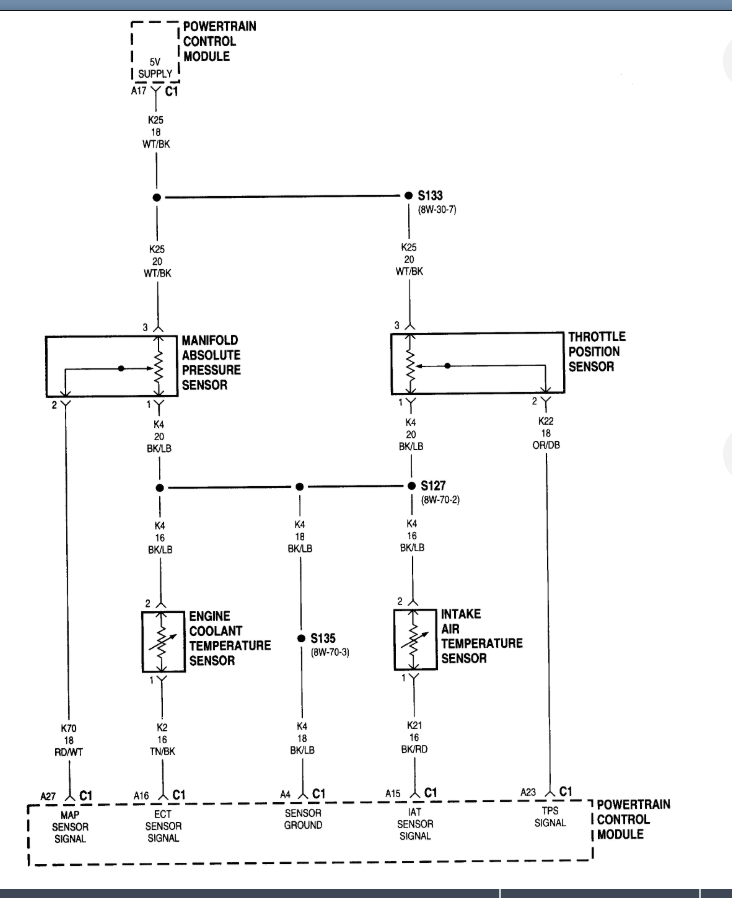

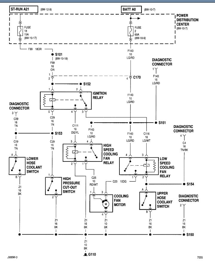

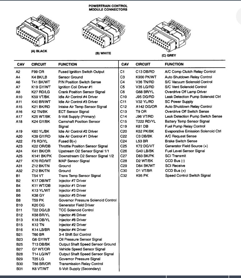

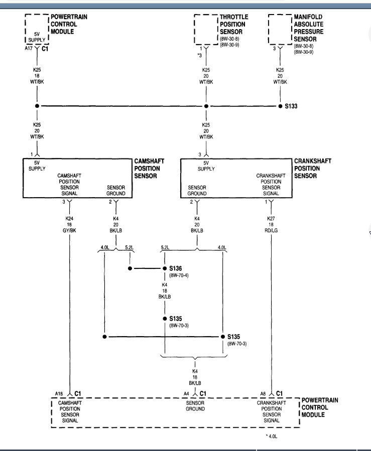

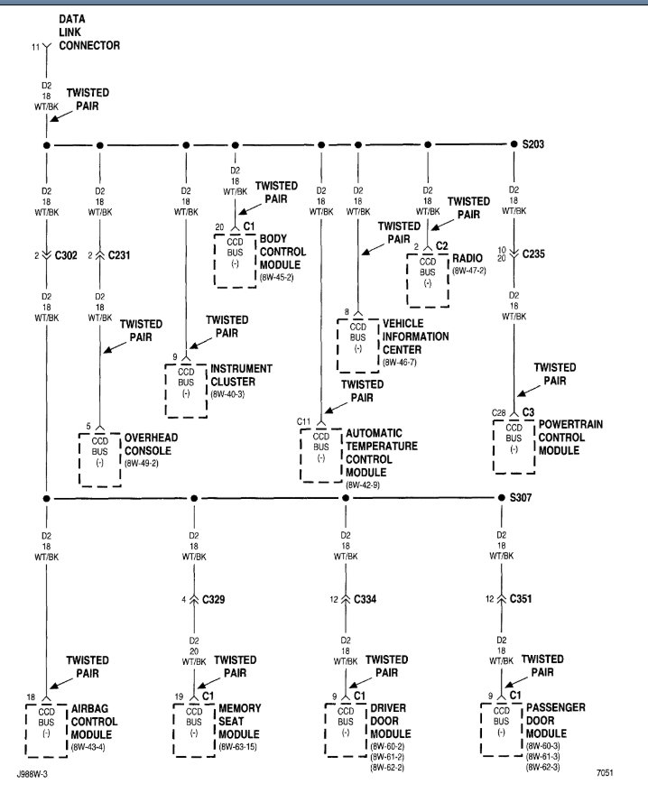

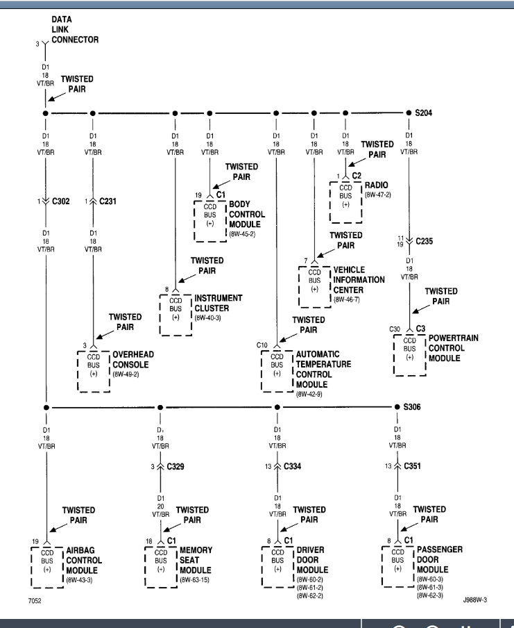

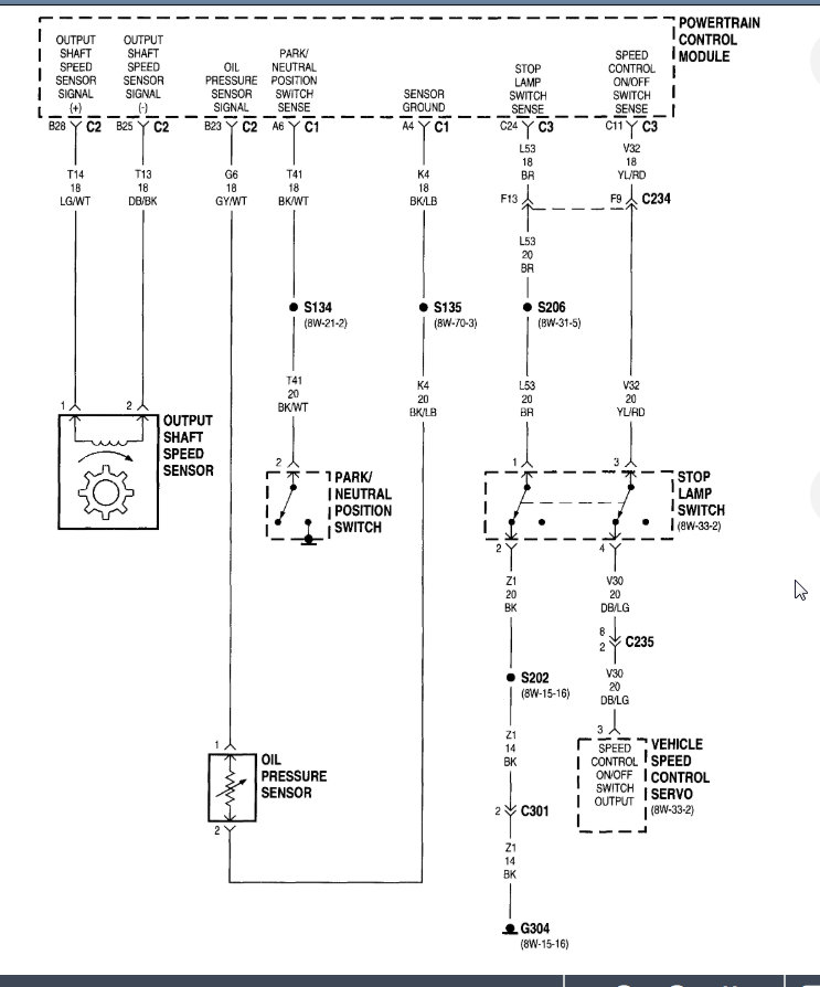

Every thing has power but the ECM. Need a wiring diagram of the ECM.
Sunday, August 30th, 2020 AT 10:53 AM (Merged)
Here are all the diagrams for the PCM. Clearly you need to verify B+ feeds and all the grounds. If you have no power to the ECM then that is where you start. Otherwise you need to check the crank signal and make sure the PCM is able to fire the injectors and coils. Let me know if you need more info. Thanks

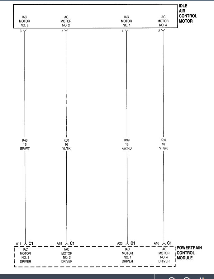

Hey im haveing problems my car starts but sometime when I drive it it stals out whenever I hit the brake the rpms just shoot down I dont know what to do
JDL
  • 16,098 POSTS
Might be a problem with idle air system? Clean the throttle-body. Any applicable trouble codes?
