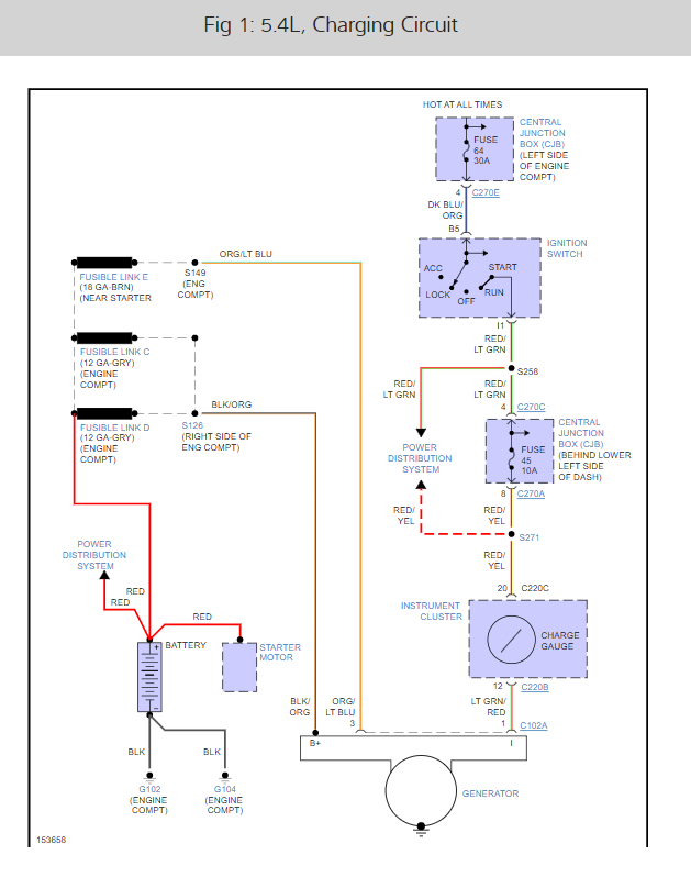

I was working on truck had it idling in the yard then all of a sudden it shut off. Now every time I put key in theft flashes rapid for minute then gives code 16. I tried both the main key and the spare key both coded to that truck doesn't work truck just turns over but no start.

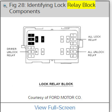

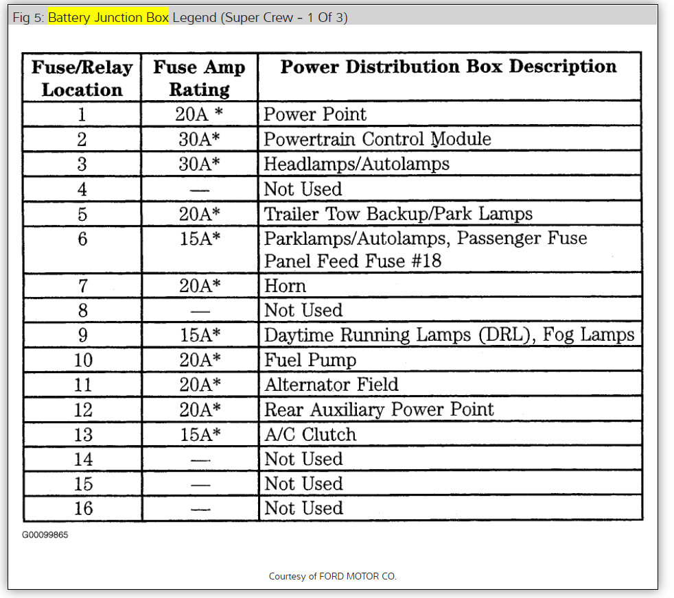

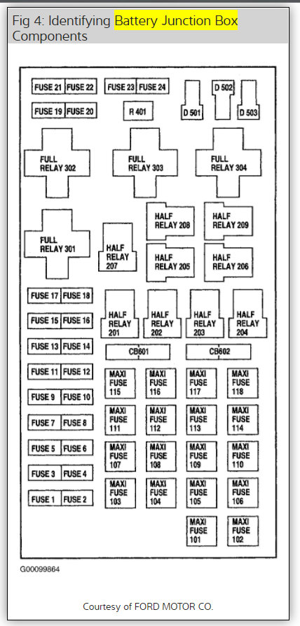

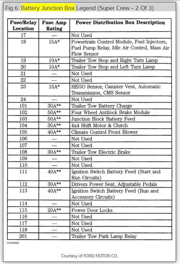

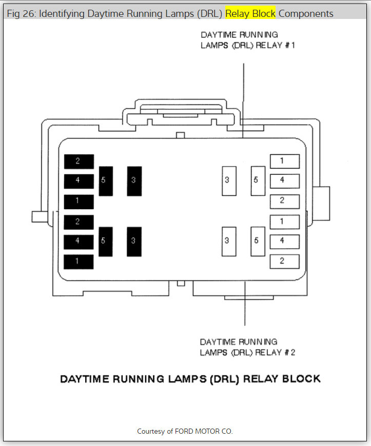

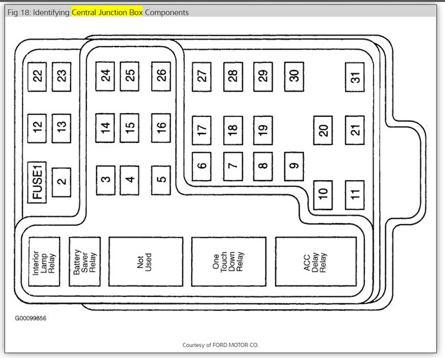

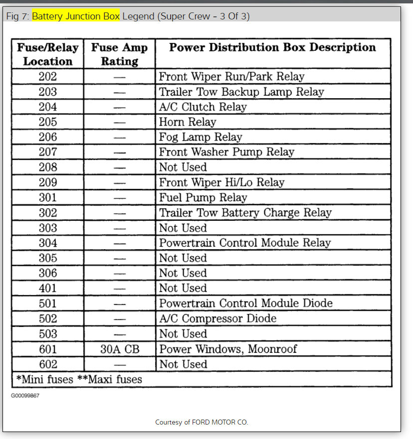

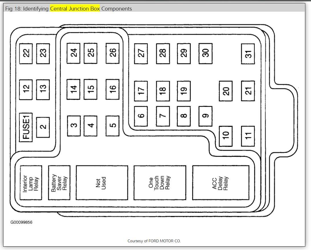

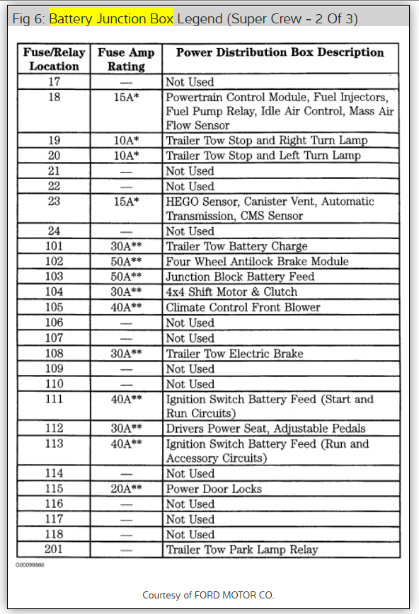

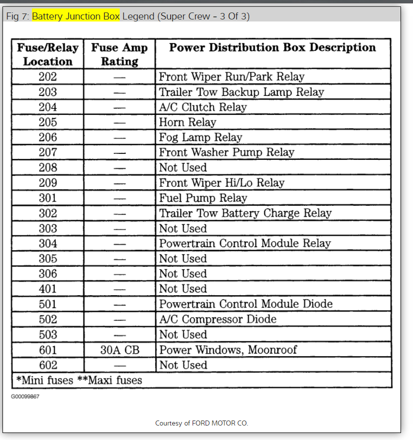

This code comes up when the cluster is not working when you turn the key on does the cluster work. You could have popped a fuse which could cause this issue. Let's start with the easy stuff first. These guides can help also I have included the fuse locations:
and
https://www.2carpros.com/articles/how-to-reset-a-security-system

Yes, fuse is good, and I tried the little tricks to bypass the pats. Nothing worked.

This first started when something was overcharging my battery, and someone reseated the cable and I guess instead of overcharging the battery it sent all those volts to everything else. Someone said that could have damaged the computer could it?
Saturday, March 19th, 2022 AT 6:39 PM

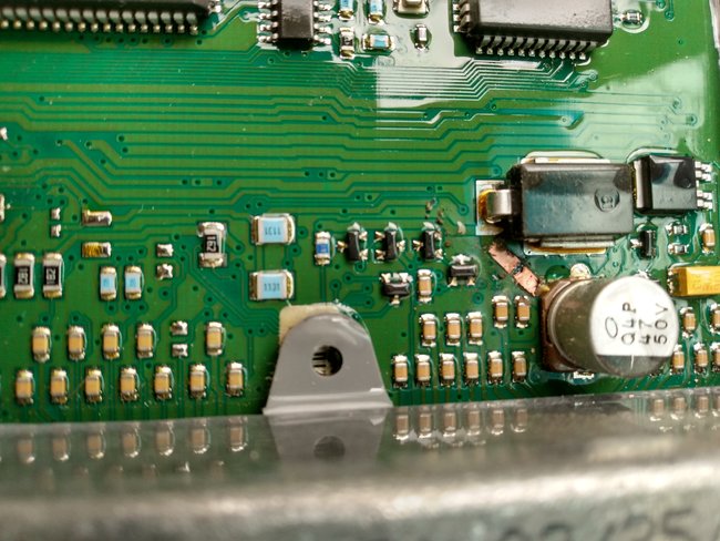

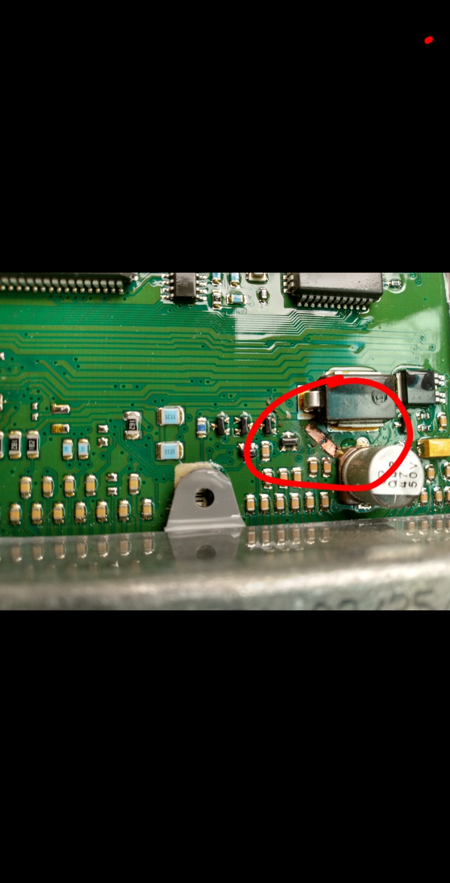

Tool the computer out of its casing and there's a burn spot assuming that's the problem. Do I need the exact same computer for it to work in my truck? And what could be causing the overcharging issue? I've already replaced the voltage regulator.

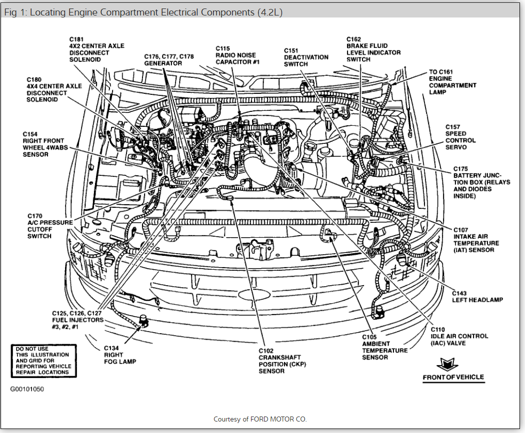

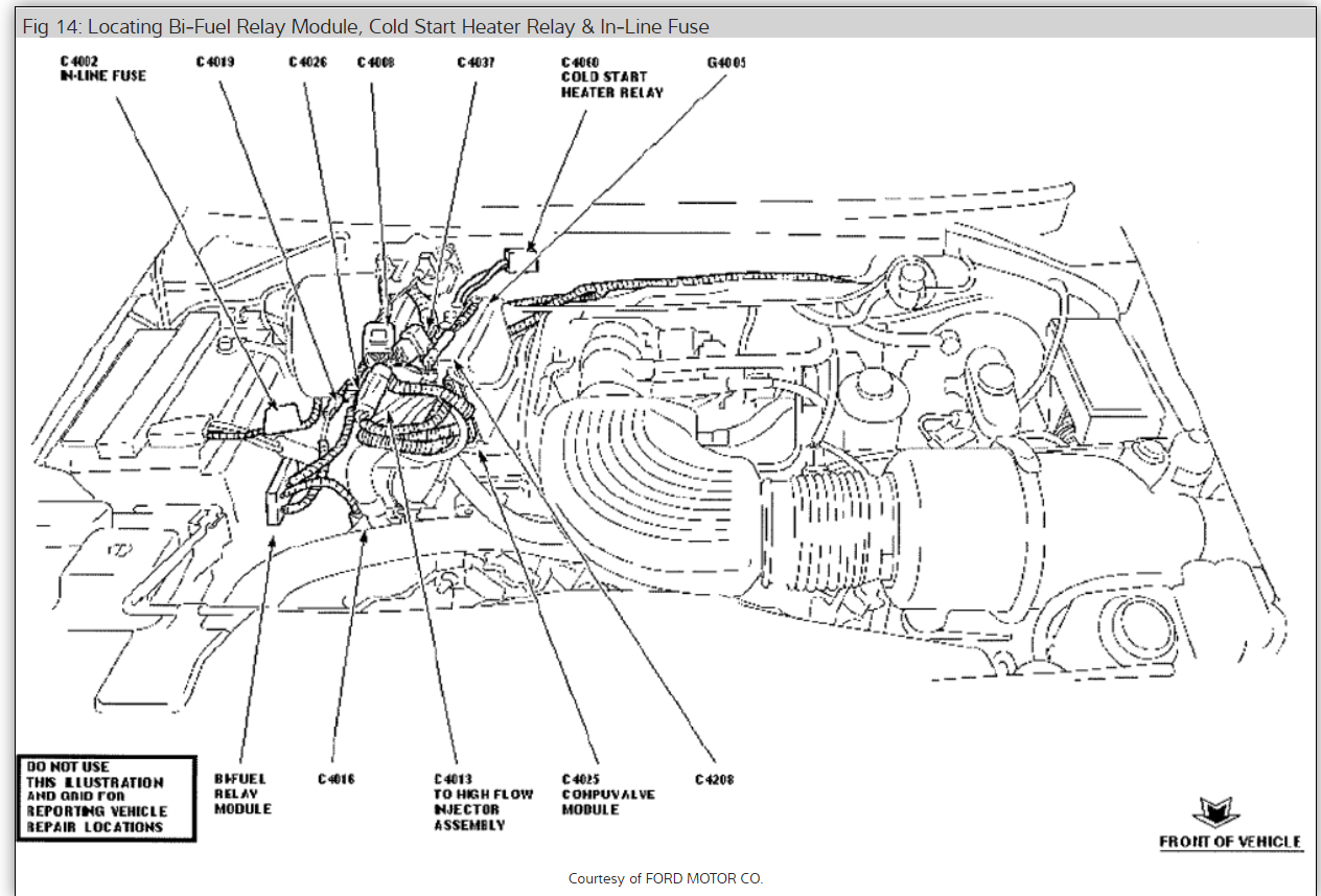

As you can see from these wiring diagrams the cluster has a voltage gauge that interrupts the charging system so if the cluster is bad, it will cause charging issues. Check out the diagrams (below). Please let us know what happens.
Monday, March 21st, 2022 AT 10:26 AM

Thanks I'll look into that. Could this be the cause?
Monday, March 21st, 2022 AT 2:38 PM
KEN L
  • MASTER CERTIFIED MECHANIC
  • 55,488 POSTS
Yep, it looks like you may have found the issue, you can fix that by soldering over the break.
Monday, March 21st, 2022 AT 3:18 PM
JCPHILLIPS21
  • 12 POSTS
Really all I have to do is solder over where the strips are broken. To fix the overcharge issue so I need to check all of those wires in that ground for a naked wire.

It didn't fix it still gives me theft code 16.

Does the cluster work now? Also did you clear the codes? This guide should help:

Yes, everything on the cluster works other than mileage is all dashes. No, I haven't cleared the codes, I'll try that.
