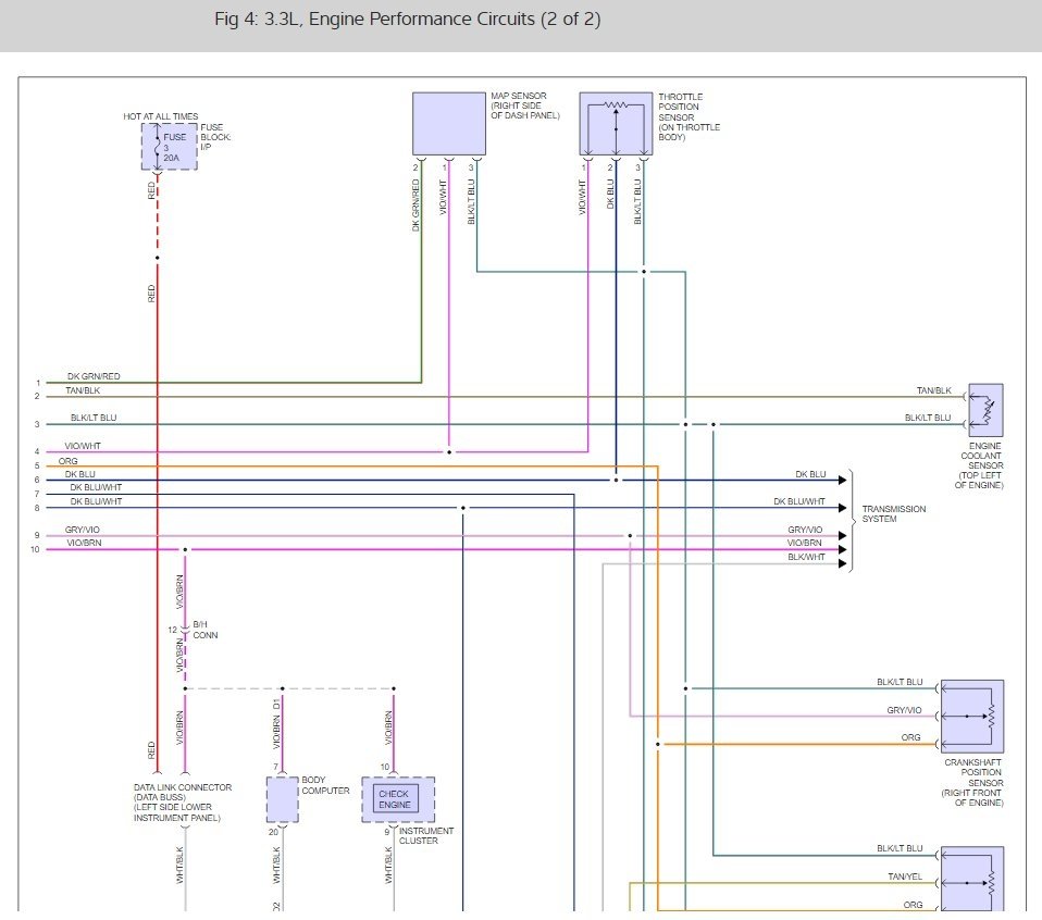

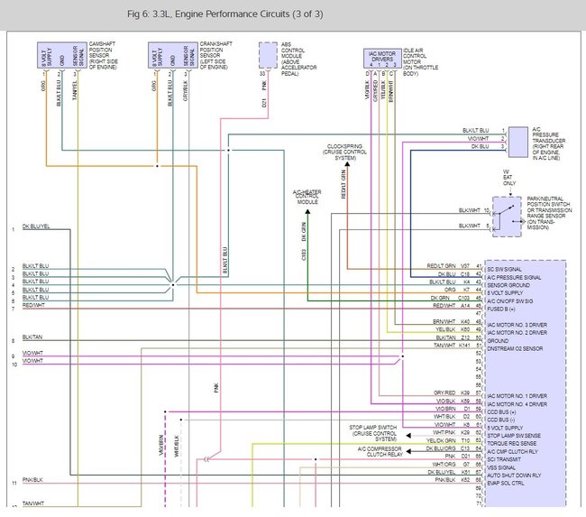

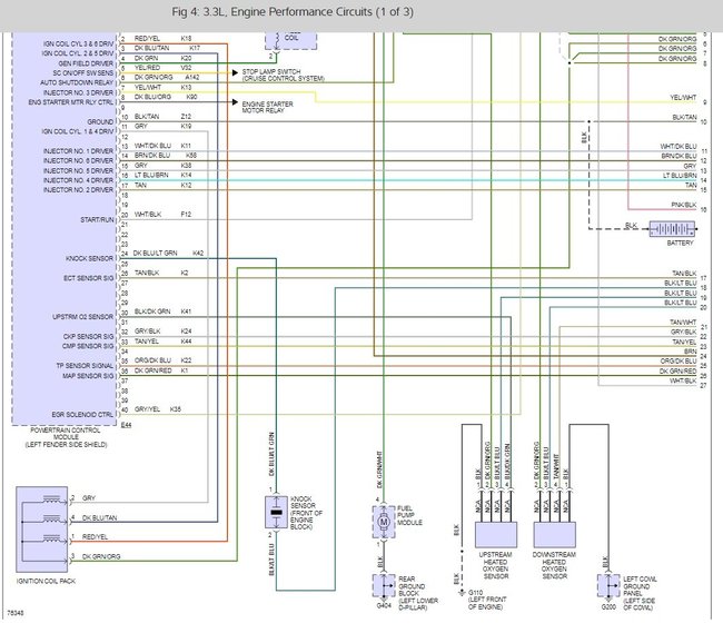

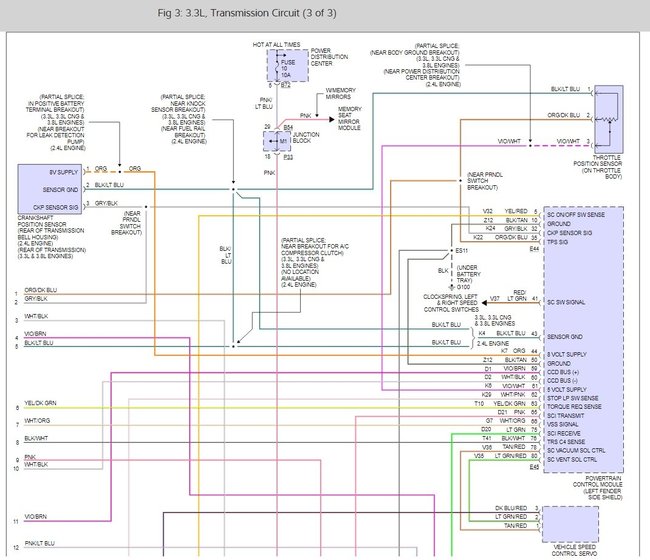

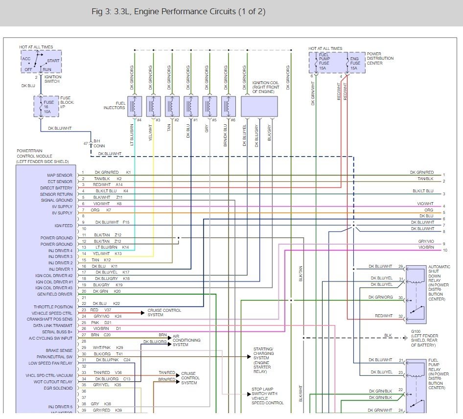

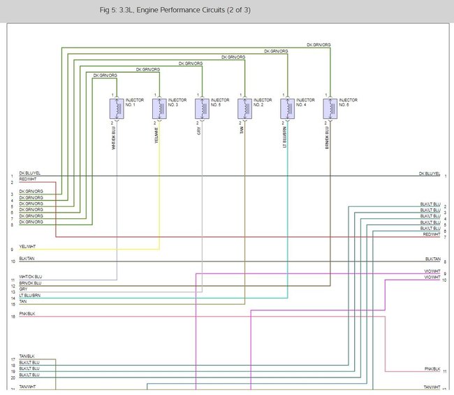

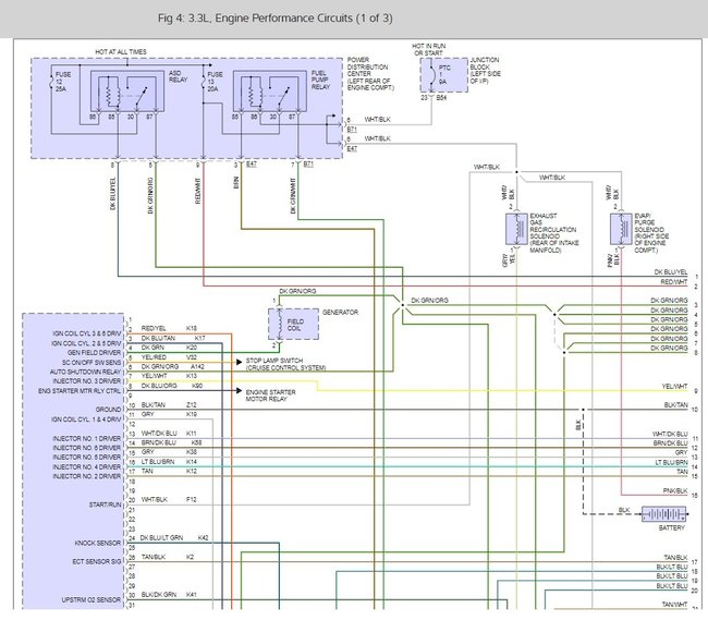

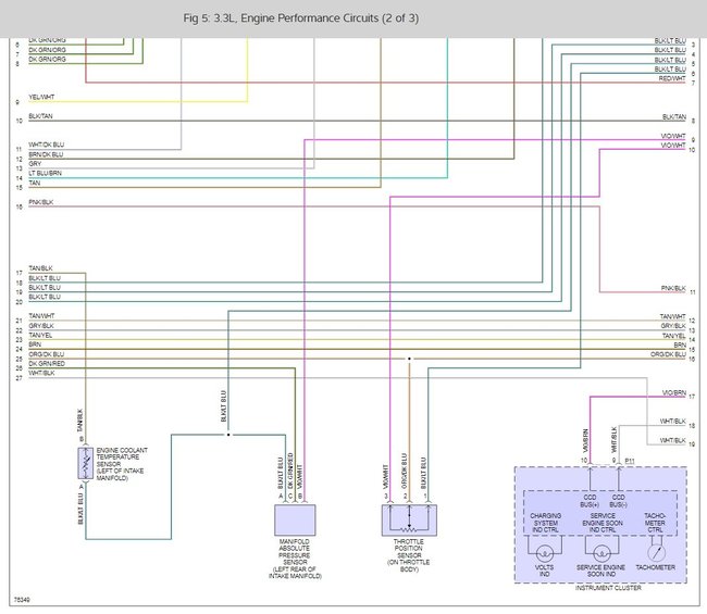

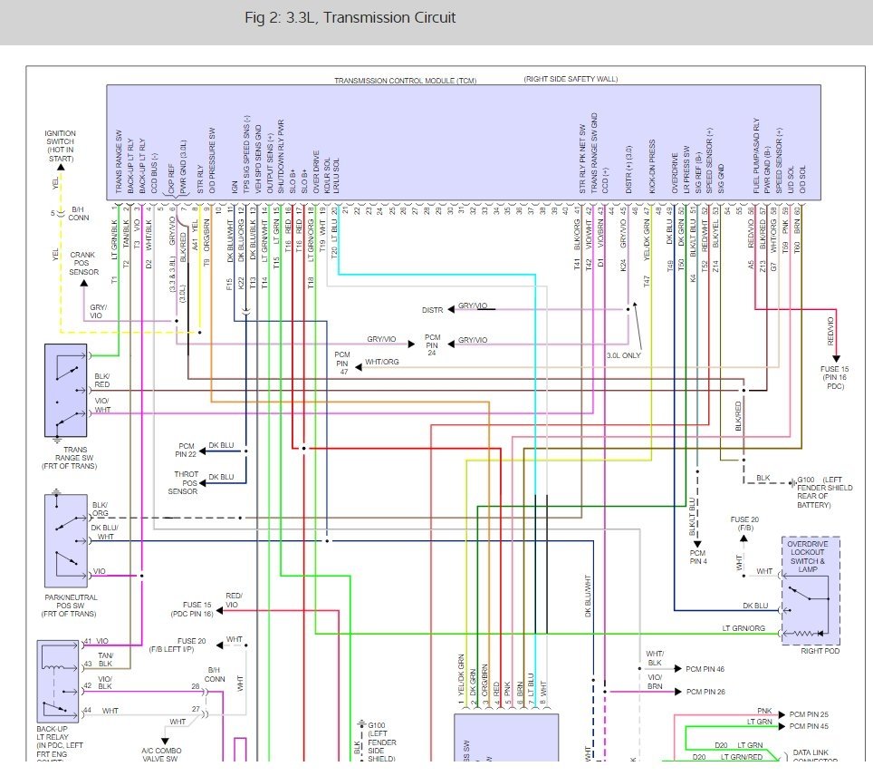

I cannot find a complete wiring diagram for my car listed above. I am diagnosing a limp mode problem without a scan tool, and I need correct TCM pin identities etc.
Jul 8, 2017 at 5:48 AM
  • 55,781 POSTS

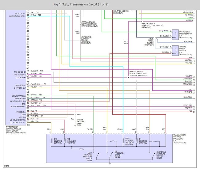

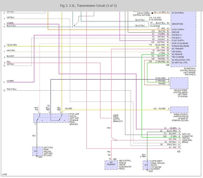

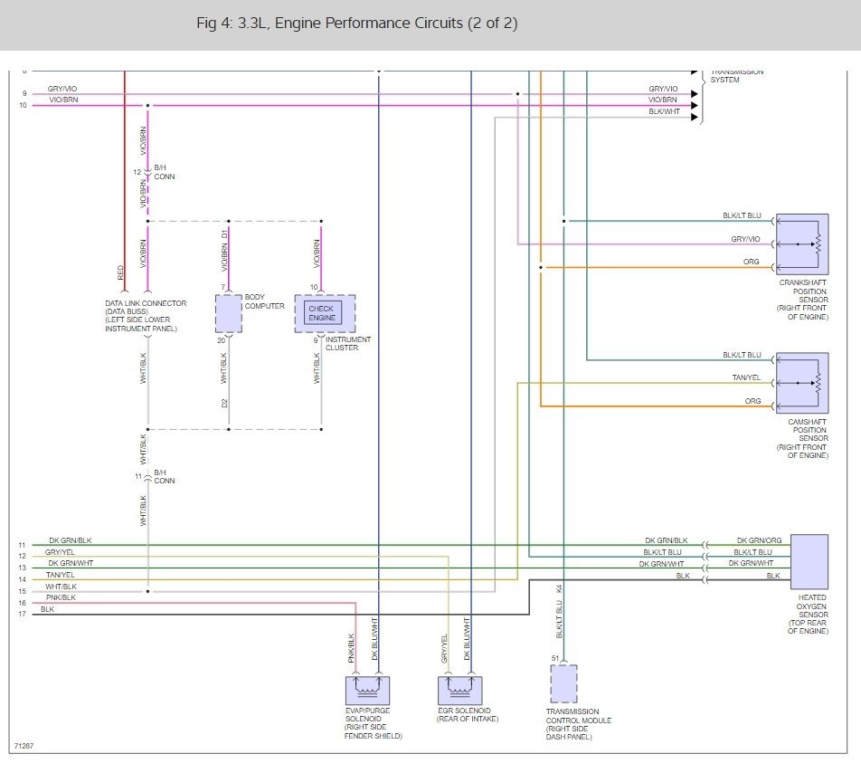

Here are wiring diagrams (below) for the engine and transmission along with a guide to help you do some testing.
Please let us know what happens, we are interested to see what it is.

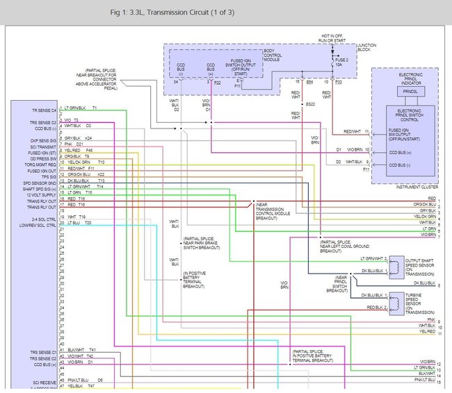

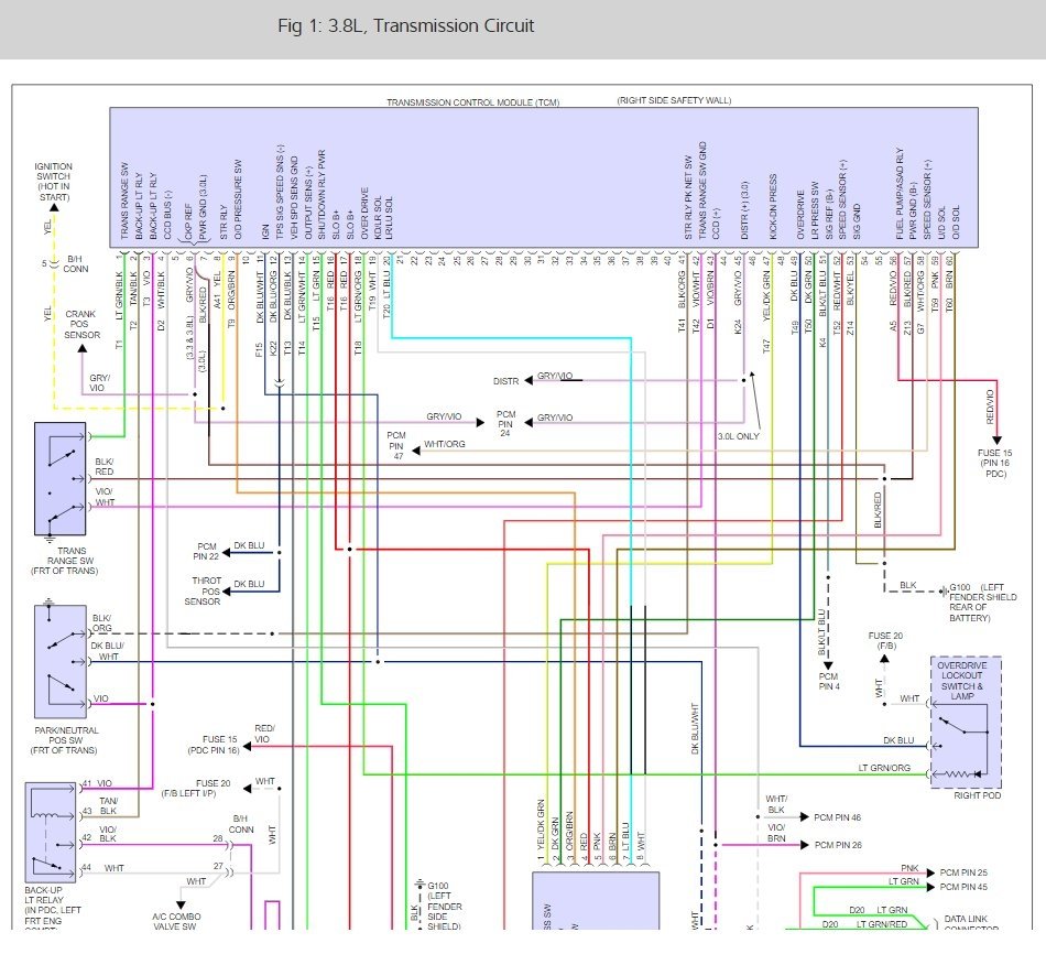

I apologize I should have paid more attention. The vehicle is a 1995 3.8L not a 96. Huge difference.
Jul 10, 2017 at 10:51 AM
  • 55,781 POSTS

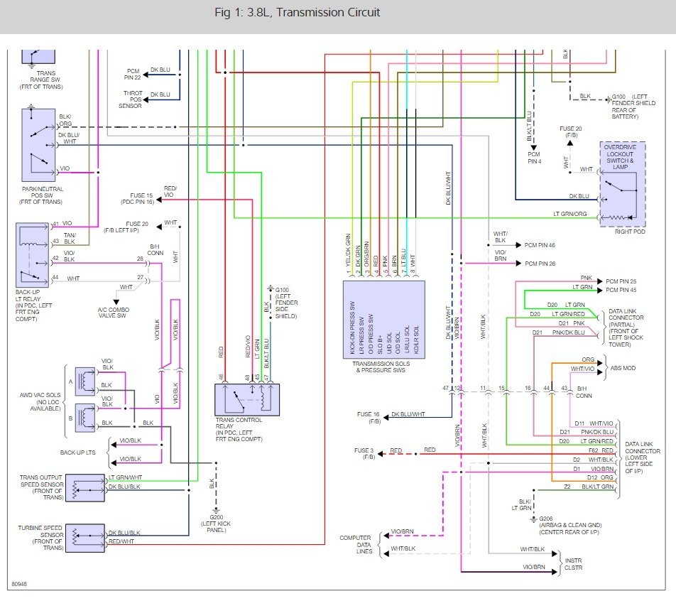

Yep there is a big difference :) here you go (below)
Jul 11, 2017 at 8:20 AM
A604
  • 38 POSTS

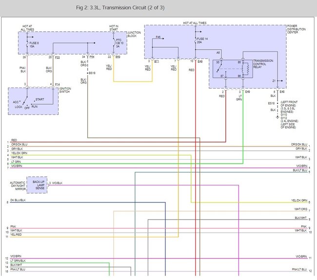

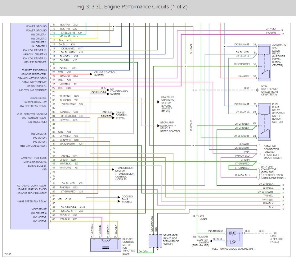

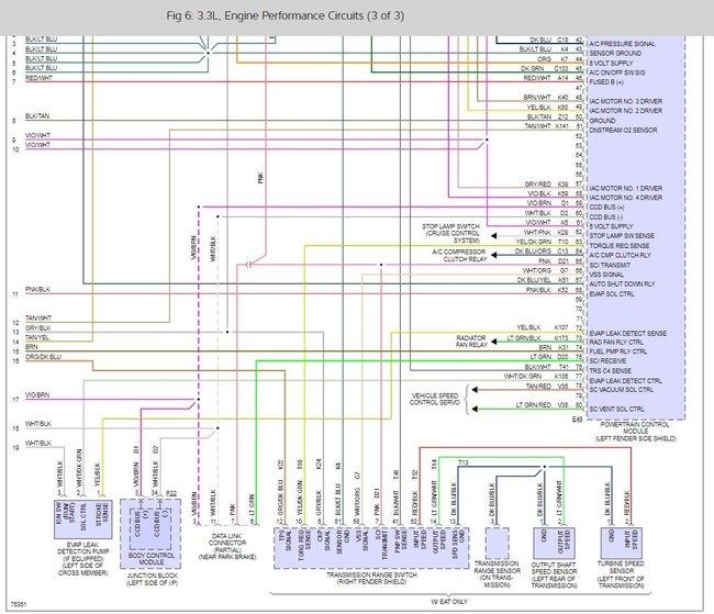

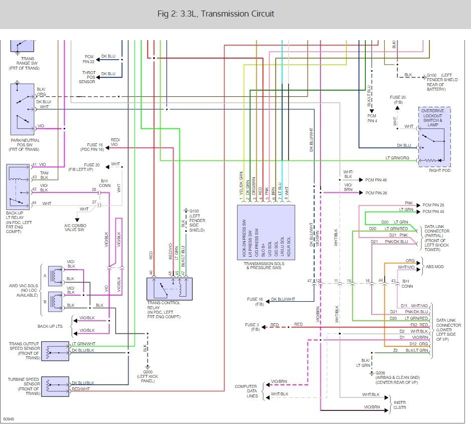

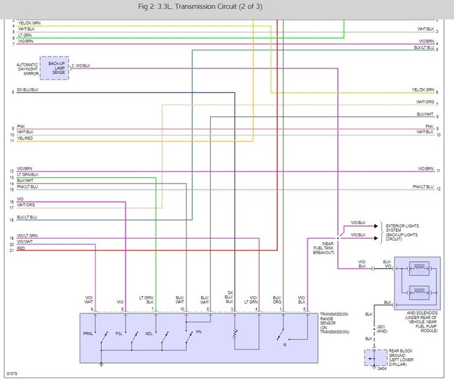

I mainly need a diagram of the tcm connector wires, shift solenoid block (8 pin ) connector wires
Jul 11, 2017 at 8:36 AM
  • 55,781 POSTS
Yep got you covered (below).

A604
  • 38 POSTS
Oh one other item does it make a difference these diagrams say 3.3l and my vehicle is a 3.8l
Jul 12, 2017 at 4:15 AM
  • 55,781 POSTS
They shouldn't but let me get you the 3.8 to be sure

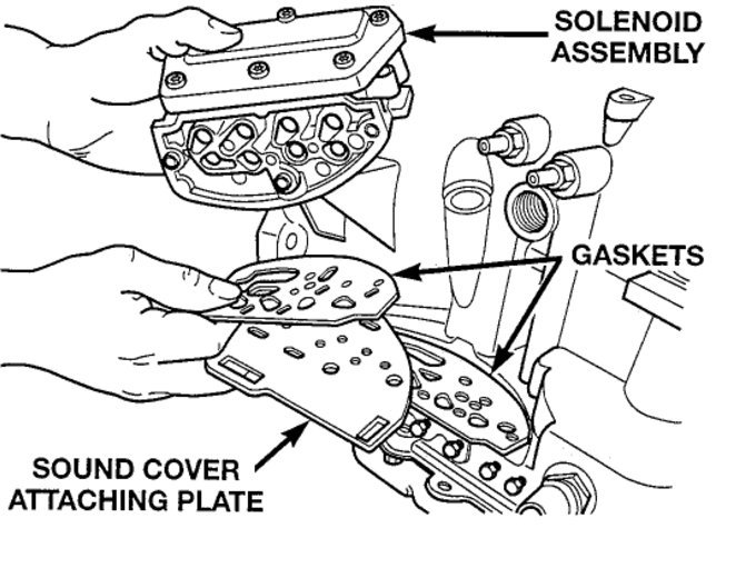

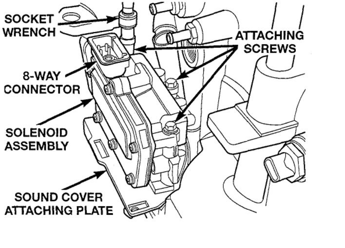

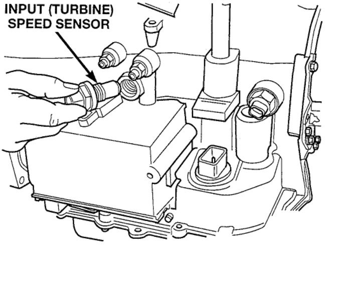

While driving went into limp mode meaning I had P,R,N, and second. I changed fluid and filter (atf+4), normal silt in pan no shiny metal. I also put Lucas transmission fix in. Van drove fine for 189 miles then limp mode again, I went ahead and changed fluid and filter, pan filter and fluid were clean. No Lucas this time. Drove fine gain for maybe eighty miles before limp mode. I am mms or in a position to have it scanned for transmission codes. I know when it is going to be in limp mode as soon as the engine starts here is how. As soon as it starts there will be a slow ratchet sound ( for two seconds) two times. I know it is in limp mode. When it is not there is no ratcheting sound, and when I put it in gear it smooth with that normal solenoid buzz click sound. I have found no bad wires connections, or grounds. Relay is good, I have correct voltage at TCM connector pins 8,11,60,59,19,20,15,16,17,56 but not at 9,57,47. Wires for those 3 go to 8 pin connector on the solenoid assembly and test good with ohms. Any Ideas?
Jul 17, 2017 at 2:33 AM (Merged)
  • 55,781 POSTS

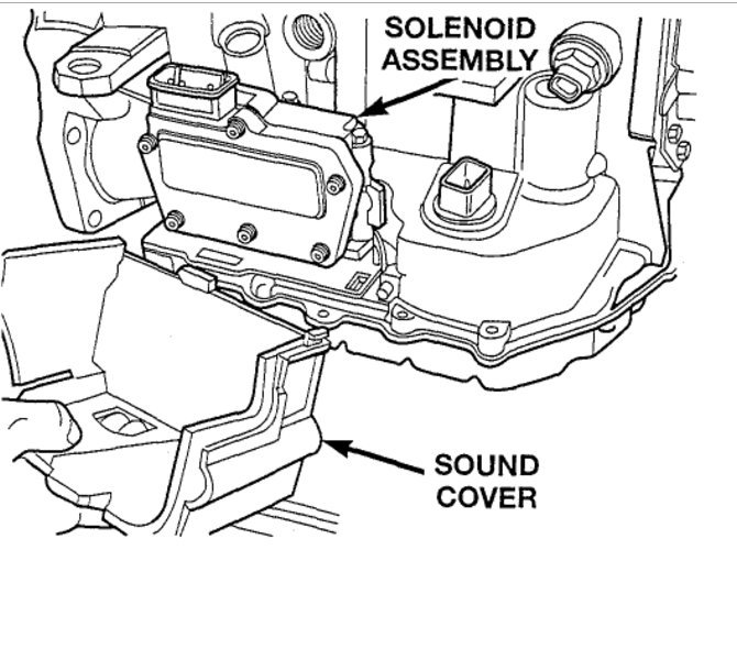

Yep, it could be a speed sensor or the solenoid pack. I have seen failures for both, Here are some diagrams (below) and a guide to give you an idea when changing the sensor.

I now also have voltage at pins 9,47, and 57 on tcm connector. So I did a amperage draw test. Pins 19,20,59, and 60 which are the solenoids they all fell into spec at 6.75amps. Is there a way to test the two speed sensors with a multimeter?
  • 55,781 POSTS
Yep here is a guide to help you get the job done.

I am troubleshooting transmission checking for voltage at TCM connector with a jumper wire at eatx relay I have one to two volts at pressure switch pins 50,47, and 9. I am supposed to have twelve volts (reference) correct? I do not know what to do next. I have no scan tool, van is in limp mode, no check engine light little.
CARADIODOC
  • 34,415 POSTS
Do you have twelve volts on the jumper wire at the relay socket? If not, check fuse fifteen under the hood.

Also could I get wiring diagram for the ECM

okay, that twelve volts should also be found on the red wire, terminal four, at the solenoid pack. There are three pressure switches in the solenoid pack, but I have never worked on that part of the system. I cannot find a written description, so I am going to have to guess that twelve volts gets switched onto those three lines you are looking at when the appropriate switch turns on. If that is correct, we know all three switches will not fail at the same time. One failed switch would be detected as such, and an appropriate fault code would be set.
It is also possible the computer sends out twelve volts on all three of those lines, then the switches ground that and send the voltage on its line to zero volts when it turns on. There is no ground wire in the connector for the solenoid pack, but that circuit could be made through the mounting bolts. Regardless, it is again not likely all three circuits would develop a problem at the same time.
The first thing to do is have the diagnostic fault codes read and recorded in the transmission computer. That will indicate the circuit or system that needs further diagnosis, or the unacceptable operating condition. You are doing tests that are the last step in the procedure after you know which circuit to look at.

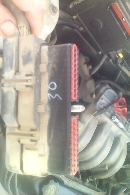

I have another question same vehicle what is the name or type of connector that plugs into the TCM, and ECM?. I tried using the term 40 pin, and 60 pin I got zero results. Here is a pic of it.
Sep 29, 2017 at 4:57 AM
  • 55,781 POSTS
Main ECM connector. I don't think it has a name that I know of. Caradiodoc might chime in with it
