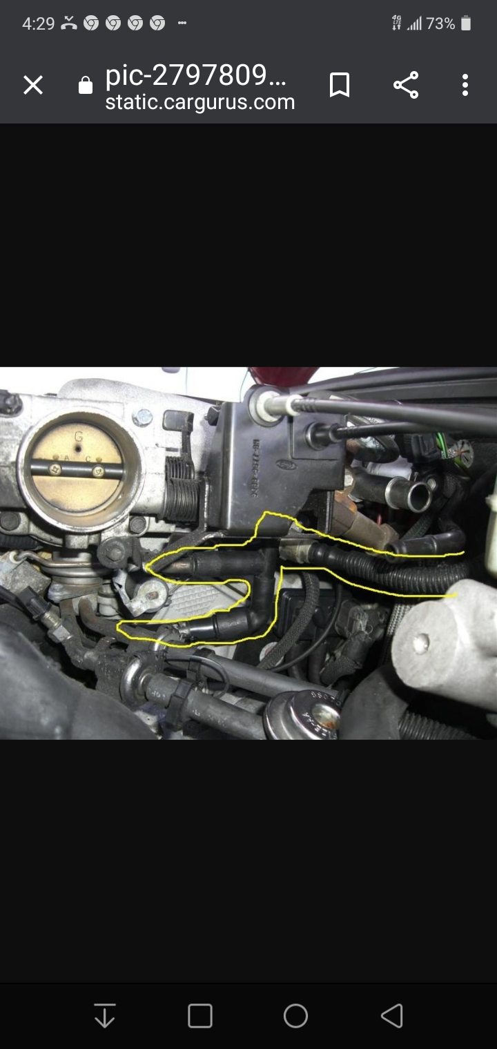

Oh my goodness I think i'm finally done. I was hard headed and allowed AutoZone to order me the pump only and it was the wrong one, which I found out the next day.
So skiddish I took my time ordering the full assembly because I was also confronted with a water pump issue but as of this morning its all done.
But I could not get the locking ring back in place so after trying all night I decided to remove the gasket(which seemed to big) and I got the ring secured. I'm hoping that does not come back to haunt me.
This hose I broke doing the water pump. Can anyone identify it? I don't think it's the breather hose as suggested but I could be wrong again. Thanks guys.
