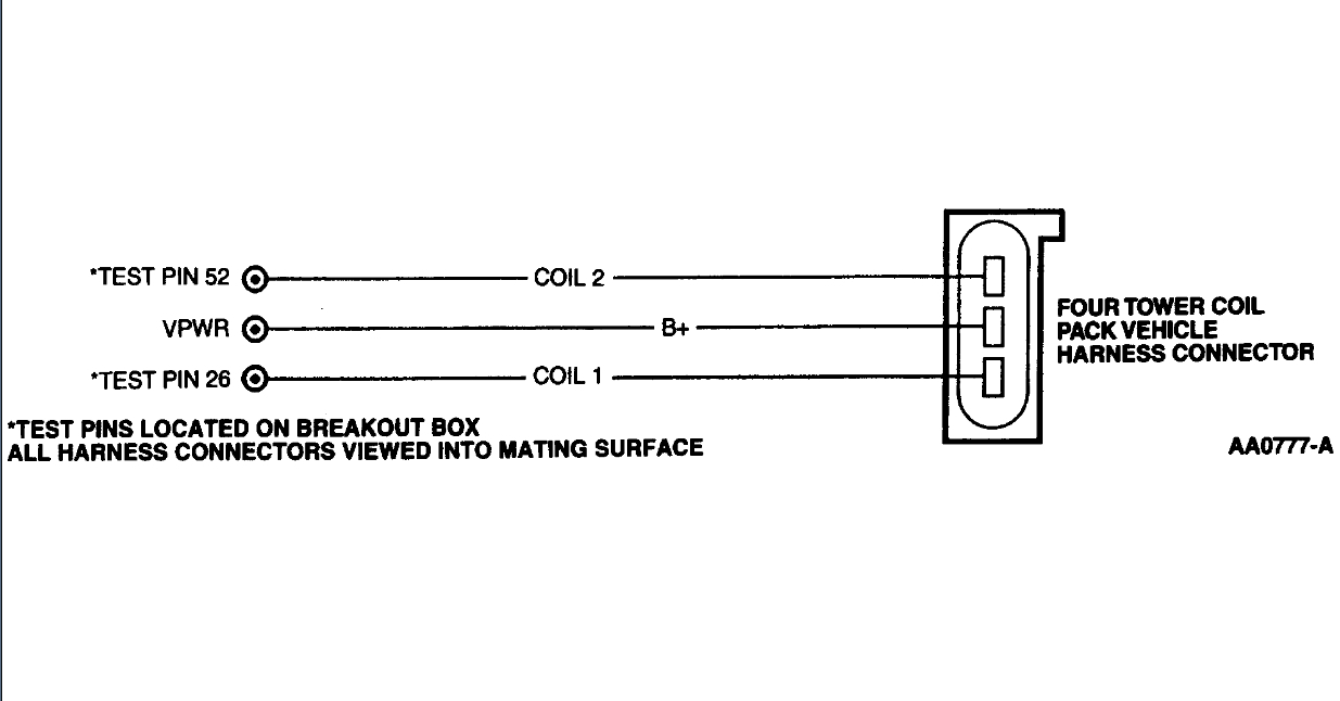

There is no ignition module. The computer controls ground for the ignition coils. Check primary voltage at the coil pack, key on. Red wire with lite green tracer should be hot/voltage, use a voltage tester. Is it hot? That circuit is fuse protected.
Are there any applicable trouble codes?

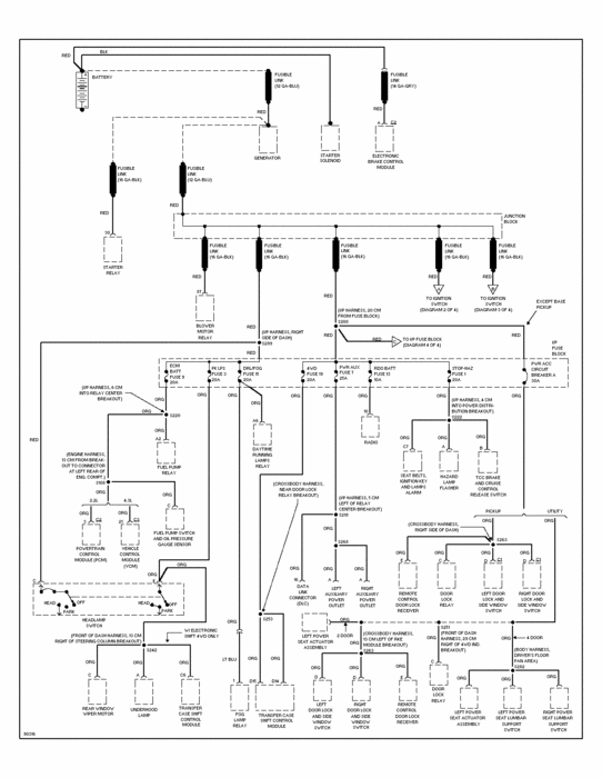

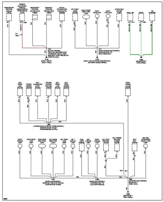

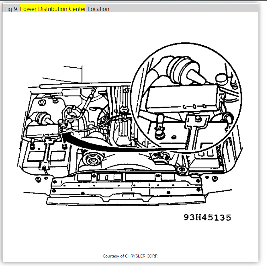

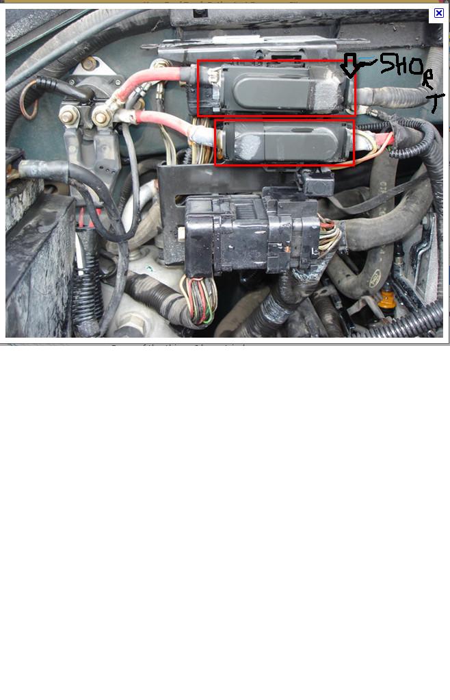

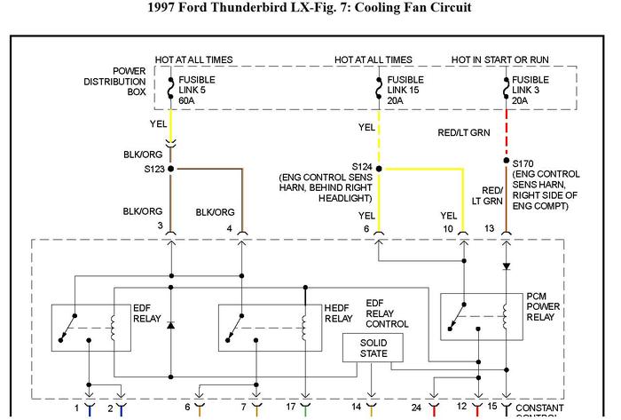

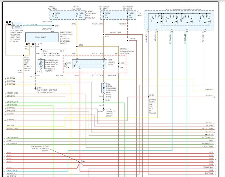

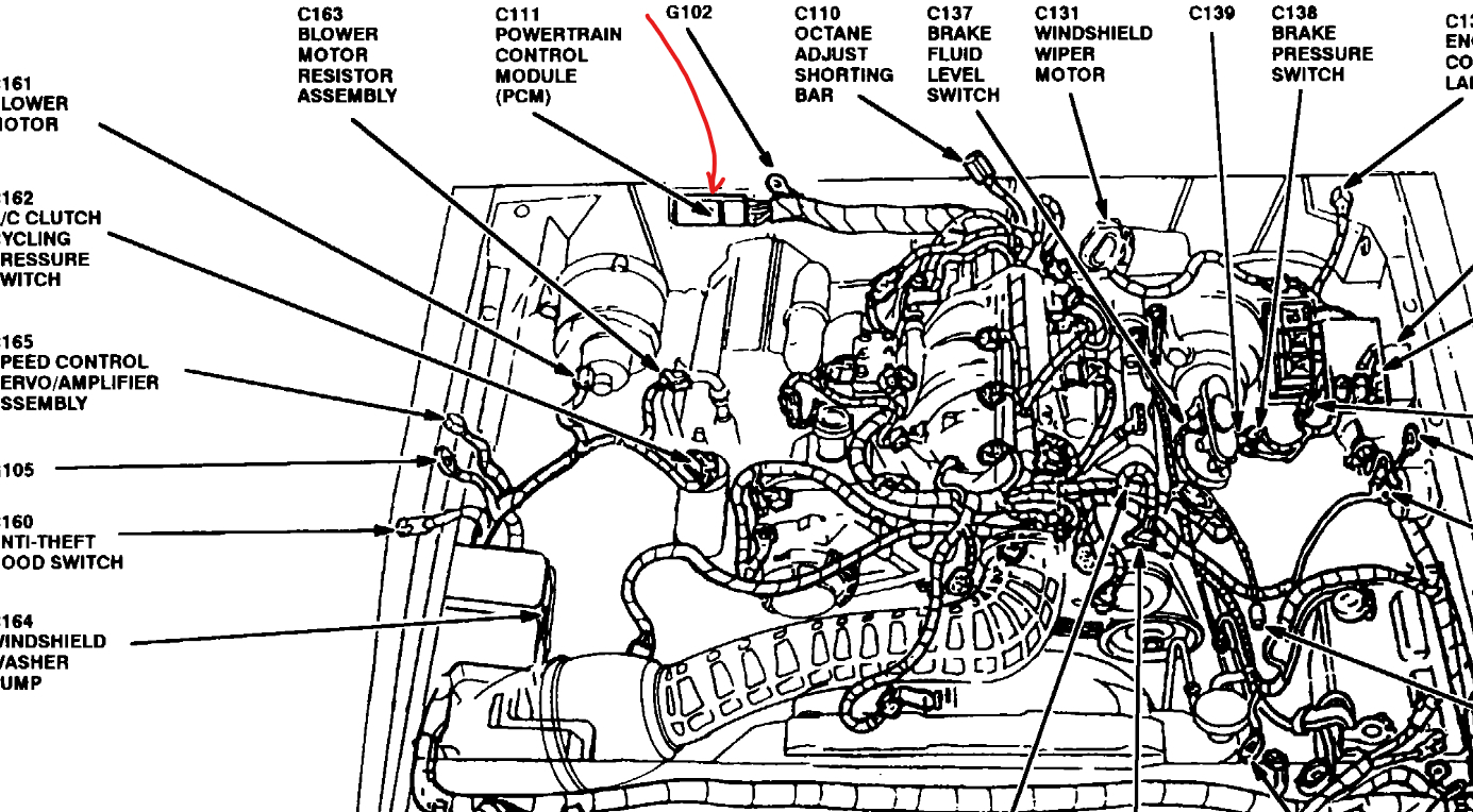

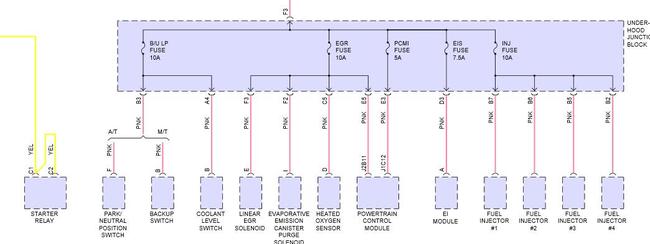

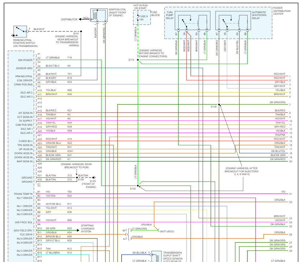

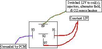

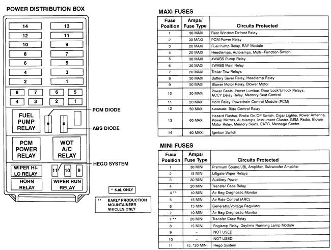

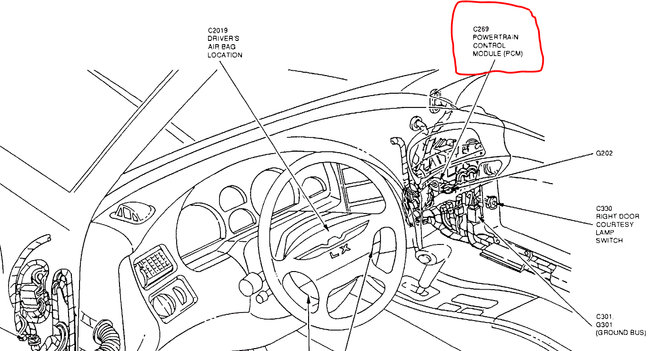

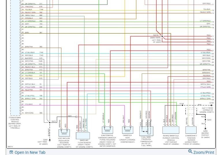

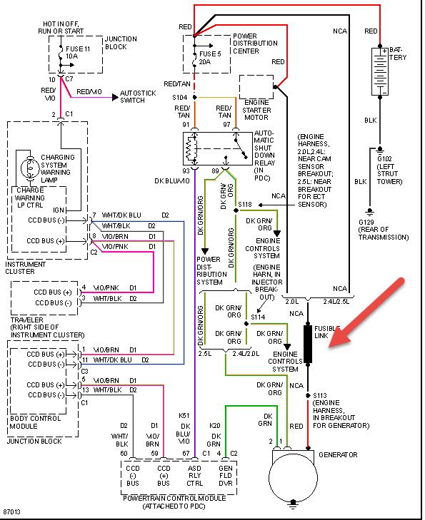

I have a cougar and it cranks fine but wont start. The check engine light will not come on in run position indicating no power to computer. There is a electrical cluster in front of air box that clicks instead. Every now and then it will catch just for a second and then its back to cranking. The high current fuses look okay but could there be a break somewhere beyond sight window? Also jackass mechanics installed heater core and fluid drips from OBD2 connecter in passenger floorboard. This problem has been around way before all the starting problems occured. Just installed new battery and fuel filter.
Monday, September 21st, 2020 AT 11:09 AM (Merged)

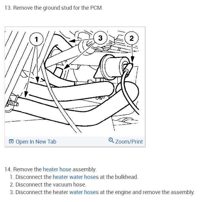

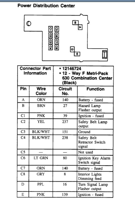

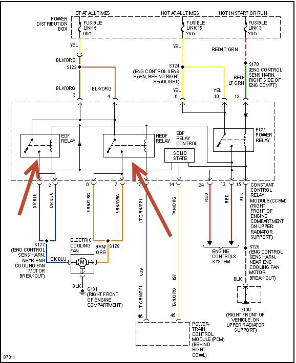

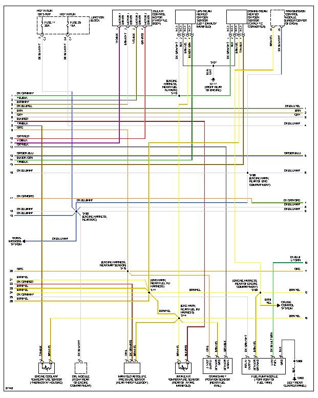

MERLIN2021
  • 17,250 POSTS

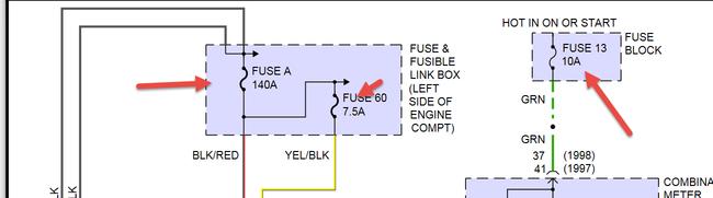

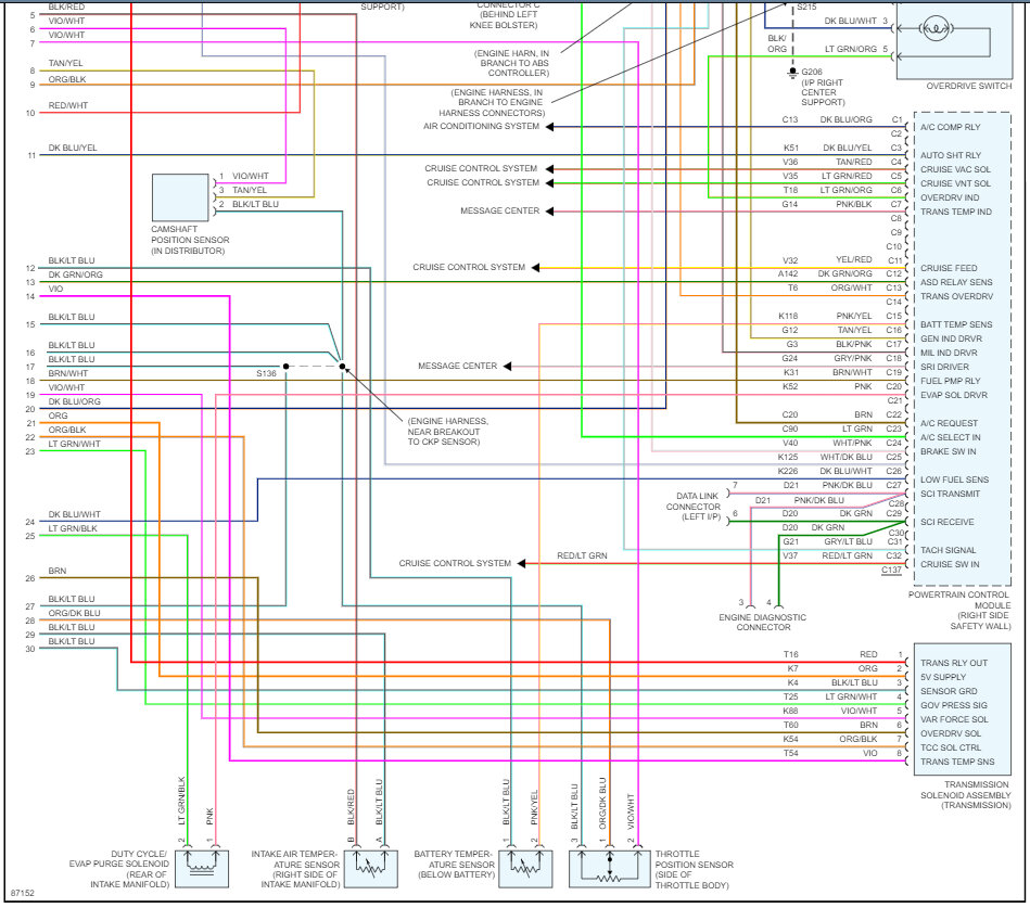

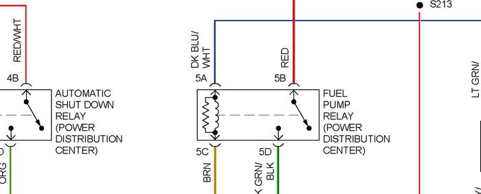

Try pulling that under hood fuse box and checking for broken or burnt wires, and check the PCM grounds Here are the two you need to check!
https://www.2carpros.com/forum/automotive_pictures/62217_PCM_Gounds_1.jpg
https://www.2carpros.com/forum/automotive_pictures/62217_PCM_Circuit_1.jpg
Check fuse 13 in car fuse panel that's the PCM fuse...

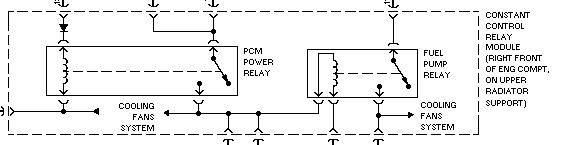

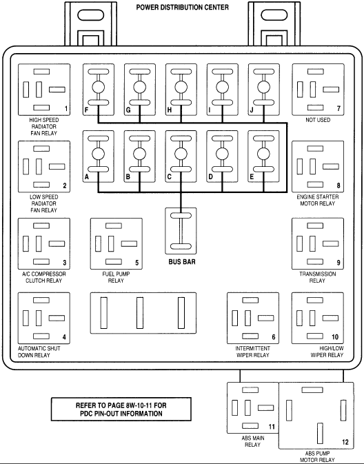

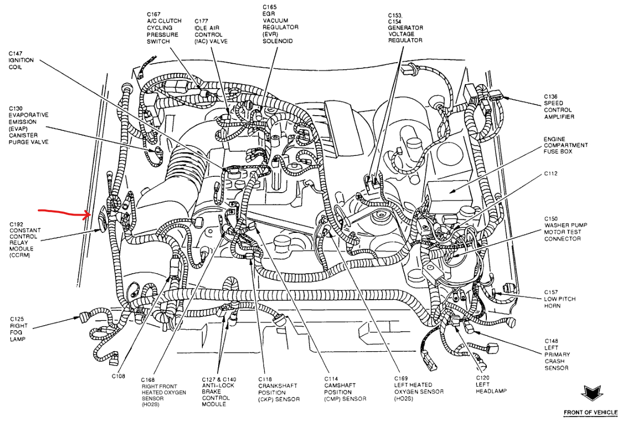

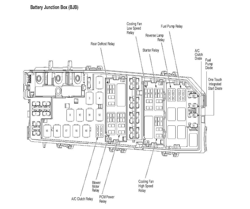

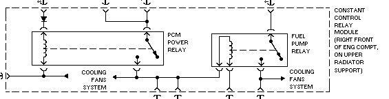

MERLIN2021
  • 17,250 POSTS
Look in the CCRM for the power relay, if it's NG no power will be supplied the the PCM EEC system!
https://www.2carpros.com/forum/automotive_pictures/62217_PCM_Testinga_1.jpg
https://www.2carpros.com/forum/automotive_pictures/62217_PCM_Testingb_1.jpg
https://www.2carpros.com/forum/automotive_pictures/62217_PCM_Connector_1.jpg
PATRICK CARTER
  • 5 POSTS

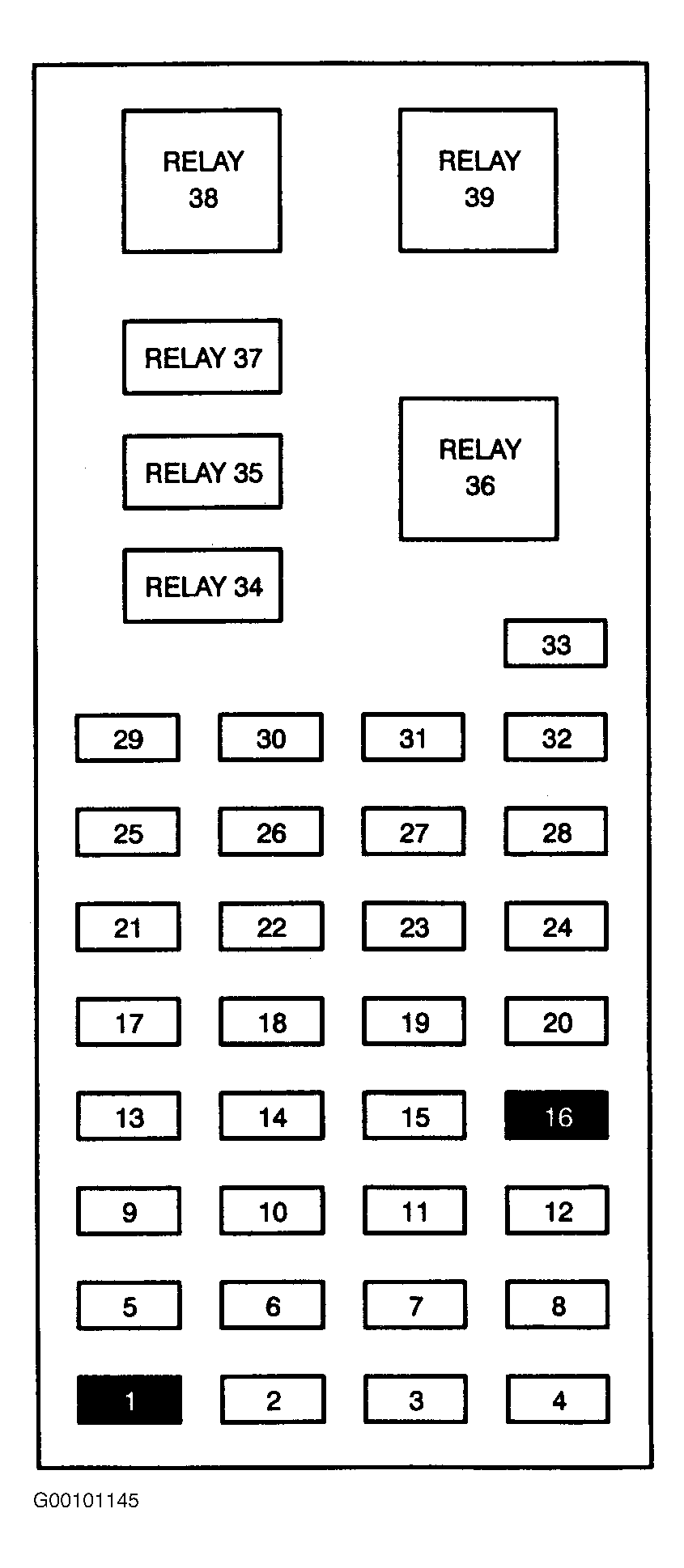

I have spare high current fuses so I replaced the pcm fuse with a brand new one and still no start. I'm thinking that maybe the computer got tired of swimming and it shorted but I could be wrong. Is there anything between the two that can be checked? The fuse panel shows no signs of burning and when you open it there isn't wires just fuses and the blades to were they go and still they all look good. This car is driving me insane. What worked for the sixties should never have been changed!
MERLIN2021
  • 17,250 POSTS
In the power ditribution center, there is a PCM power diode, it looks like a black fuse, check it too see that current can only flow one way. Check several fuses to make sure power is getting to the distribtion center.

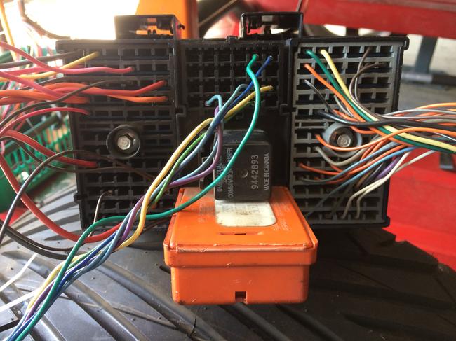

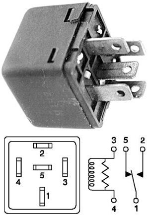

COUGAR MASTER
The reason you have no power to you computer is because the eec realy could be bad it controals the power to the computer injectors every thing really eec stands for electronic engine controals that mite be bad its in the power distrubution box its the big black realy beside the horn realy withch is green.

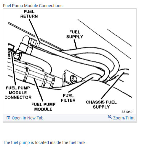

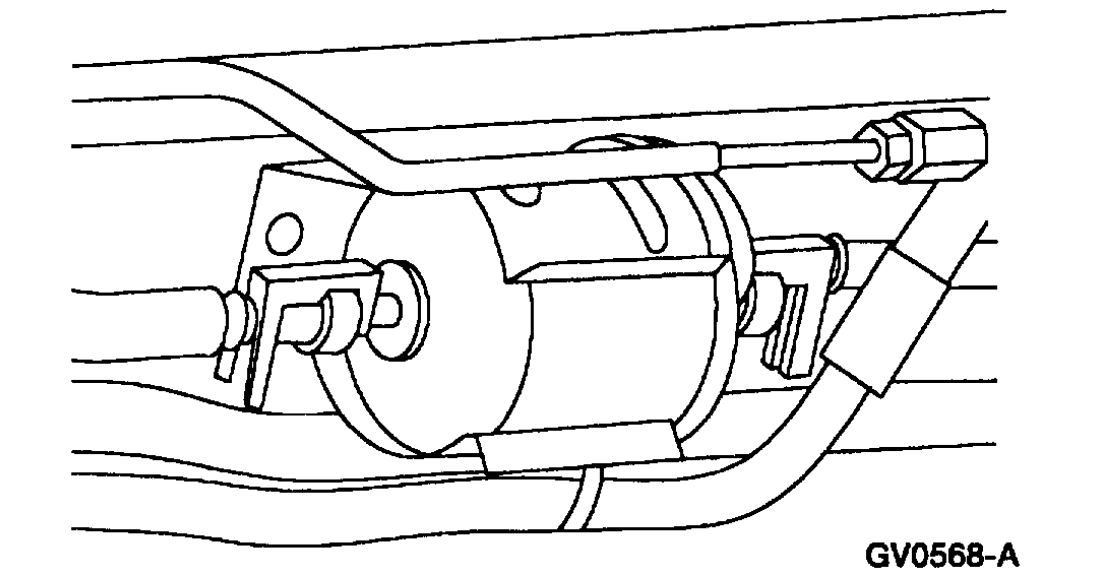

Changed fuel filter but car still cuts out and sputtersnafter running for awhile. Then when you turn it off and try to start it, it won't. But after it sits awhile it starts again and you have to push gas pedal continusly to get it to run and idle again. Then it is fine and then it happens again. Could it be the fuel pump and is it internal or external?

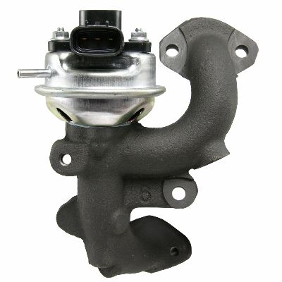

RANDICO
  • 174 POSTS
Sound like an air filter being plugged, And when you say sputter do you mean misfire? The fuel pump is in the fuel tank, just to answer your question. I truly get a feeling you may not be dealing with a fuel pump. The reason I say this is when you let it sit a while it start again. And you have to push the gas pedal to get it going again. With a failing fuel pump stepping on the gas pedal you would just stall out. Whether you are a 3.8 or a 4.6 you have a EGR. Let the vehicle idle for a while, turn off the engine go to the EGR and feel it. If its too hot to touch then its open. And the problem will be with the EGR itself.
