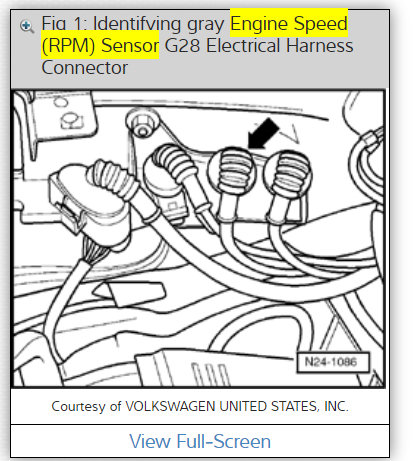

Just put in new battery in 2003 Passat, V6 2.8L. Engine turns over but will not start. Car has been outside in -20 degree weather for 2 days. New battery purchased from VW dealer was changed on second day. After a couple of start tries there is noticeable gas smell. Gas tank is 3/4 full. All fuses are good including one for fuel pump. All appropriate dashboard lights work during engine turnover.
Already Tried:
Tried to start for 45 - 60 seconds w/o touching gas pedal, engine just turns over.
Also, tried to start for 45 - 60 seconds with gas pedal pushed to the floor, again, engine just turned over w/o starting.
In addition, removed fuel pump fuse, turned over engine with gas pedal pushed to floor. Once engine sounded like it was going to start, put fuse back in. However, after 3 tries with this procedure, it still did not start. It did however, advance to some engine combustion, but just short of starting.
Thanks,
Charley
Sunday, January 18th, 2009 AT 6:51 PM
96 Replies
  • 75,992 POSTS
This sounds like you have a crankshaft position (engine RPM) sensor that is not working. Here are two guides to help us get started by walking you thought he steps with diagrams below to show you how to replace the sensor on your car.

I got a new sensor took me about 30 minutes to do the job.

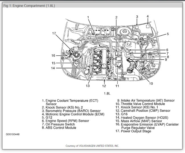

Check engine reads
17536 system too lean
16706 rpm sensor
G28 no signal intermit
Error in mapped cooling system check
Temp sensor / thermostat
Car runs and drives fine only issue is won't start

It sounds like a classic crankshaft angle sensor shorting out, but we should do some testing before replacing it to make sure we are barking up the right tree, when it doesn't start we need to check for fuel pressure and ignition spark, please follow these links to start,

The code that really stands out is the crank angle sensor engine rpm code, this sensor will cause all kinds of problems. I would try replace the crankshaft angle sensor and see what happens, follow this link for more info
