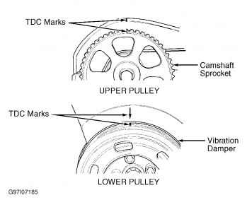

i have a 01 vw passat that died while my wife was driving so I had it looked at and was told I didnt have compression and my timing belt was broke. Later I decided to look myself and found out the belt and the chain were fine. I dont have compression, could the belt jump a cog? I looked at the timing marks on the crank and cam, according to the marks its in time. I have spark and fuel. Are there timing marks on the cam shaft for the chain on the camshaft?Also I have a chilton repair manual and it says if you have a bad sensor the car wont start, if so which sensor is it thanx

Sorry bout that, no crank just a cam sensor. are timing marks lined up as shown below

Yes the marks are right on

If timing is good and sensor is good then only things left that will cause poor compression is internal mechanical issues such as worn piston rings, valve seals etc. Would have to tear down the motor and inspect all the components to find the issue.
