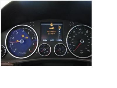

My vehicle will start but then @ times it will shut itself off, sometimes taking 2-3 attempts for the veh to stay running. I have three main concerns/questions regarding this:
A. My key light on the dash has appeared. Re-programming of the keys or possible computer malfunction/replacement.
B. Fuel pump.
C. Cluster that helps operate dashboard/odometer.

Next, this sounds like your fuel pump. You need to get it check and the pressure. If it was not operating at all I would have you check fuse 28. However it runs and cuts off. There are checks you can do on pressure and voltage but you have to have certain tools for that. You also have a fuel relay that may be acting up but again, you need test equipment. But it sounds like a fuel pump.
https://www.2carpros.com/forum/automotive_pictures/248015_1_20.jpg
As for the key, I attached a pic. I believe it means your key fob battery is getting very low and needs replacing. While at Auto Zone the actually have a battery fob tester there at some locations.
