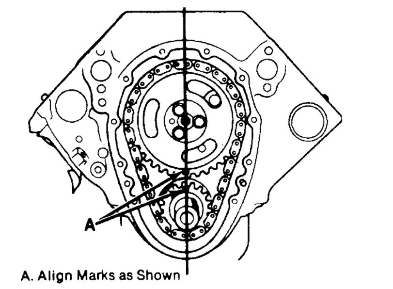

DPIERCE
We replaced the fuel pressure regulator, it was washed out and clean right under the regulator like it had been leaking, flushed injection system, then had to clear the codes because of misfires, took truck out for a drive and it still acted up. Put scanner on it and it all looked good except for -14 on cam timing. Took it to my local GM dealer and they reset the timing and said the truck was fine. But now when I go up a hill under load it pings and knocks then goes away. Any ideas?

Dpierce.
The cam retard at -17 is not good. The dealer change the position of the distributor to get the 0 reading that the cam sensor requires.
Doing that s compensation for a worn timing chain. That is why you have pinging. Most likely you will need to replace a worn timing chain and then have the cam retard reset.
