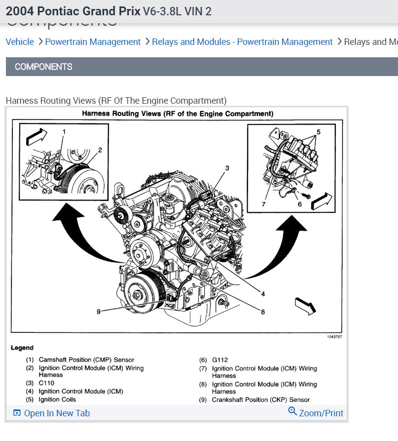

The car starts fine and will run real good and strong. Then it shudders and begins to lope RPM's up and down. Then it shuts off. It will start back up but it doesn't run for ore than about a minute. Performed fuel pressure checks, spark check, injector pulse. I have checked all the basics. Watching the scanner data I can find nothing to cause this problem. All parameters look correct. I was looking at the data and see that as soon as it goes into closed loop is when my problem begins. After I couldn't find anything, I changed the MAF sensor, MAP sensor, and O2 sensors as a guess. I have the scanner data available. I have been doing this a long time and I've not been stumped like this.

No codes correct? These cars had a problem with the ignition module and coil pack. It wont cause codes but it does create the problem you have described. Here is how to do the replacement. Check out the diagrams (below). Please let us know what happens.

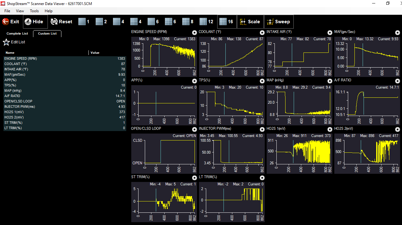

You are correct. No codes. I swapped the ICM and coil packs with a known good on the shelf, no change. I have included a screenshot of the scanner data. It seems to show that the exhaust gets richer until it shuts off.

See the MAF readings showing a possible plugged catalytic converter. To be sure lets use this guide to confirm the issue:

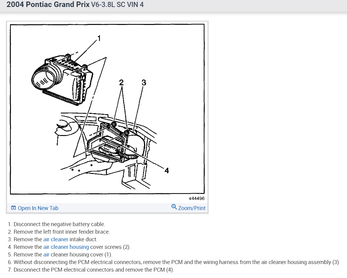

Sounds like the PCM is loosing its program and must be reset to start working again. Fuel pressure okay? If so I would swap out the PCM here is the location

Fuel pressure is within spec and never changes even through the surges. The PCM has already been changed. It is new.

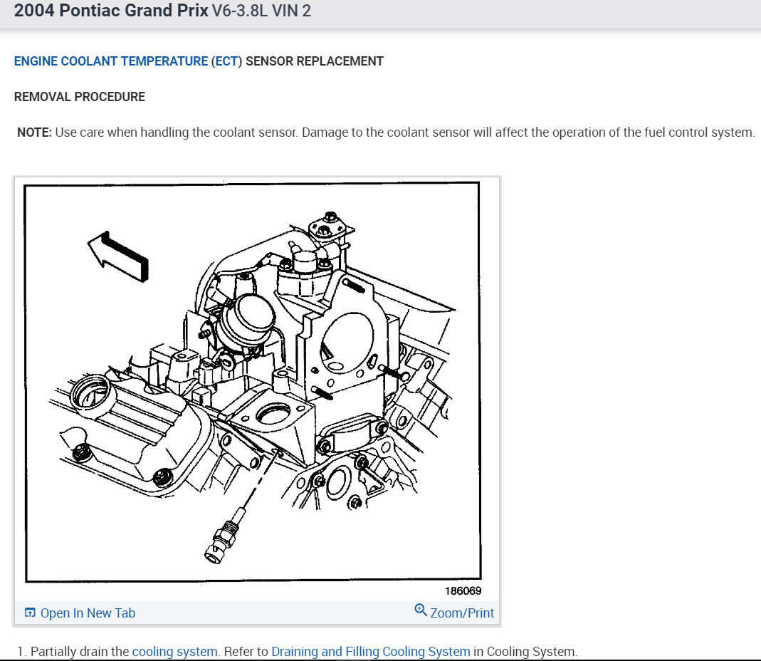

Okay, when you are reading the data do you see the coolant temperature sensor value? It sounds like it maybe shorting out when warm. Here is the location so you can swap it out. Check out the diagrams (below). Please let us know what happens.

I can see it on the scanner data and it is steady without any erratic behavior. But I will change it be sure.
