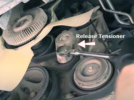

Step 1 - We begin underneath the vehicle for this job in particular even though most of the time you can do it from above, whichever is easier to reach the belt tensioner which will release the belt pressure.
serpentine belt
Step 2 - Use a 3/8 or 1/2 drive socket wrench (ratchet) and force against the spring pressure in the opposite direction to release the tension on the serpentine belt.
release belt tensioner

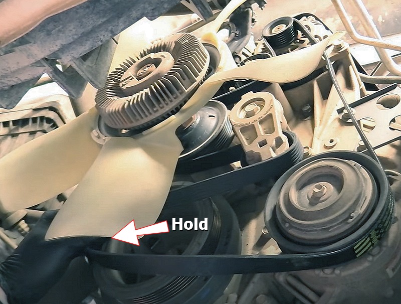

Step 3 - As you can see in the example below the belt is loose on the pulleys, while holding the tensioner use your opposite hand to remove the drive belt off of the nearest pulley. Belt routing can be confusing, so make sure to take a picture using your phone or draw a routing diagram before removing the old belt. If you get mixed up on the routing you can ask the 2CarPros communityto help, for free.
remove serpentine belt
